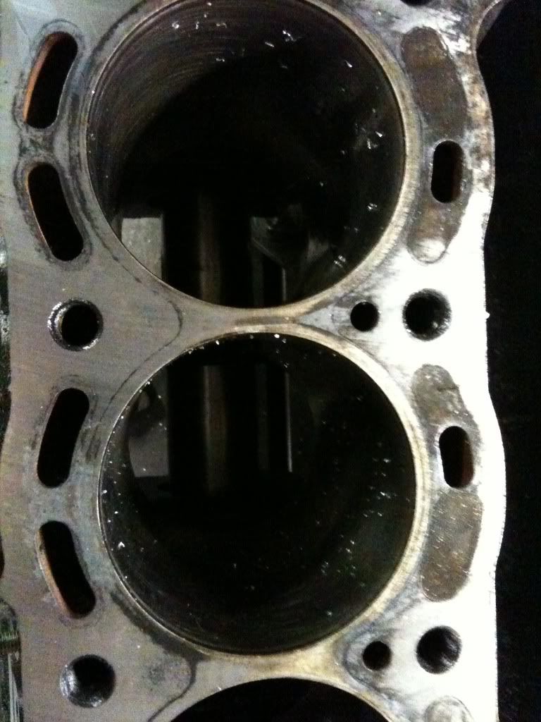

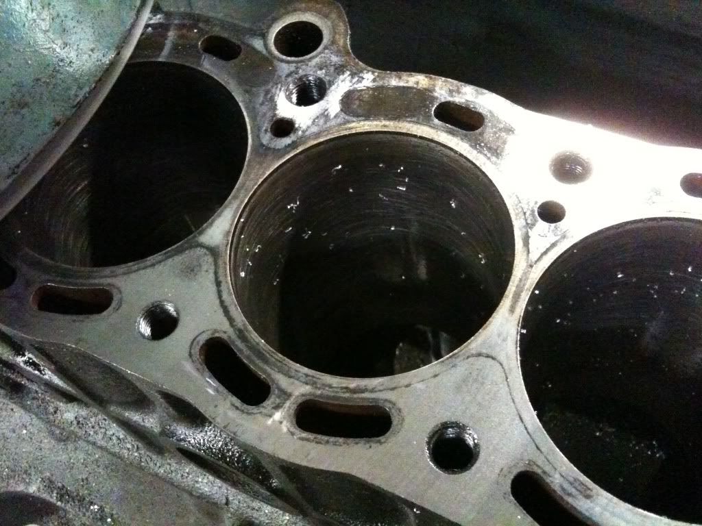

I would recommend getting the head decked no matter what, The block I would check for warpage and make sure its not warped. I would personally not recommend going with a MHG unless the block is decked. Here is one we did recently and it shows how much the block surface varies. You can see after the first few passes it is all kinds of warped and pitted. Also shows why you have to unassembled the whole block including freeze plugs and oil galley's when you surface and bore/hone a block, metal shavings get everywhere!

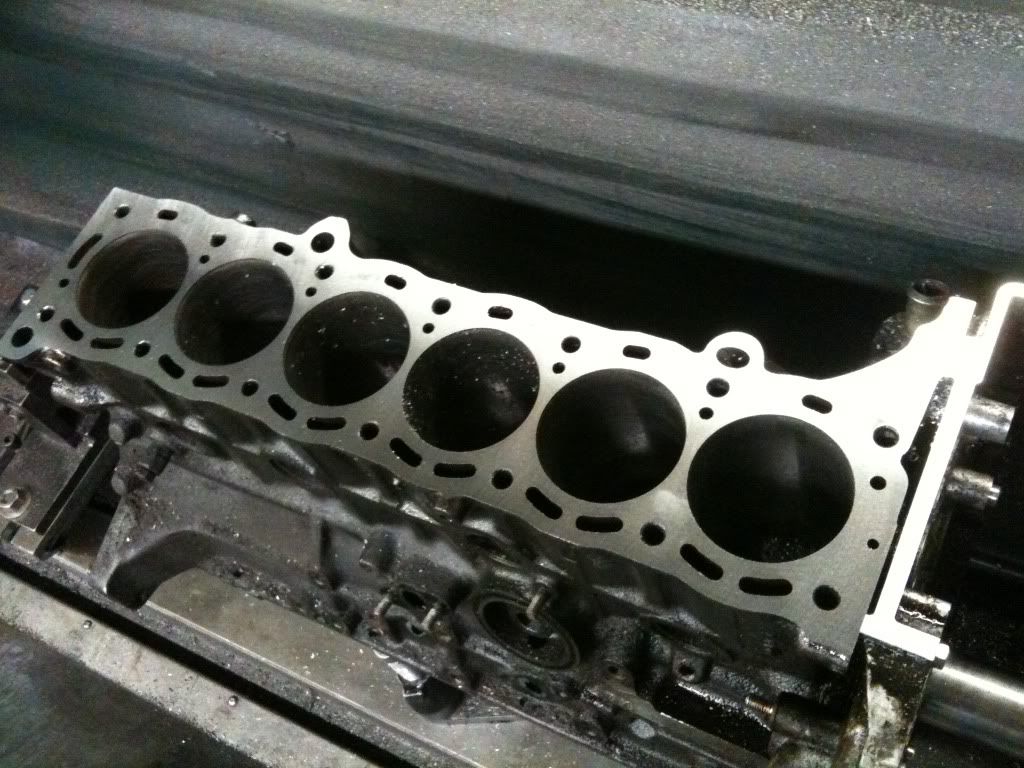

Finished product "mirror Finish"
SupraCorwin
Shadow
Oct 14, 2008
166
Washington
By mirror finish he means that the roughness index (RA) is so low flat/smooth that it looks like a mirror, which is done by taking material off the block and head at a shop. Remember to have them do it with the timing cover on, and then buy a MHG the right size to make up for the difference of lost material. :)
