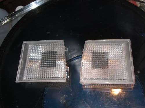

Good morning across the pond,
Just to keep you up to date, I cast the other side this aftenoon and below is the first pair in existence.......now that's unique :evil2: I knocked up another little box housing, sprayed it chrome, wired them up and yep, I reckon it's looking good. I have a rear cluster on it's way to me an hope to be able to report favourably on the dissection and post pics of the final result. All being well, I should be abe to get another to make a pair to be fitted to the first lucky owners car :naughty: The third pic you might like is my Corolla/Esprit clear rear conversion, which if you use a bit of imagination, you might be able to get an idea of the finished result.
[/IMG]
[/IMG]
