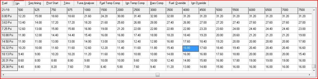

Honestly not really sure. My ignition table is based off of a table that IJ posted. The stock TCCS timing is good for moderate boost and alot of people have good luck with it. I dont know what a stock timing map looks like but i would bet its relatively safe for reliability.
Heres my timing map. Use with caution if you choose so as every motor can be different and like different amounts of timing. Keep in mind im running water/meth 50/50 starting at 10 psi.

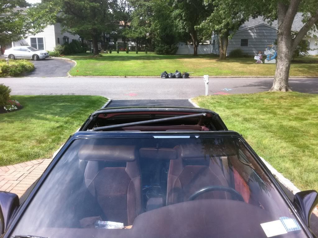

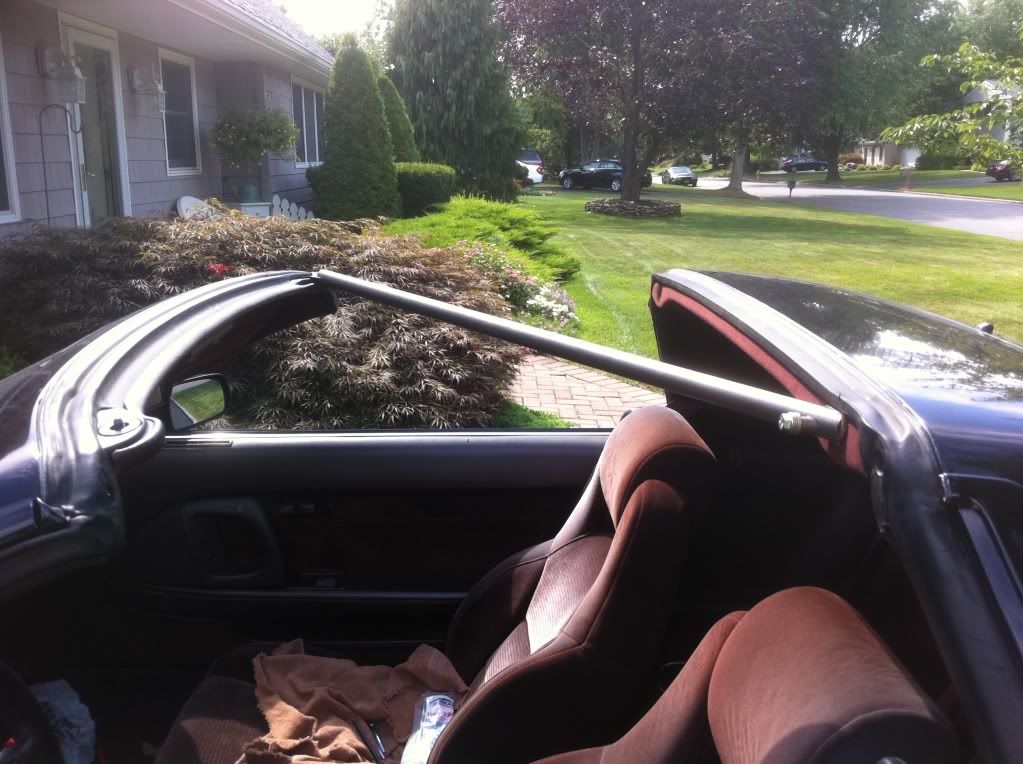

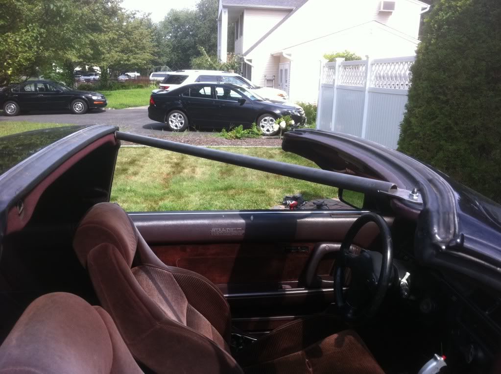

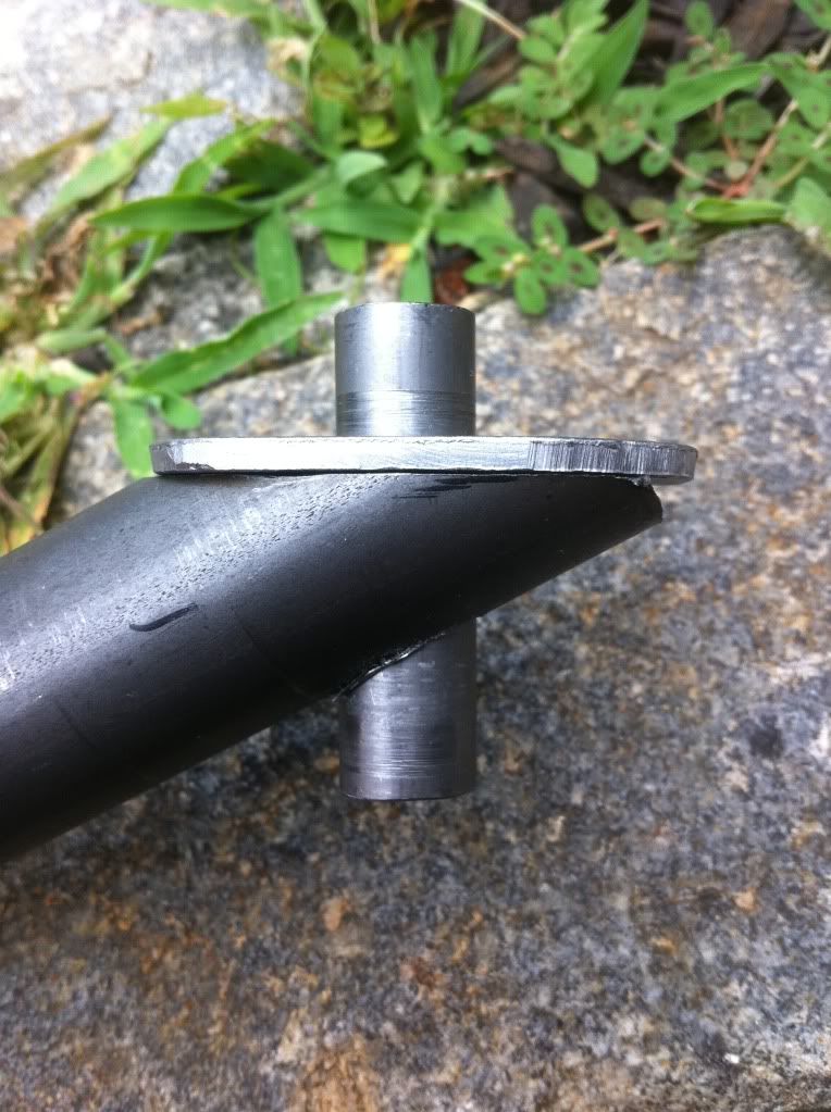

On other topics i have started to make a targa brace. Im constructing it out of 1" .083 wall and 1/2" .065" wall 4130 Tubing as well as some 1/8" plate.
Heres some pics:
Obviously its only about half way done at this point. It will be fully tig welded with bracing and made all pretty when its done.
