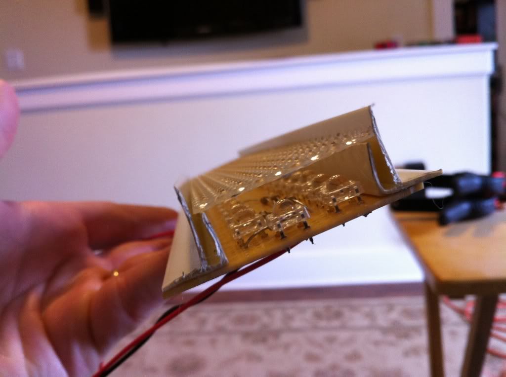

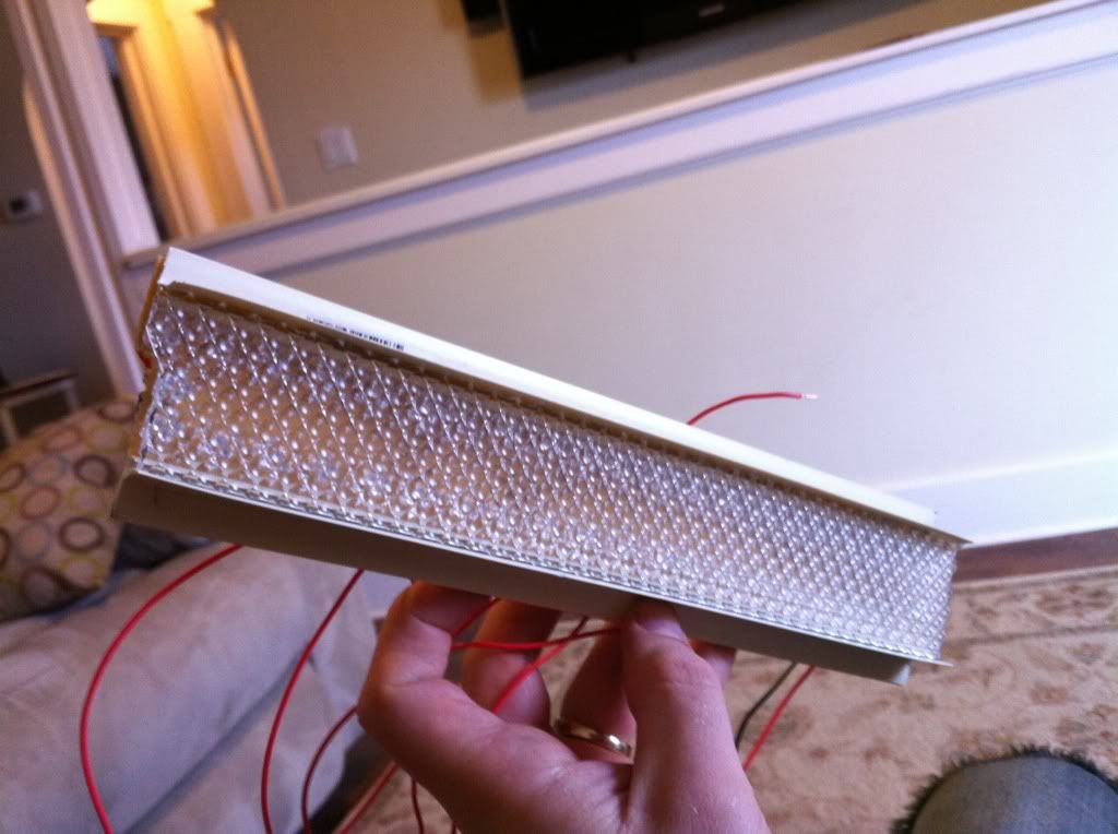

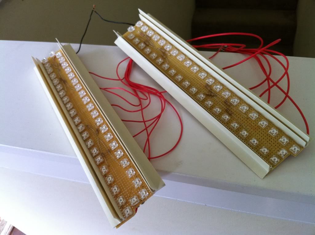

I thought I'd post a few pics of the work so far to keep myself motivated. Progress is slow due to my work schedule and I haven't had time to sit and work on these for quite a while...
These LED housings are designed to do three things:
1. Hold an extra layer of plastic that diffuses the light further
2. Keep the lights at a distance from the lens for extra diffusion
3. Contain any scattered light within the little rectangle so that just the strips are bright, not the entire lens.

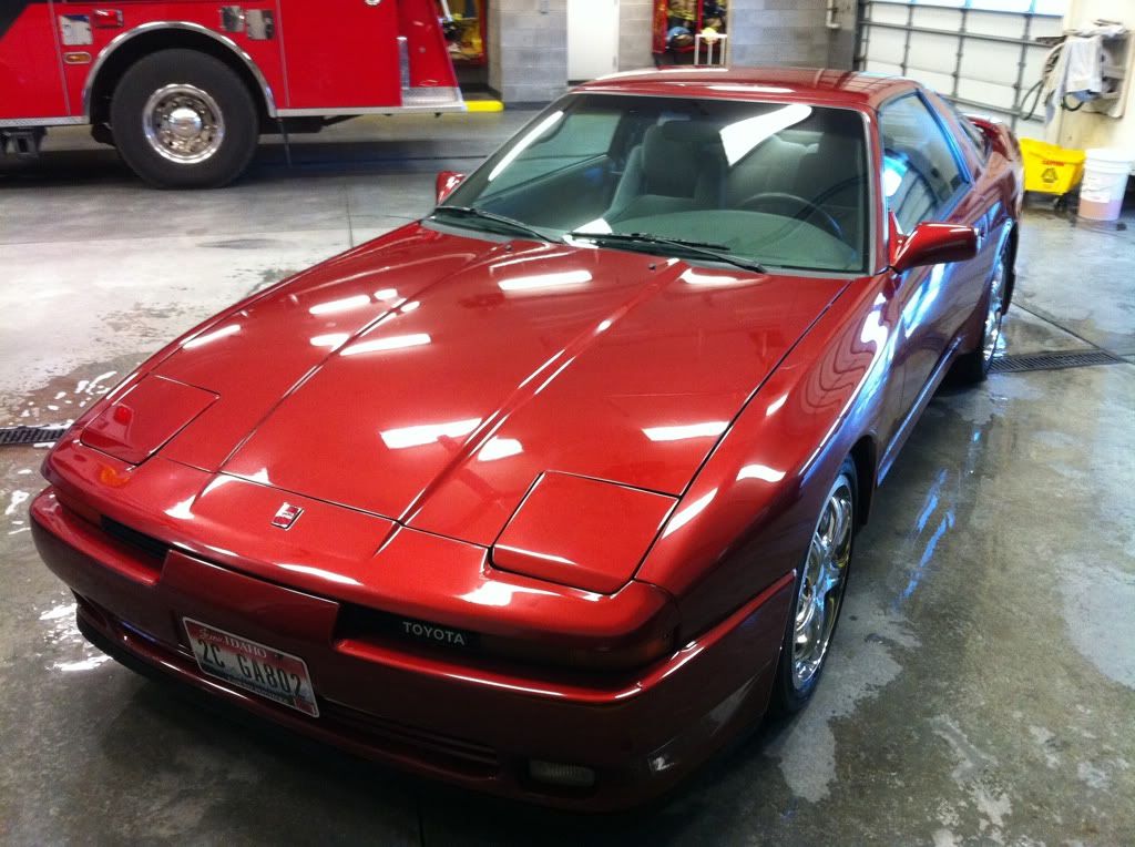

And I have to post a picture of the just washed car...

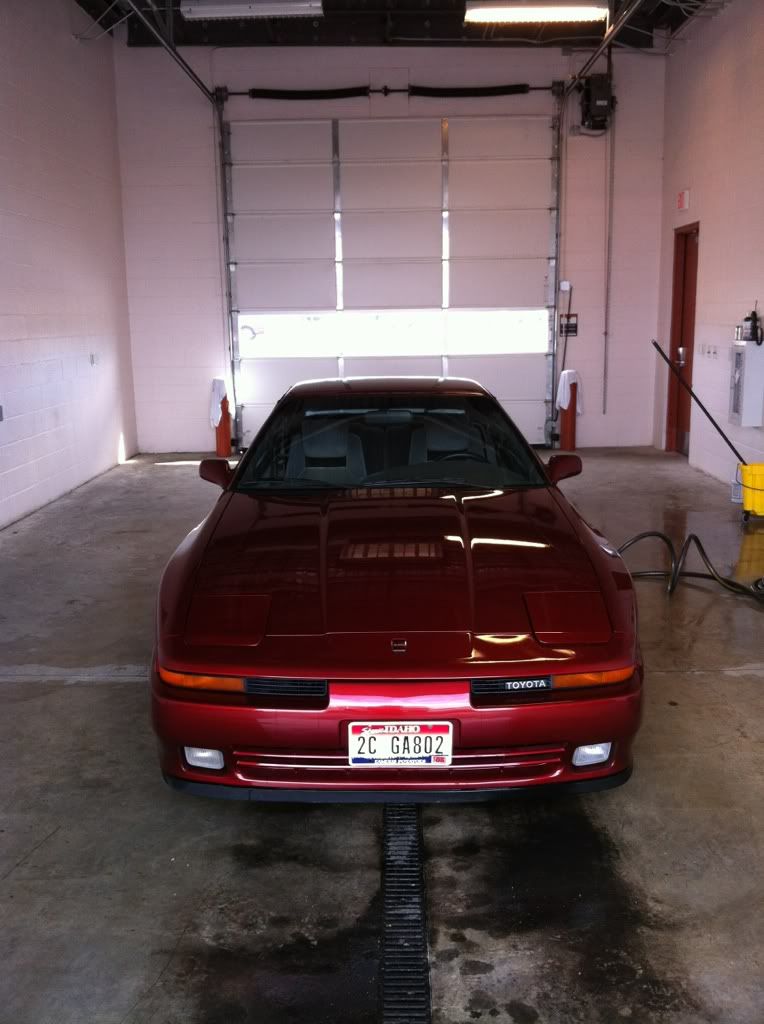

Been super busy lately, but now that the weather's improved I've spent a bit more time on the Supra. Took off the Bomex side skirts and rear bumper and replaced with stock pieces. I like it better now...
