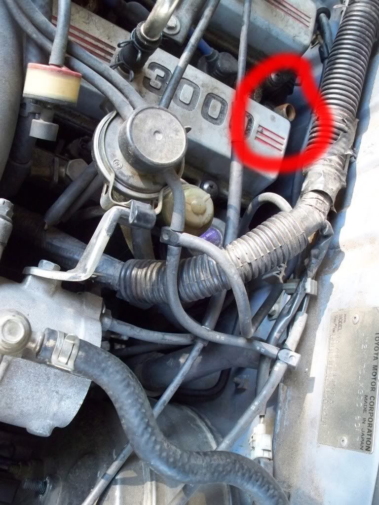

Found the leak it seems to be coming from the top hose that goes to the back of the motor I've had problems with that before but it was just me forgetting to tighten the clamp maybe it needs to be retightened but I rather get a silicone hose for it, do you guys know if they make one to replace it?
It seems to be a heater hose according to the TSRM it says, "To heater" it is the inlet in between the cam covers right above the EGR cooler. I can see water dripping down the turbo side but I cannot see the source.
This isn't my picture but this is where I think it is leaking from circled in red

If it is that small 90 degree hose I am going to murder people because that thing is a MAJOR PAIN IN THE DICK to put on. I will check it out and find the source of the leak tomorrow morning if I have time then order a silicone hose accordingly.

Yup, it is the heater hose I can tell because of where the rust is lol it is annoying that my cooling system is rusty or turns the water into a rust color but it is helpful for spotting leaks especially on the driveway you can see powdered rust if something leaks over night and the water evaporates or something.
