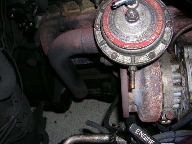

I have a question in regards to my oil leak. I am 98% sure it's from my oil dipstick because when i remove the bolt that holds it to the turbo I can push it in further and I can feel it seat but if I leave it there I can't bolt it to the turbo because the bracket is too low, so I am thinking since I replaced the O ring with an OEM O ring and it still dribbles a little bit of oil. Can I extend the bracket so i can keep the dip stick in place or would that be a bad idea? The reason why I am pretty sure it's the dipstick is because if it was oil filter or turbo oil drain then it would be leaking massively instead of a tiny dribble because those two are pressurized also the splash pattern from what I can see leads me to thinking it's the dipstick as well. So basically I am asking is would it be a good idea to make an extension for the bracket or find another way to stop my leak?

can you bend or slide the mounting tab on the dipstick tube into the appropriate spot to get it to mount correctly? or maybe you have the mounting plate upside down on the turbo?

There is no mounting plate on the turbo it's just a screw hole in the turbo housing, I can't move the mounting plate on the dipstick because it's welded.

Any ideas on how I can fix this dipstick issue? I am leaning toward grinding the bracket on the dipstick so I can push it into the block for it to seat and bolt it to the turbo but I want to have that as a last resort because obviously something is not quite right since I did not have this issue before.

seeing as the metal doesnt shrink or extend under its own power
i would have to say crawl under there and get a bird eye view of the alignment
im just confused on your problem
dipstick tube slide into block, then bolts to side of turbo
not trying to be a dick but you should try and fix it on your own
i mean its only a metal tube :)
