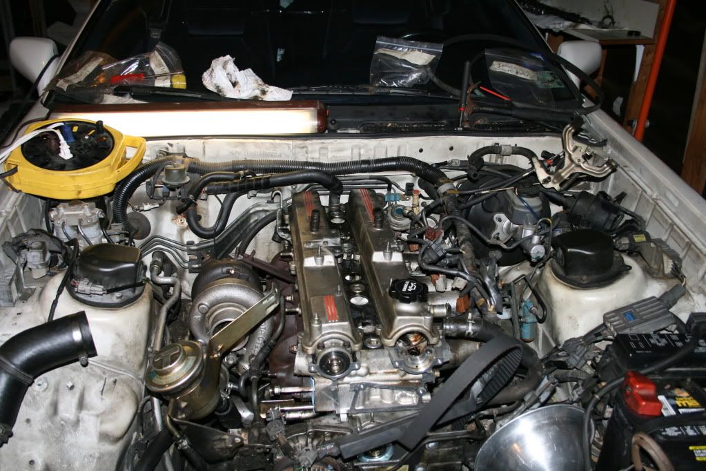

I may need help figuring out the harness especially on the intake side if I can't find it in the TSRM but posting up pictures helps me a lot.
Here is how the car sits now

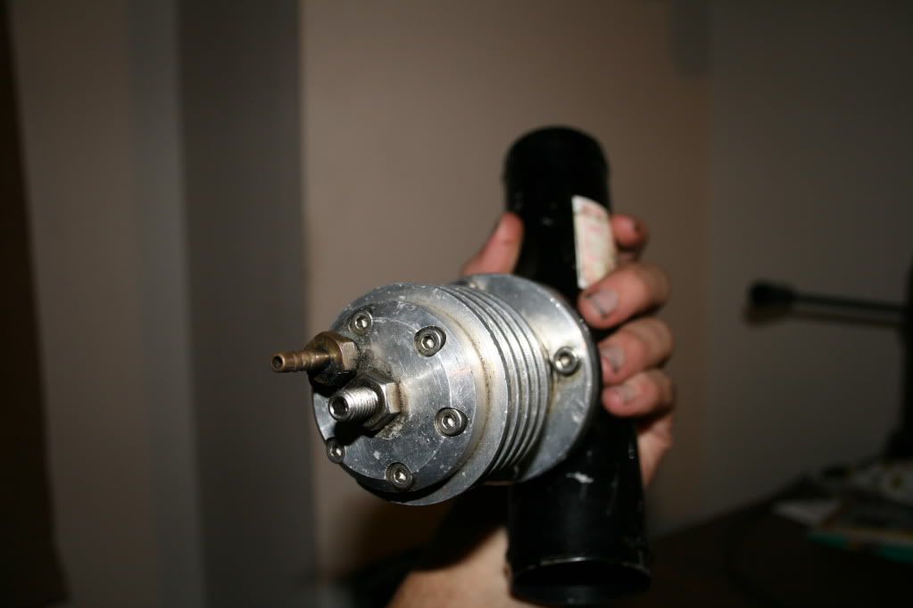

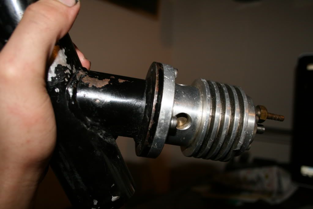

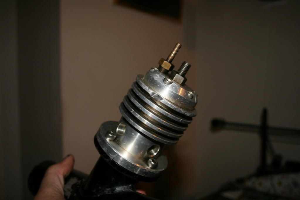

A friend of mine gave me a blow off valve since he found it but we don't know what exactly it is lol, does anyone here know?
Apparently it's a TBO blow off valve

FWIW that hose shaded in gray is a 16mm (5/8") coolant hose. I ended up bypassing the whole Toyota rubber thing and bought a silicone variant from here http://www.dphsiliconehose.co.uk/index.php?route=product/product&product_id=51 in a vintage black finish that I can't find on their site anymore. I've had it off and on maybe five times in the past two years and its still pliant and good as new, even being doused in oil/coolant/water from time to time.
For being in GB it got to my house in under a week, I was surprised.
That's also the same hose you can use on the back of the head, I need to buy another one...
