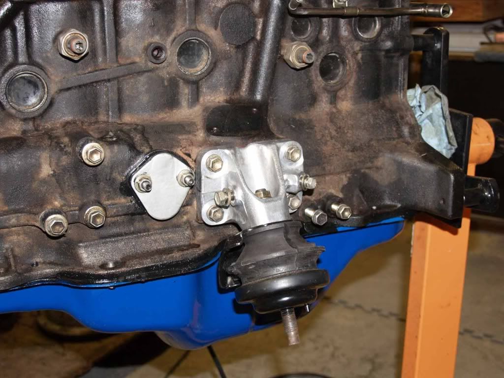

The other thing I decided to do was mount up the new motor mounts.
Compliments of Fred! :)

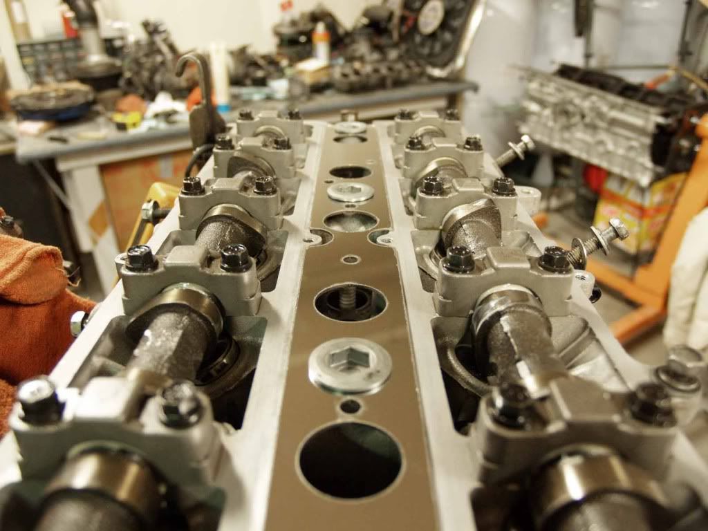

I accomplished a few other things today as well. I got all the paint stripped off my valve covers using some spray on paint stripper. It worked great!

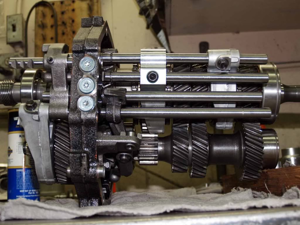

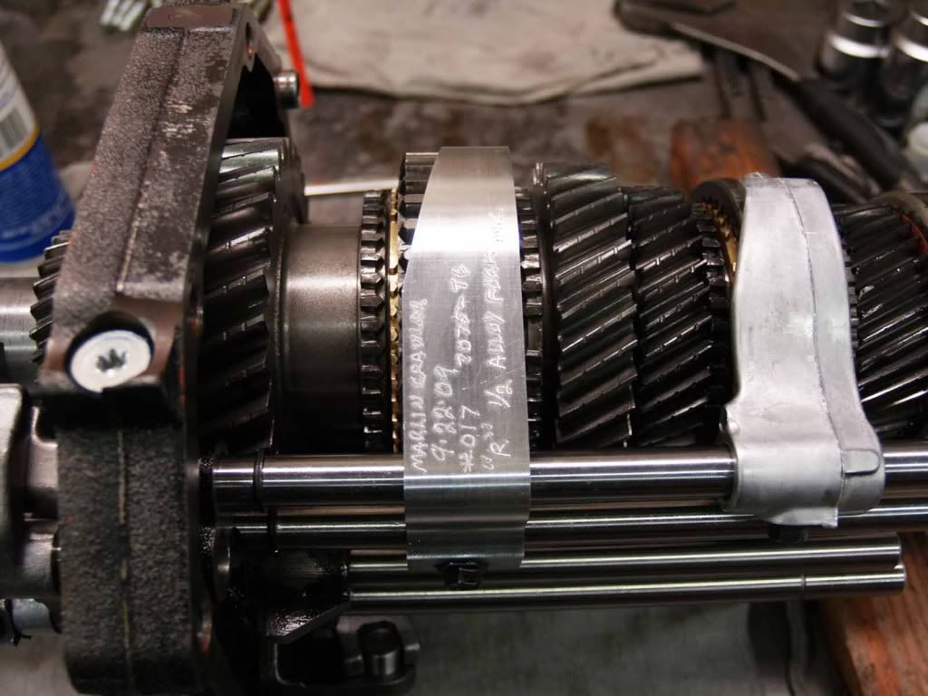

My buddy called me today and told me to come down and take my last look of the tranny opened up because he's going to button it up tomorrow!

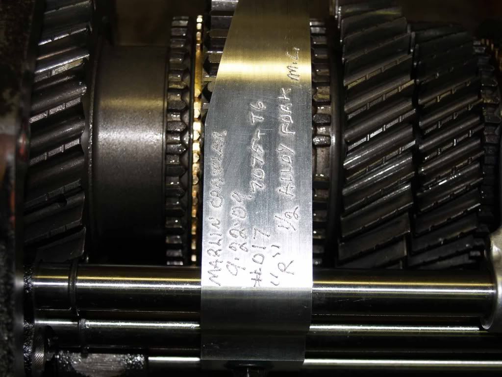

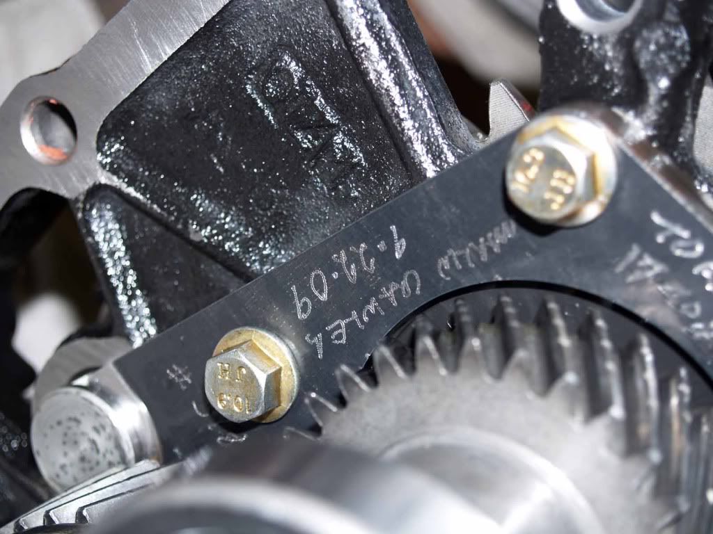

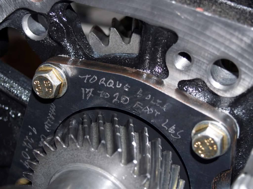

Here are pics of the Marlin Crawler Chromolly Bearing Plate installed. Take note to the engraving. If someone tells you they've got a MC Bearing Plate and it doesn't have engraving like this on it, they're wrong...

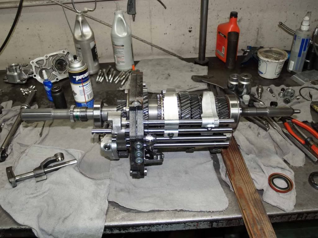

The same thing goes for the shift fork. Here is an MC 7071 Billet Aluminum 1 to 2 shift fork. Mmmmm.....looks pretty! :)
And here you can see a comparison between the Marlin Crawler and the stocker...
And here's a full assembly shot...

Man that's a beautiful site to behold. Good for you, those parts look great and should make a difference. Keep up the great work you're doing, I use your build a lot for site references.
-Fred

Thanks Fred! Yeah, it does look pretty cool. He told me that it was a good thing to take the extra step and replace the needle bearings. Before rebuild measurements were on the border of spec on the loose end. After all new parts along with the needle bearings I had to get from Toyota, all measurements were right in the middle of Toyota Spec. So if/when you rebuild yours, go the extra mile and have the needle bearings replaced.

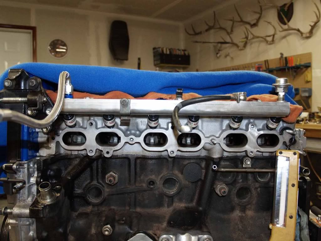

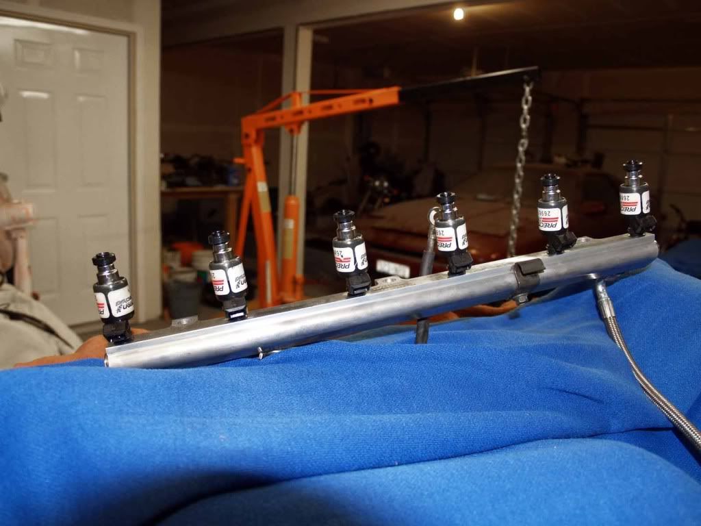

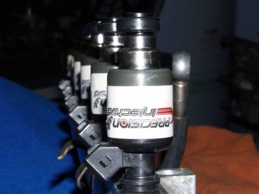

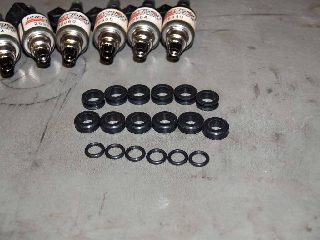

Here are some injector goodies that arrived from Driftmotion. (not the injectors, just the o'rings and insulators)
And here they are installed in the rail and eventually on to the head.

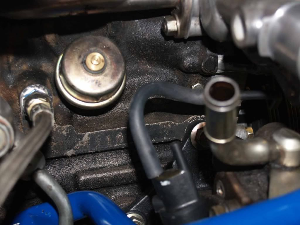

Then I busted a knuckle pretty good so I decided to end the evening by replacing part of the power steering 'up' idle vac line.

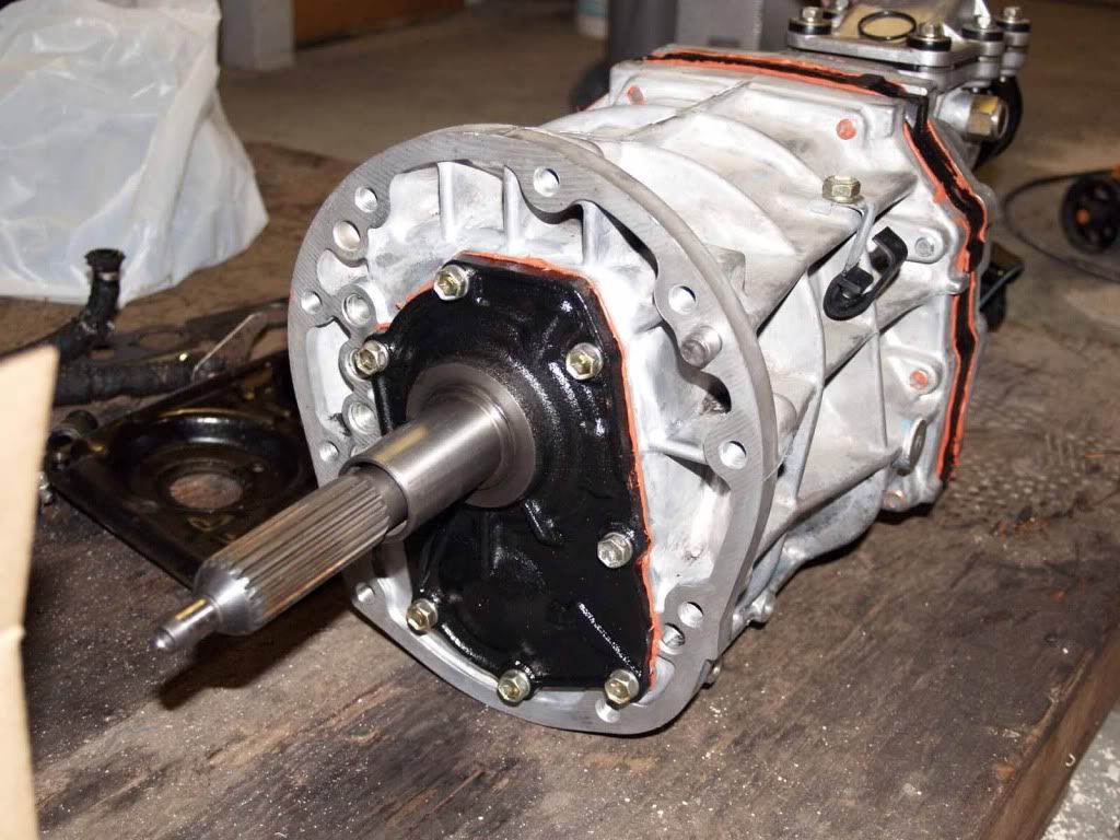

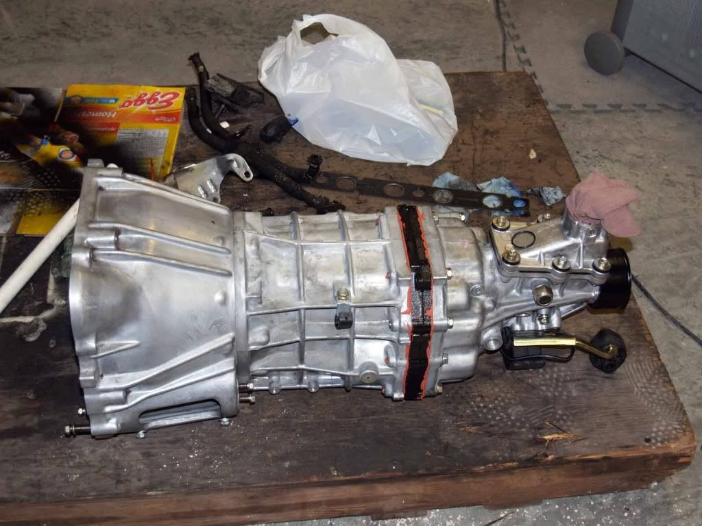

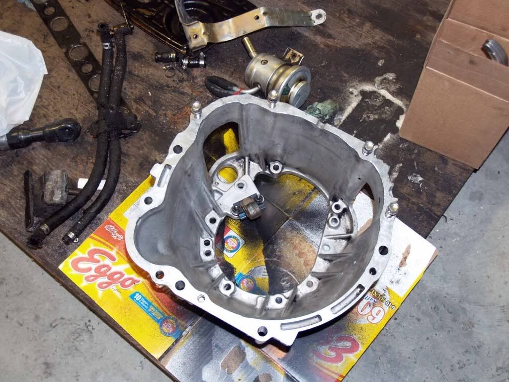

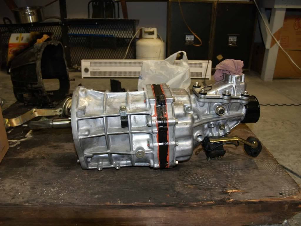

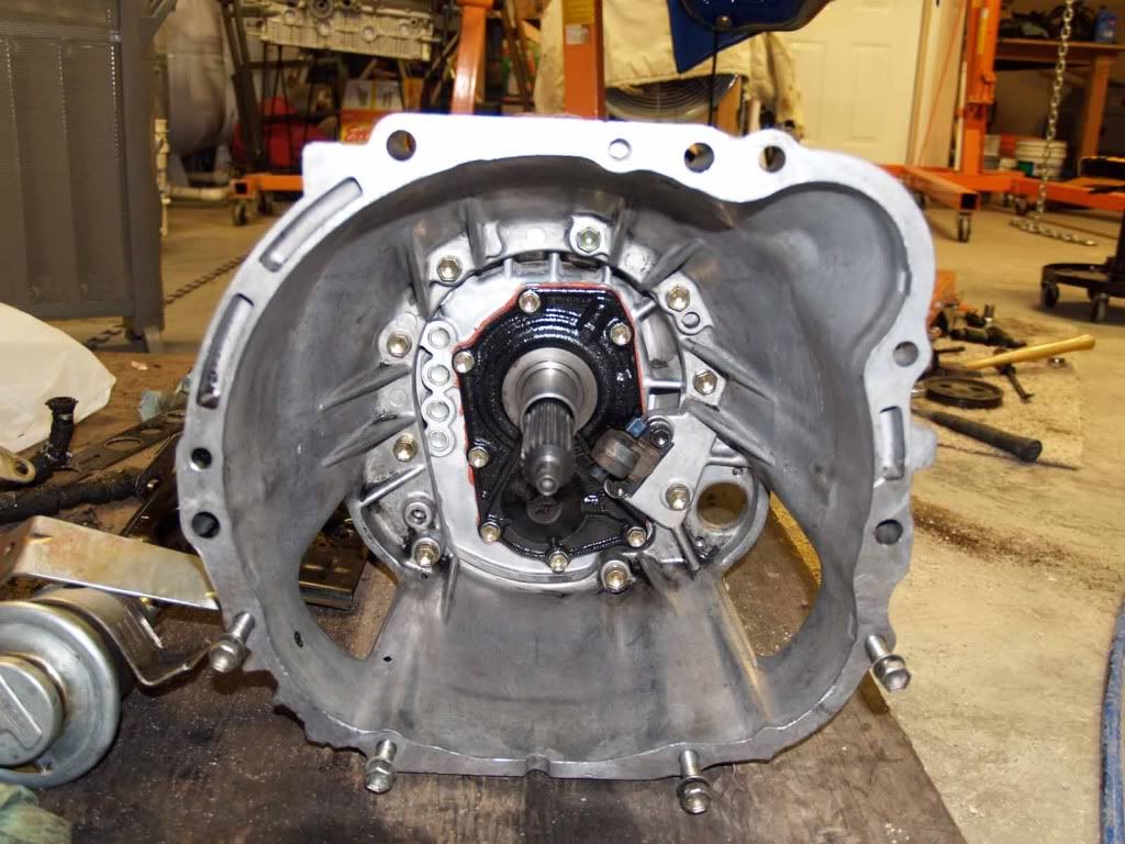

Ok. Exciting stuff today. I went and picked up my tranny! Here she is all Marlin Crawler'd up! :)
And yes...that's FIPG Orange!

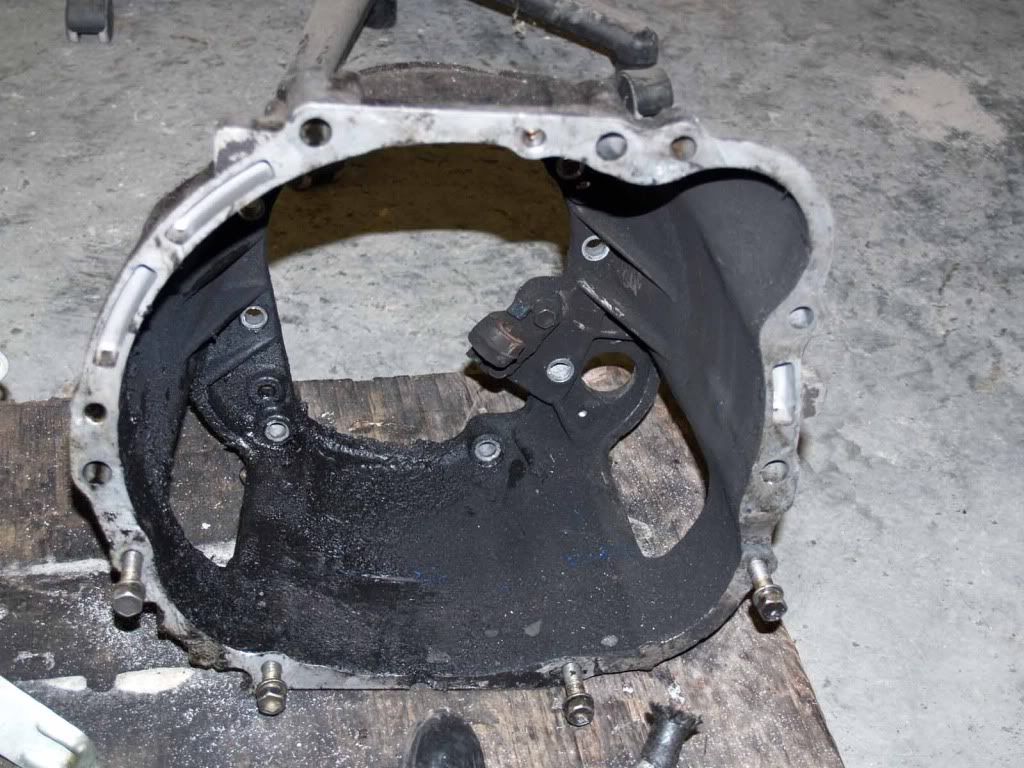

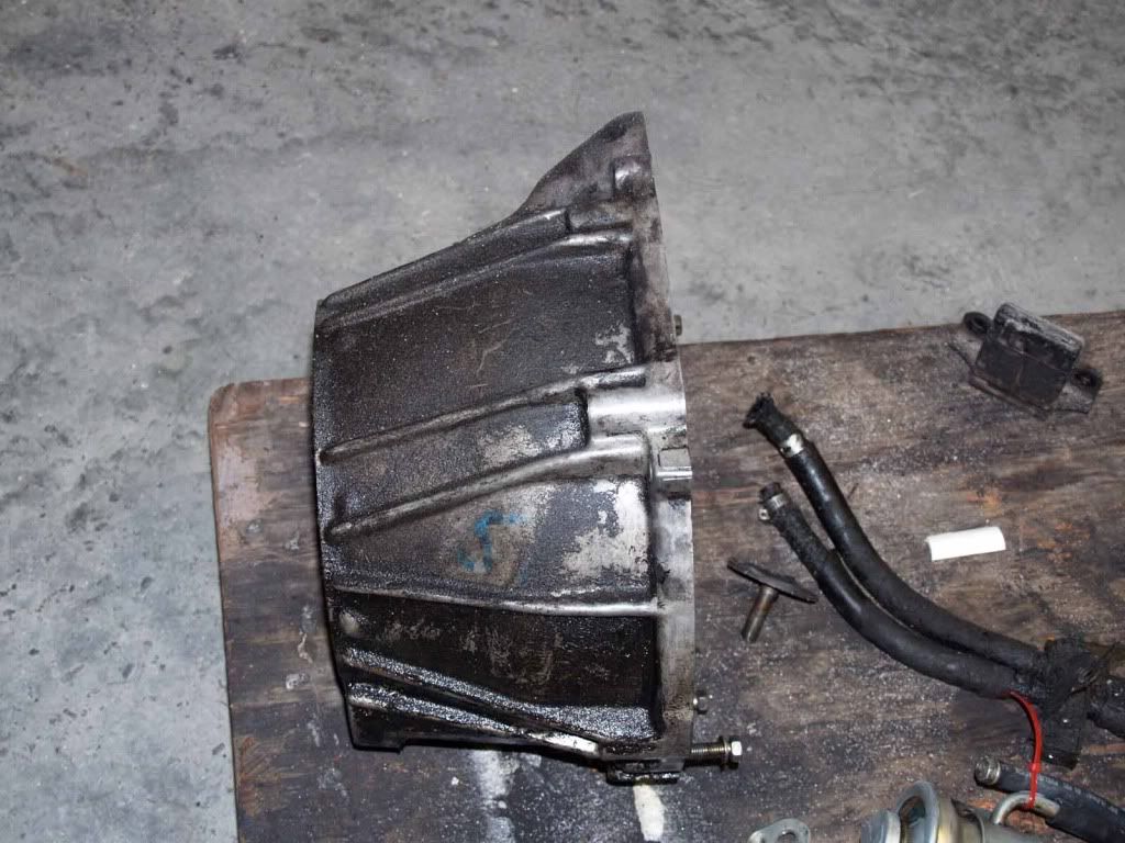

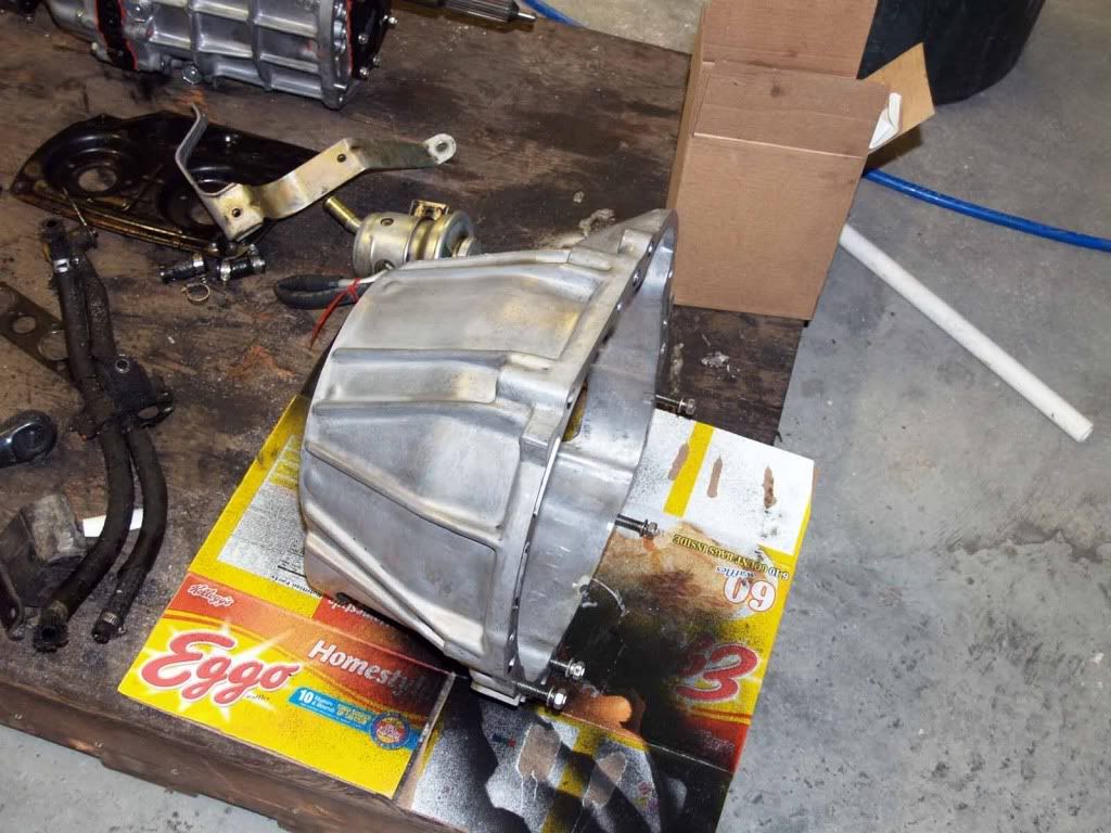

I then got motivated to clean this pig.

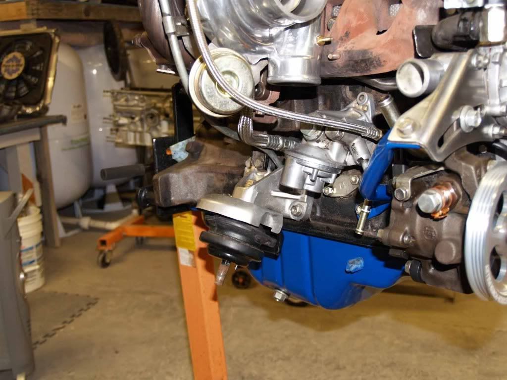

Then I mounted her up!
