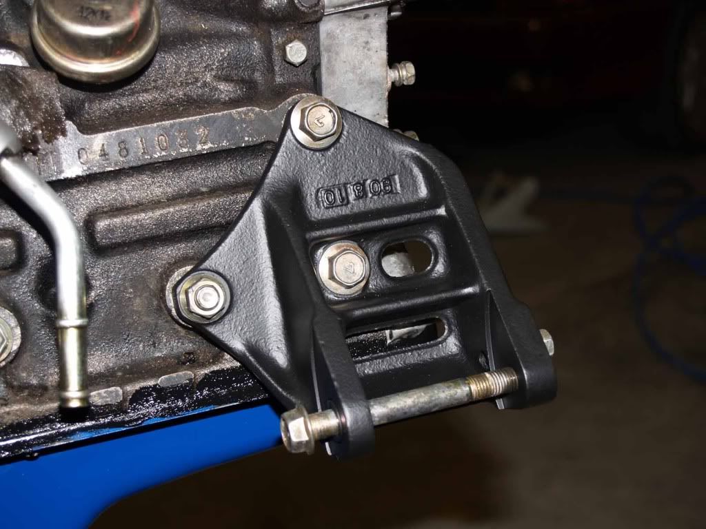

Tonight was mainly just a cleaning night. I got a lot of brackets, braces, and such cleaned up. I also sprayed the block down with Gunk and Brake Clean. Yep, it removed everything including the paint. Oh well...at least it's clean now... :)

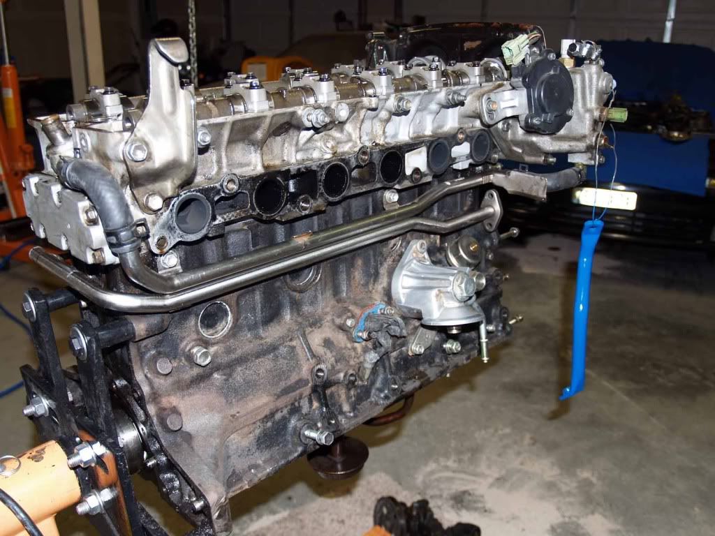

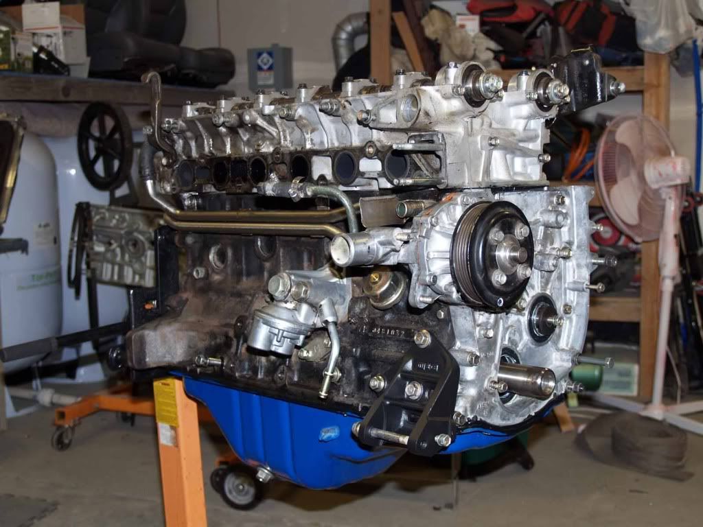

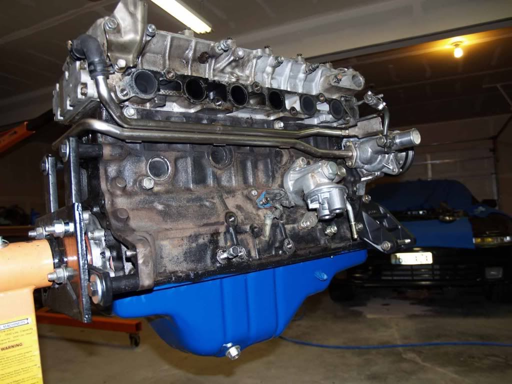

At this point, she's starting to look more like a complete engine again.
The rear main seal is in along with the rear timing cover seals. Everything has been torq'd to TSRM Spec and Toyota FIPG used.
Here's a couple shots showing off the newly painted oil pan. You may notice that it's a different shade of blue than in the previous pics. After seeing what 'Ford Blue' looked like, I decided to repaint it 'Old Ford Blue'. It's a bit darker. Me likes better!

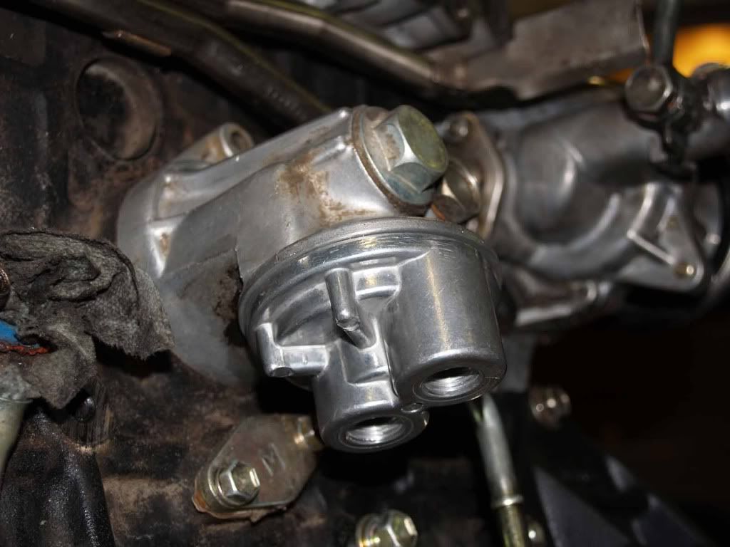

Here's a shot of the Oil Filter Relocation Flange.
I haven't decided where I'm going to mount the filter yet though.

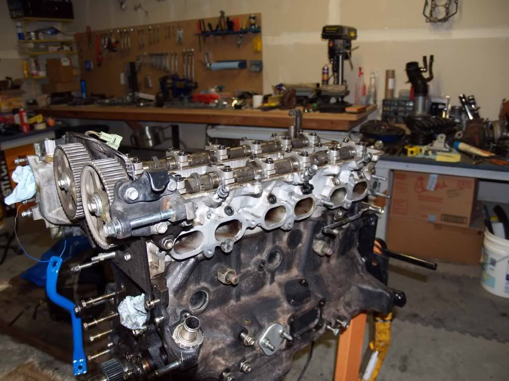

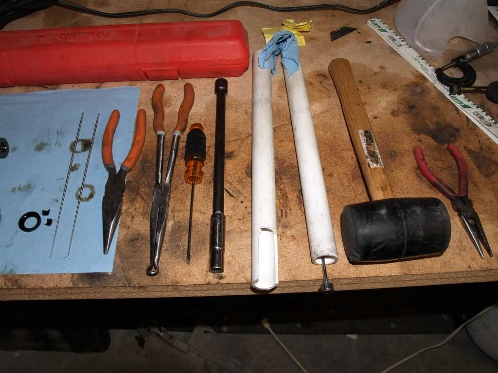

I got the center galley and the cams out. Getting ready to tackle the valve stem seals.
Here's the tool arsenal I chose for the job.

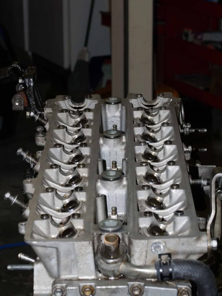

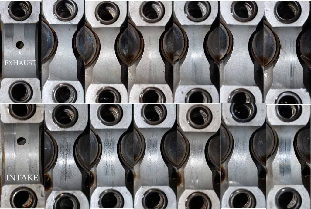

Here's a shot of all my cam saddles. This is after only around 6k miles. Not too bad; but, worse than I'd hoped to see.

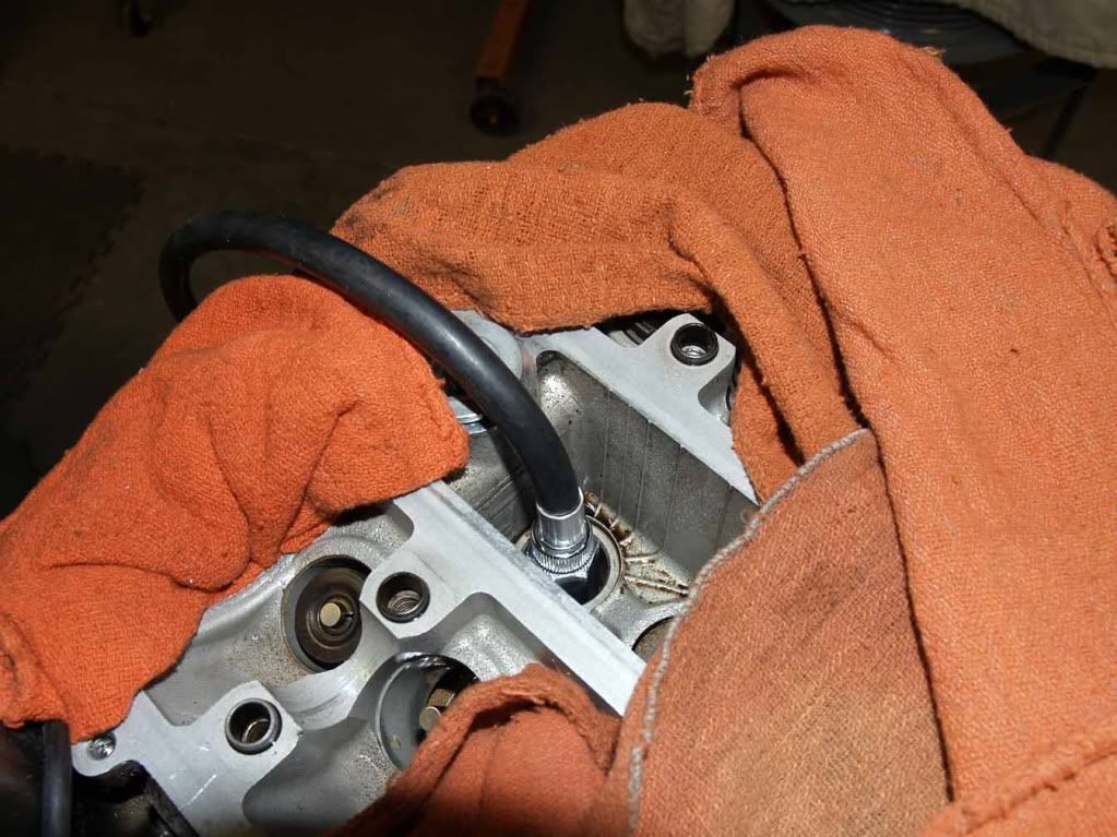

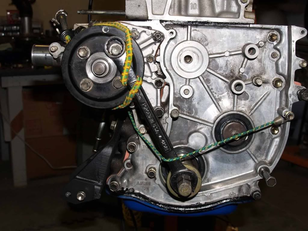

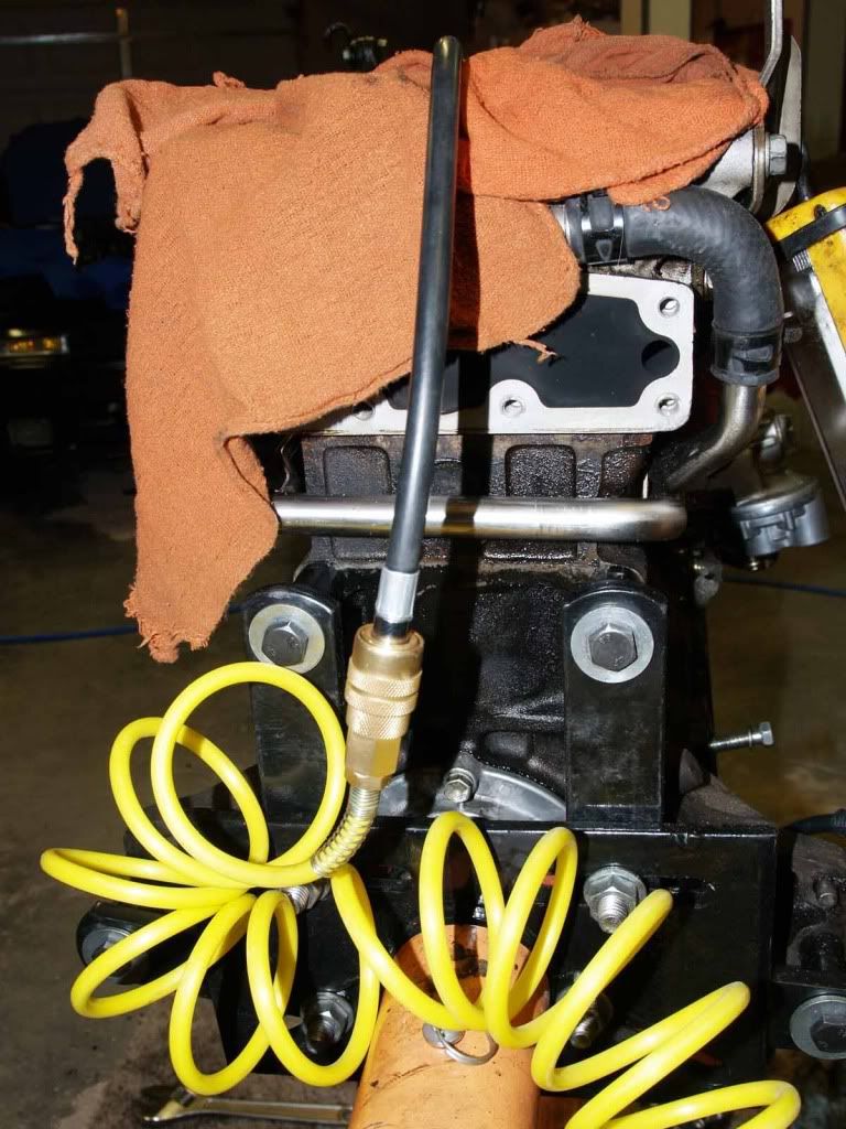

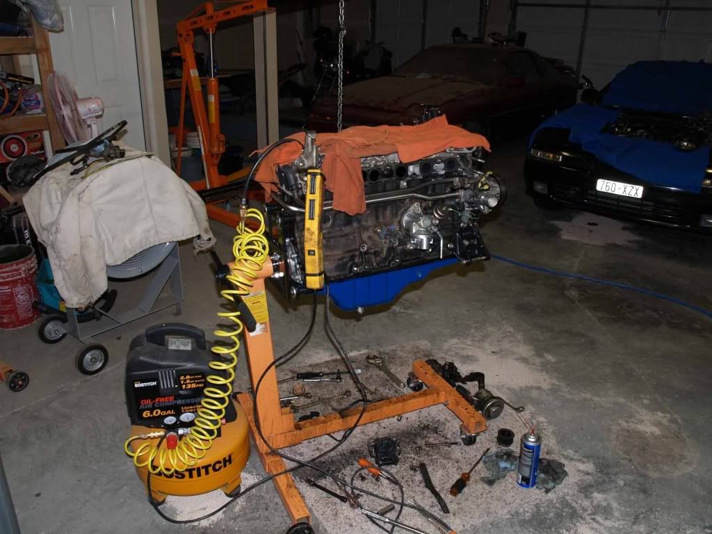

Here's setup to the block. I chose to use air instead of rope.
I set the cylinder that I was working on to TDC then secured the rotating assembly with a wrench so it wouldn't rotate and suck in a valve.
Using a hose from my compression tester kit, I pressurized each cylinder to ~30psi to keep the valves from falling in to the combustion chamber.

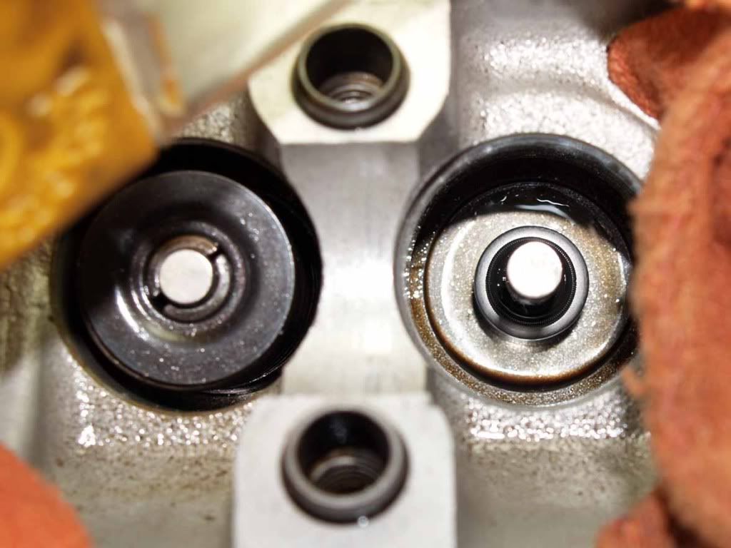

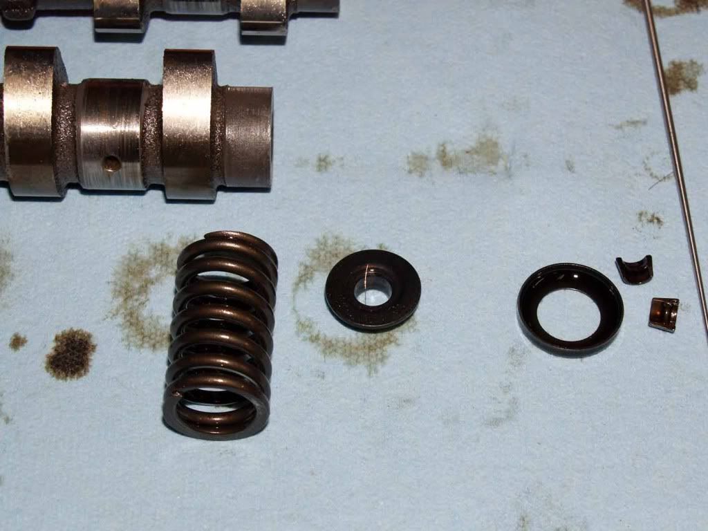

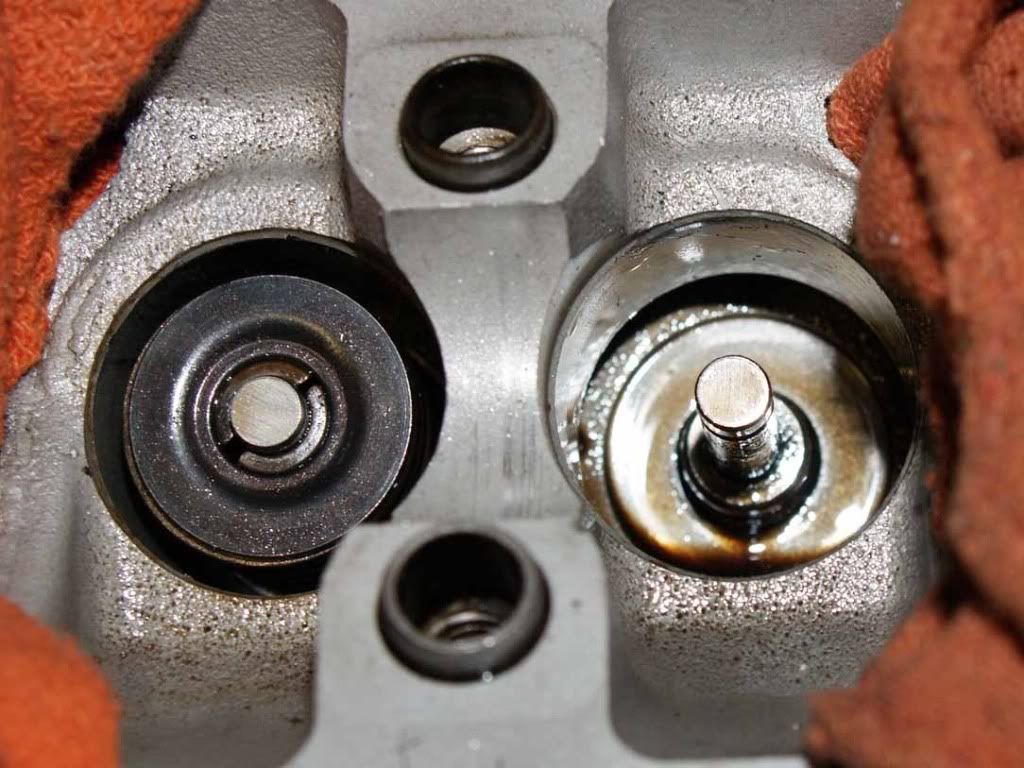

Everything worked like a champ!
Here's a disassembled upper valve assembly. Note the two small keepers on the right. Don't lose those!

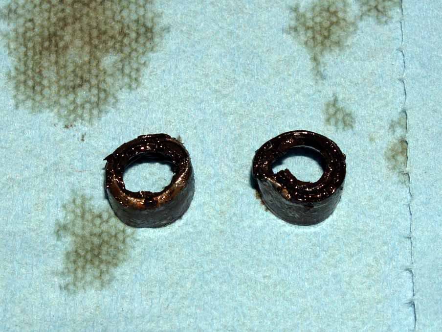

Here's a nasty old valve stem seal.
Here's a new valve stem seal installed.
