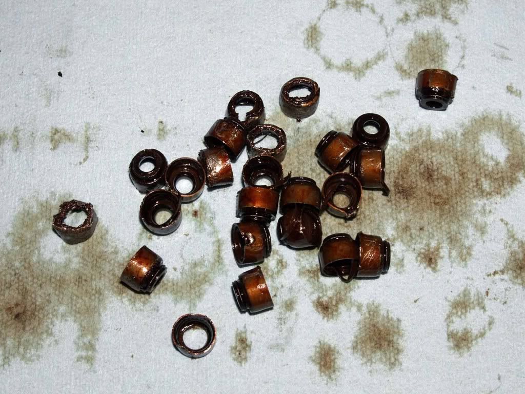

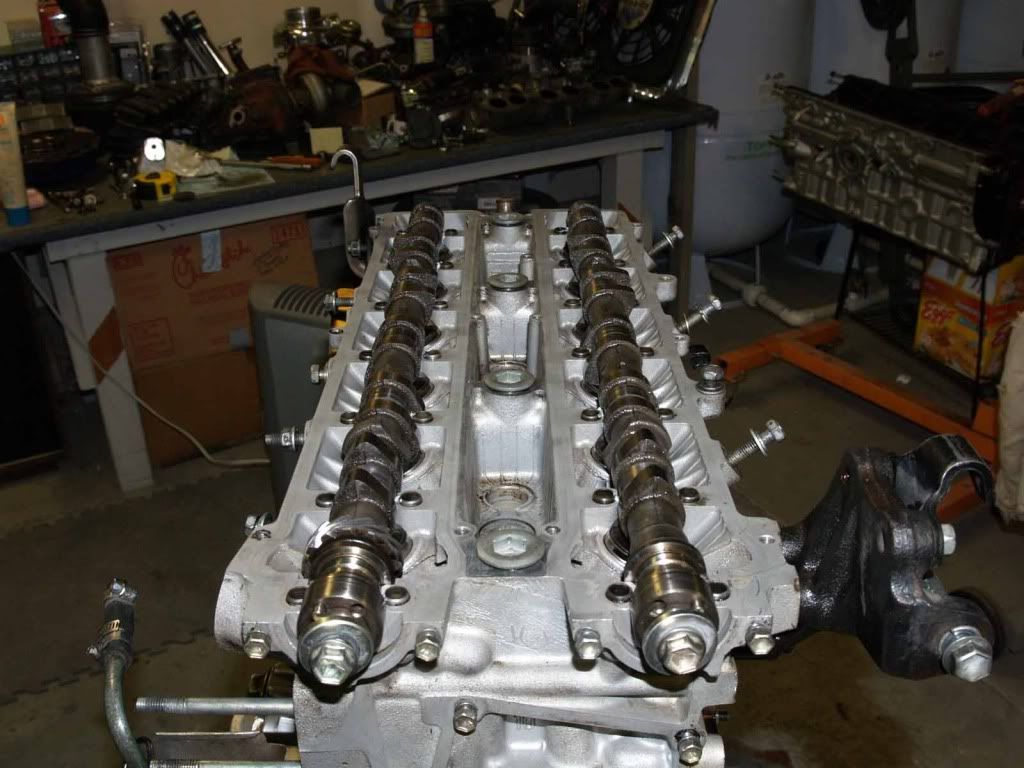

Finally got done with the valve stem seals. That job is by far my least favorite to do. It has also been the single most time consuming part of this build so far.
I HATED EVERY BIT OF IT!!!!
Here's 10+ year old valve stem seal carnage...

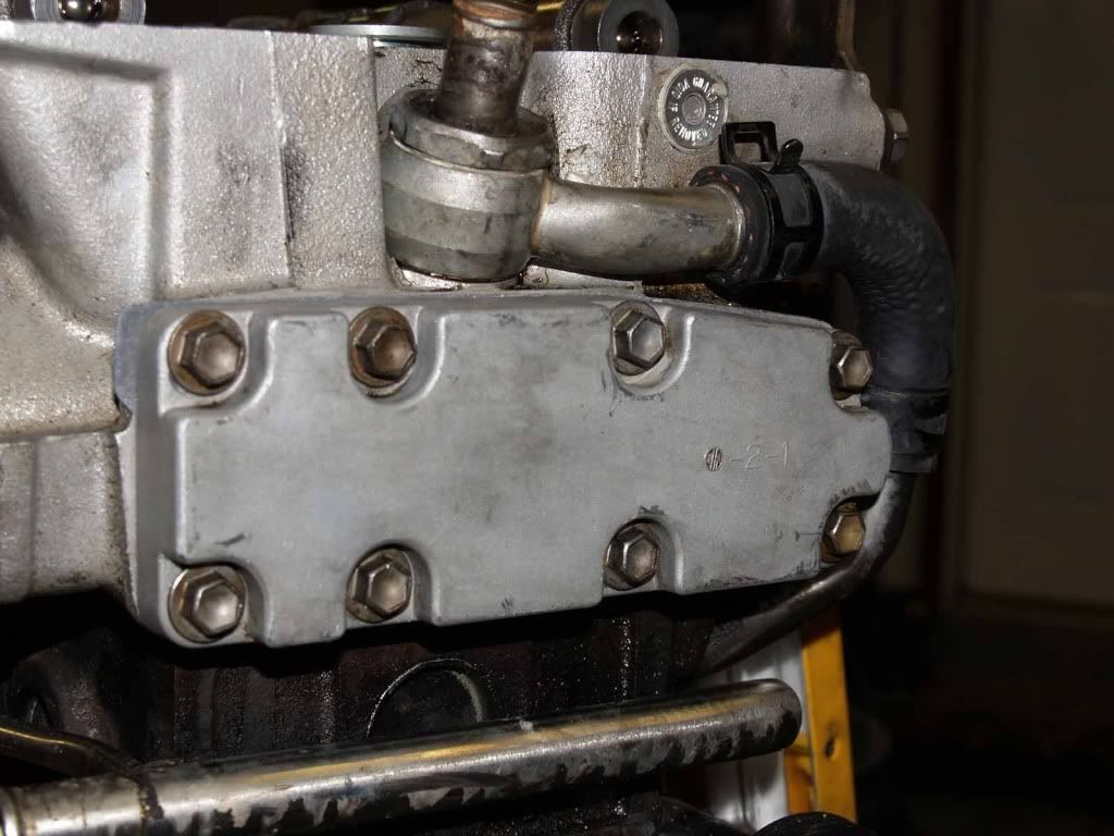

I decided to replace the EGR Cooler Gasket. Good thing too! There wasn't one there at all! :aigo: Whoever rebuilt this head needs to be punched in the neck!
And here's where I stopped for the evening. The cam saddles have all been lubed and the cams are set in place awaiting caps and torque. I'll try to finish this part up later tonight. We'll see...

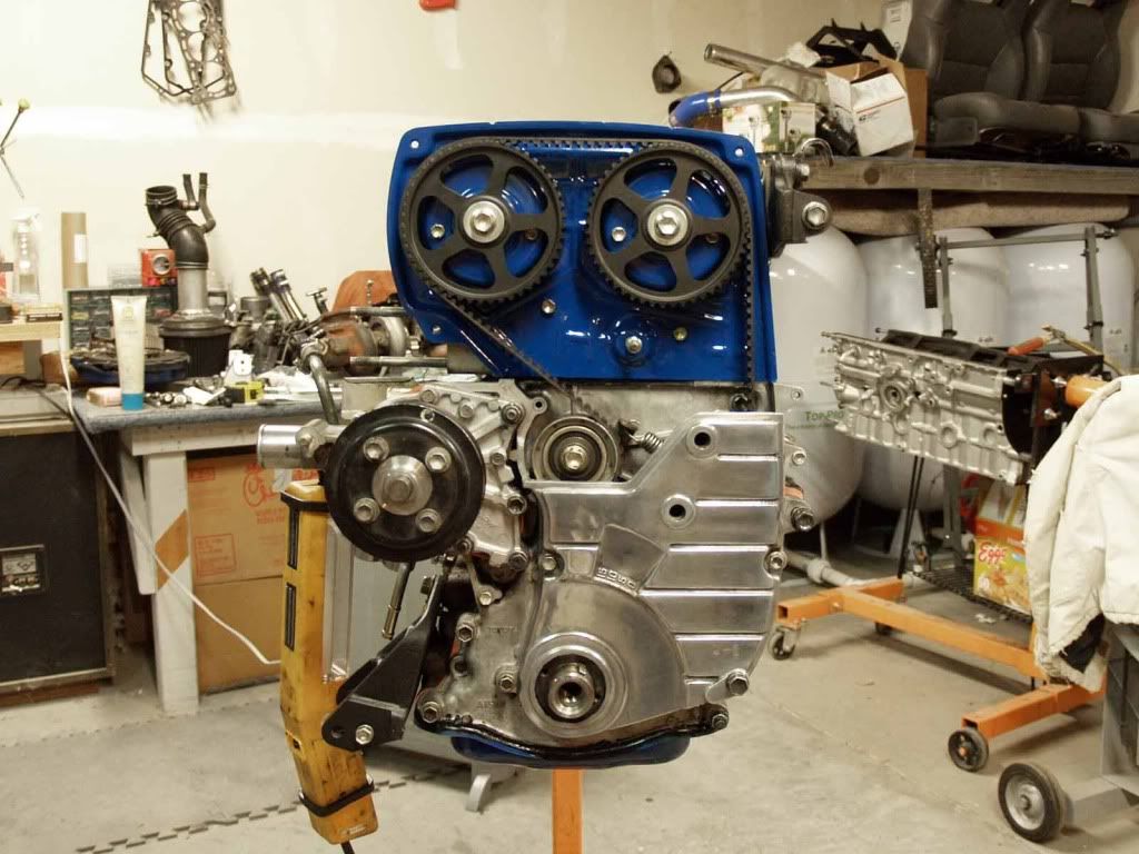

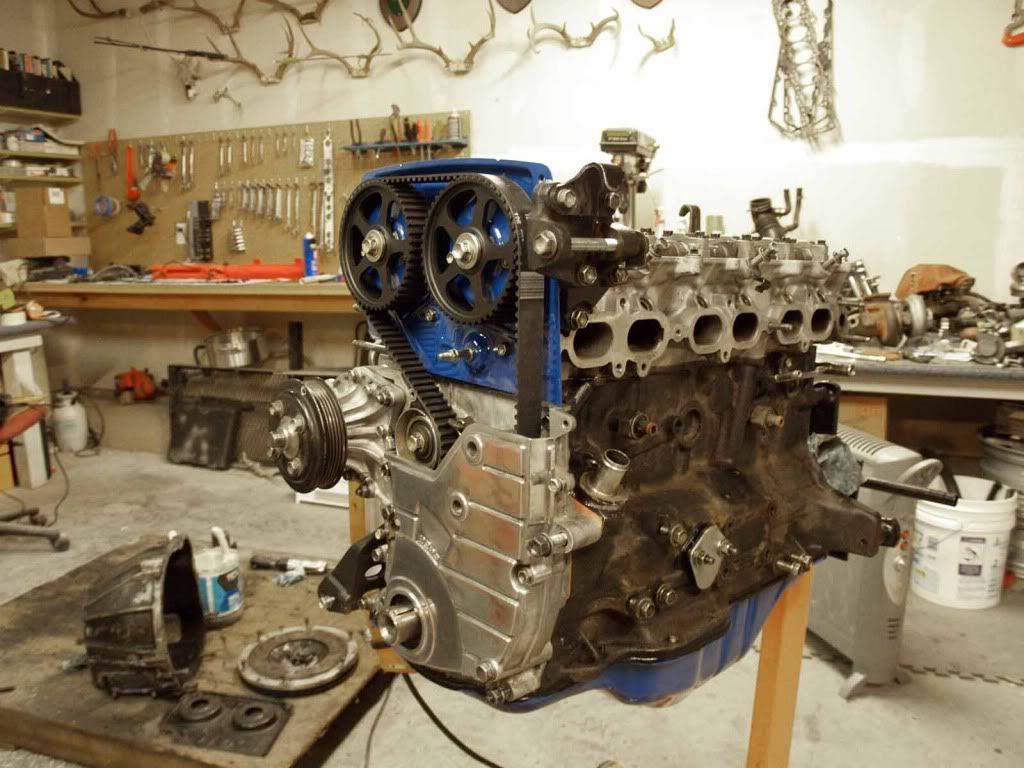

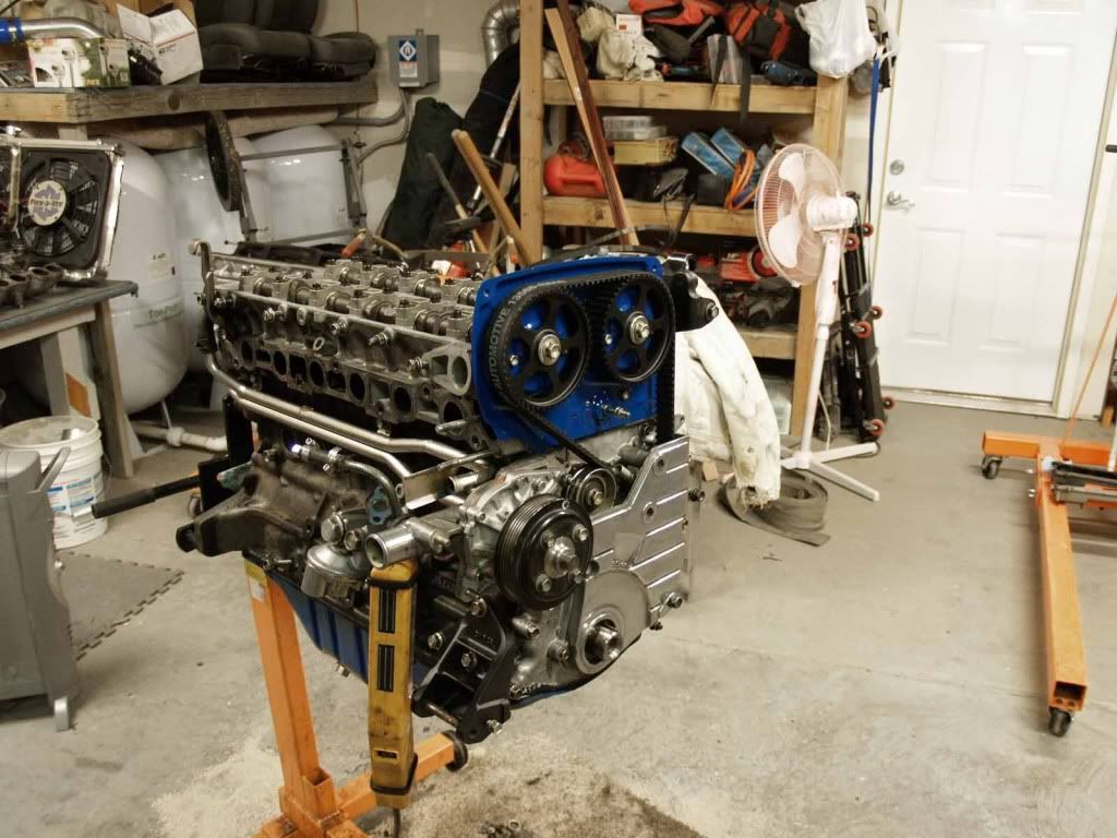

Today, things are starting to look pretty good. I got the cams torq'd in and most of the front portion of the motor assembled.
Take special note to my newly painted rear cam cover, cam gears (I still have to mark the timing marks in white), and polished lower timing cover.
I still haven't decided whether to paint the water pump pulley in blue or flat black....

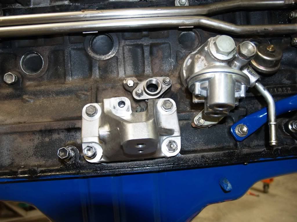

Here's a motor mount bracket all cleaned up. I didn't know they were aluminum. It's amazing how different things look cleaned up!

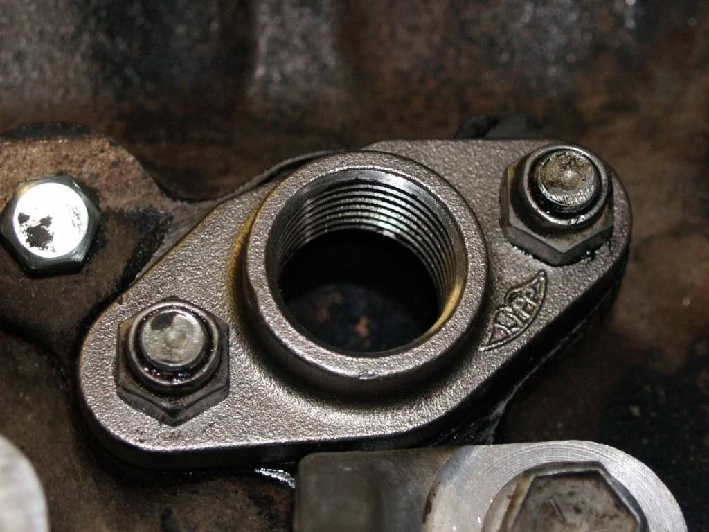

Here's a LIPP soft line turbo return flange.

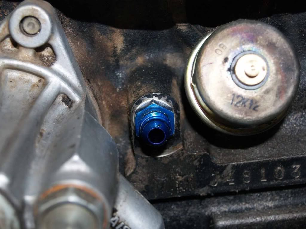

And here's the turbo oil feed fitting.

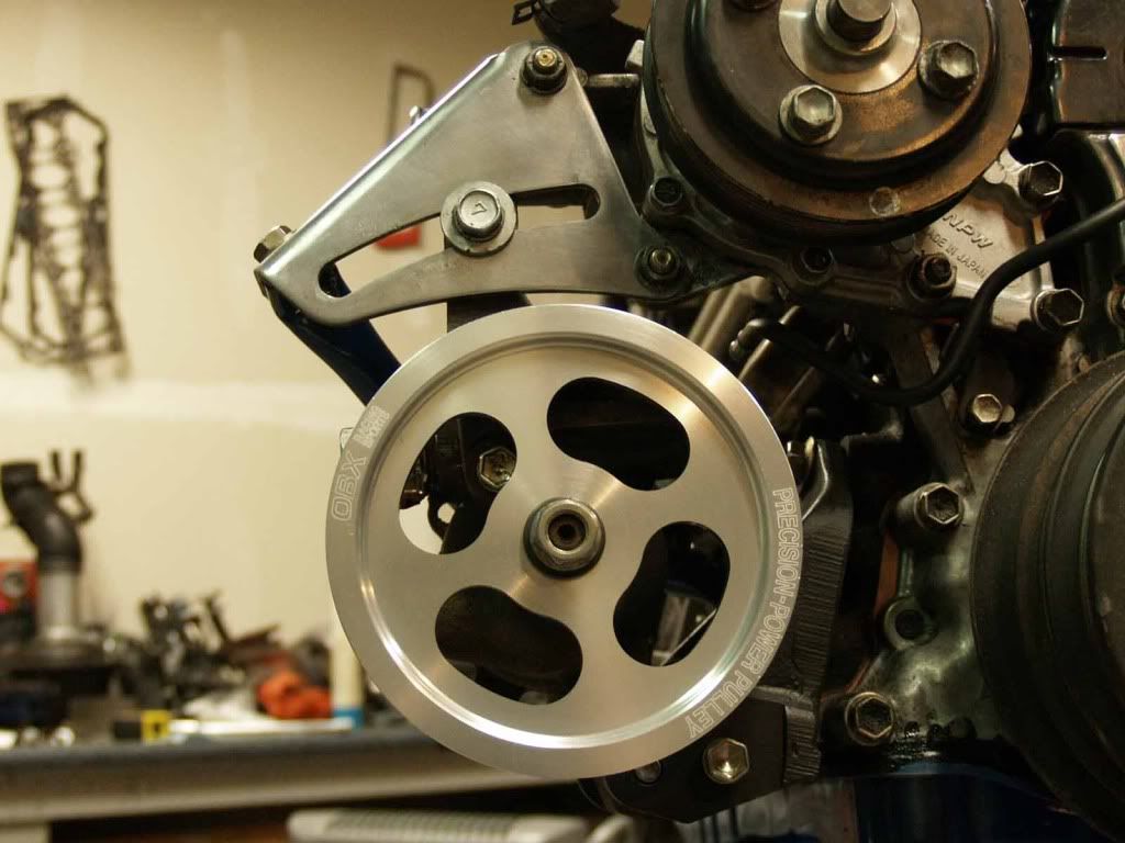

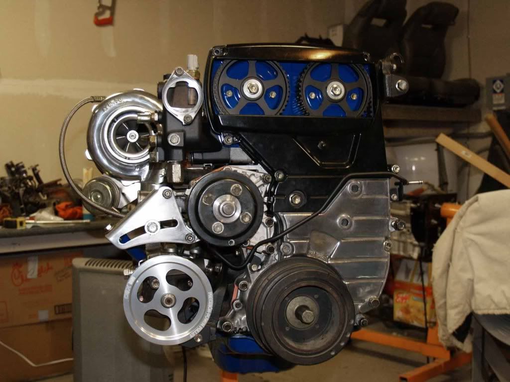

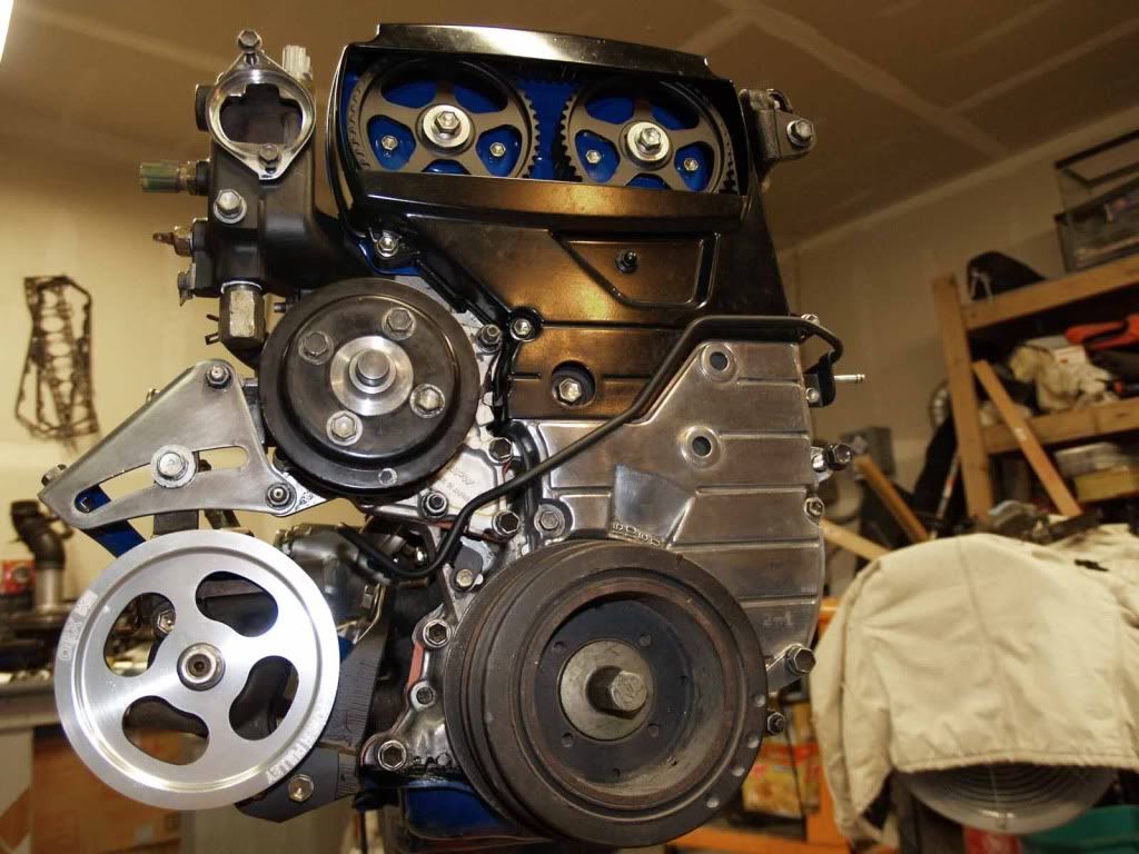

Here's my new OBX Power Steering Pump Pulley. Also note, the power steering bracket that I "semi-polished". Hopefully it won't rust too quickly!

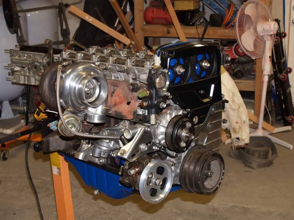

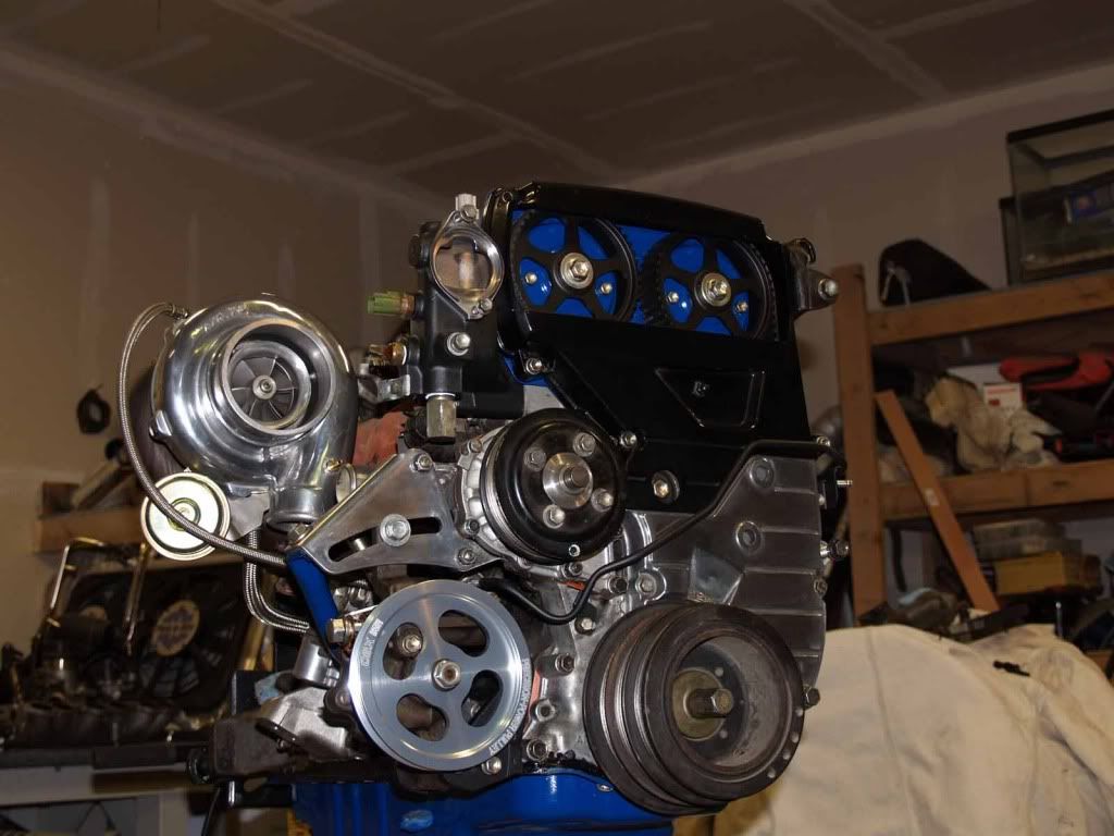

This pic shows the whole front and if you look in the upper left corner, you'll see a flat black thermostat housing and flat black power steering hard vac line across the front.
I also got the new upper timing cover on. Thanks Fred! :)
At this point, things are looking pertty....

Looks very good! Glad to see you put the shop rags to use, you should be getting some more this week. Let me know about the ATI, it 's a good add.
Happy New Year!
-Fred

Looking good Kenny, I like the rear timing cover being painted.

Thanks! The color is Rust-Oleum "Old Ford Blue".

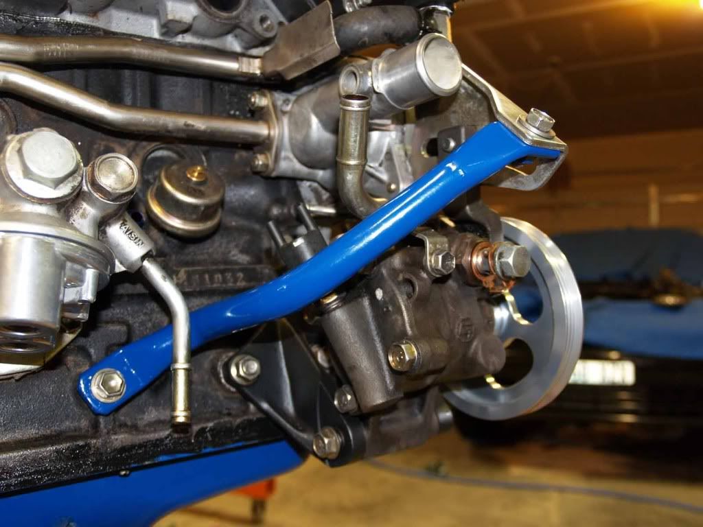

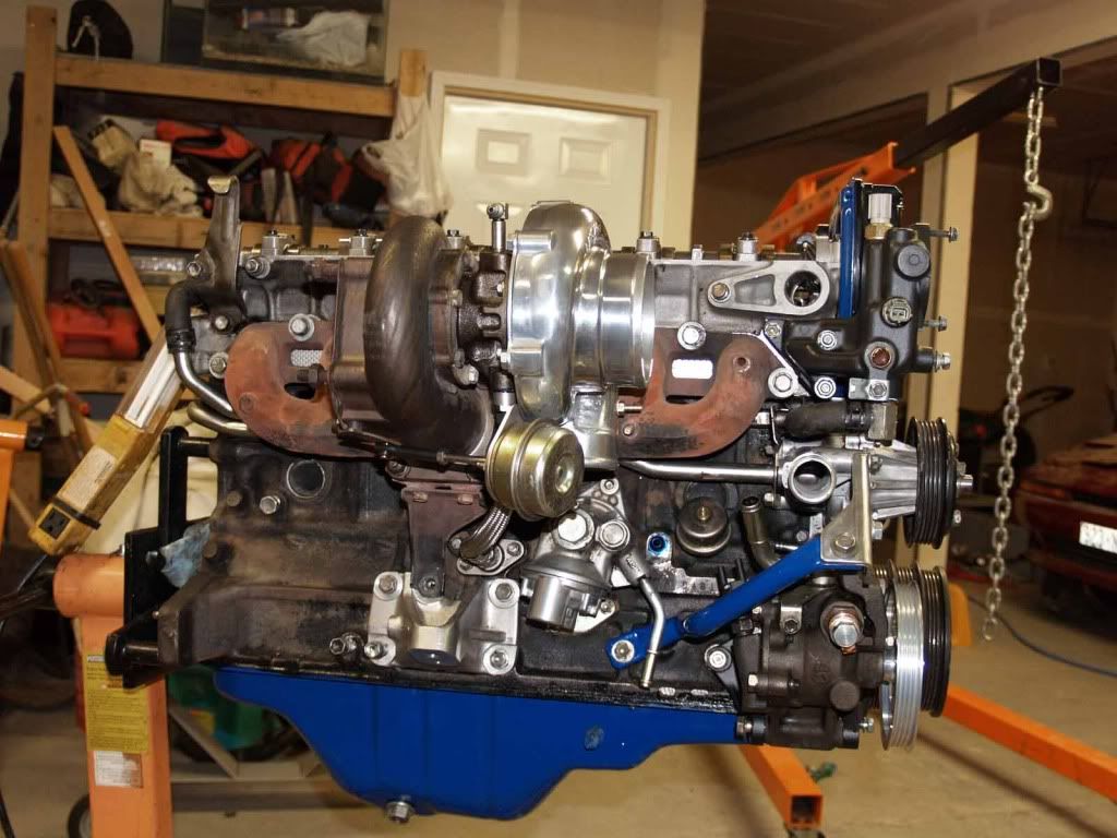

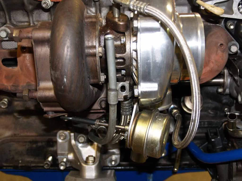

Ok. My first hitch in the giddy up.
The new turbo has no mount for the dip stick tube.
So, I had to fab something up. I decided to use some aluminum bar stock I had laying around. The brace clears everything just fine and is quite sturdy.
