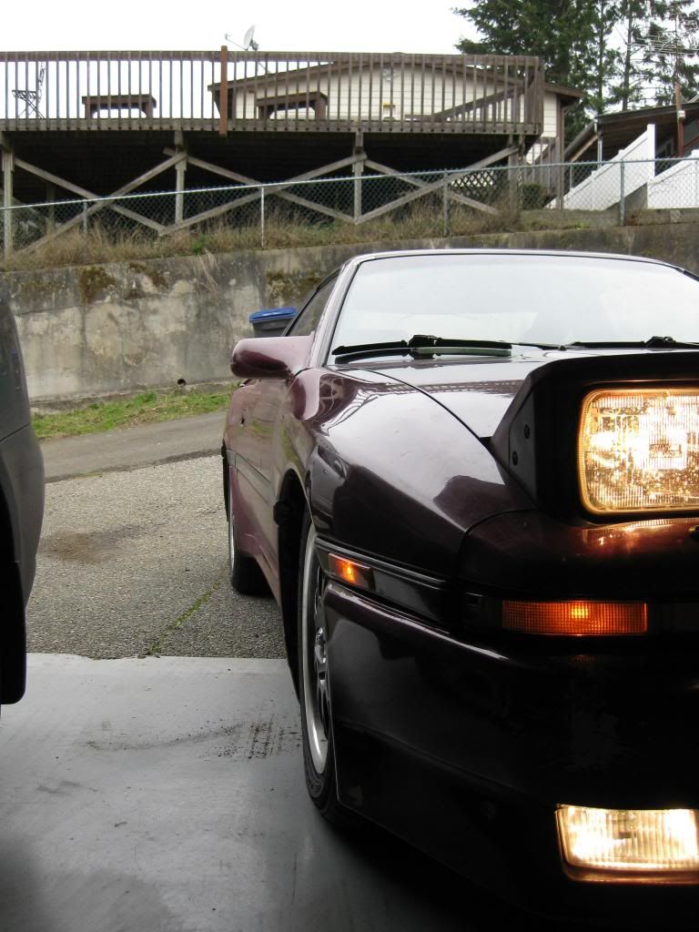

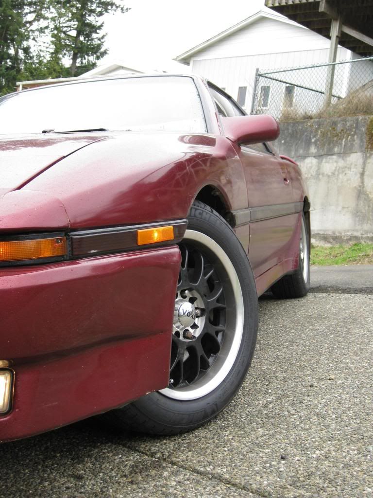

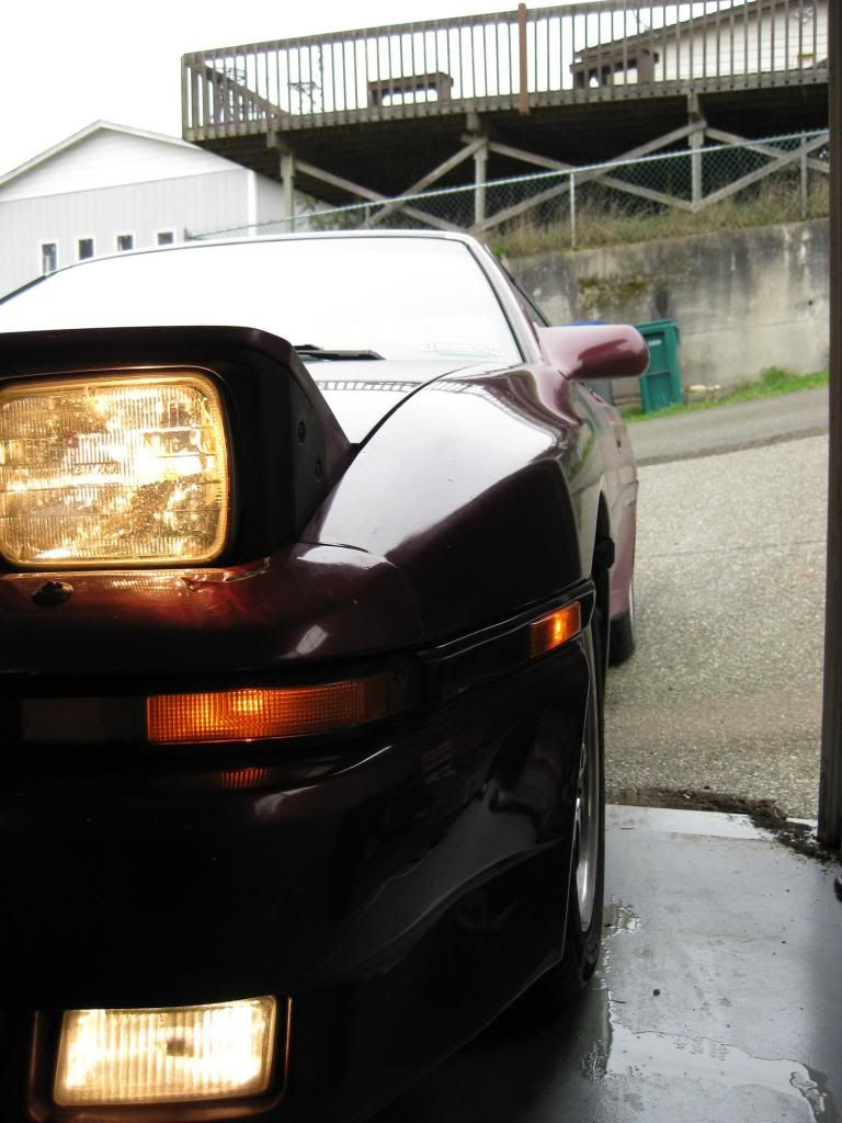

Here's a few pics from yesterday I snapped.
It's like Christmas in February!
The old:
I realized I didn't take any during photos mainly because there was about 25 LBS of dirt that came from the first wheel well and the remaining 3 were just as bad and didn't want to mess up my camera. Here are a few after shots. Still needs some adjustment but much better than the 3" lift kit that was on it before!
The front is a little too low and the rear is just a little too high ride height wise but a decided improvement.

Right now the ride height is way too low for me and I plan on raising it up at least a half inch maybe more in the front then reassess the rear height. I have the coilovers set on the hardest setting and thought it would be extremely bumpy or harsh but they're actually not too bad as far as driver comfort but again I've had them on the vehicle for less than 24 hours and driven the car twice with them on, my opinion may be subject to change on the matter.
