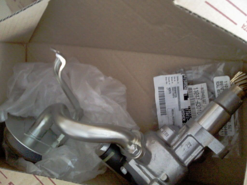

Ah ha! Found this hiding in my garage. Had no idea I had a new oil pump yet. Shh must be bday surprise!
