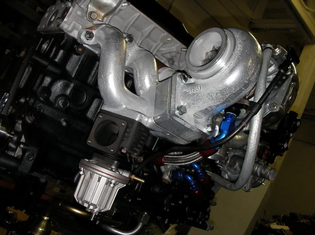

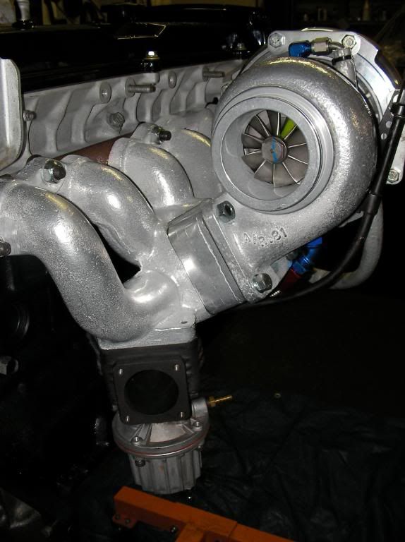

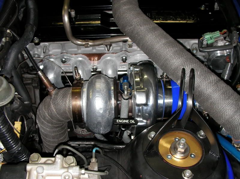

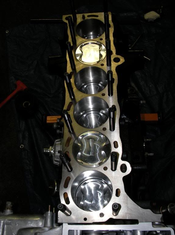

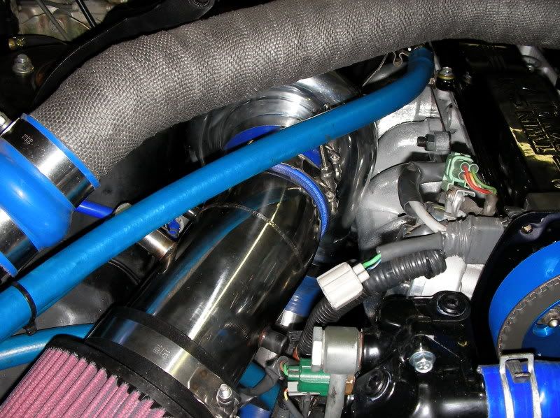

is that a completed destroked motor???? looks with prob's and arp studs.

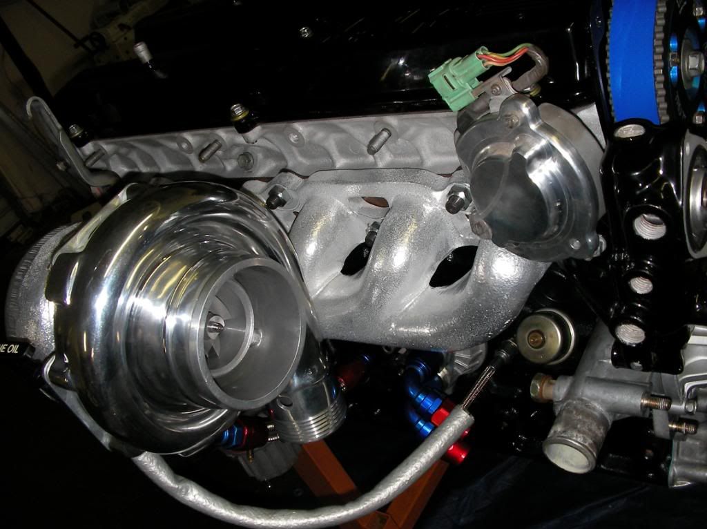

is that a short or a long mani?
specs on the turbo?
set up looks very good,

i might be wrong, but i think aaron runs a gt4082 with a larger .82 turbine ar, and a turbonetics cast manifold. the turbo is a 58mm inducer if im correct, and i think he made 420rwhp on 18lbs. (if you couldn't tell, i was interested in a set-up like this for a long time) ....... creepy!

Not good as in snout broke on crank in Vegas on Sunday after the drags and it had to be trailered home. Still haven't had time to tear into it yet, too many customer projects to spend time on my own car. It was all good otherwise, the engine ran just like I expected and was a lot of fun. I will have to have a 7m crank destroked on the journals this time rather then using a 7m crank.

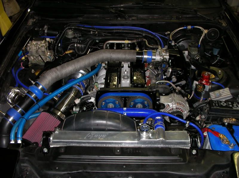

It went 13.5 at 111mph in Vegas, I didn't get a chance to dyno it. The rev limiter was at 7500rpm for break in :biglaugh:
I tuned the standalone on the freeway to Vegas so it could have been better if I had some dyno time. I spent about 8 months and $700+ on that damn crank and it went about 400 miles. If you try new things and sometimes it doesn't go as planned the first time around. It looks like it just broke at the weld, so I think the block and everything else will be ok.
