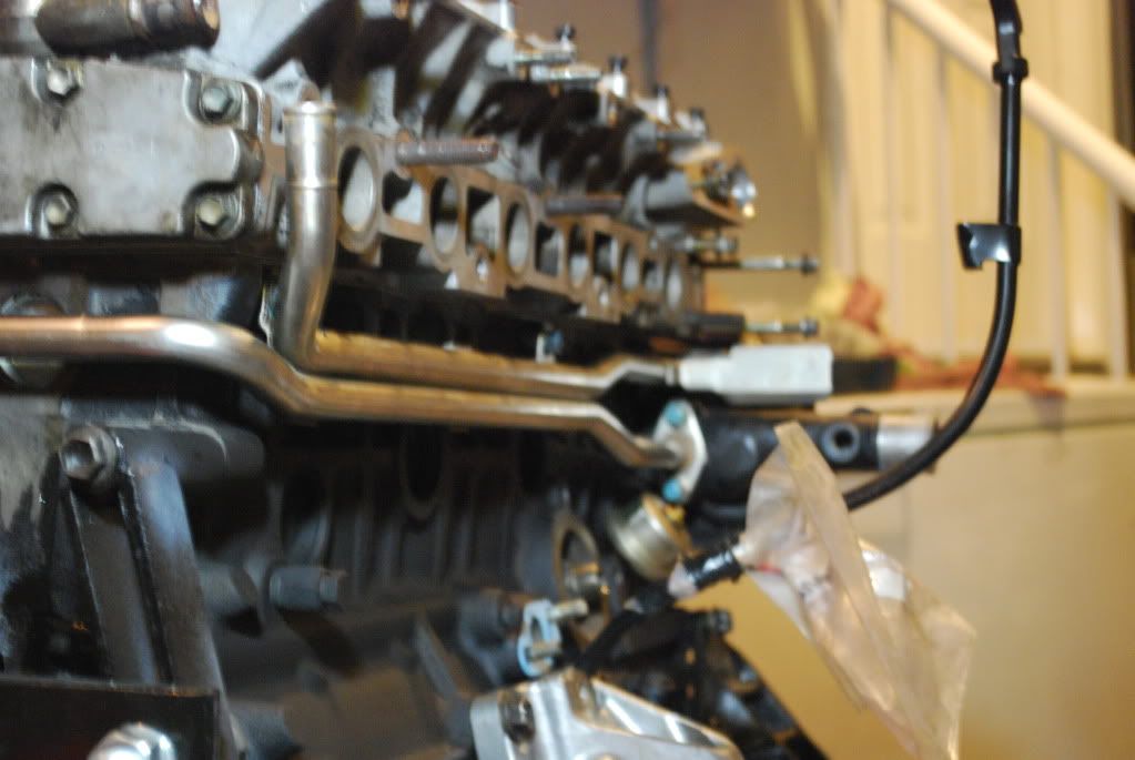

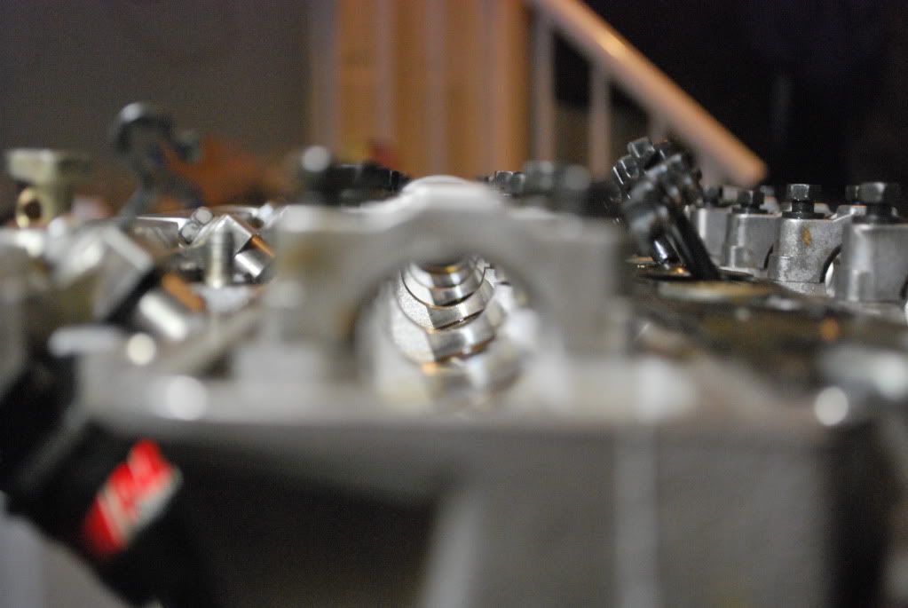

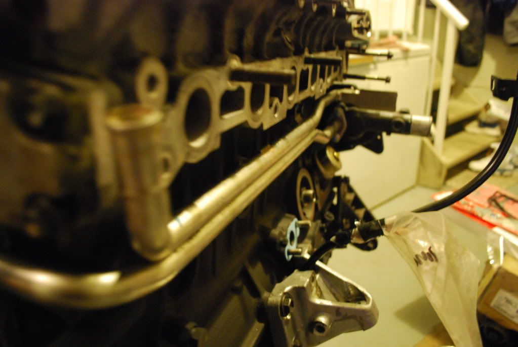

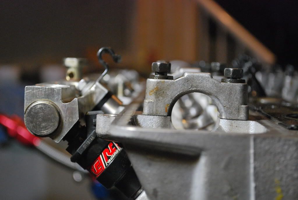

got a good friend come by and he took a few nice pictures but we had poor lighting!

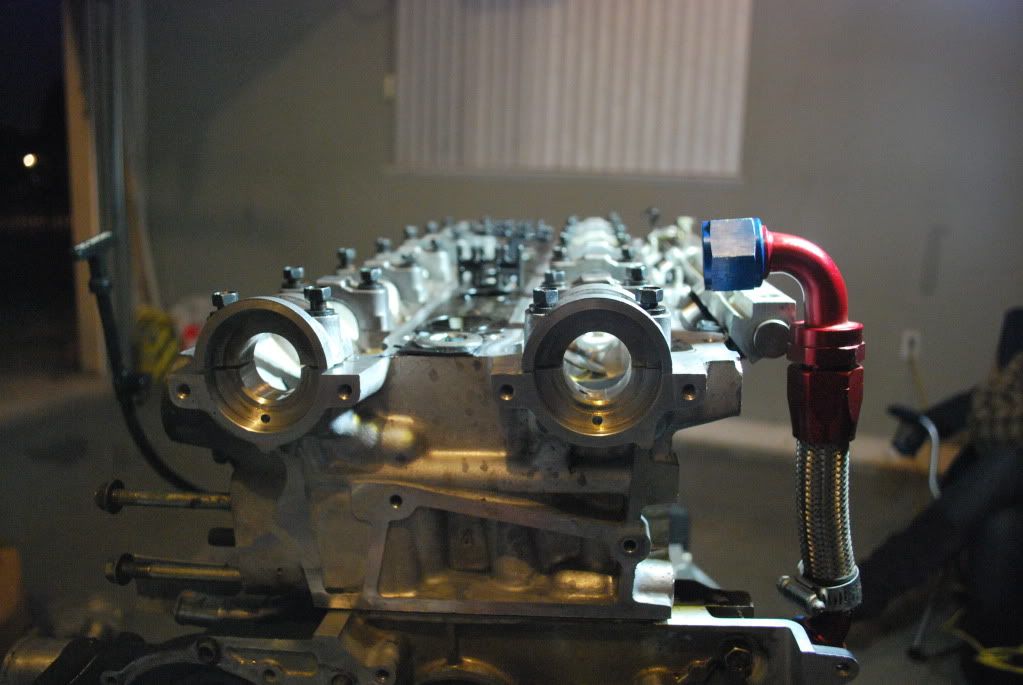

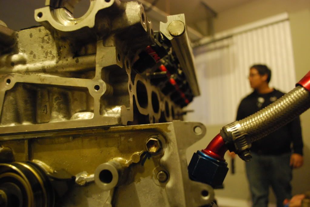

wells heres more update! i got busy lastnight!
i torqued the head down to 90lbs 4 passes w/ arp moly lube as instructed.
installed the cams, timing belt and timed it, installed one valve cover ( still need to polish other!) , picked up a cressida throttle link to run the NA covers with a gte Intake, installed the rear main seal. and remove the spark plug valley cover to clear up space to install my coils, installed power steering pump, lower rad hose w/ t-bolt clamp, moved the AN fitting for the valve cover to my NA cover.
as of now thats all i can think of!
i still havent installed the oil pan but should be in the next couple days then i can work on the wiring next and finish up polishing misc parts.
the AN clears the alter bracket and also the fuel rail.
cressida link to make the NA covers work!
HKS_TRD
Jul 21, 2007
998
Australia
Nice to see the AN clear
Is it -12 or -16, also have you tried the lower runners on yet?
You seem to have had much better luck than me with it all fitting

yeah! the lower runner did fit i just didnt get a chance to take a picture but i will once its done. :icon_bigg
