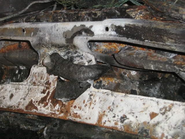

firewall is warped from the heat... who knows about the windsheild frame...
possible to repair? probably, but it's not going to be cheap...
get an estimate from a a bodyshop to repair the warped metal and see where you stand...

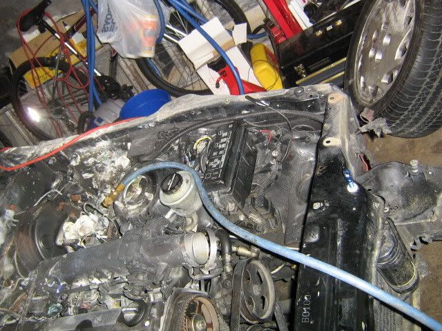

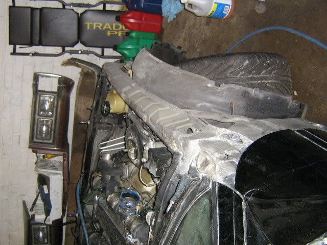

Passenger fender removed:
Rest of front bumper:
Drivers fender:

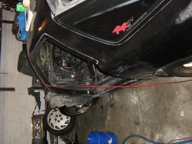

Fire got so hot it melted the wiper arm:

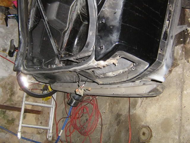

Rear body parts removed:

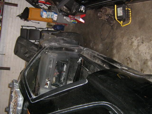

Left Door:
Right Door:

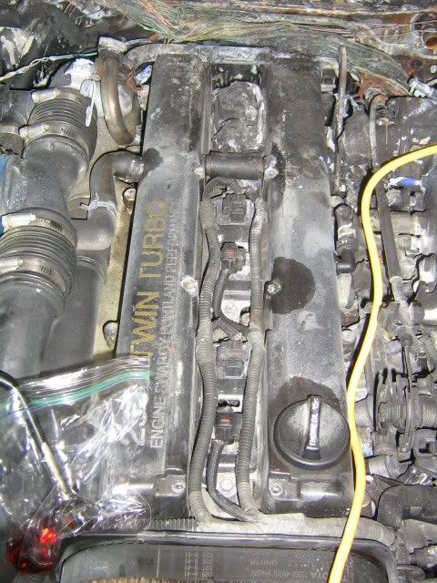

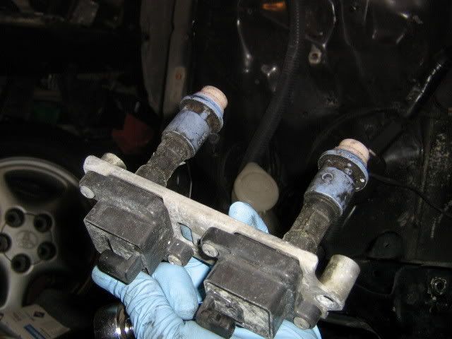

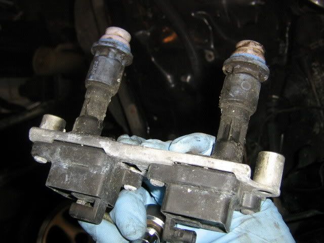

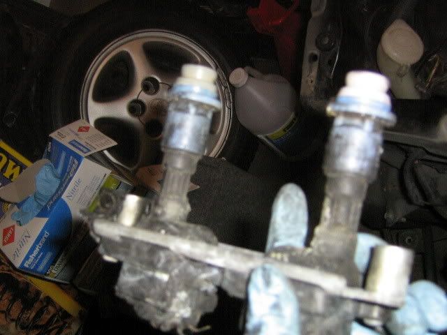

Removed Spark Cover:

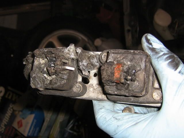

Coil packs 1 n 2:
Coil packs 3 n 4:
Coil packs 5 n 6:

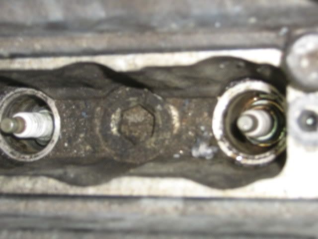

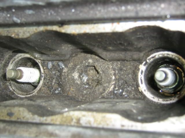

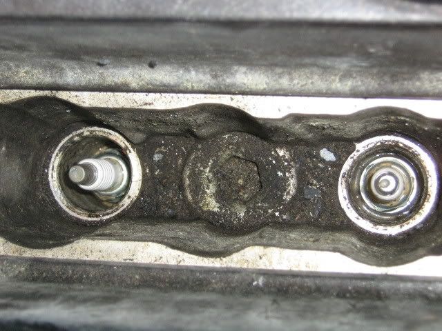

Spark plugs 1 n 2:
Spark plugs 3 n 4:
Spark plugs 5 n 6:

Block is fine rear pair coil packs are not.
