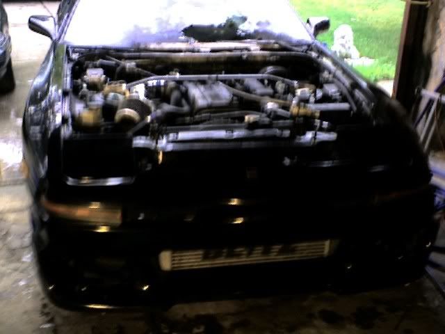

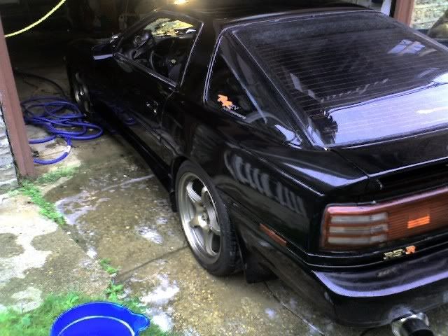

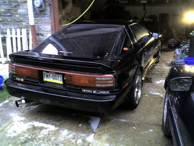

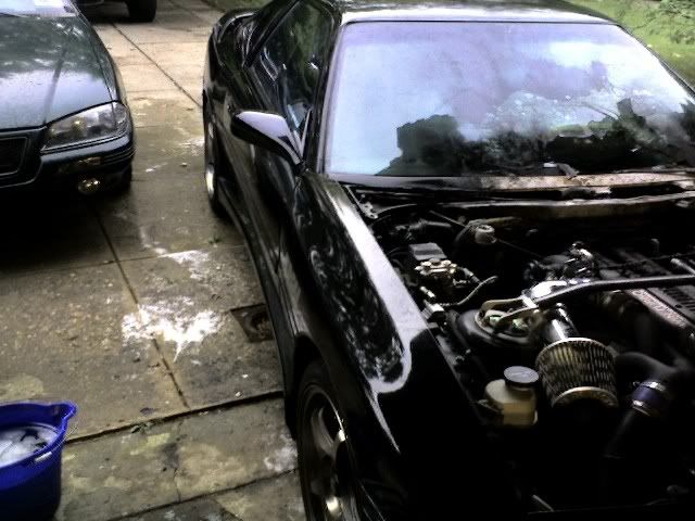

Finally got some work in:
Cleaned her up so I wouldnt get crazy dirty while i worked on her....Only had my cam phone with me this time:

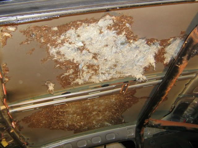

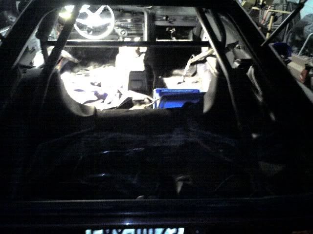

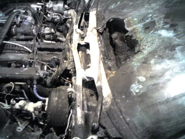

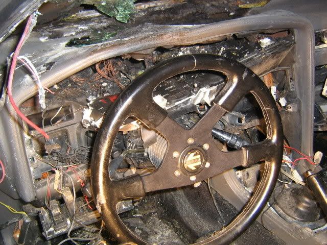

Shes not going to make it fellas...dash electricals are too badly burnt for me. Im gutting her....taking pics till the end.
If anyone wants the carcass let me know.....
Removed headliner
Dash- Badly burnt up....shes not going to make it:

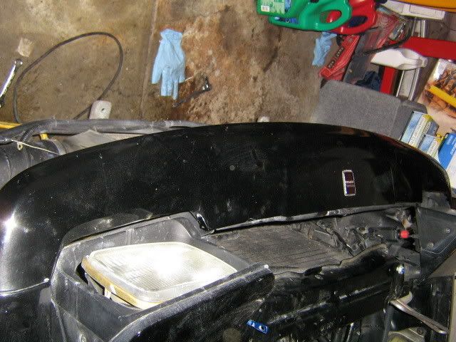

Removed bumper:

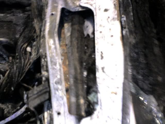

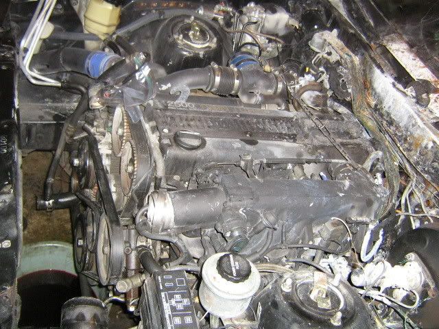

Engine w radiator removed

It looks like your loom cought on fire right around where the splices to extend the harness is. If the splices were side by side and shorted out it would do this in no time at all.
I think it was the splice going from the starter system because there is a high amp fuse or direct wire to power always hot its the black/blue white/black wire coming from the starting system looks like the splice came apart possibly on that system then once one wire shorts they all get hot melt into each other and fuse together making things worse. your car looks fixable from the pictures hard to tell though.

I hope to be pulling the motor soon for a close up. Hopefully it is A ok. MOre to come as i take things out the engine bay!
