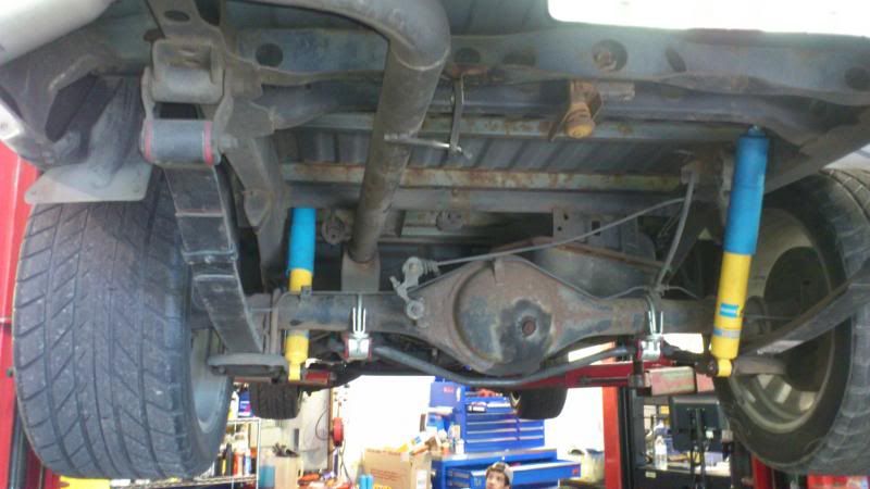

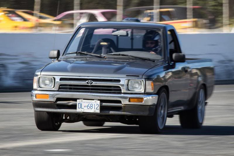

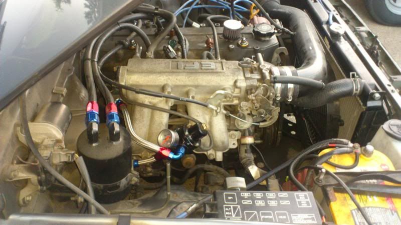

Here are some pic's of the truck right now

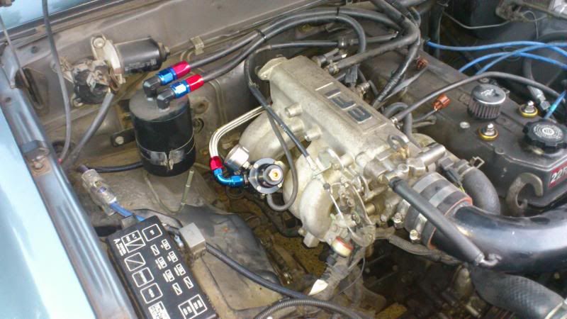

stuff installed since last post
fuel regulator

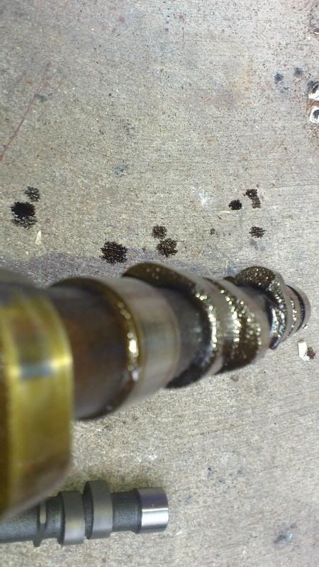

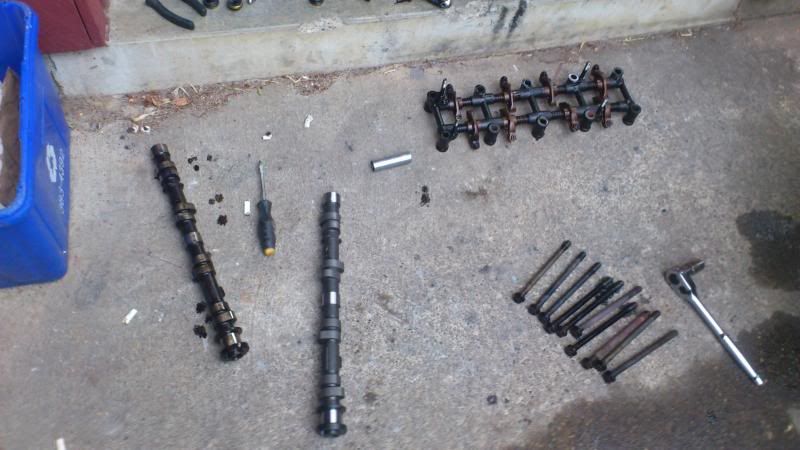

custom cam shaft

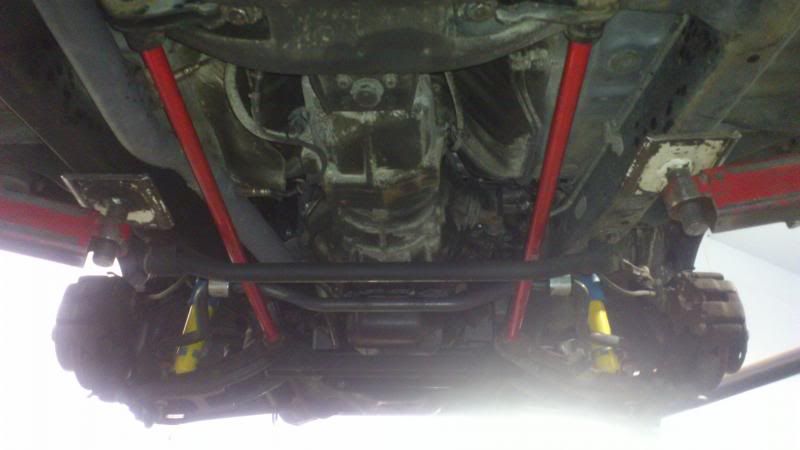

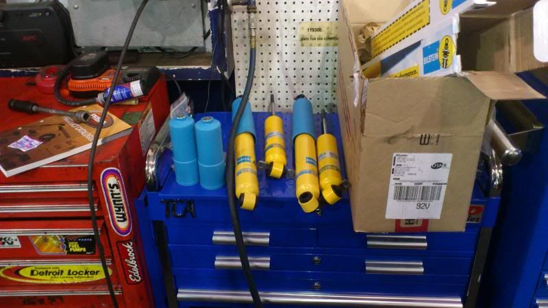

t bars and bling stein hd shocks

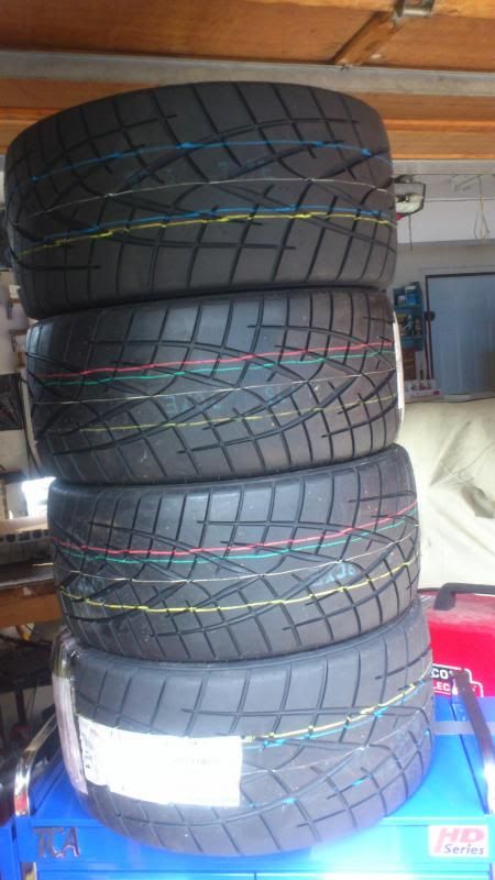

toyo R1R 245 front 275 rear

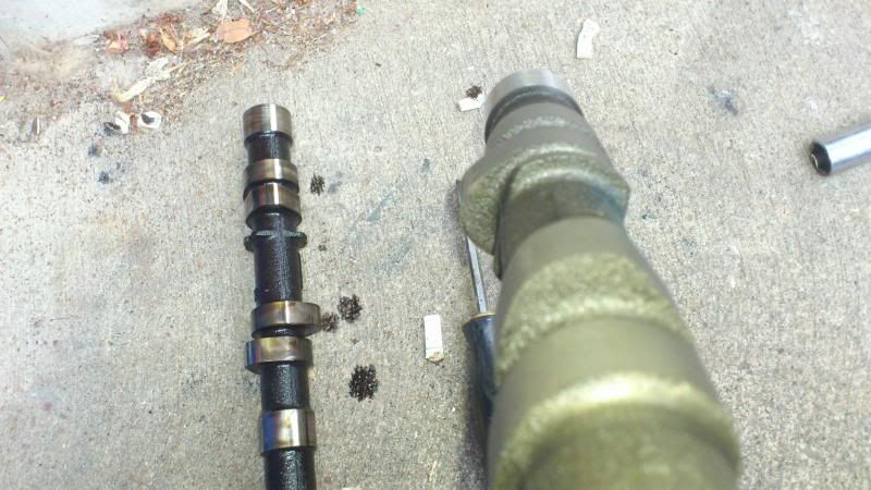

stock cam shaft see the base circle
reground cam see the base circle

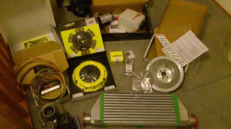

New stuff to be installed stuff not shown are lsq coils and 7mge injectors

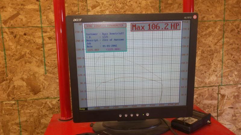

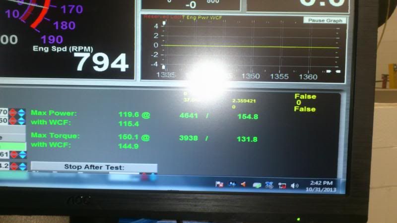

Here is a dyno befor cam shaft and fuel regulator
current power level is about 130 hp and and 170
this pic's was from when it was on a mustange dyno

I went to install my clutch and fly wheel today and well they sent me the wroung one grrrr
act is over nighting it to me and throwing in some goodies in the box
