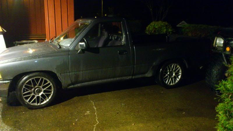

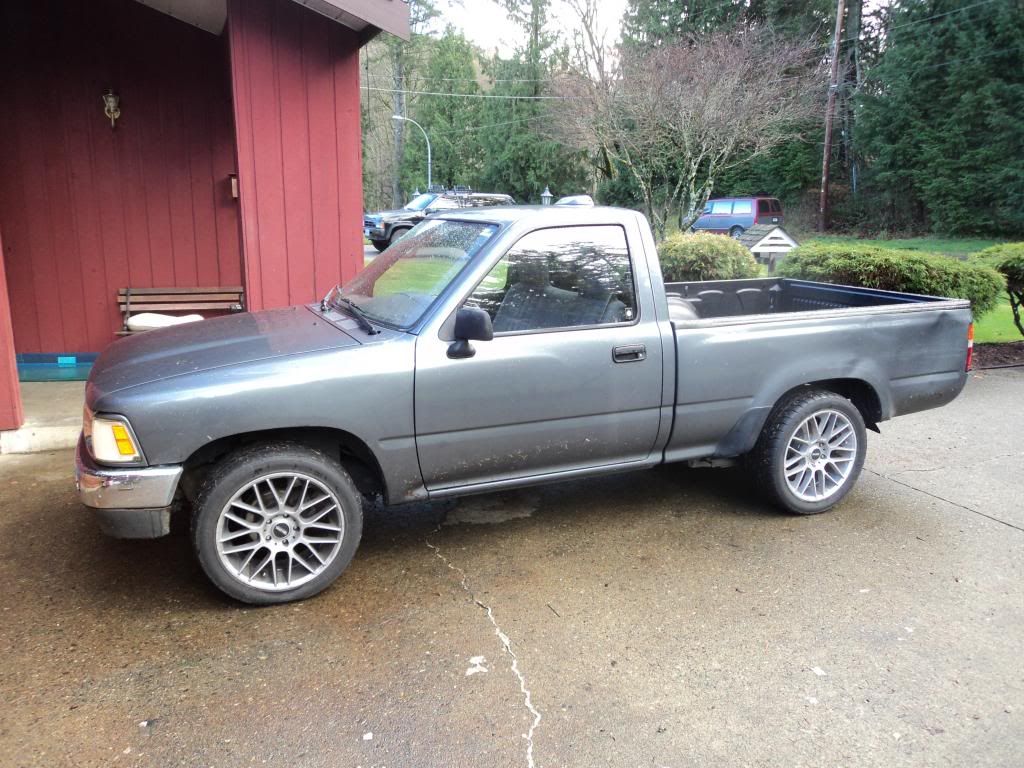

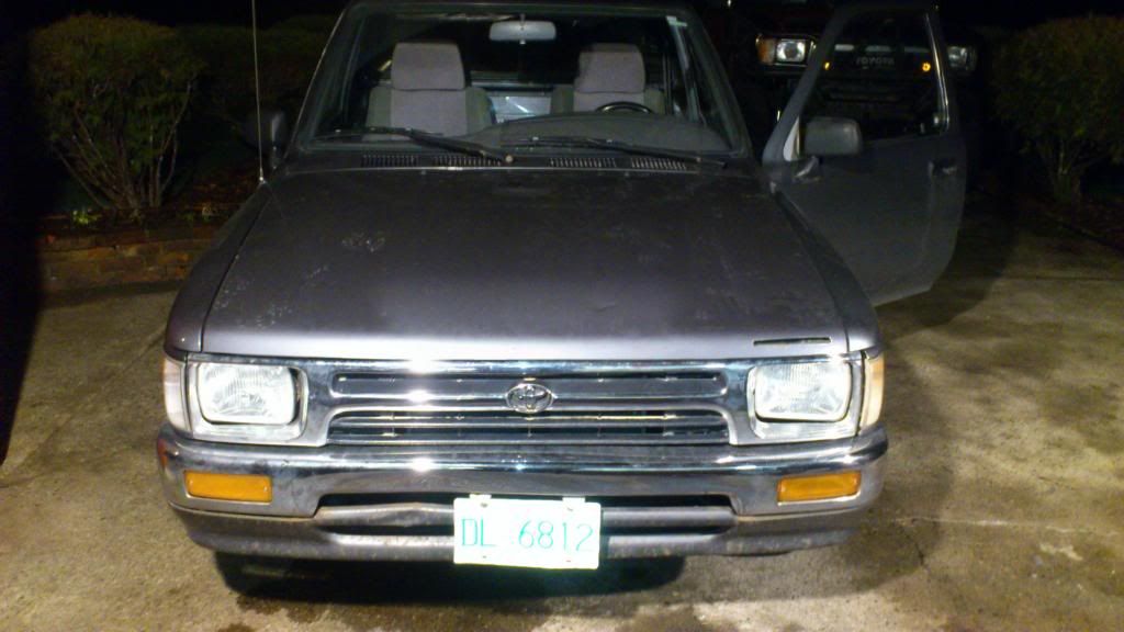

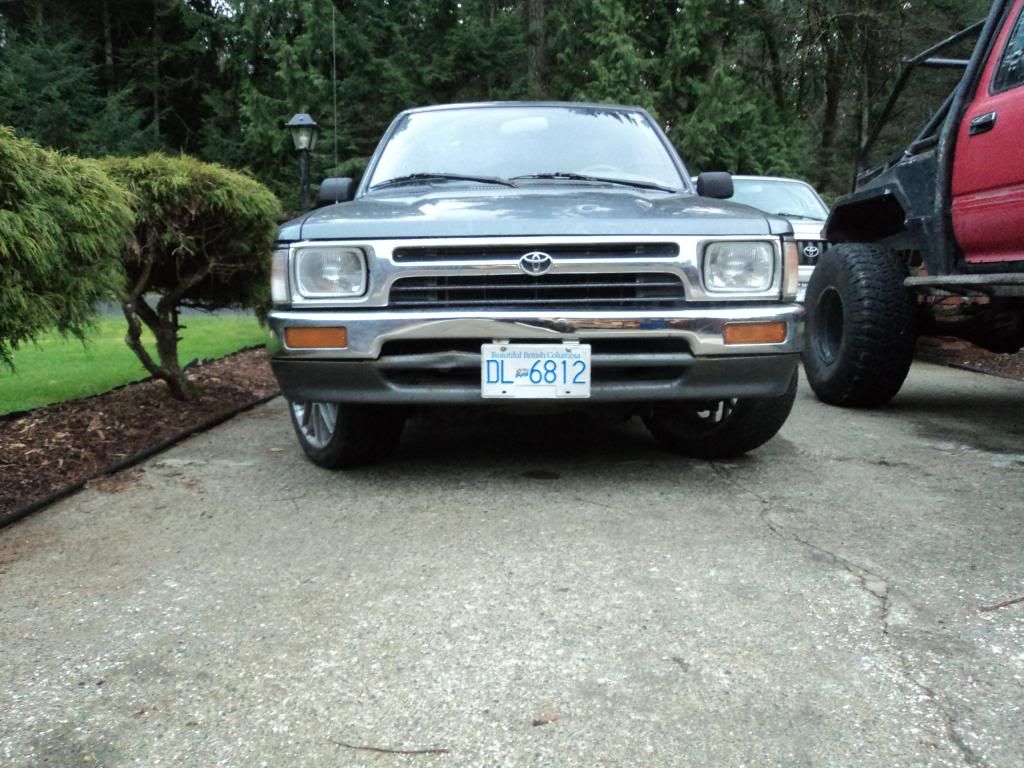

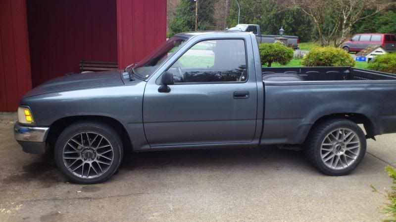

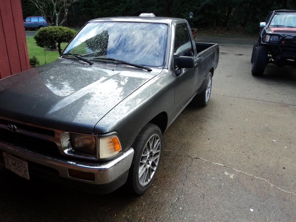

94 Toyota base model in stock form
so far I have not really done to much but I have done some things like

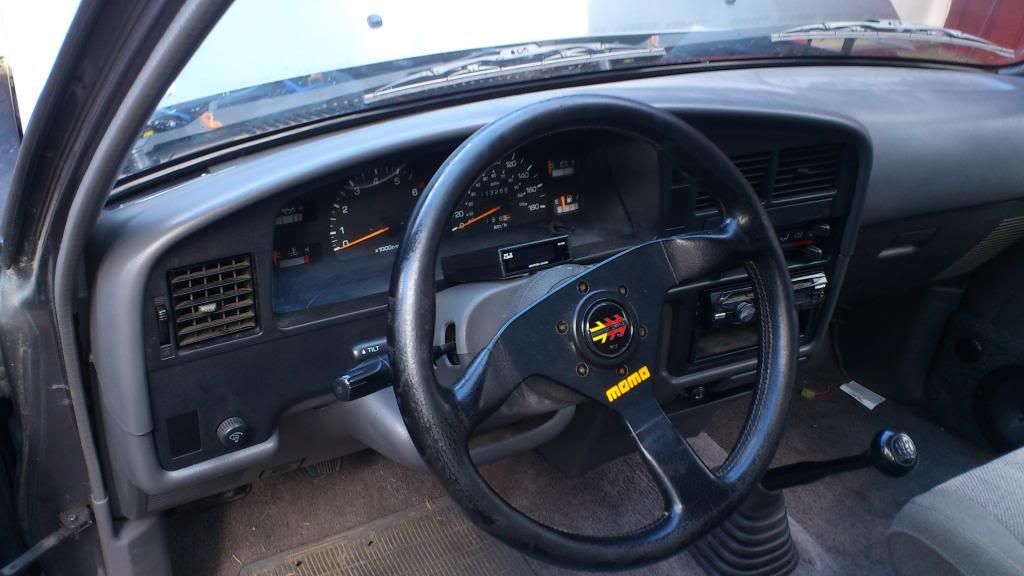

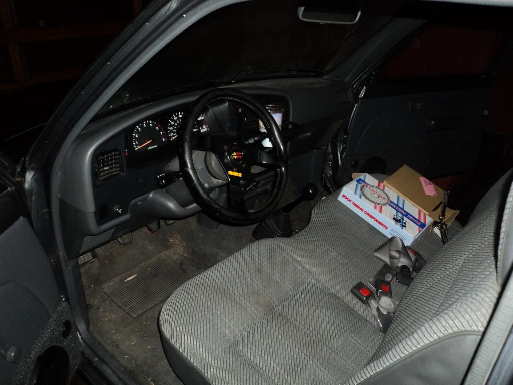

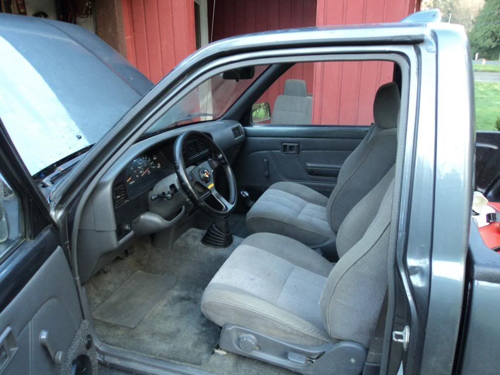

install new tilt steering column and momo wheel
-installed new gauge cluster from a sr5 sorry no pic as of yet or the new update of the interior will get one soon
- installed new deck and speakers

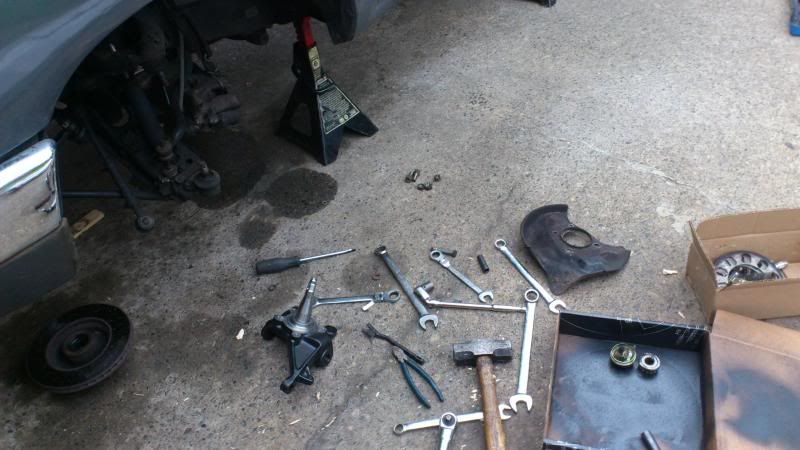

swapped shoes form my car to my truck since my car will be going to 18's soon
befor
after

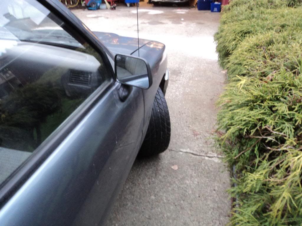

had to add some 1 inch spacers so tire would not rub frame. I am pretty sure a 285 is about as wide as you can go in the back and boy does it look good

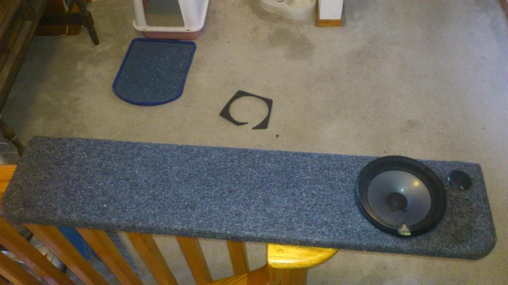

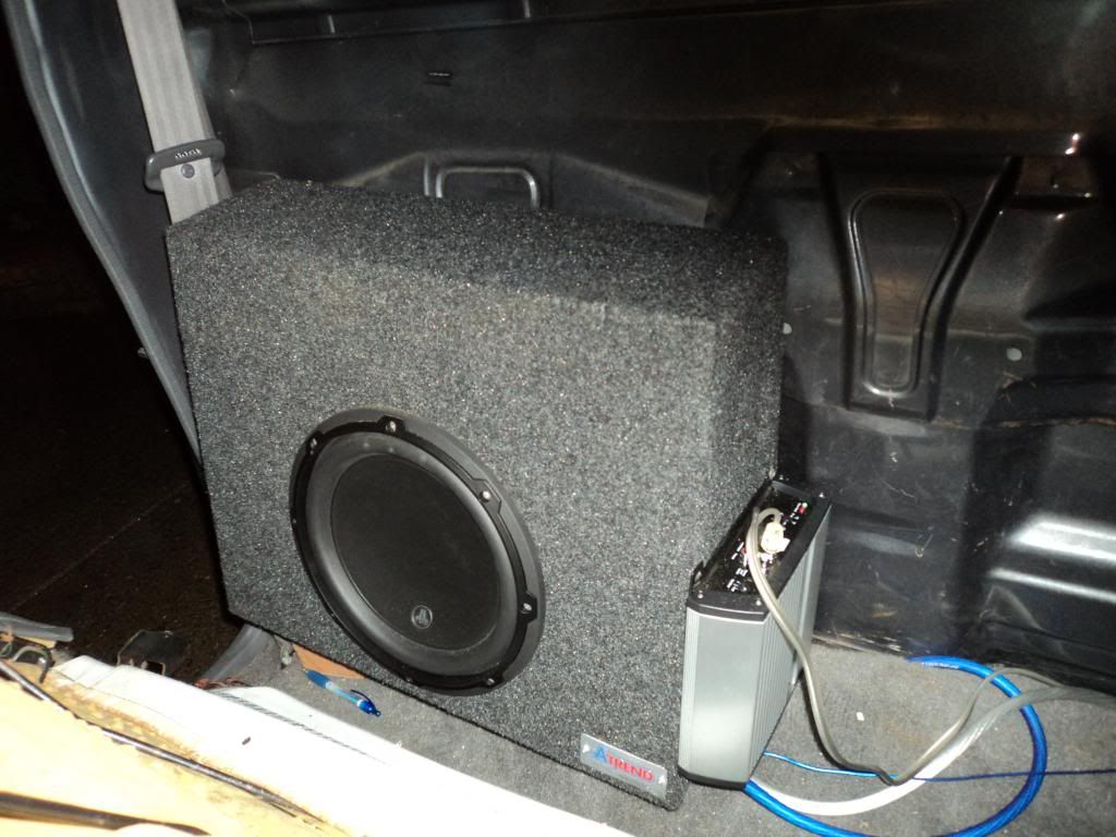

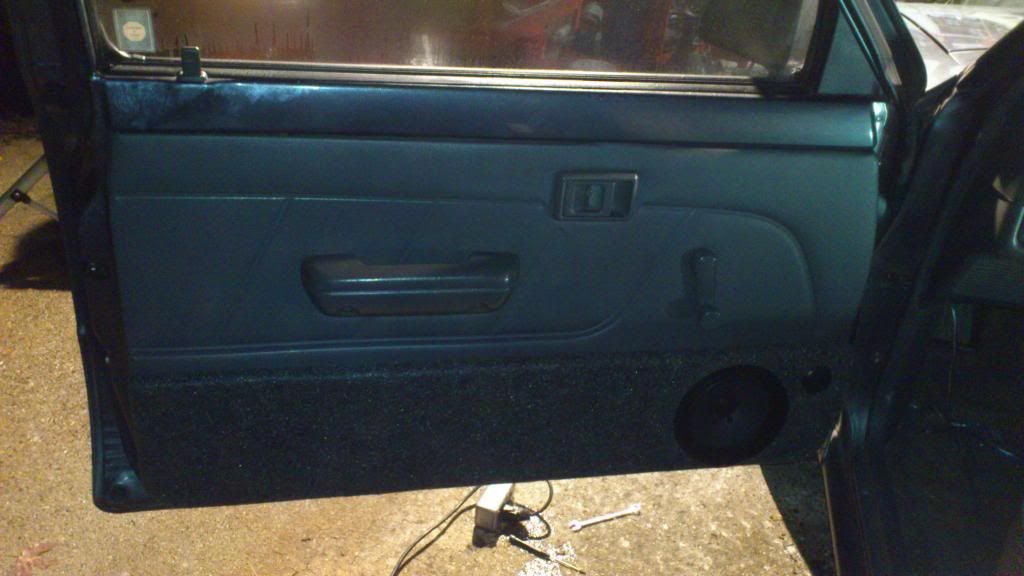

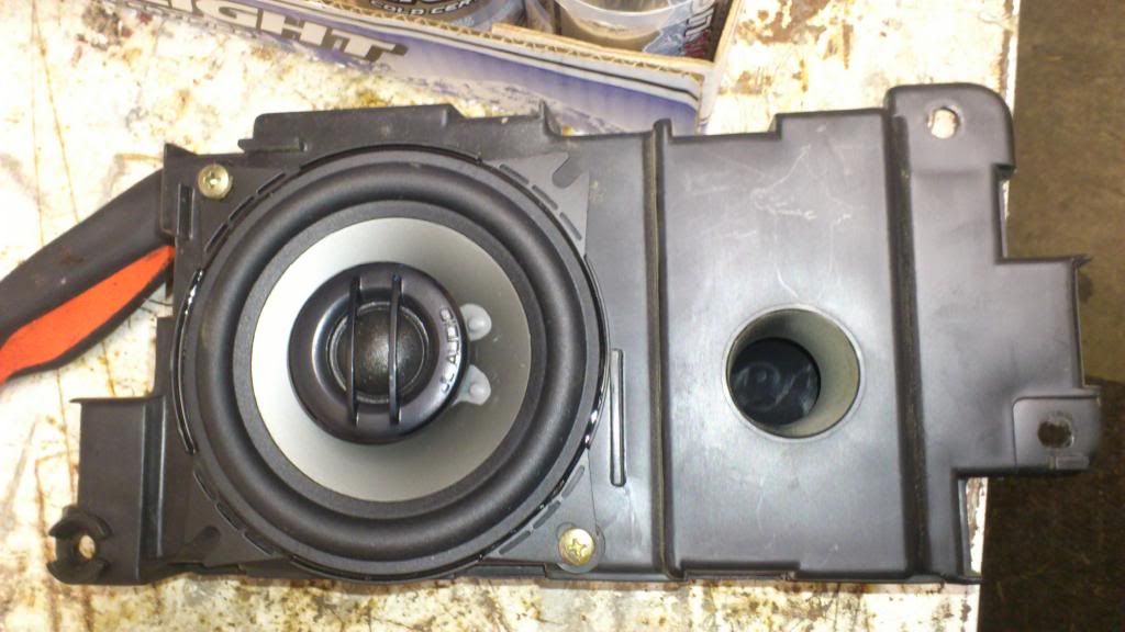

I have finished my door panels with speakers and sub and amp, steering wheel, tilt setup cluster swap
pic's

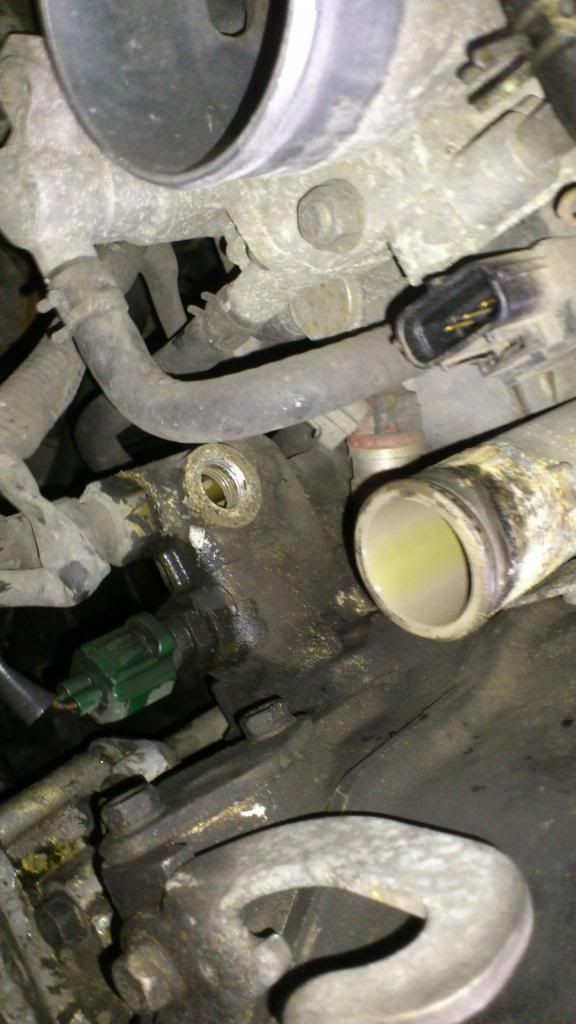

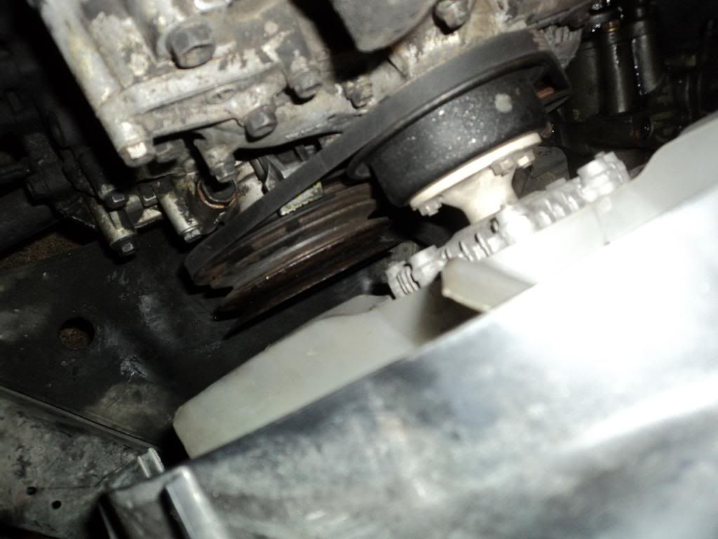

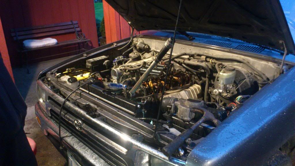

Timing chain fun

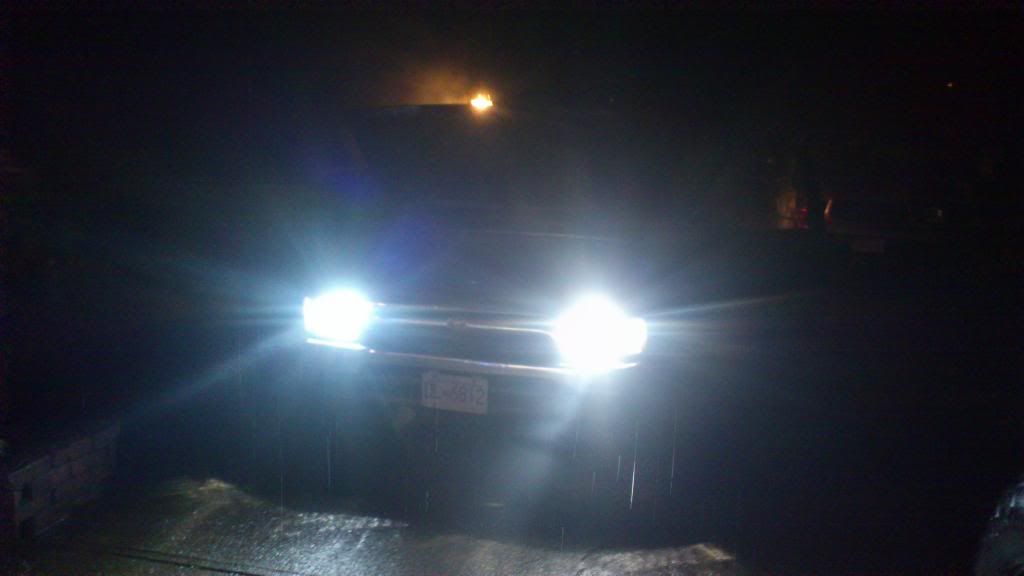

hid install
after

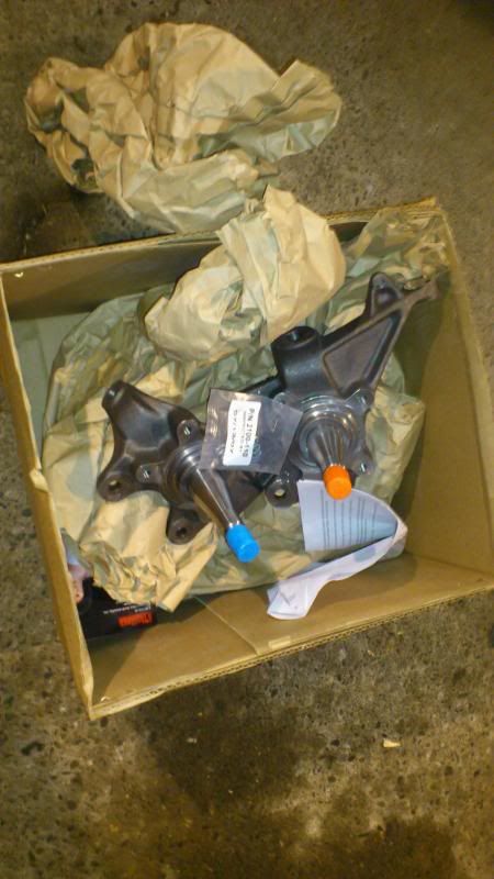

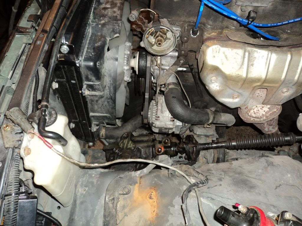

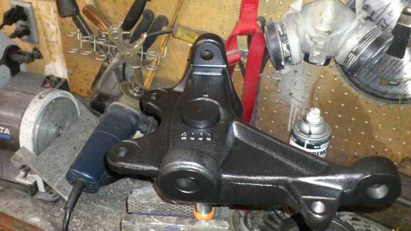

ball joint flip and power steering added plus added more steering angle with some tweaks and stuff

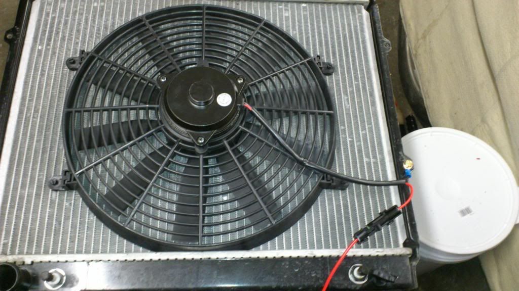

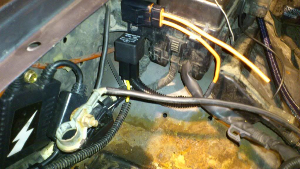

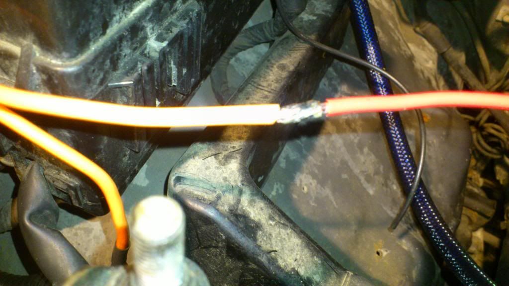

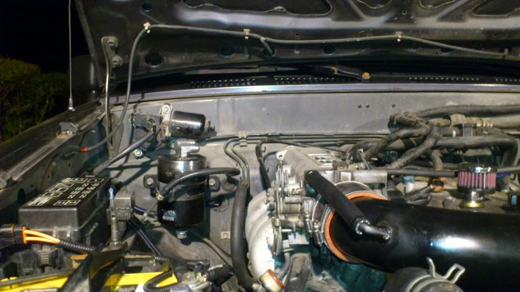

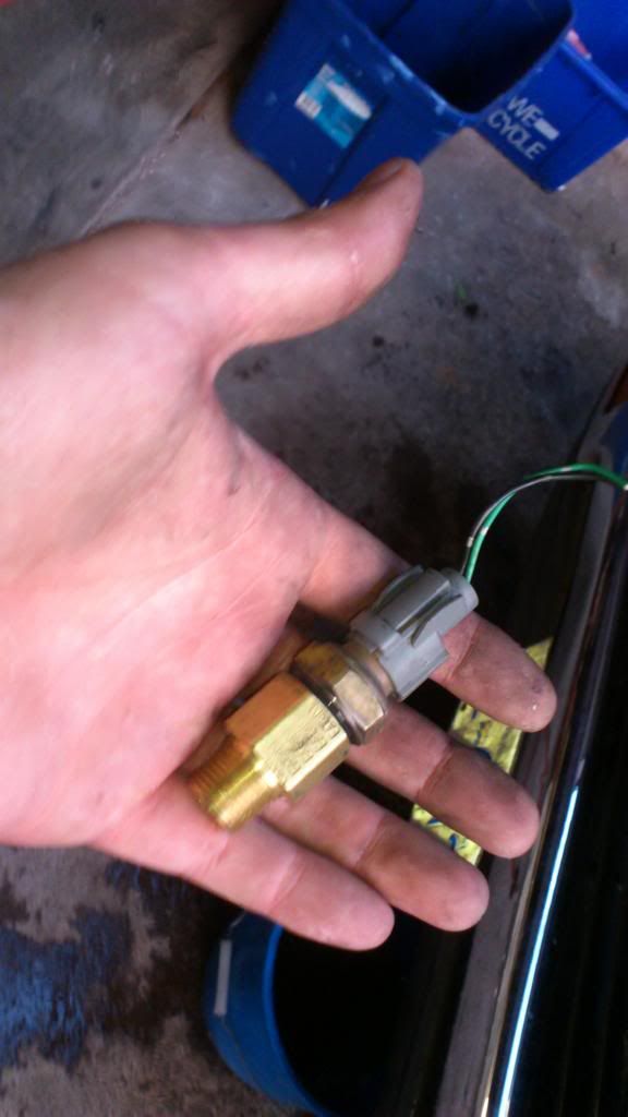

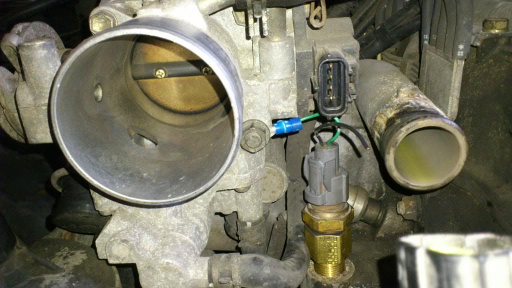

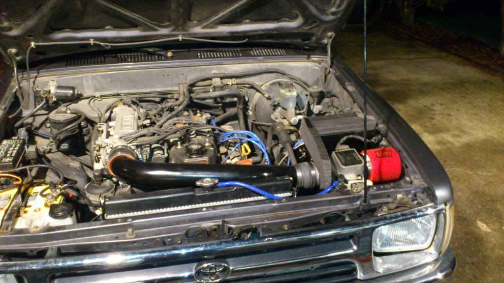

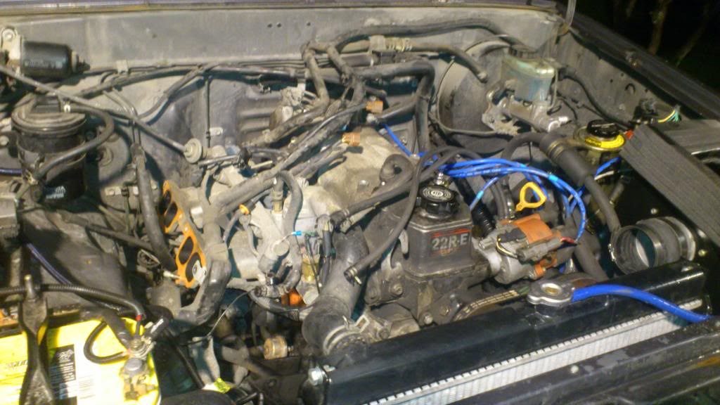

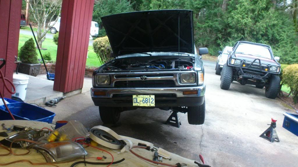

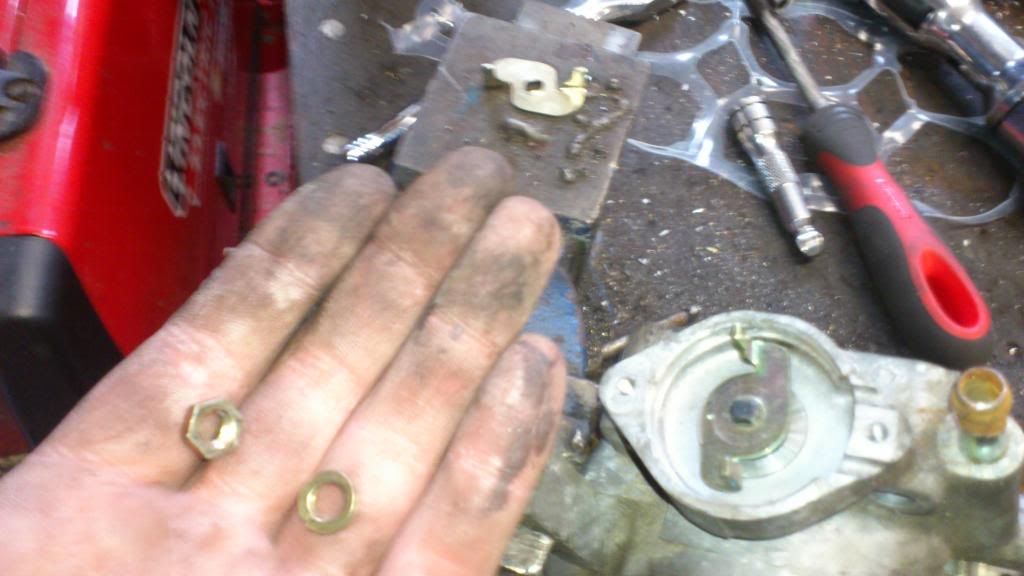

E fan installed with honda fan switch

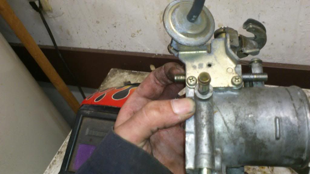

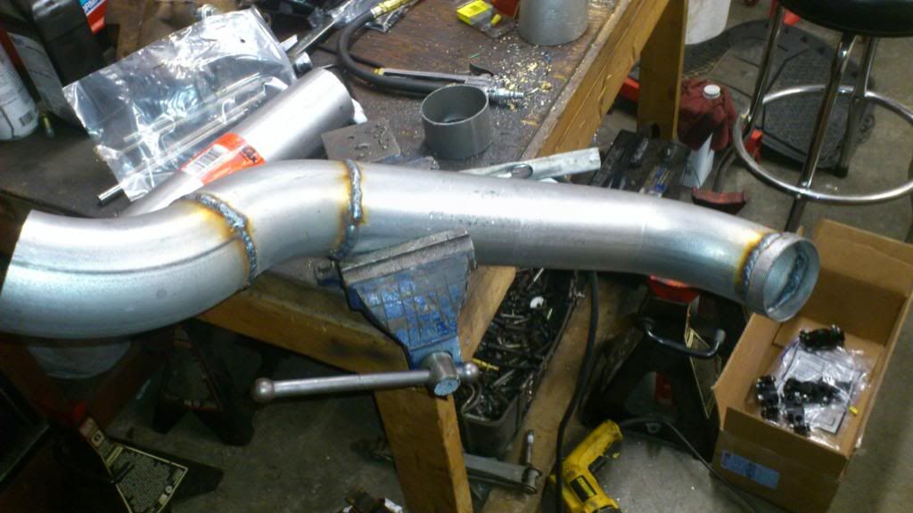

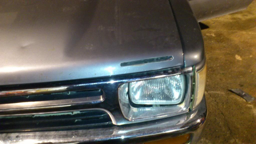

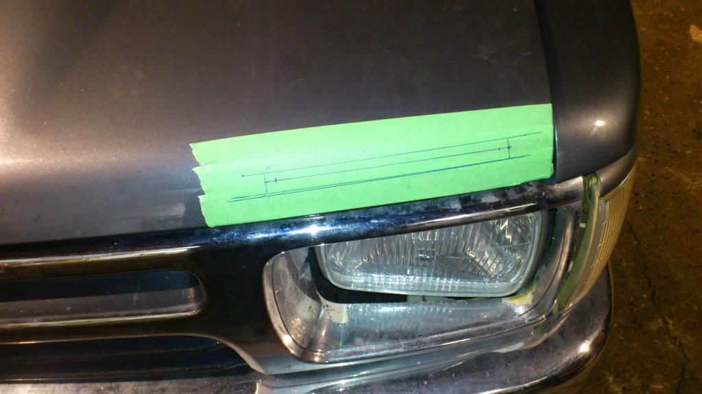

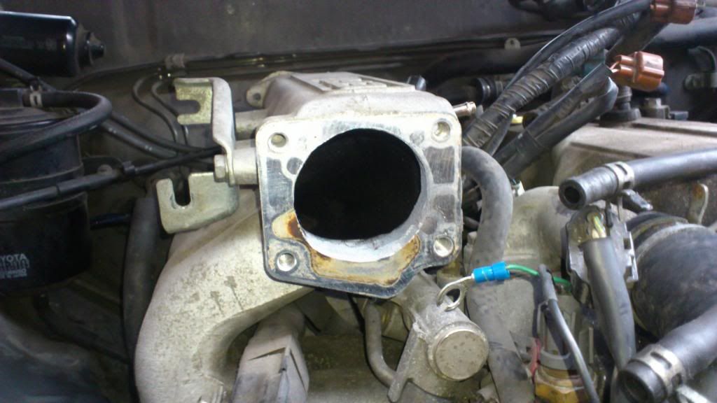

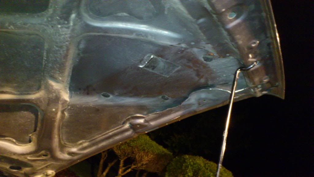

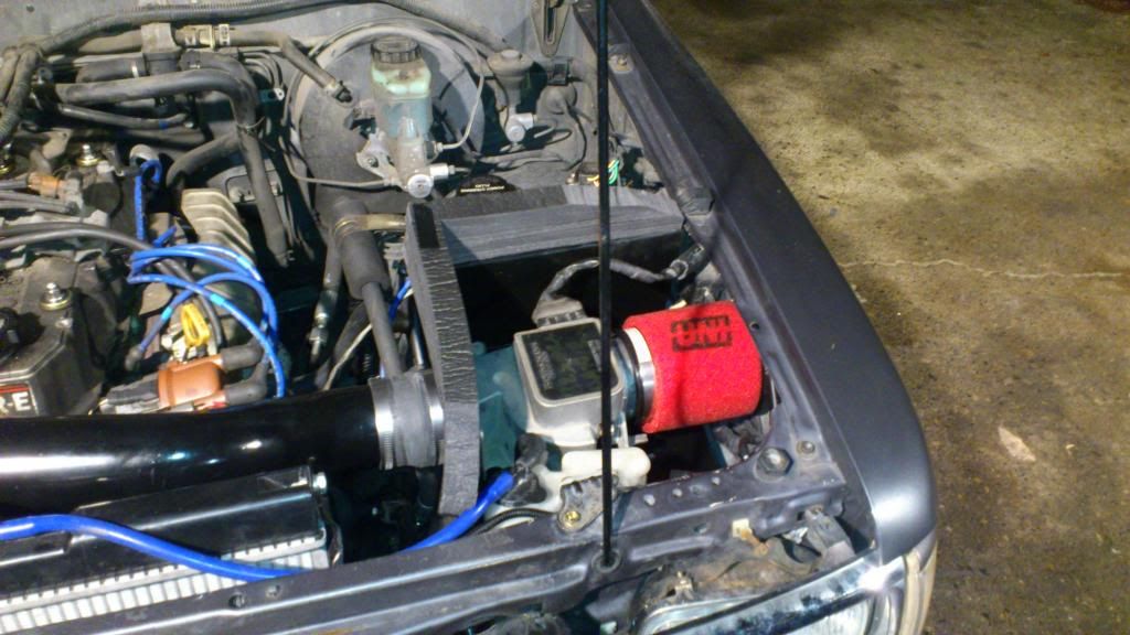

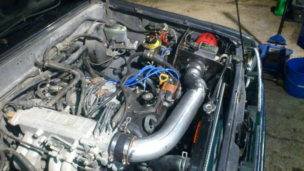

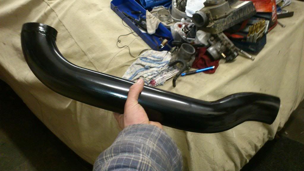

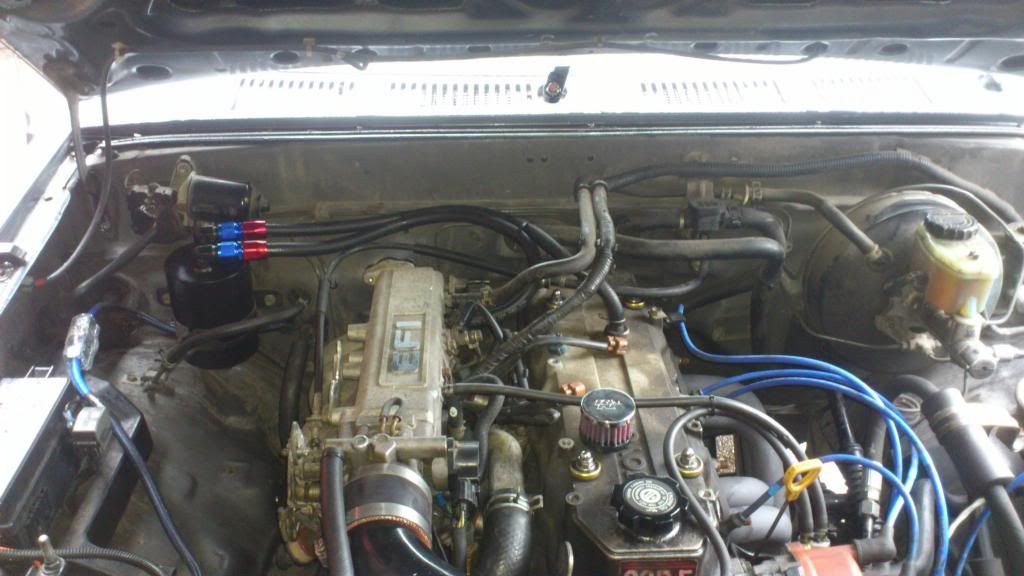

Cold air ram with modded hood useing a supra afm ect

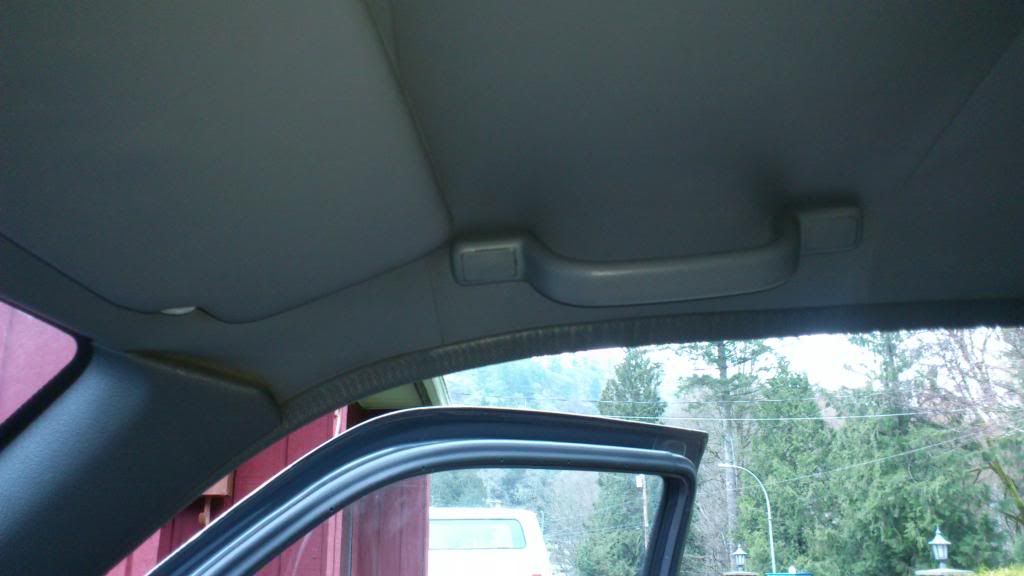

holly shit handle
4runner light bar
hood mod

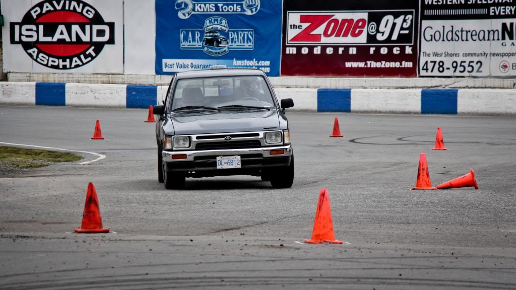

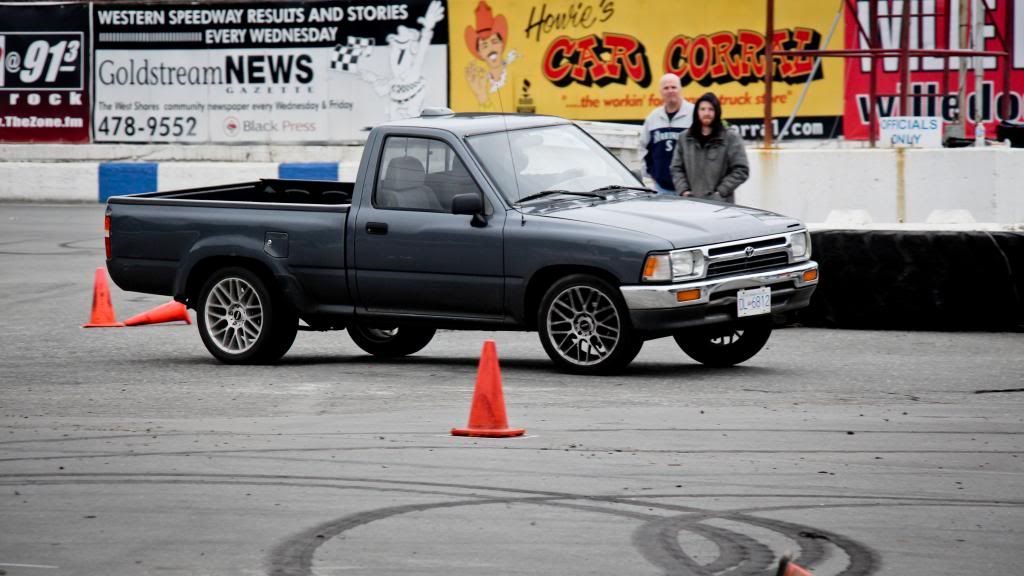

Auto cross

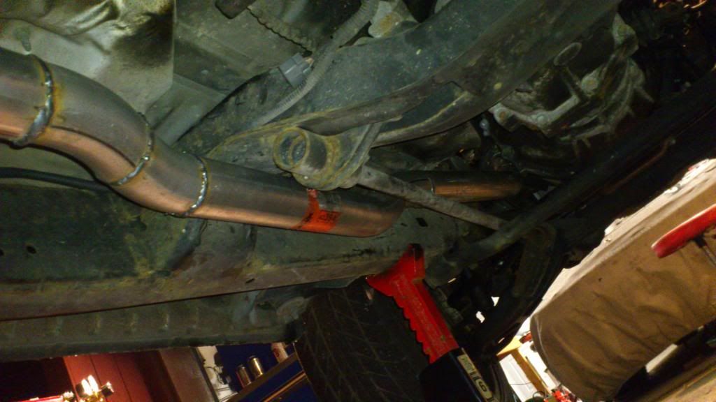

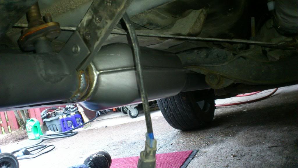

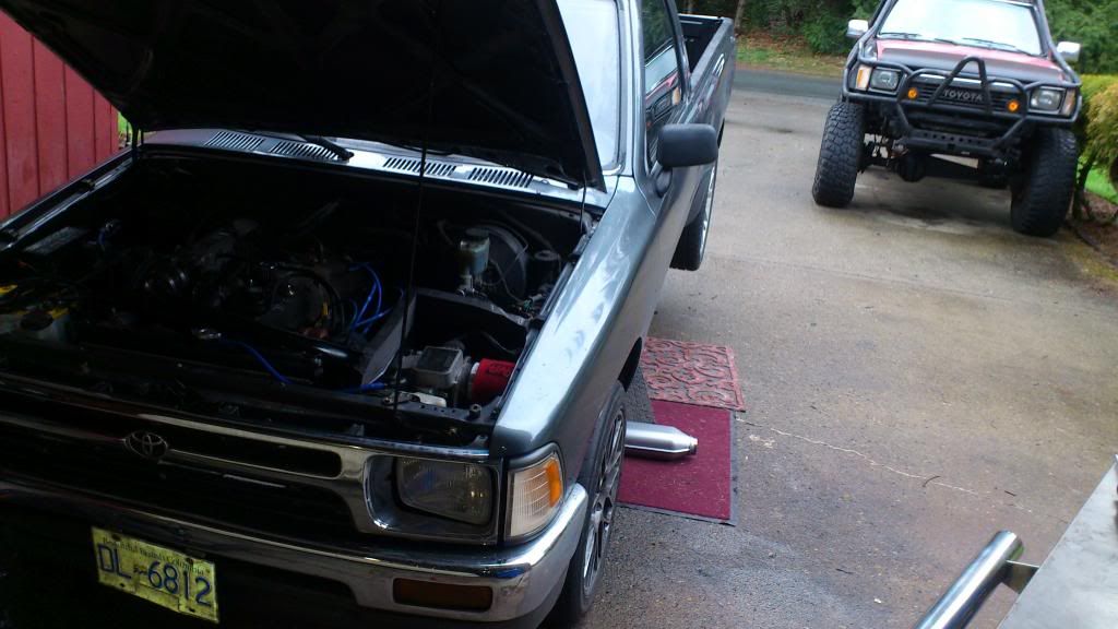

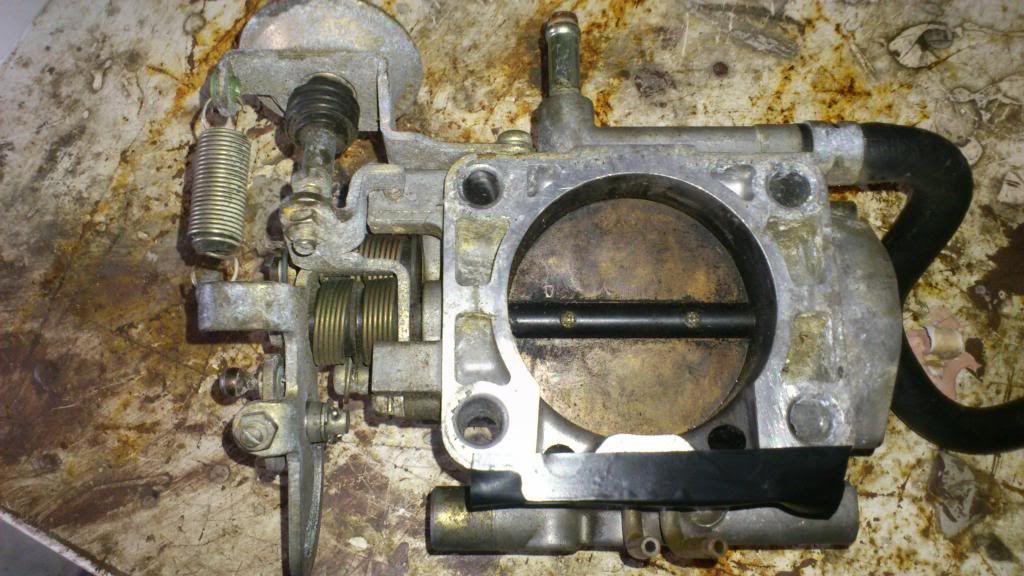

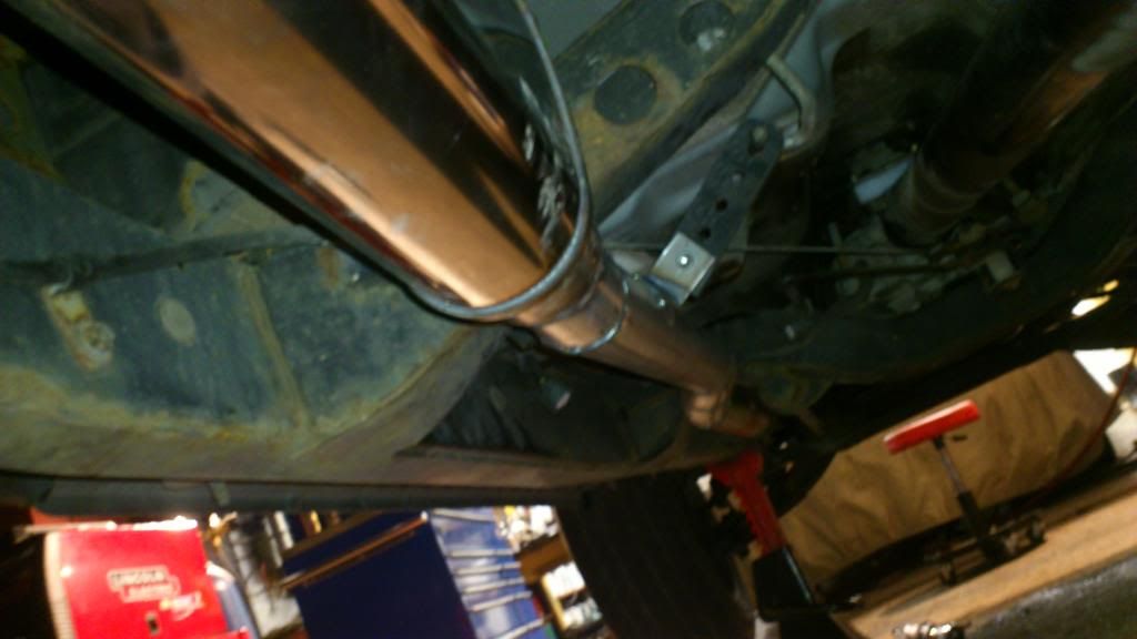

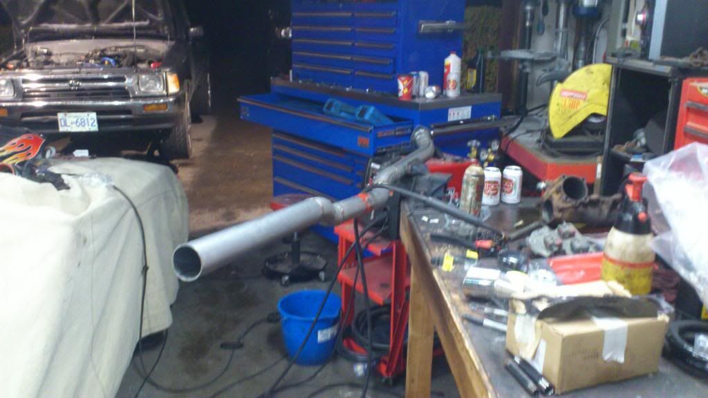

Exhuast and supra throttle body
hill billy die handle mine went missing

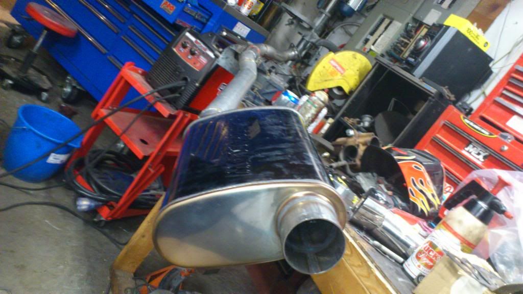

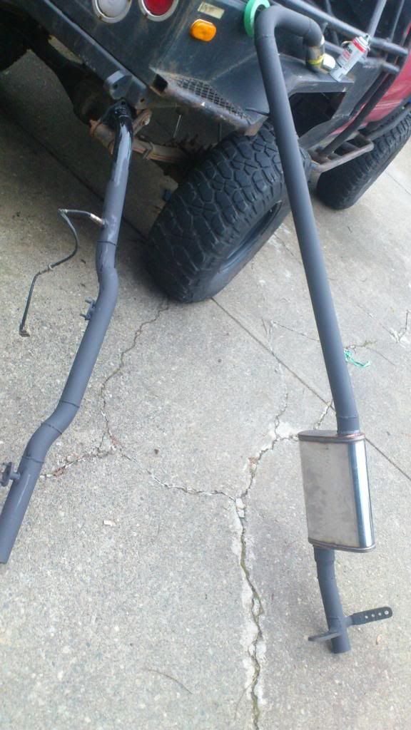

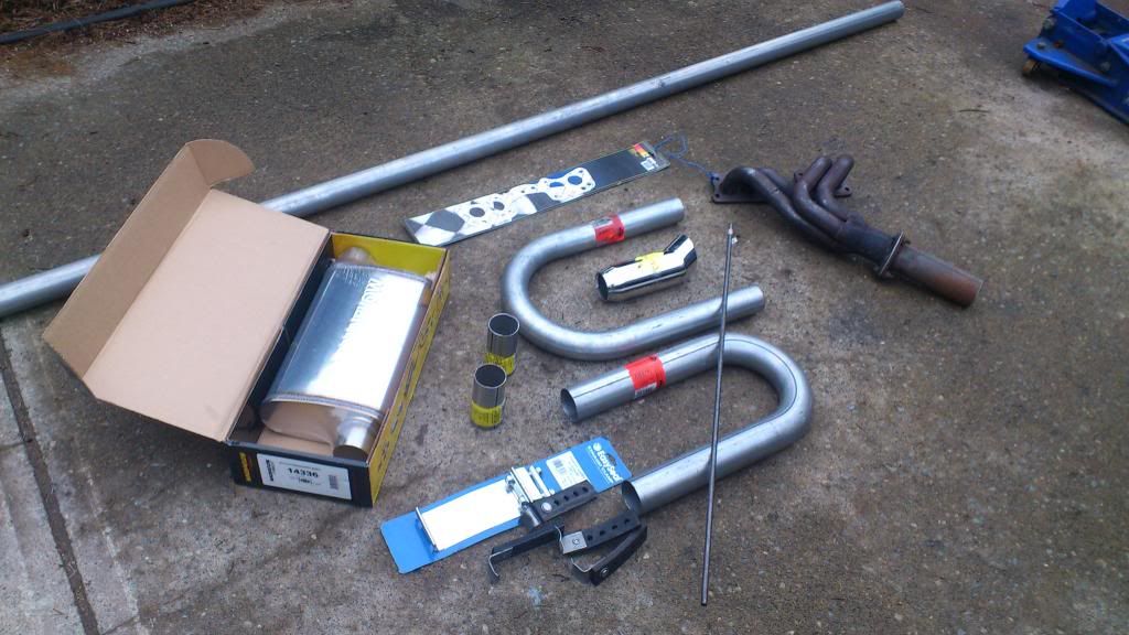

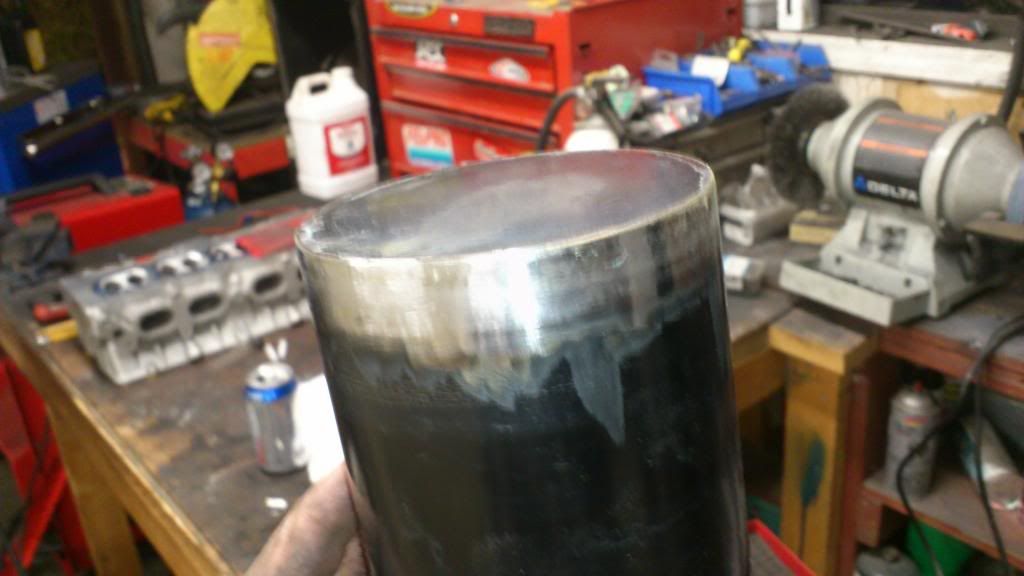

added a hush power 2 muffler to the exhuast it was to loud for me

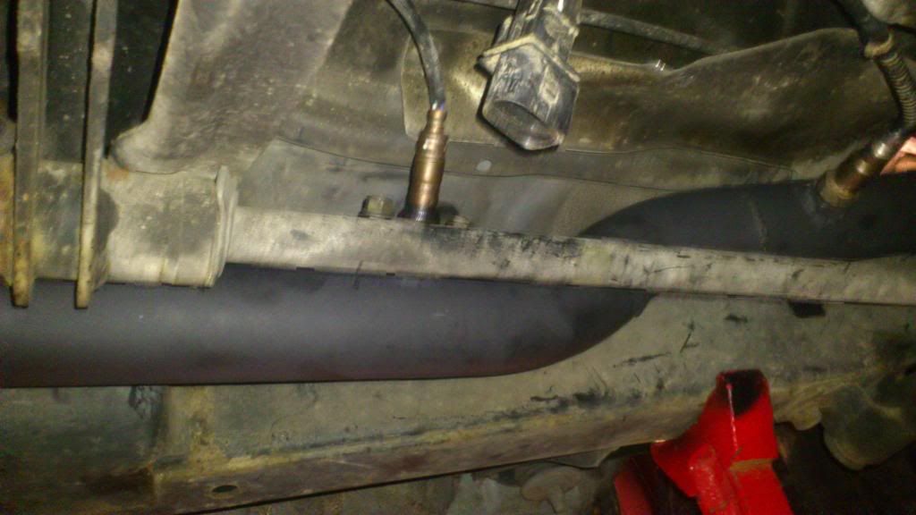

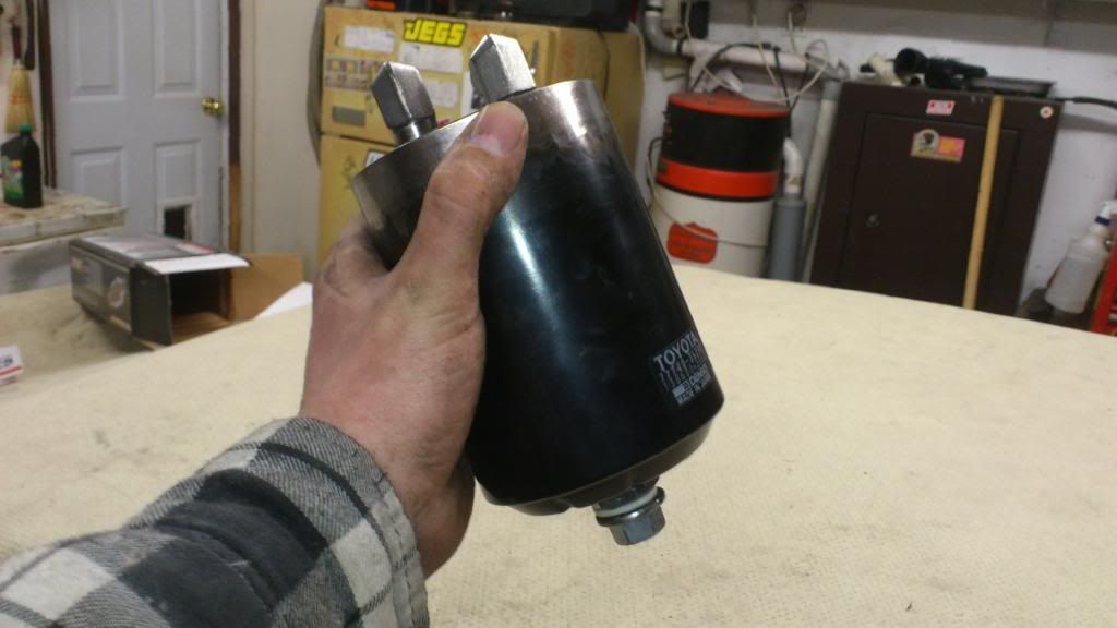

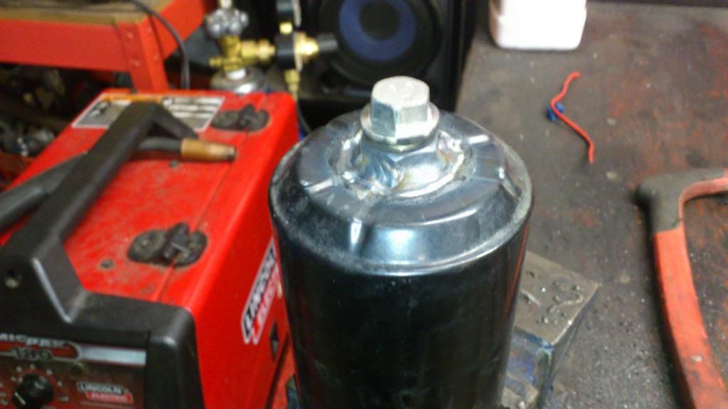

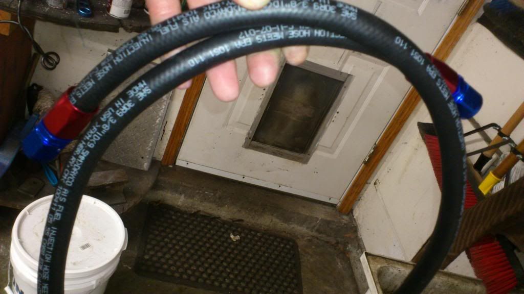

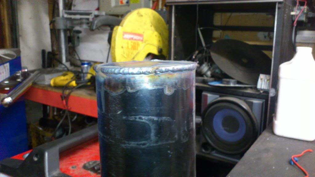

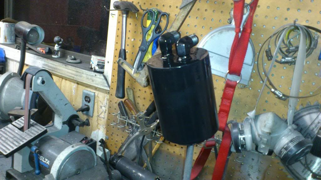

wide band installed and custom charcoal canister oil catch can

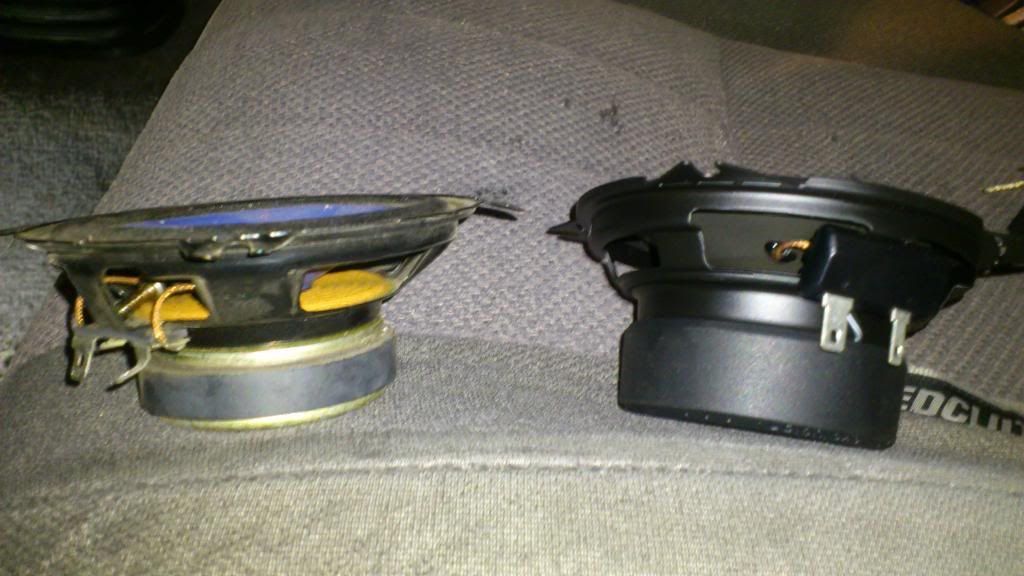

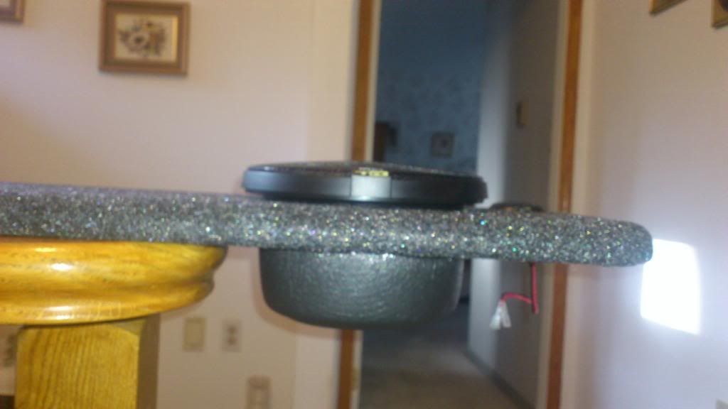

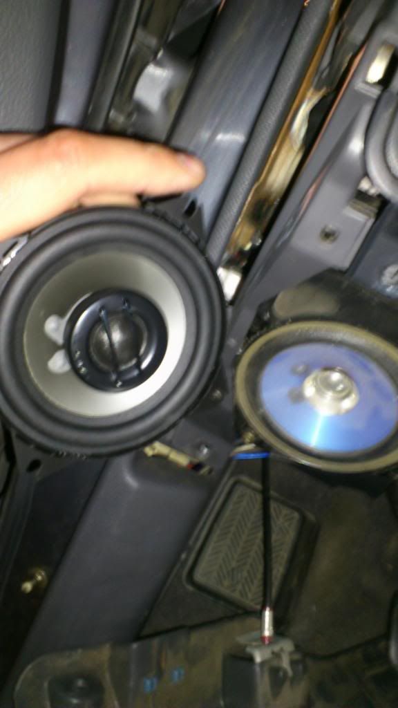

speaker install JL c2 4 inc

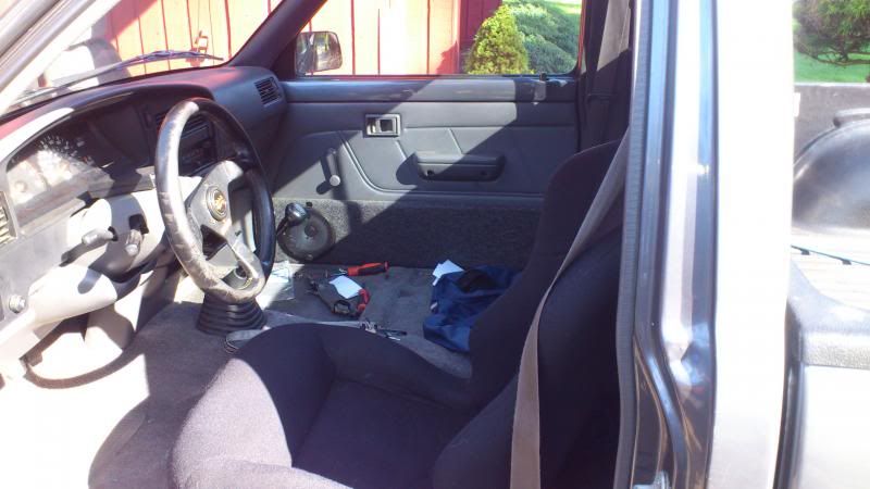

seat's and custom brackets

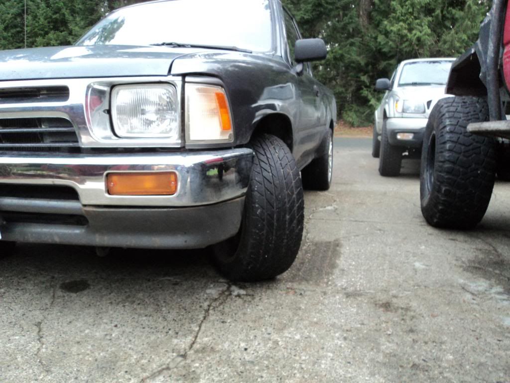

lowering
[/QUOTE]
before
after words

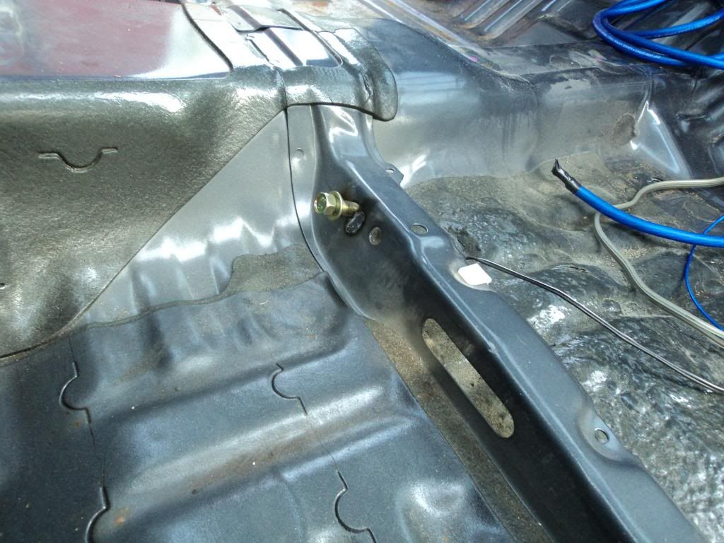

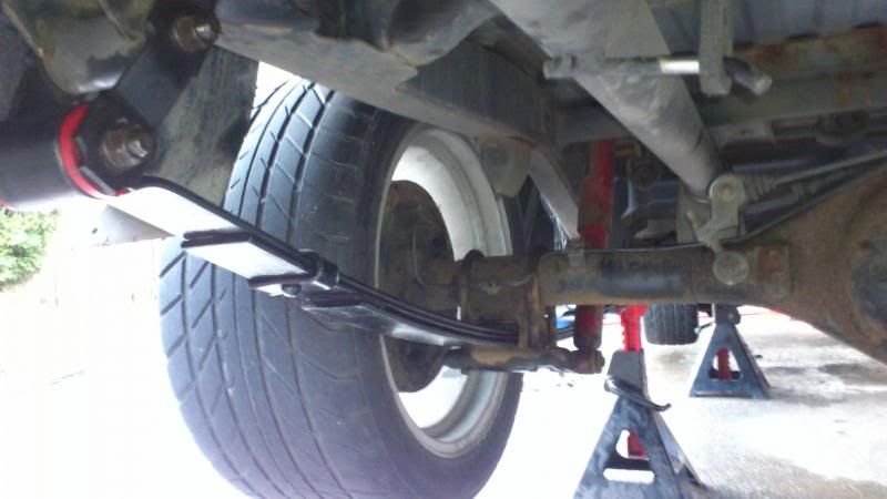

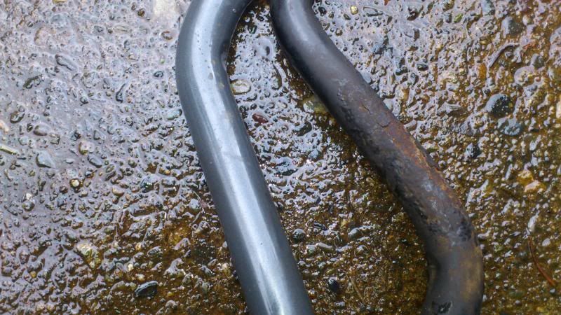

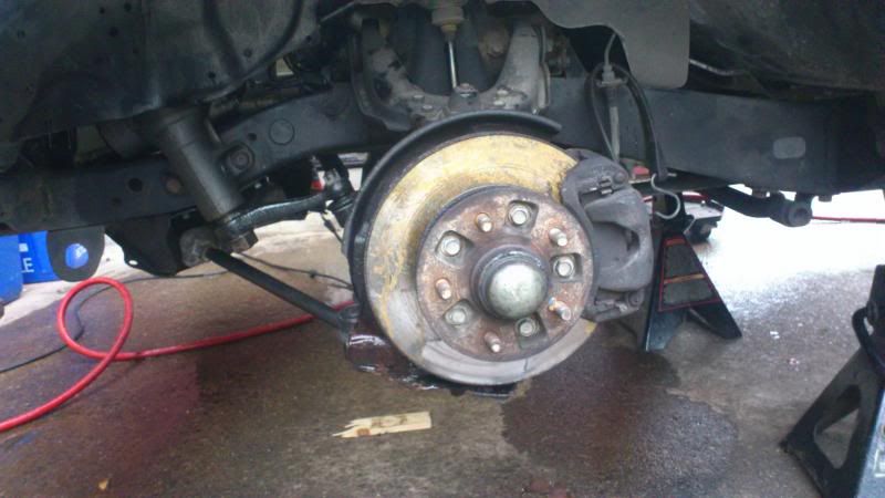

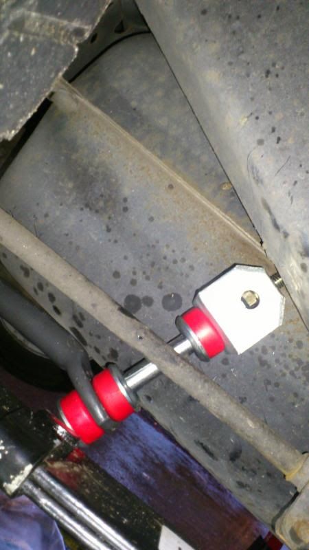

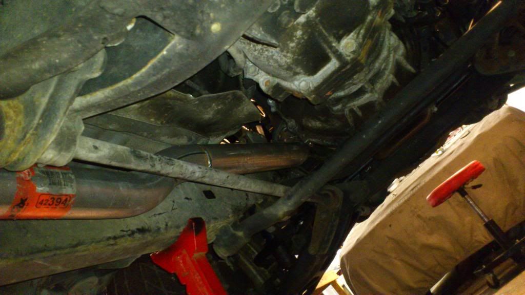

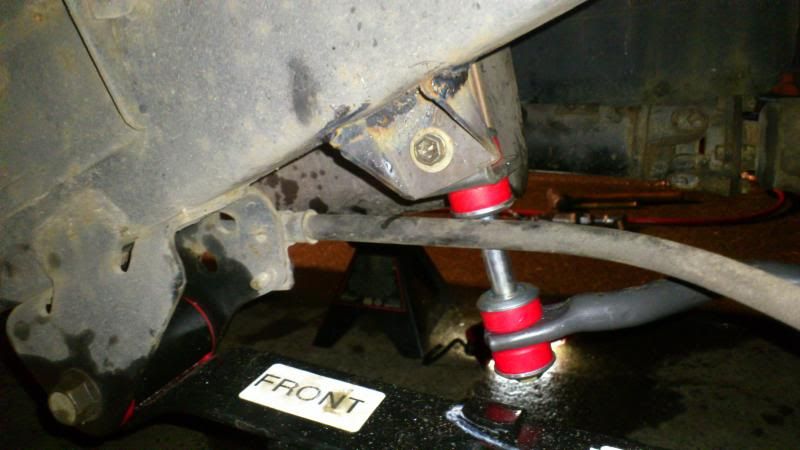

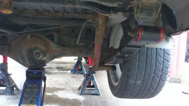

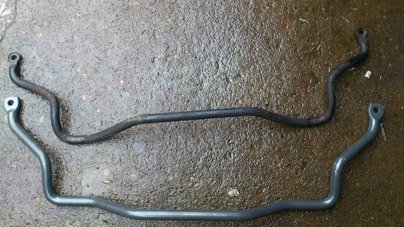

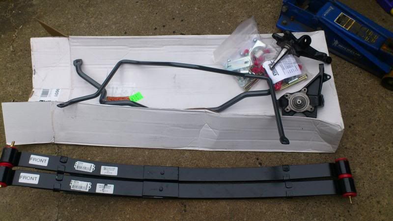

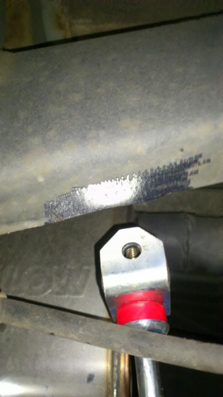

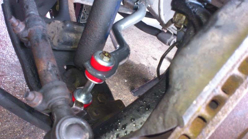

Well today really sucked snow, sleet, hail, rain and gale forced winds grrrrrrrrrrrrrrrrrrrrrrrrrr but the sway bars are in the rear bar did not fit all to well at frist but I made it work. I made have to shorten the end link abit bet but after today **** it not even sure my mounts are aliened right, but it's an easy fix
further more my welder broke so I had to whip out old trusty 120 since the trigger would not work after a bunch of testing look like it the main contoler for wire feed has an issue grrrrrrrrrrrrrrr some more.
oh ya the bell tec rear bar does not fit right since it is made for a 4x4 4 runner or a 4x4 reg cab wtf
any ways here some pic i going to drink my self to sleep tonight then wake up to go get the truck alined at my buddies shop I have nice aliment planned so it should turn out pretty sweet
well here is the front bar beside the stocker
pic is not great but it is bigger

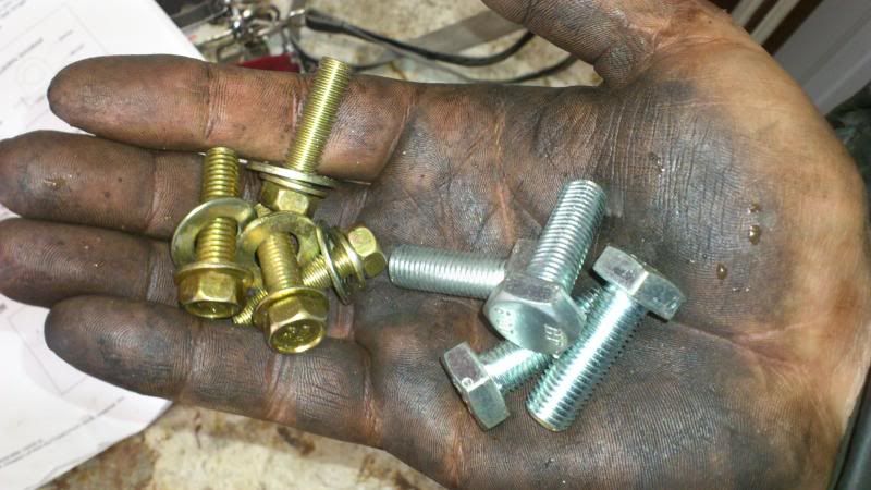

bolts they gave me but did not fit must be for 4x4 replaced wit new bolt's the good one's are gold

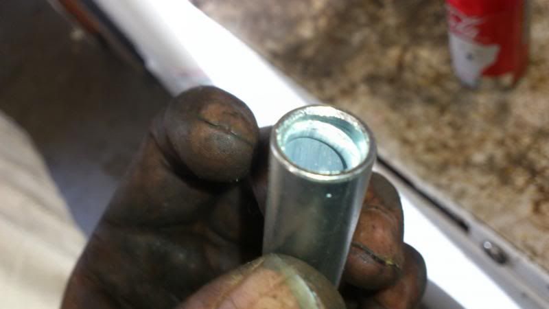

for some reason the collect for the end like had some **** in it so i had to drill it out
front bar installed

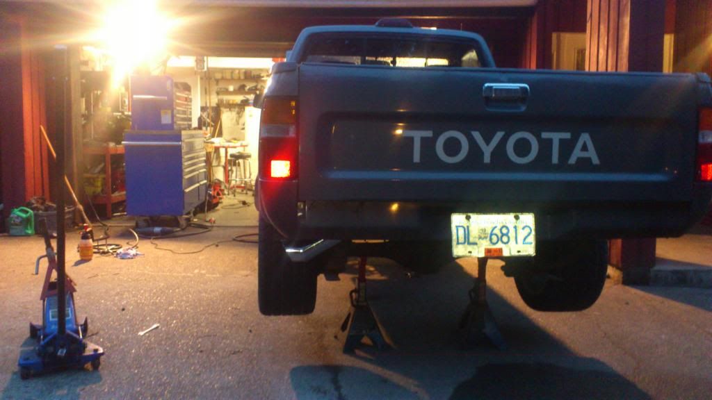

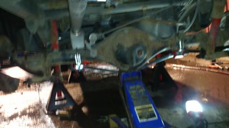

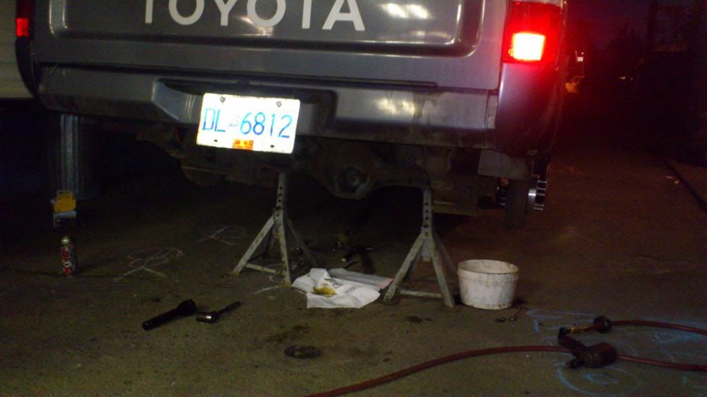

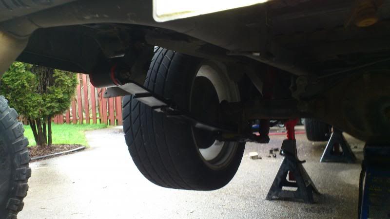

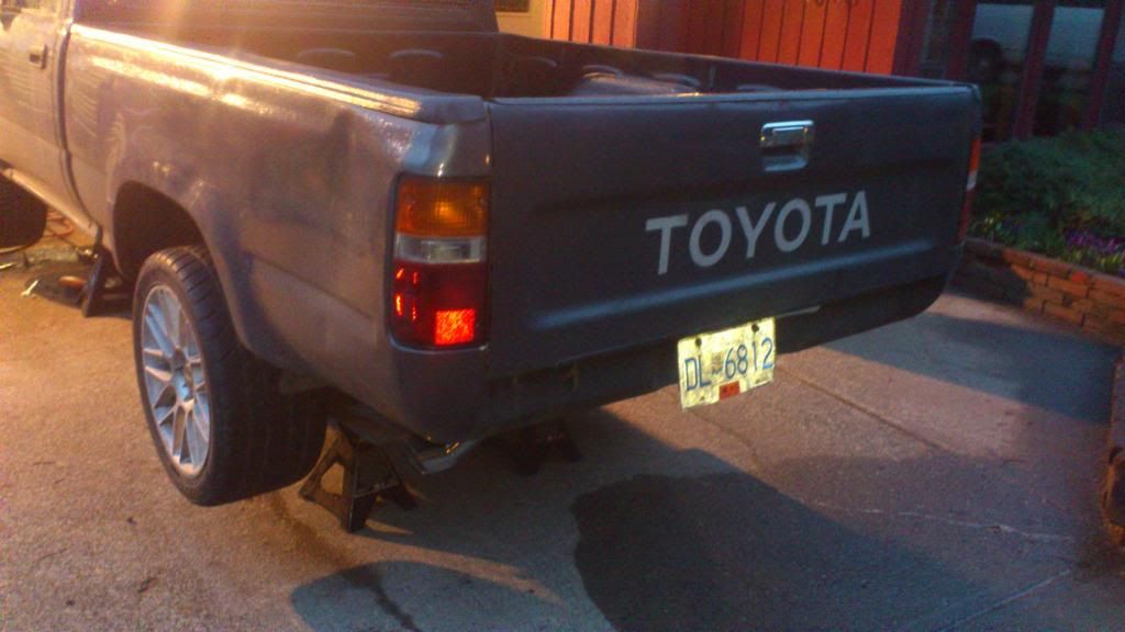

jacking the rear since no one has scene the drop leafs

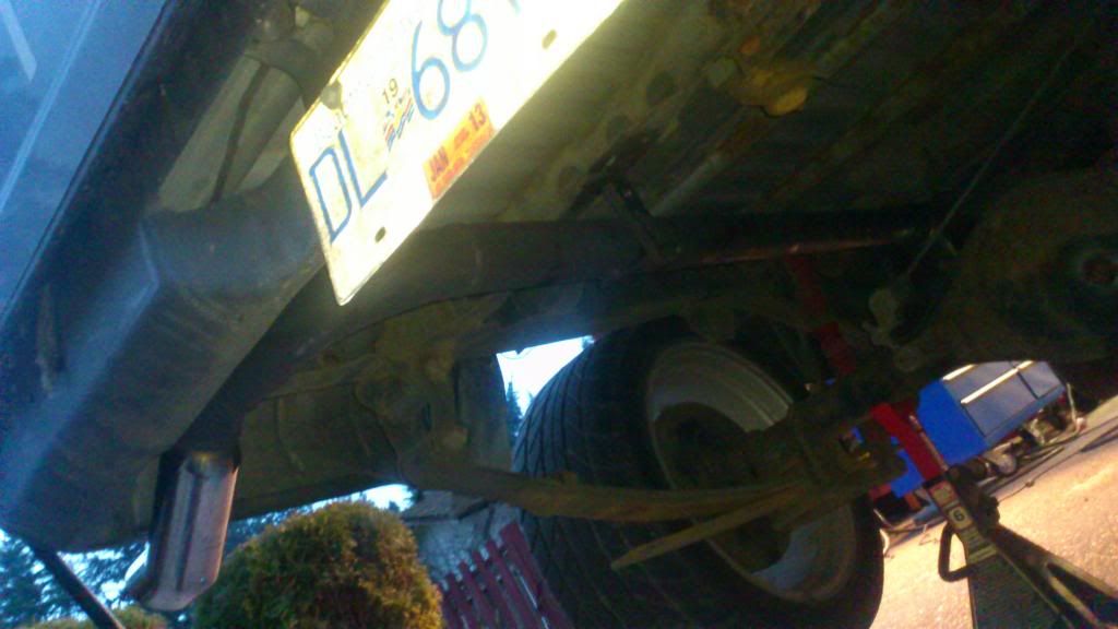

**** don't fit but i will make it work gas tank in the way

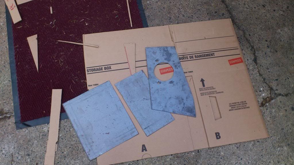

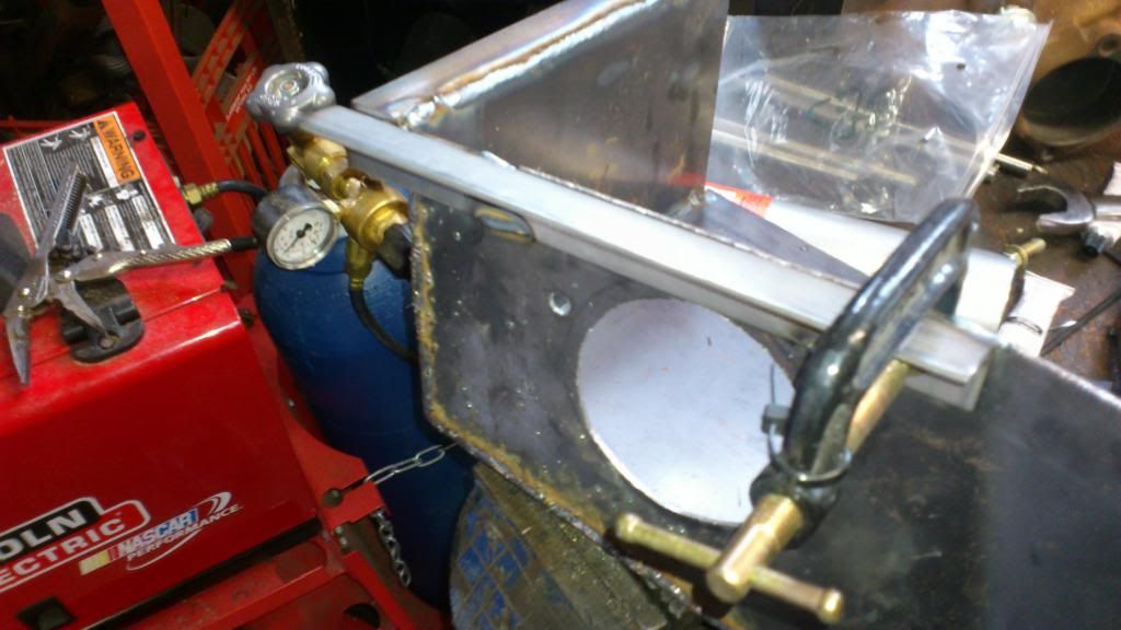

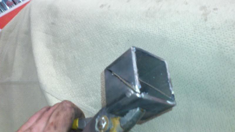

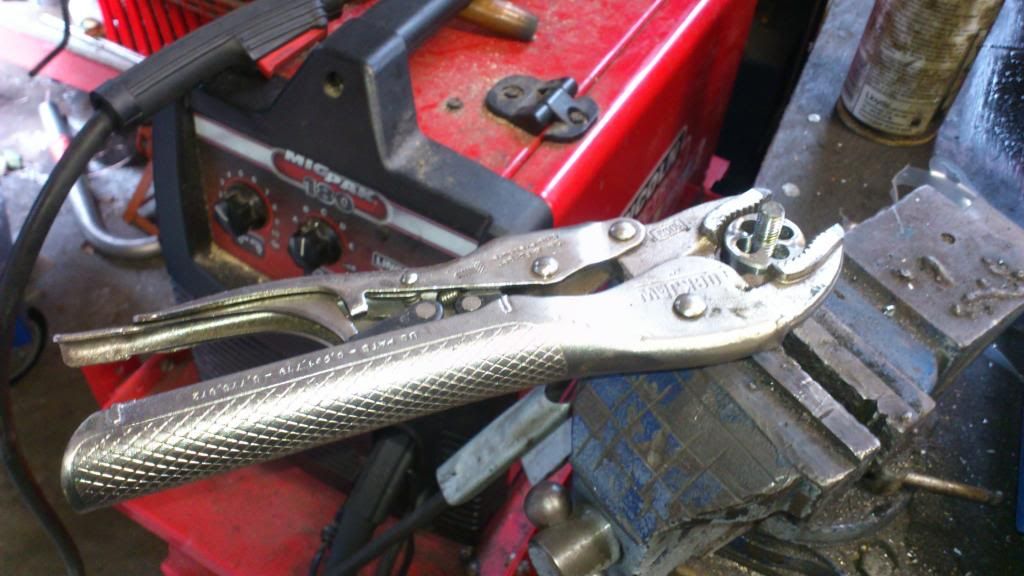

grounded do so i can weld

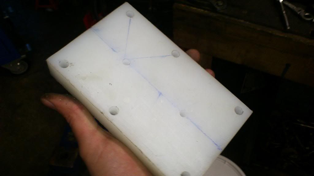

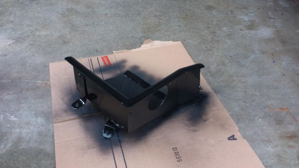

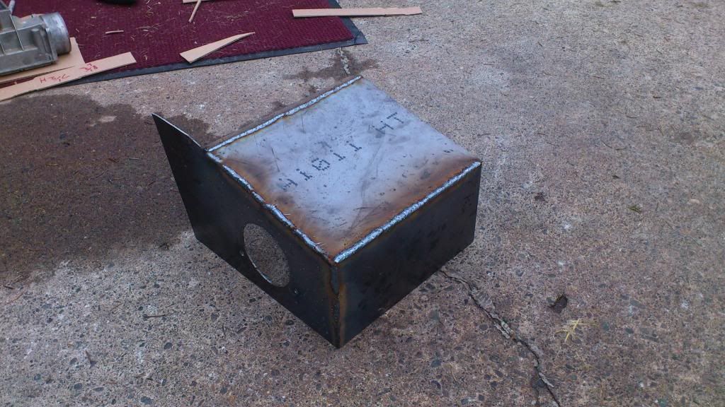

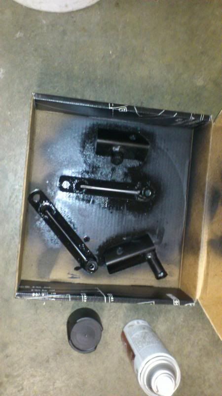

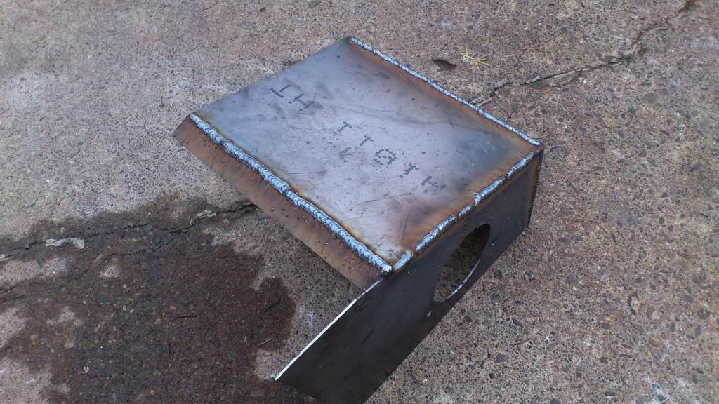

custome bracket to make it work
install with ****ty 120 welder but it did it's job
****ty shot of the rear at this point i did not care
