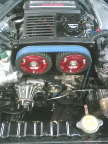

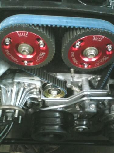

Well the tare down begins ...
Here is what were chasing

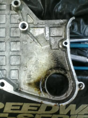

With the pos(you will see below why) timing cover removed.
For $150 you get JUNK. The cover after 1.5 years, and less then 2K miles is already cracking. I am going to send ATI a email about this.

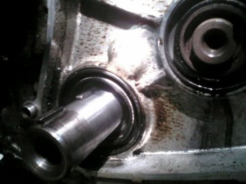

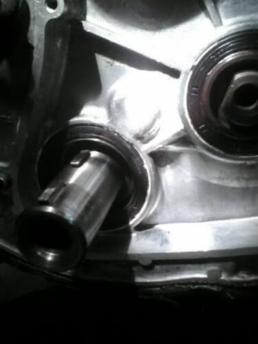

After getting everything removed the problem became obvious.............. My engine builder installed the seals backwards!!

^^^^ I think so, Only thing I can think of is that he installed the seals in the cover first then bolted it to the block. Other wise there is no way you could press in the seal backwards. There's no face to press from if the cover was bolted on first. O-well, live and learn. The old saying stays true, " If you want some thing done RIGHT, do it your self " .
Unless there is something Im missing and Toyota installs there seals with the face of the seal in toward the block and the spring out, away from the block?

Ok here we are some pics :)
Now on to the leaks

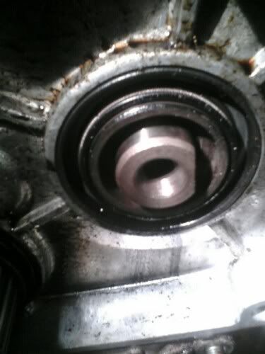

The next couple pics you can see the seals that are backwards :(

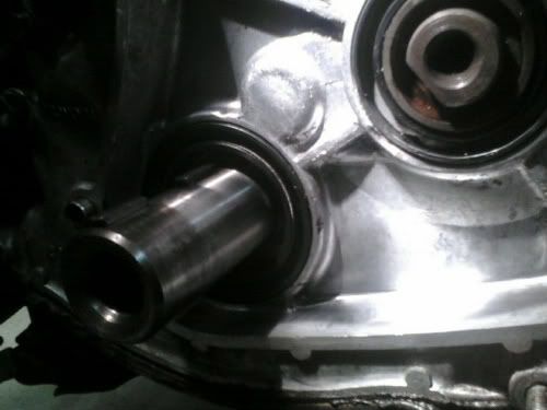

Here it is cleaned up
Today I'll remove the the oil pump shaft seal, can seals, then reassembly will start.

Yep pretty sad. And yes im also how little the leak was. One good thing is at least it wasn't catastrophic failure, or a mad oil burner like some of his other engines he built ;)
Well the new seals are in & hopefully installed the " correct " way-direction, lol. Yes the outer edge was pre lubed with lithium grease, and the inter sealing surface with Mobile 1 synthetic grease.
Almost back together now.
