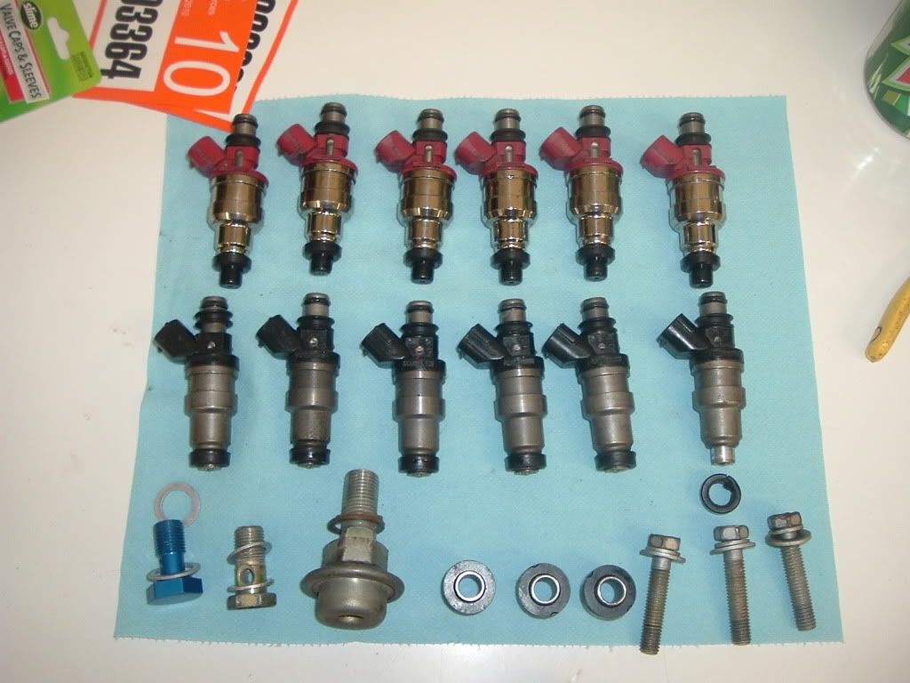

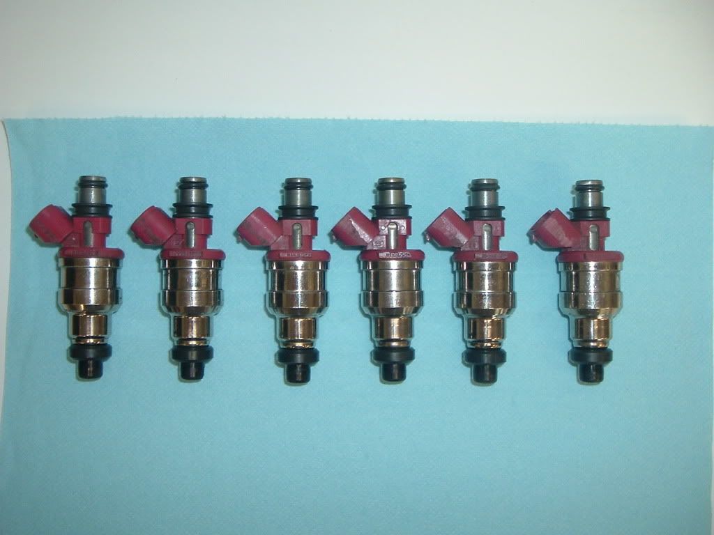

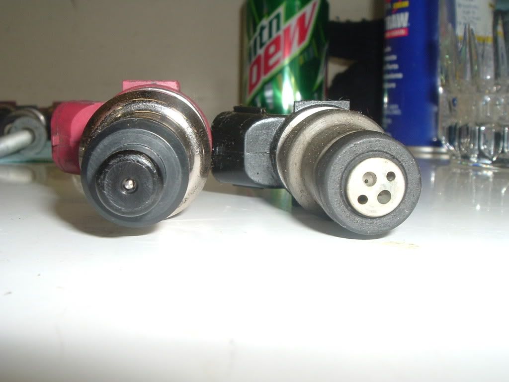

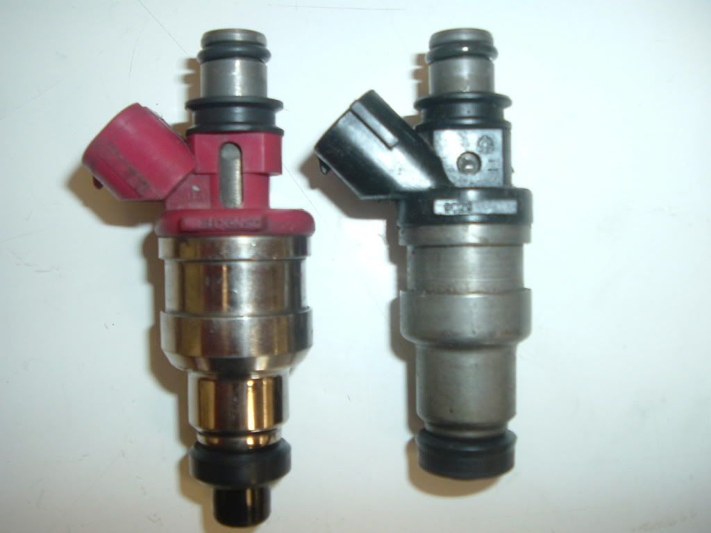

last night I started to R&R the injectors, until I checked resistance on the denso 195500-2020 I pick up. :( there high and not low. I swear they put 195500-2020 on what ever injector they wanted. They "should be" low, with a purple top, yet I have high with red top,..... but what ever.
So I was trying to pull info out of my memory bank from when I put these in my last supra (10 years ago). But there was to many cob webs in the way so to the phone I went to call a couple people. Long story short, I will still run them. If I leave the resistor pack in place they will be a little "laggy". By-pass it they will work perfect.
So hopefully Hundo will pick up my 2 scrap harness for a person in Cloud, so I can make a nice looking jumper for the pack. Other wise another option is to run down to Wayne's house and pick up his scrap harness to make one.
This morning i will head back out to the garage to finish up the instillation.

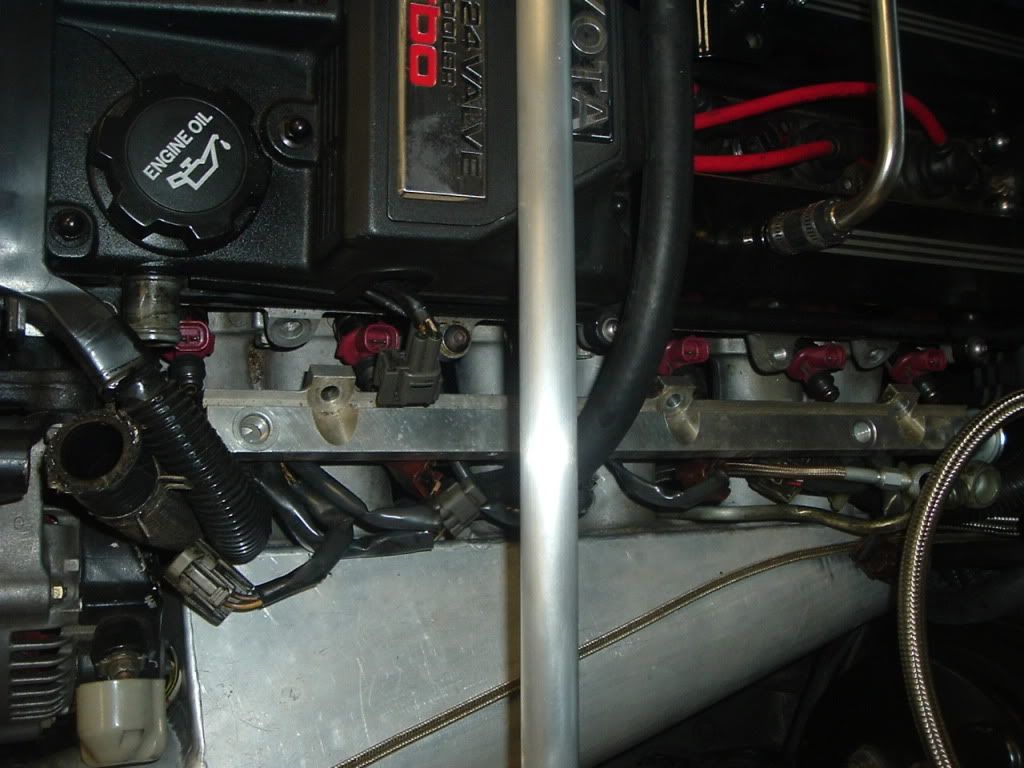

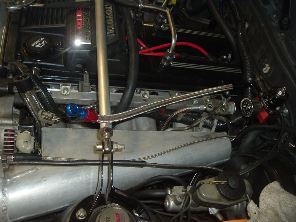

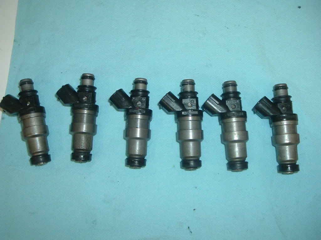

Well today after getting back from Back to the 50's, I finished up the 500's and lexus install. And for the record high impulse injectors work just fine on the TCCS from a 7M-GTE ;) But I will still by pass the resistor pack once I get the harness's. Every thing went together smooth. One problem, Im guessing the A/R is all messed up (no piggy back) because now once warm it wont idle for shit. Jumps between 250 then 500 rpms for 5 seconds or so them just dies.
After everything I took her out for a quick test run. It is definitely better but still not up to par. It pulls a little harder and No fuel cut witch is a huge bonus! Yes it is only set at 7 lbs. but creeps up to 12 ish once at 6700 rpm's or so. The best part it pulls all the way and I almost need to spin it to higher rpm's but need to see a dyno graph to make sure. I know last time on the dyno with these cams power didn't fall off till 5300 ish on a stock turbo where other I have seen were all done at 4800 ish rpm's.
Once it dose reach the 12 psi mark it starts to really come to life! I can't wait till Im able to run 17-20 lbs. It should be fun. I still have no bottom end (below 3K rpm's) but I guess that is the trade off for this turbo and cams.
But good enough for now till the piggy back (or standalone and once again new fuel system) comes and have it tuned in since I don't drive it any ways besides maybe 20 miles a month. Also I still need to buy a smaller air filter, the K&N is still way to large to fit in the area I have available.

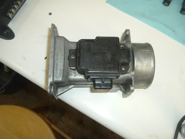

This is all that had to be removed (besides the 550's waiting to be installed)
Lexus AFM

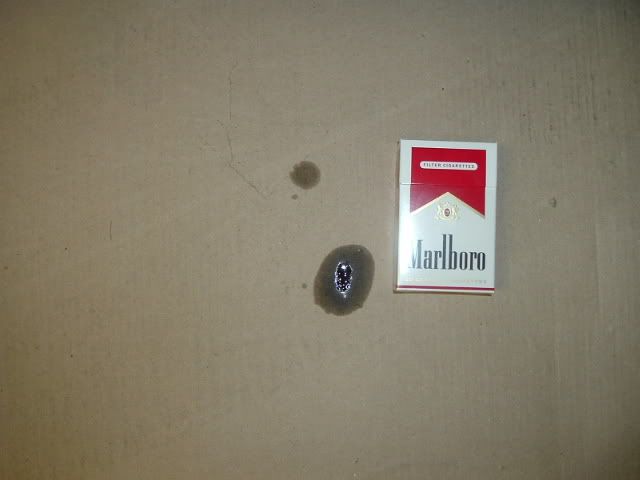

Also for the record here is how much it leaks. It only leaks once the engine is warm when I just back it out of the garage it don't seem to leak at all. I know not much, but I still don't like it. It looses about a quart ever 3-3.5 K miles that I have noticed.

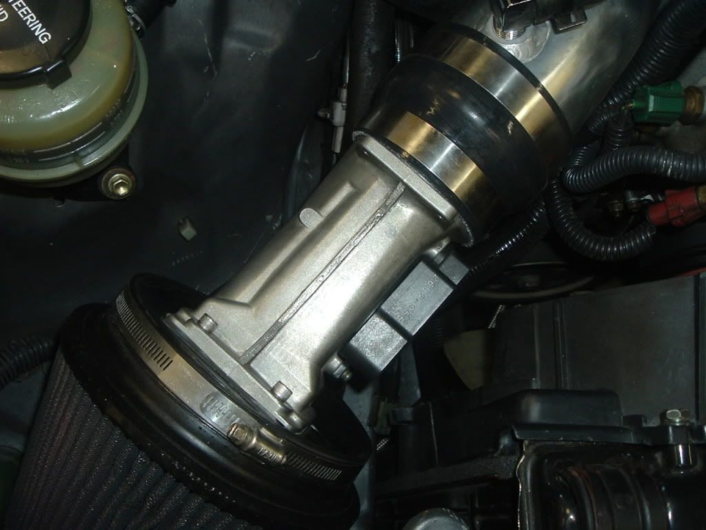

I have an adapter, I think... Does the lex use the stock air cleaner bolt pattern or not?
Yep it has the same pattern ;)
Mr.Yuk;1583526 said:
I have an adapter also on my GE AFM...
Those I dont know about. Test fit it up against the AFM you have.

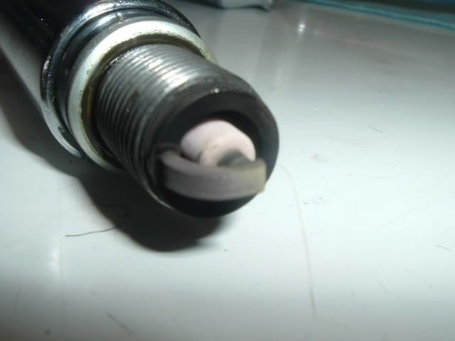

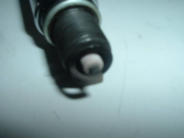

Also here is a random plug (cly 5) I pulled. Well it don't look rich, but might be a tad bit on the lean side or a/r perfect under boost at the whole 12 lbs of boost creep! So pretty much she is done until a dyno pull with A/R can be done. Any one know of a dyno day coming up at all local? The flash made it "look" a little whiter in color.
What do you guys think?
