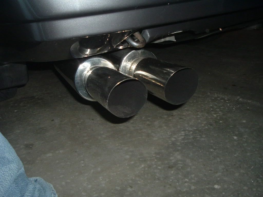

Well this after noon I was board for 20 min so I removed the HKS exhaust and re installed the other "custom" twin pipe. Time to be loud for a couple weeks then I will take her off again.

yes it is very low:( It sound pretty good I guess after talking to a few members after the meet this past weekend. But it is not staying. The HKS will be going back on

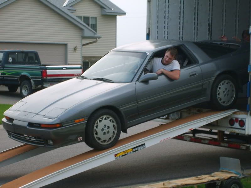

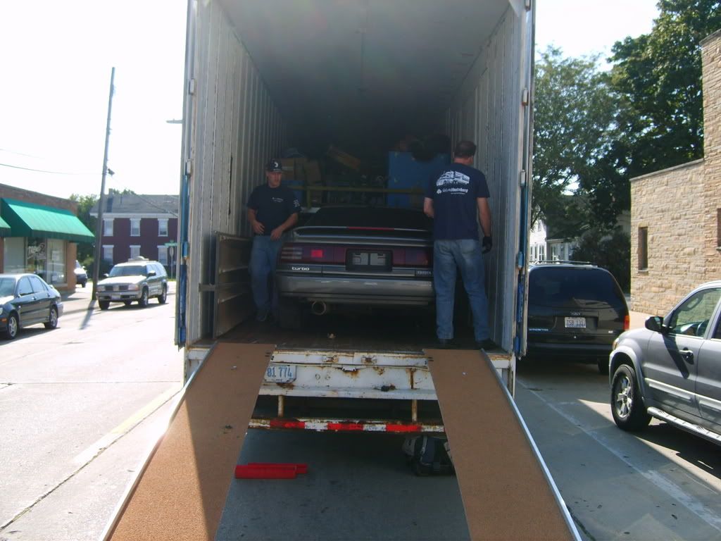

ROFL, you are the winner! I wondered how long it would take some one to notice that. IT only took 2 years!!.
Well when we loaded it it went in nose first, from Rockford, IL. Once we got to Minneapolis we had to unload the trailer and all the boxes and furniture was in front of the sup. So when we were at the loading dock we pushed the sup out of the way on the dock and unloaded our cargo. When it came time to load it back up for the last hour drive home it was easier to reload it ass end first.
In short, used a loading bock to unload the cargo in front of the sup, then reloaded it.

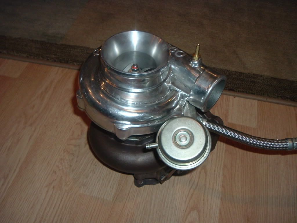

Suprasports "P" trim, Stage 5, GTS GT61, .81 A/R on the exhaust, Triple ceramic ball bearing. I guess it is Comp Turbo's equal to Garret's GT35R.

Well Anyway I went on down to SS again today to pick her up. Nice a shiny, whoo!! It should look pretty good under the hood of my sup. Now to find another storage spot until I upgrade this winter. LOL, my storage room is getting full.
Well here are some specs on it from Greg,
Comp turbo, GTS-CT4361,"P" trim, Hi flow at low boost, .83 exhaust trim, 4" inlet, 2.5" exhaust side, Triple ceramic ball bearing. His housing flows 78 (he couldnt remember what).
Pretty much this is equivalent to a Garrett GT35R (since every ones knows what a Garrett is, lol) but only built by Comp Turbo. And the best part is that is is plug and play for my 7m, and can support 625 HP.
Jake said this is a nuts turbo. Third gear give it some throttle and watch out the back end brakes loose and will spin you right around if your not careful. Well so much for talking on to a couple pics, lol
