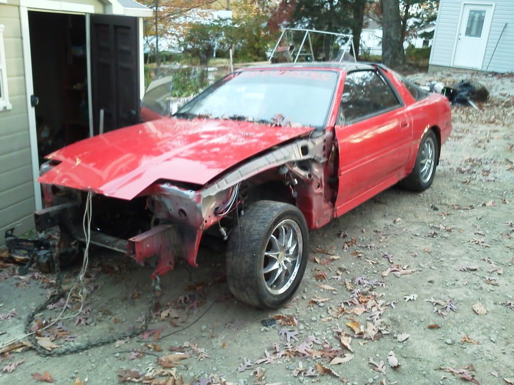

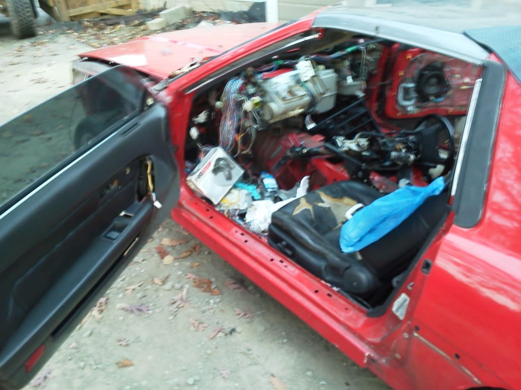

Fair enough...I guess I am in the minority. I must have dealt with him while he was PMSing. Judging by the feedback odds are you won't have trouble with him. But I still would never recomend dealing with him.
Anyways, looks like you got an aswome Supra. It deffinetely is in way better condition than my 92 red w/ black leather
Although it was a perfect donner car for some non rusted rear quarters.
