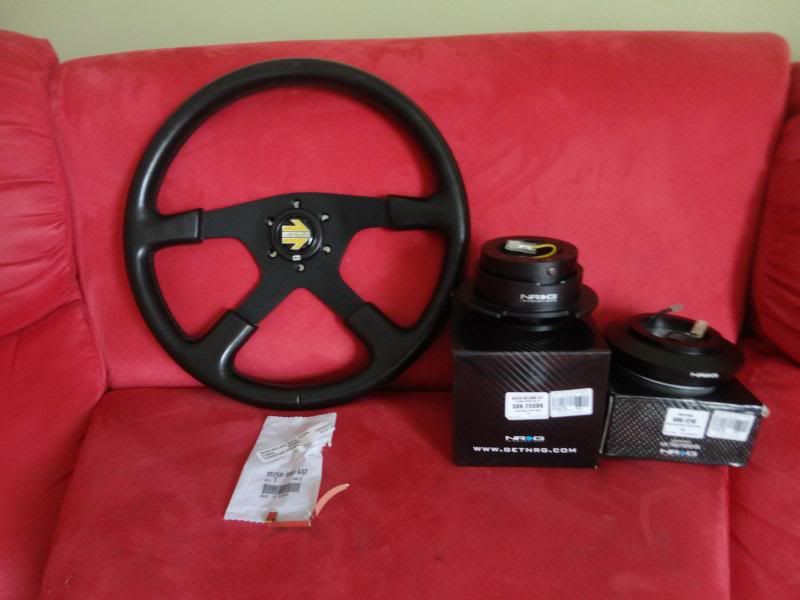

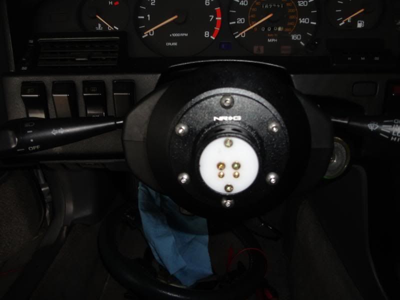

Well its been a while since i updated, I got to do a few little things like replace the 2 square bump stops located on the hatch, Thankfully DM includes new screws, the original ones got stripped cause for some reason Toyota decided to put locktite on the...

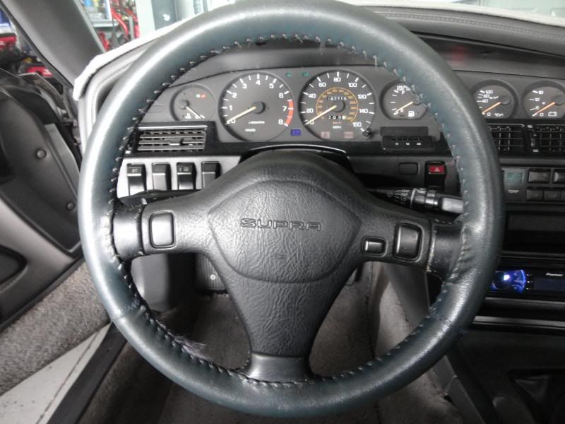

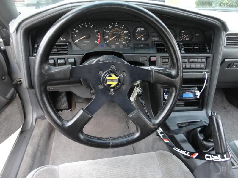

Then decided to change up the interior a bit by installing a Jza70 Steering wheel with a NRG short hub and quick release:
Before:
After:
I made a diy if your thinking about doing the same:
http://www.supramania.com/forums/sh...steering-wheel-install-with-NRG-quick-release..

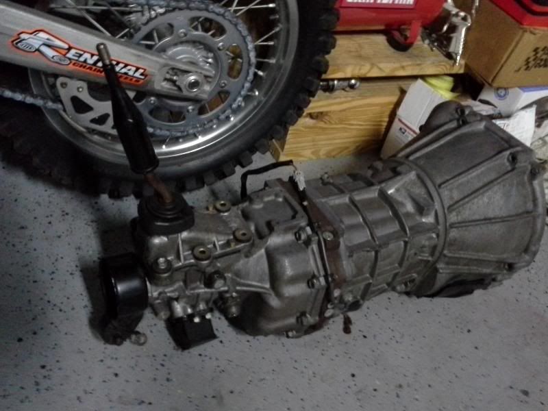

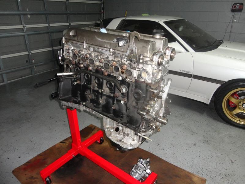

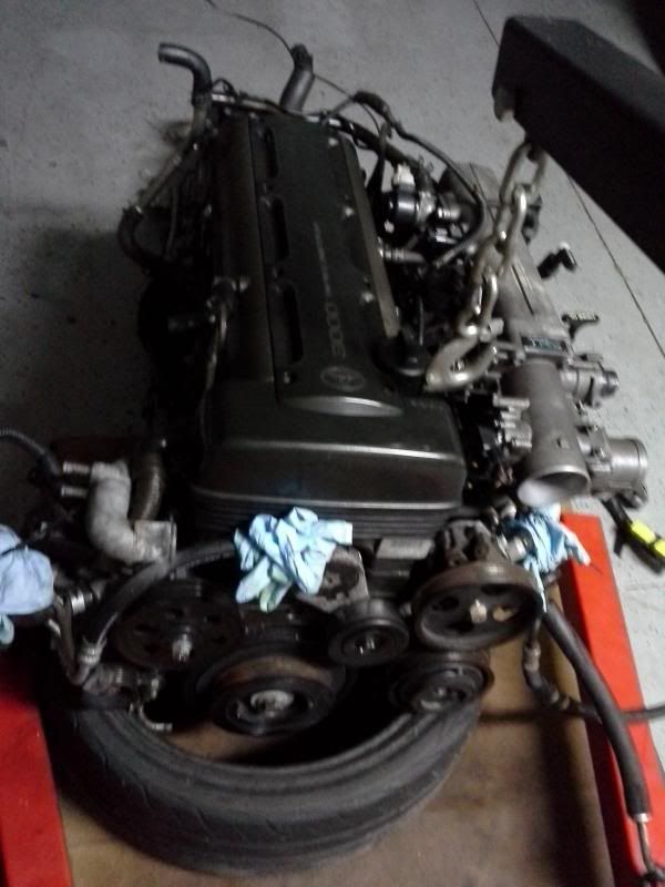

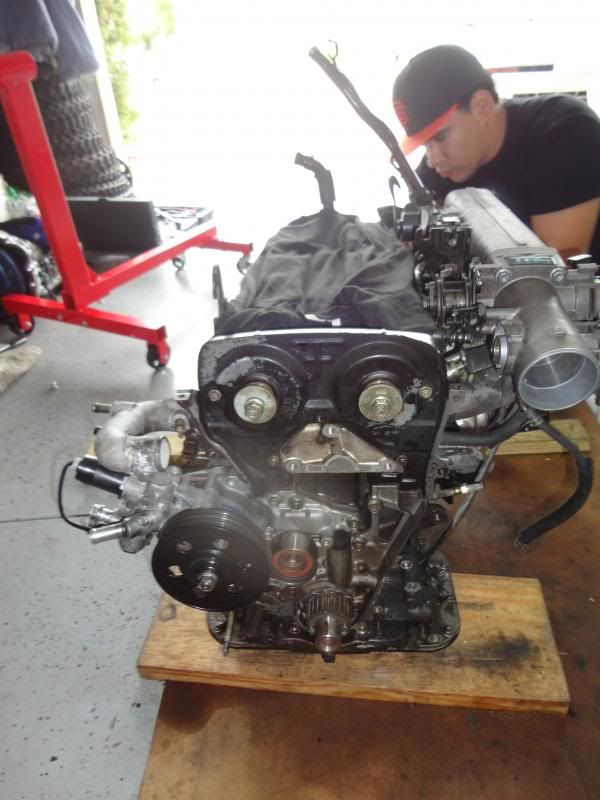

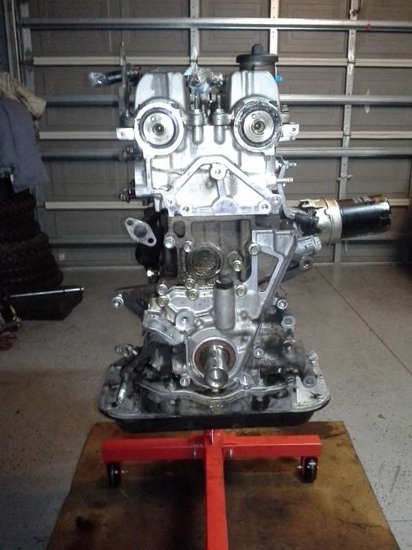

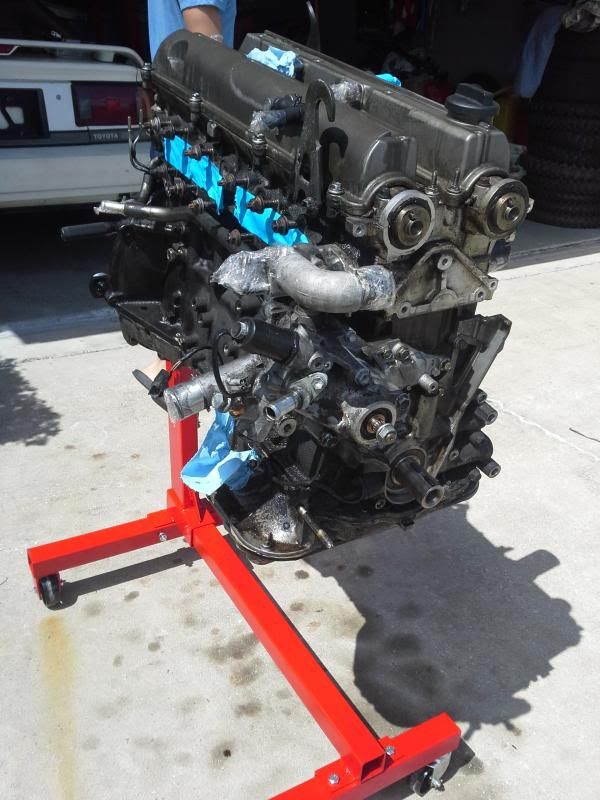

Update:

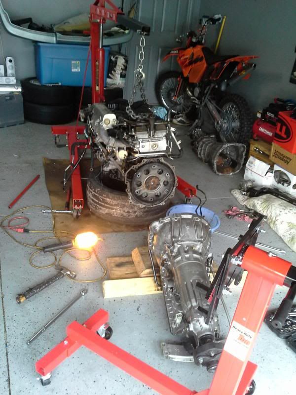

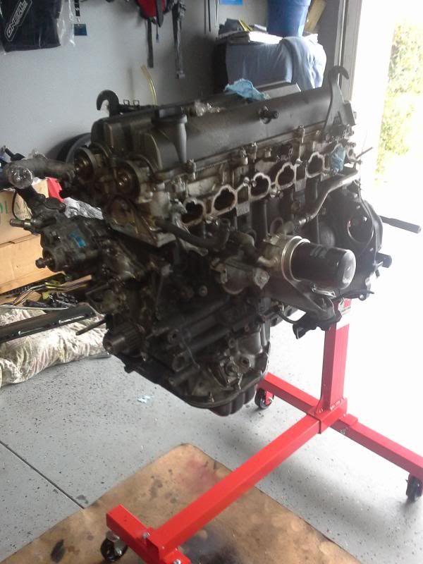

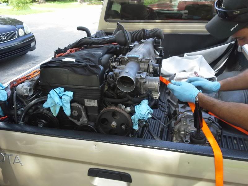

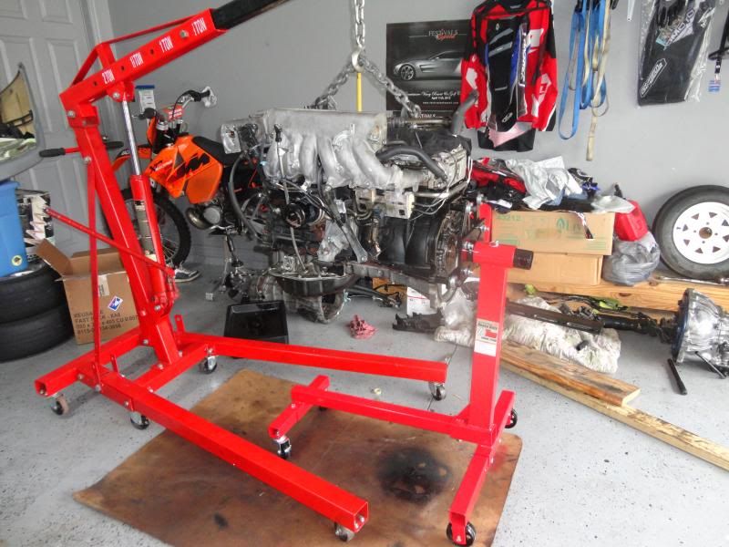

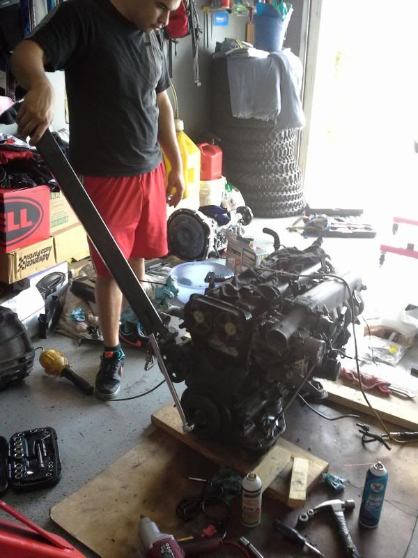

This past Sunday i get a call from Suspectsupra aka Pedro regarding if i was interested in a jdm 2jz engine he had for sale, We basically agreed in a price over the phone and next thing i know the motor was being delivered to my house the next day. I got a aristo 2jz, rear sump(not installed), R154 and jz bellhousing.
Here are some pics of receiving my first 2jz:

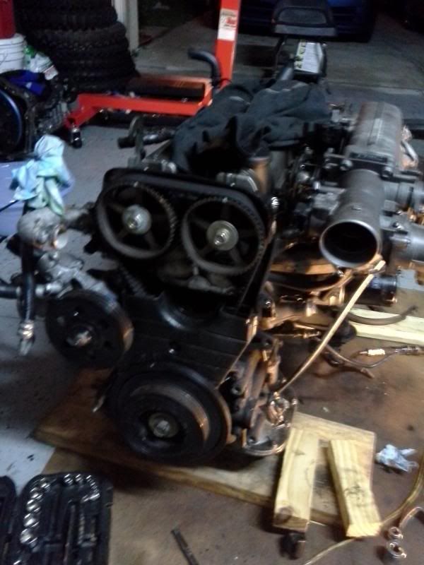

The next day i started removing parts to begging preparation for some new parts:
Trying to break loose the crank bolt with my cousin without sucess, had to call Pedro for help :1zhelp:

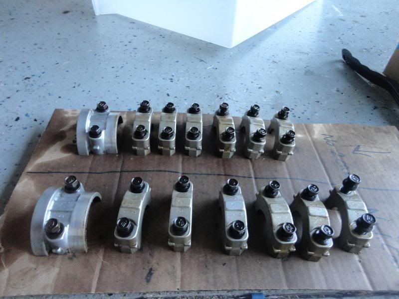

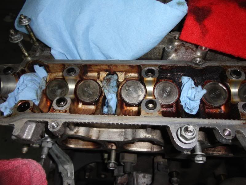

Cams are dirty so i will be removing them for some cleaning.
A bit of cleaning:
Need to start ordering parts soon. I will be replacing:
-water pump
-oil pump
-Cam seals
-front and rear crank seals
-timing belt
- timing idler pulley
-timing tensioner
-replacing front sump... etc

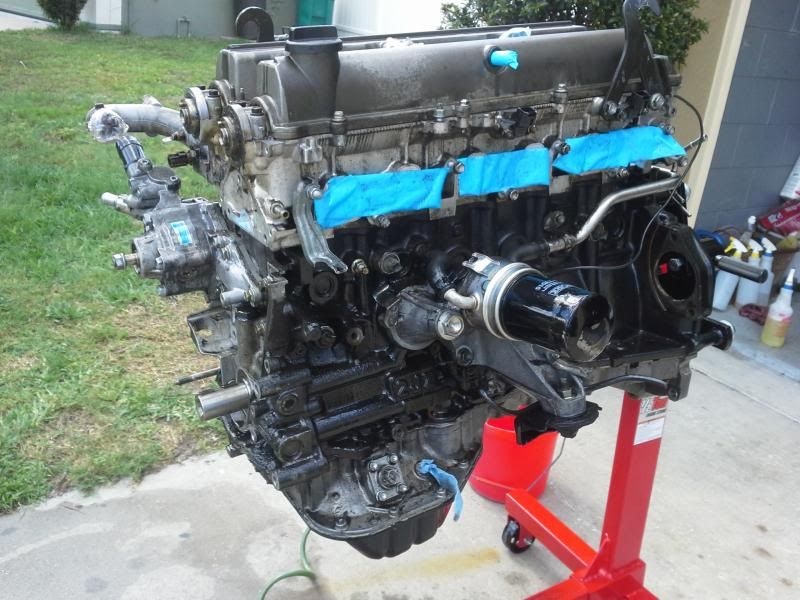

Thanks, yes you are correct this a 2jz-gte which originally came twin turbo from factory. As far as plans go i will probably go single turbo with a borg warner s360 aka 83-75 or a s362 and possibly using a cast manifold. Plans might change but with that setup ill be fine.

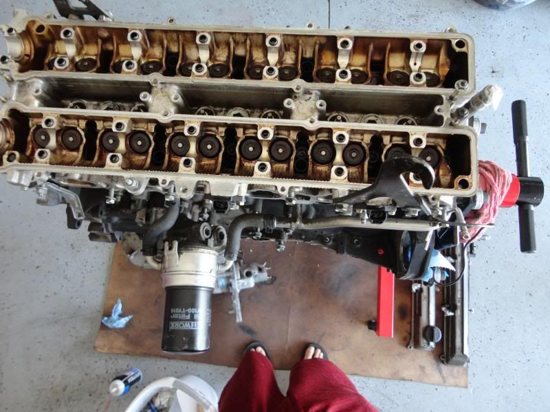

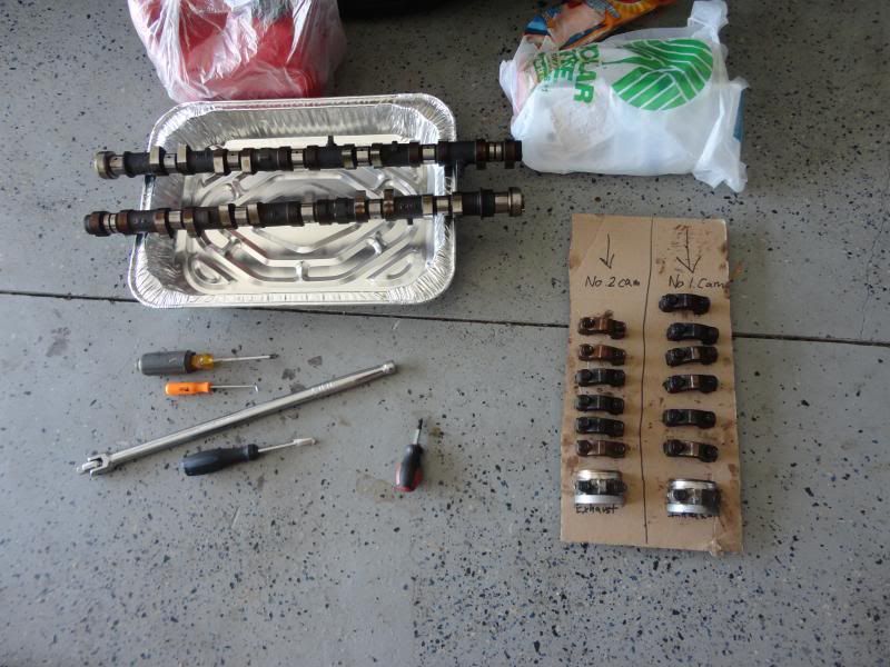

More updates:

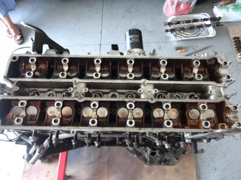

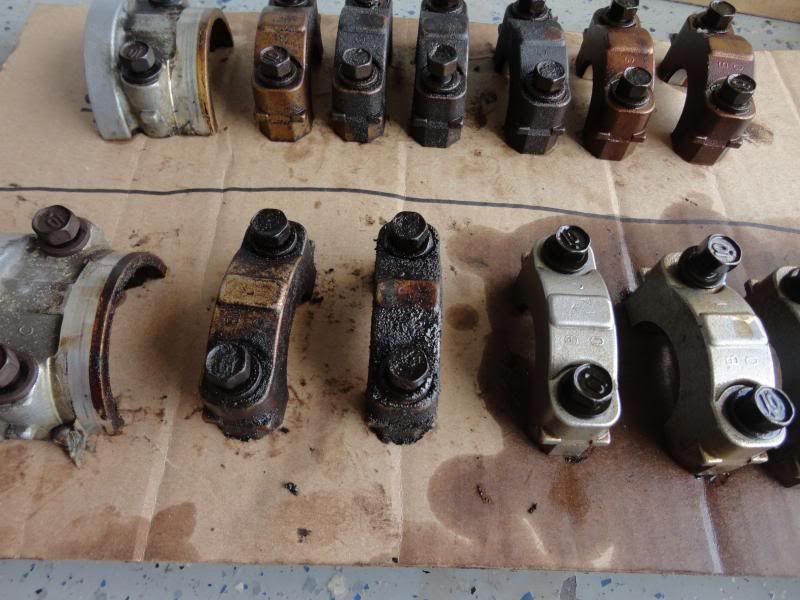

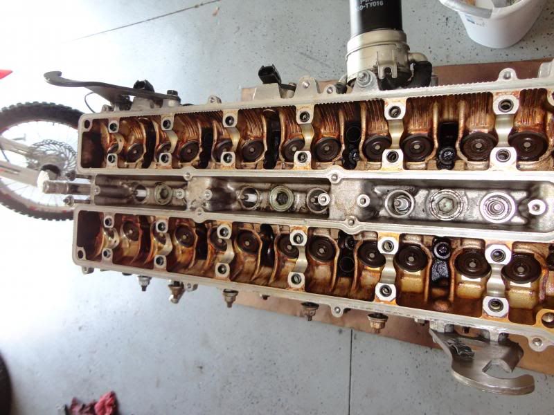

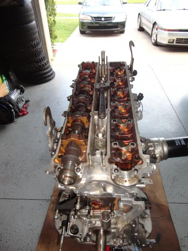

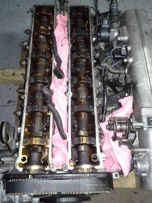

Started to take the cams off and clean them.
Before and after using diesel fuel and a wire brush:

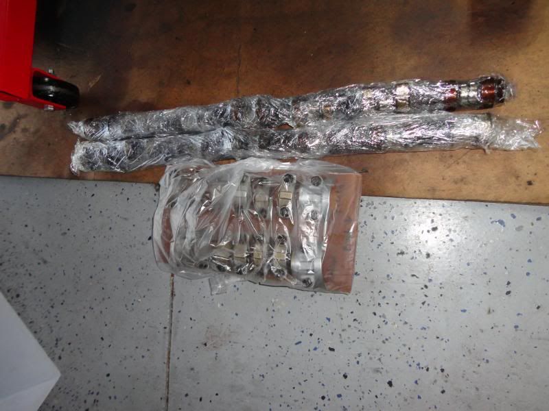

Packaged for storage:
Before and after cleaning gunk:

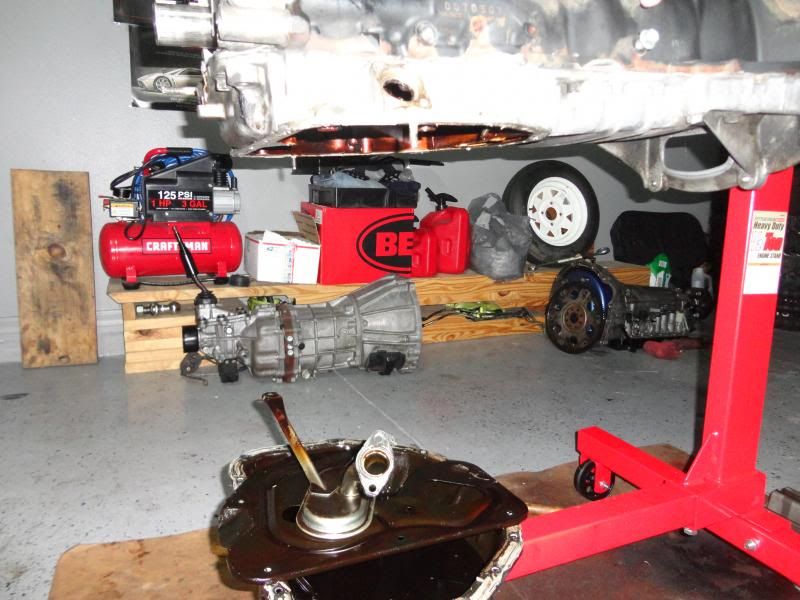

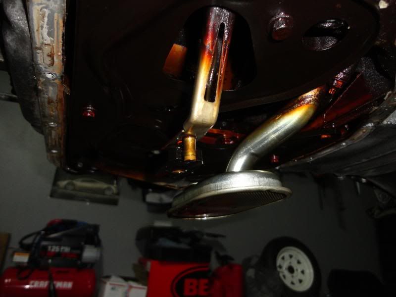

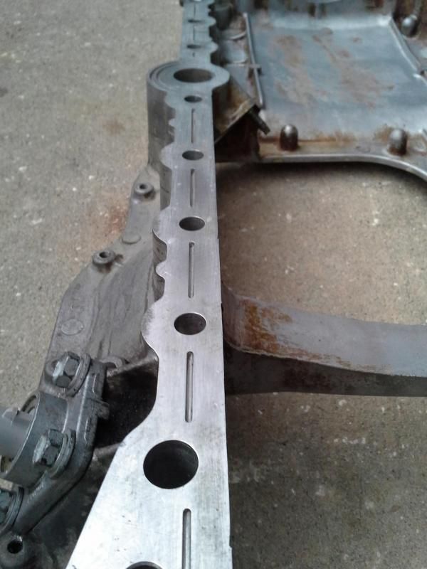

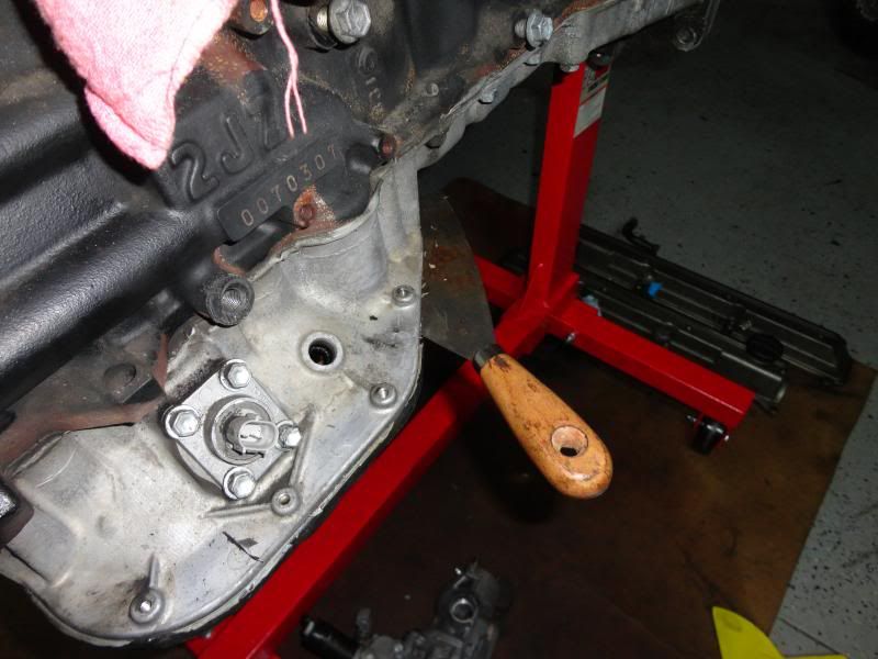

Removed the lower pan, baffle and strainer:
The next update will be removing rear seal plate, Oil pump and upper oil pan.

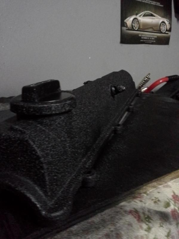

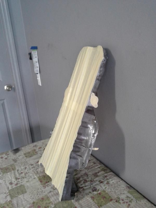

time for a needed update.

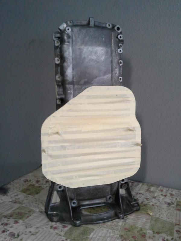

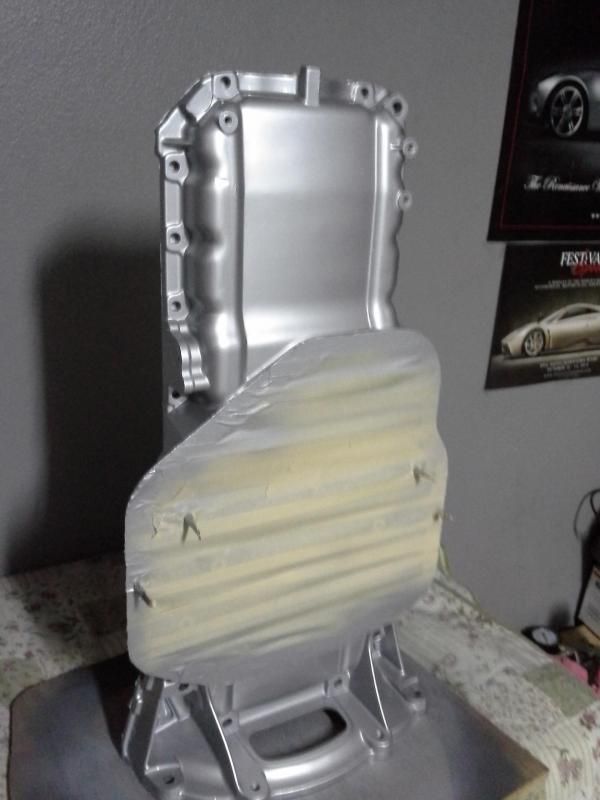

Cleaning the oil pan surfaces and prepping for paint:
After some duplicolor high-temp:

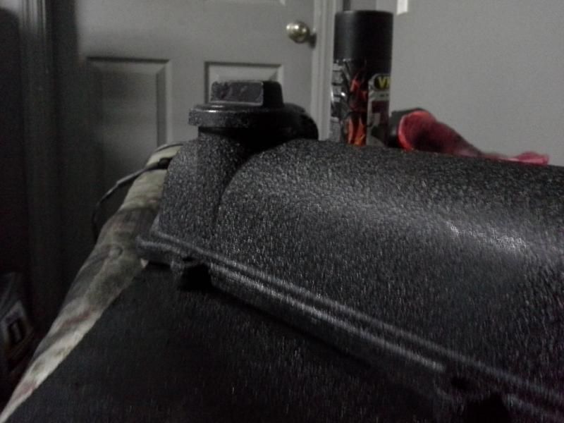

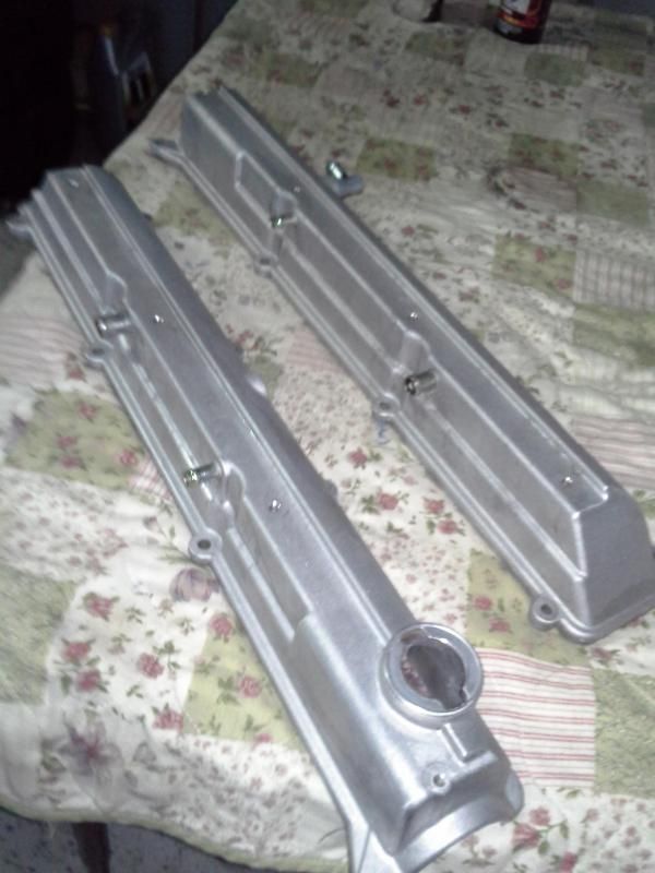

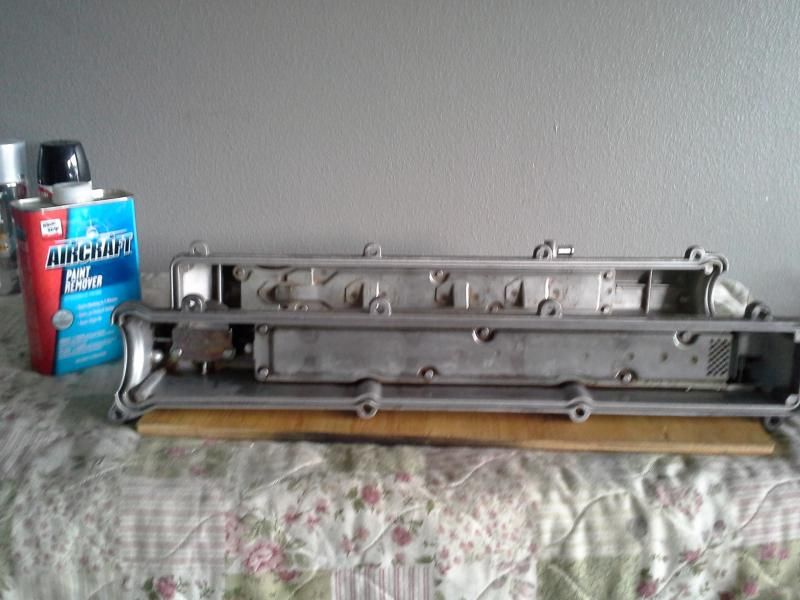

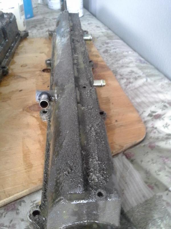

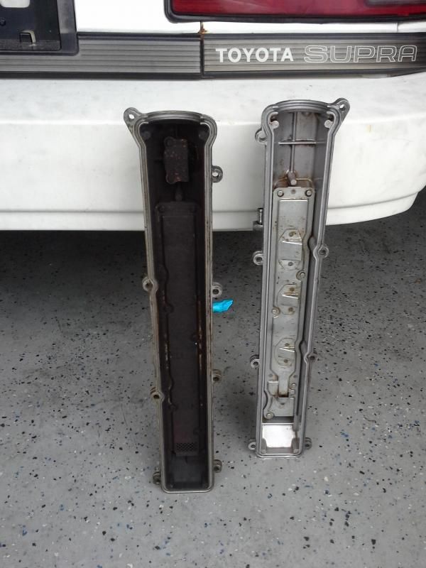

Next was cleaning the valve covers and paint prep:
Heres after painting with VHT wrinkle paint:
