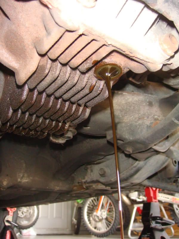

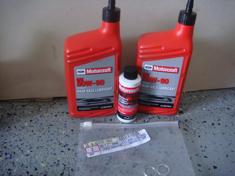

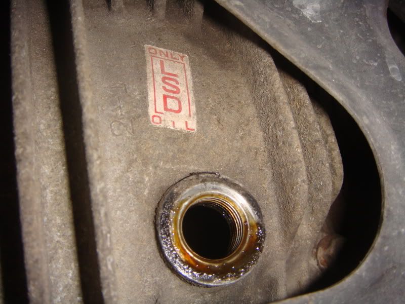

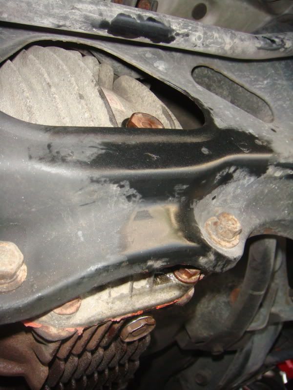

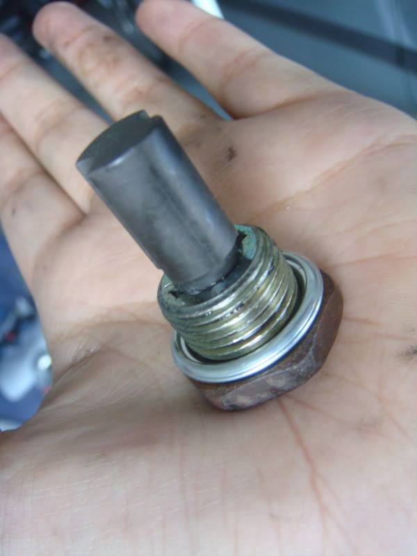

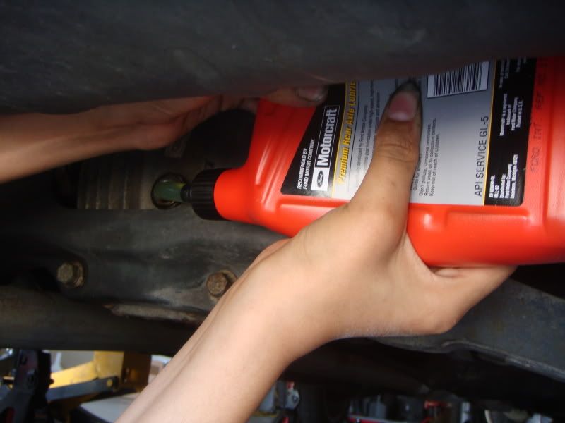

Today i went ahead and flushed the diff and the tranny.

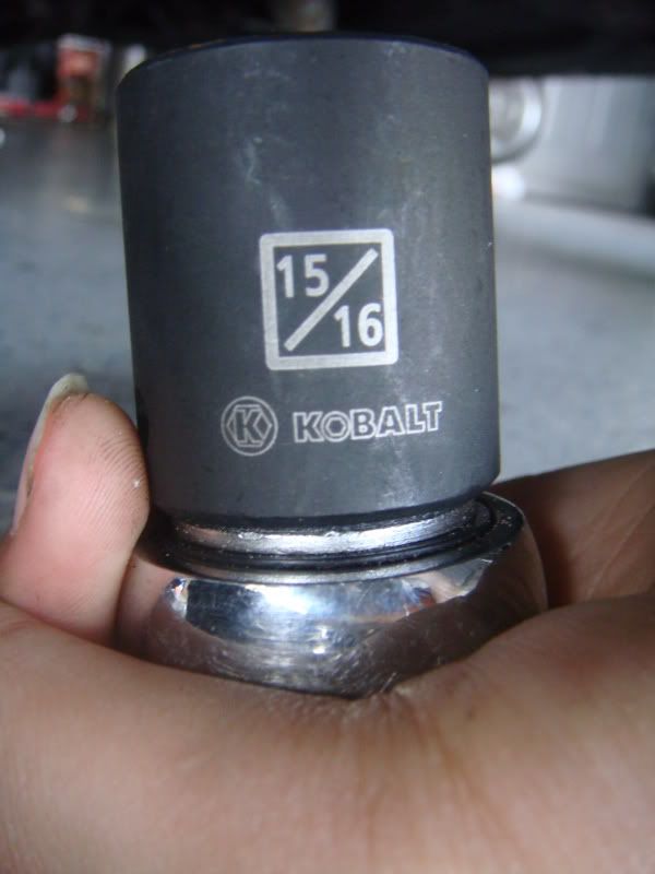

For the Diff i used 2 quarts of motorcraft 80w-90 and the lsd additive with oem washers.
Had to get a 6 point 15/16(24mm) socket for the fill and drain plugs
Yuk

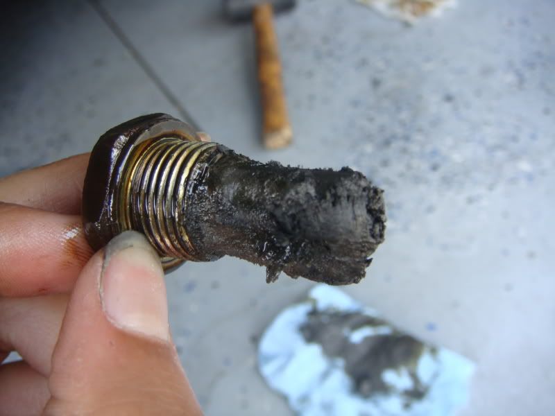

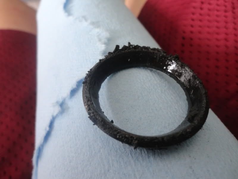

The magnetic drain plug was all covered in some type of gunk with metal shavings.
Cleaned

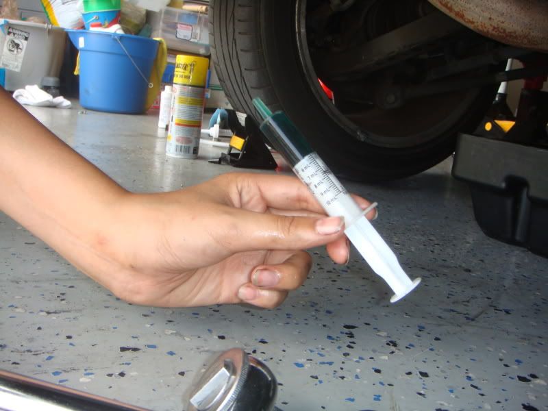

Adding the additive 1/4 of an oz at a time
Both bolts torqued to 30ft lbs

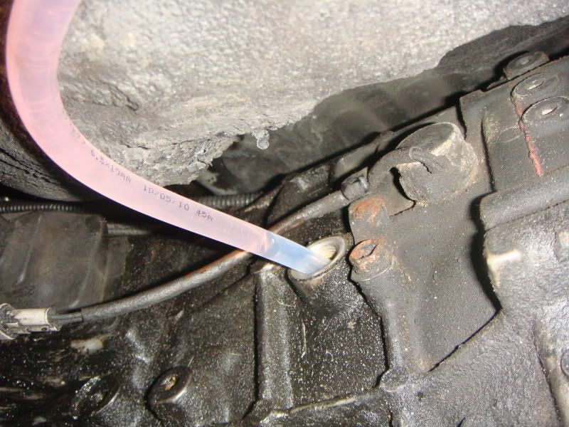

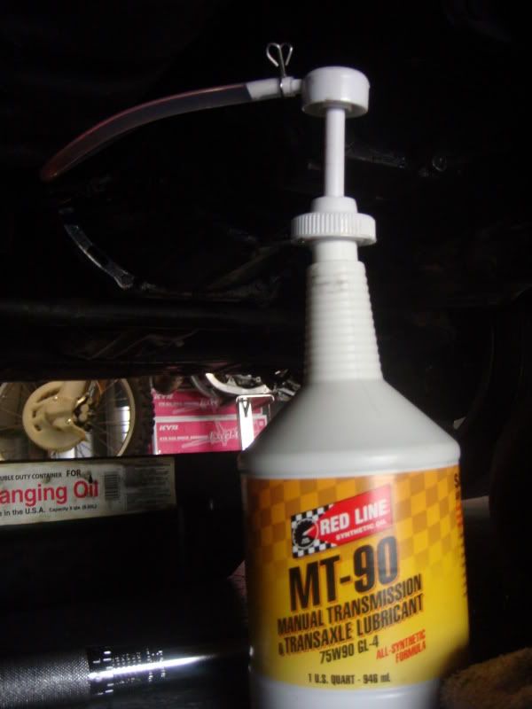

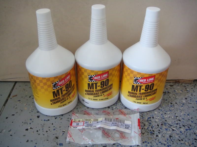

Now for the W58 tranny i used Redline MT-90 that i got at Titan motorsports which is 10 min from where i live. Also Oem washers.

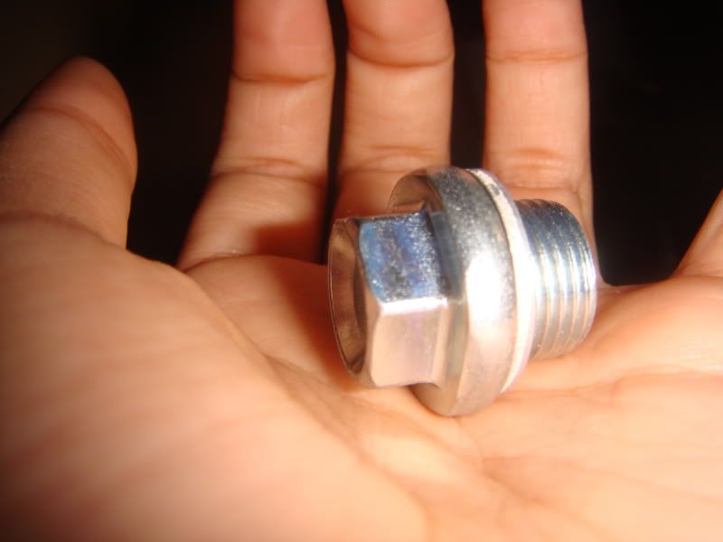

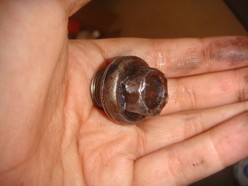

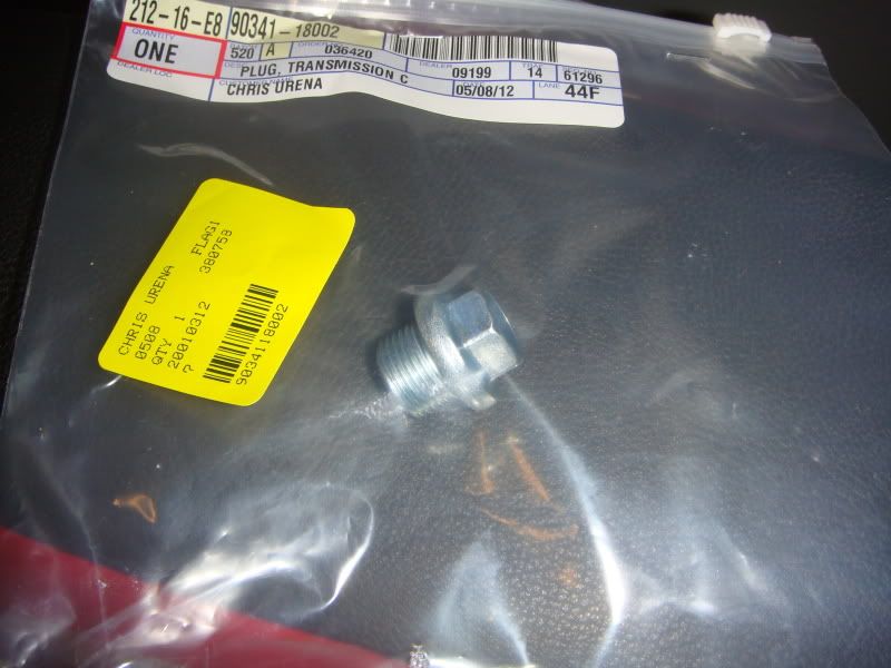

I barely managed to take off the fill plug from the tranny as the PO stripped it.
I left the tranny draining while i went to Toyota to get a new fill plug.

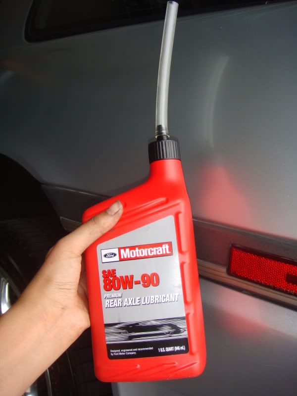

Got this oil pump at the autoparts store which made the job much easier:
got the fresh fluid in then torqued both plugs to 30ft lbs :icon_bigg
The tranny feels much smother now then before. Goes into gear with barely any force or hesitation. The Diff doesn't shatter no more which is also great. All i need now is some marling crawler shifter bushing to remove all the play i have while in gear.

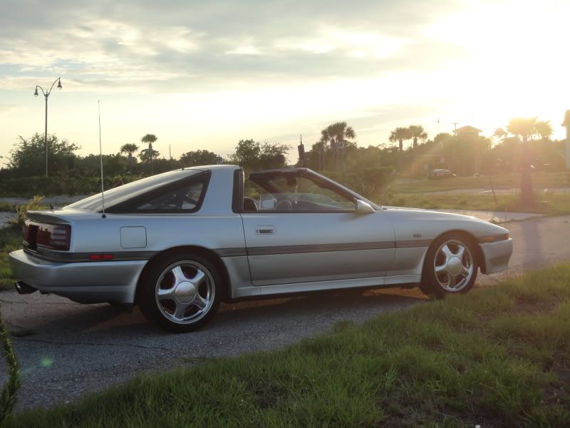

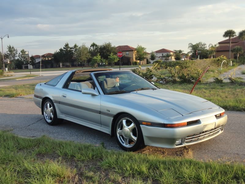

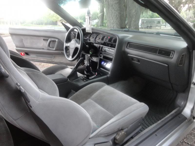

Cleaned the supra and went to take pictures of it with the springs settled and the top off.. :naughty:
My cousins pit bull wanted to join.
Edited this 1
Let me know what u guys think..Thanks

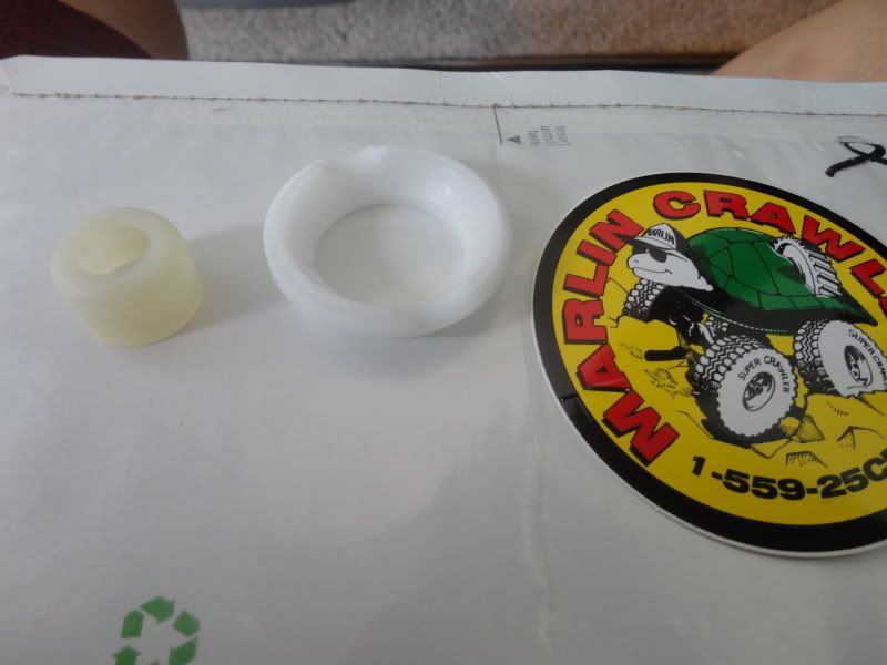

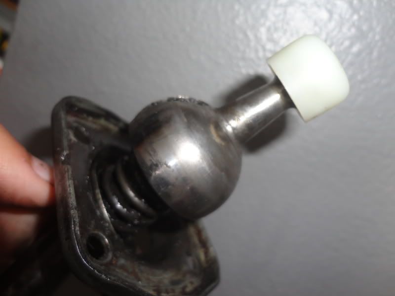

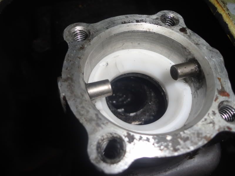

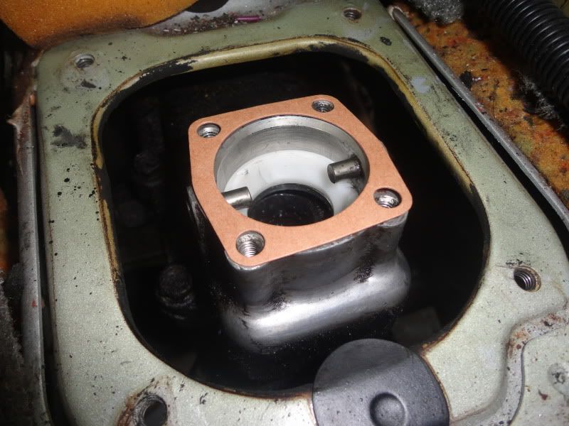

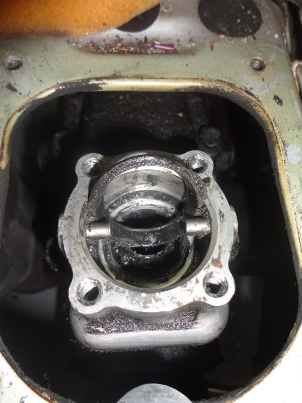

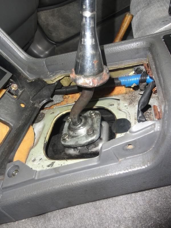

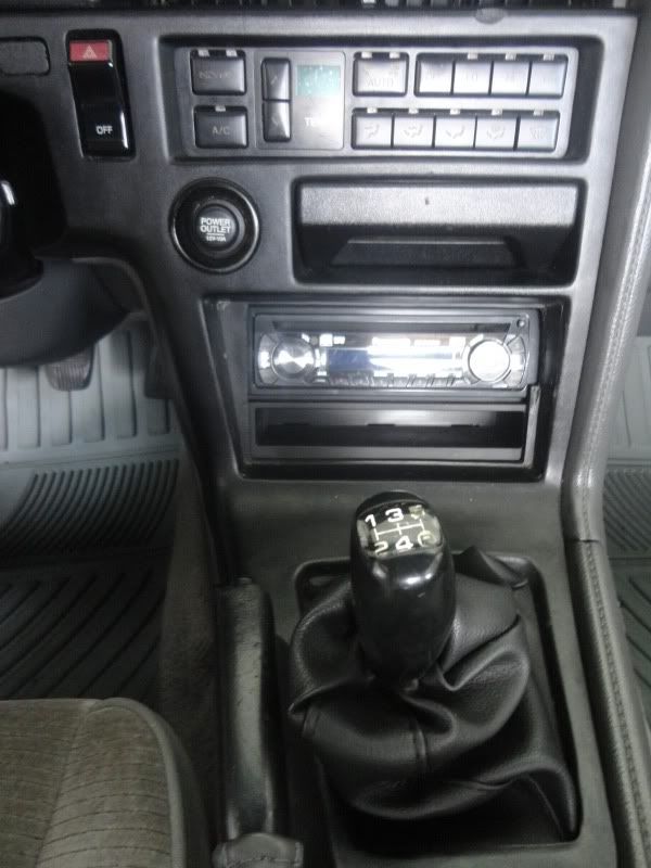

Today i got to do my marlin crawler bushings which i had for over 2 months.

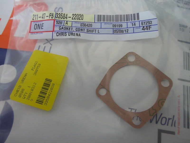

Also got an oem shift lever gasket from Toyota.
Old rubber seat removed:
MC seat installed:
Nylon MC bushing also installed:
Everything put back together.
The difference is incredible. Gears go in more precise, barely no play when is in gear and much stiffer. 10X better than before and the best 20 buks ever spent(no lie). I did a DIY on the installation of the bushings, here's the link:

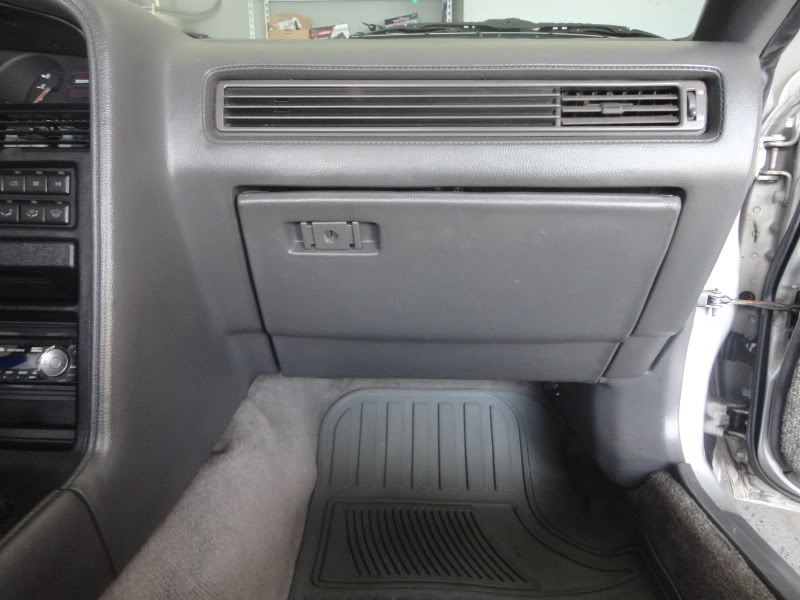

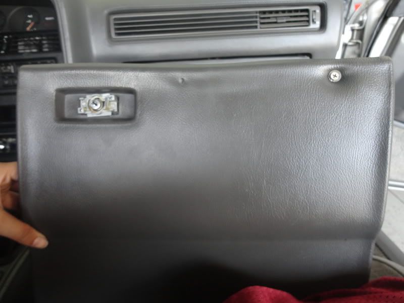

Also received a minty glove box that i purchased from cripplegto.
Old 1 was held on by screws and was missing the handles
Installed the new to me glove box and looks amazing. Thanks cripplegto!

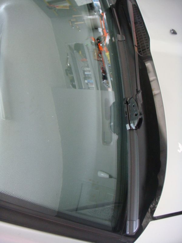

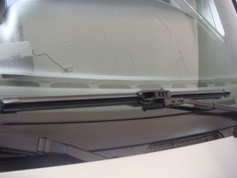

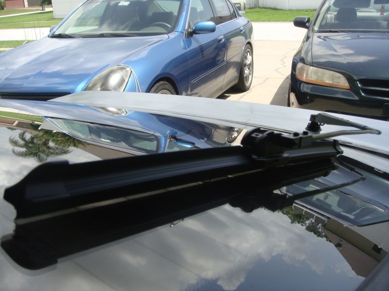

Got some new wipers: Rain X latitude for the front and back windows

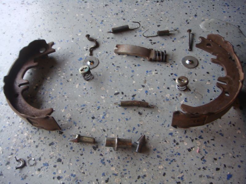

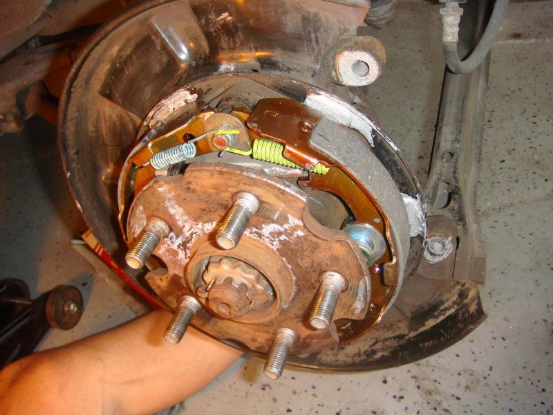

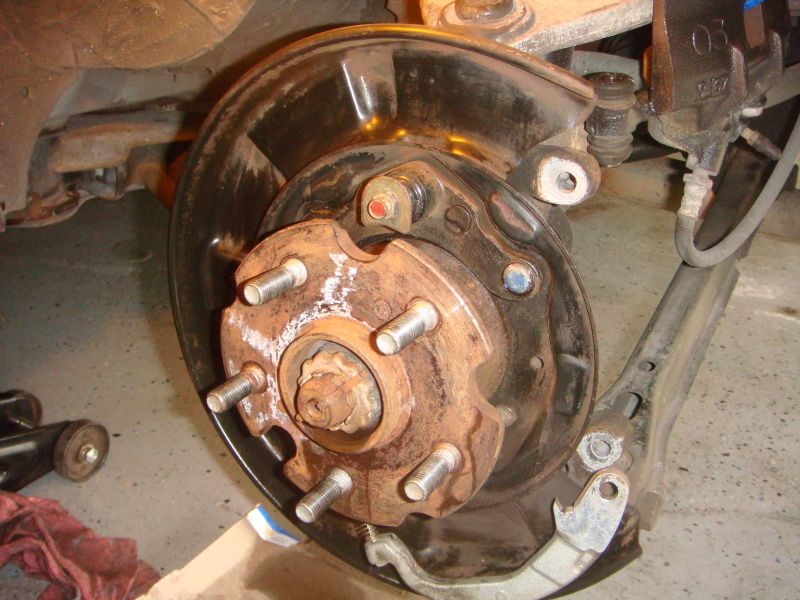

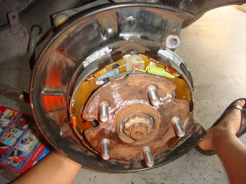

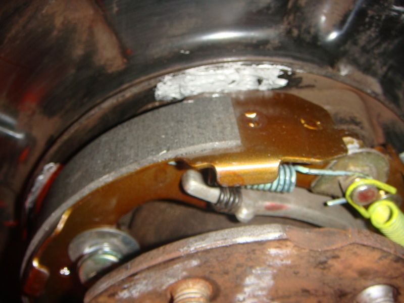

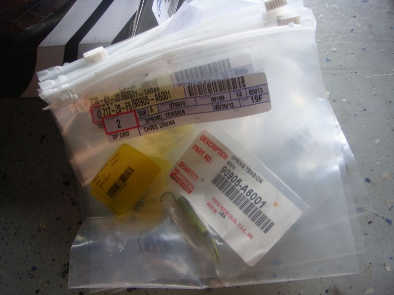

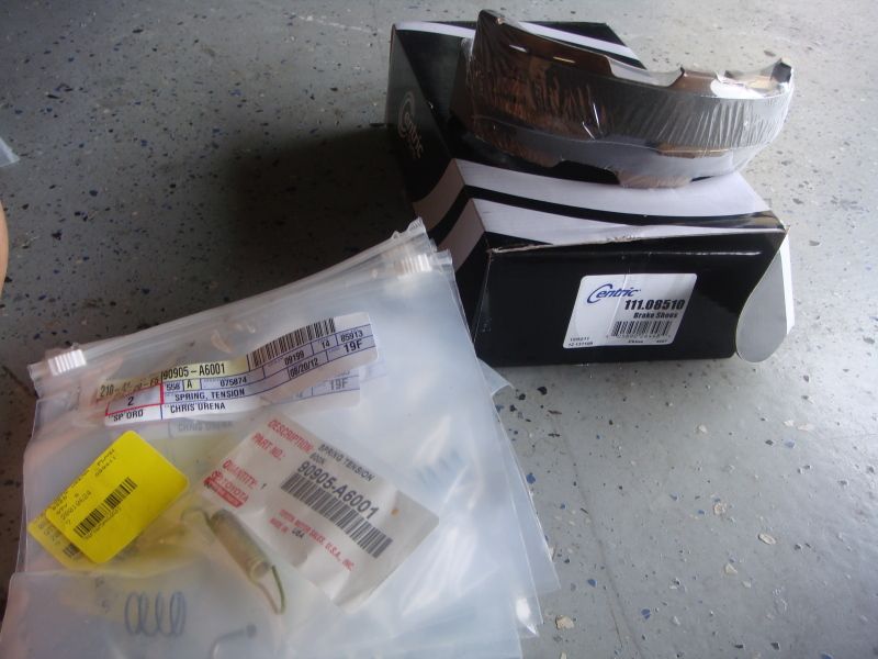

And finally did my e-brake with Centric shoes and oem toyota springs and clips.

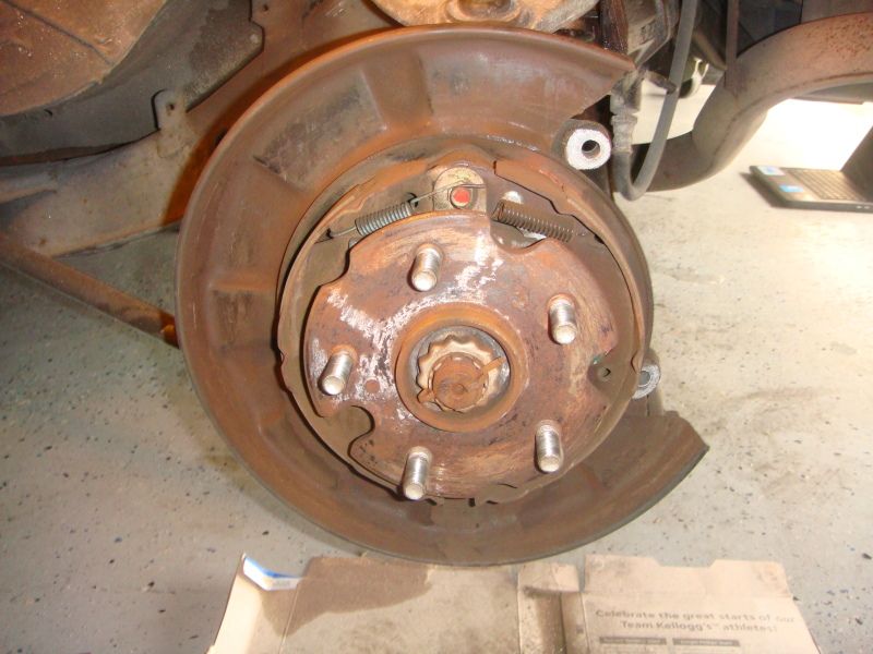

Before:
Got everything cleaned up with a scotch brite and a wire brush:
Everything layed out just in case
installed the new shoes and oem harware(the gray paste is anti-seize on the sliding area of the shoes)
This was my first e-brake job, it was fairly easy if you have the right tools and follow the tsrm.

These wipers work with the standard two screw mounting point? went to get some yesterday and they said they don't have any for my car, clearly are compatible with the supra, only in NZ....
slowma70
May 23, 2011
296
Orlando,FL
no they dont you will need an adapter to go from the screw style to a pin style..

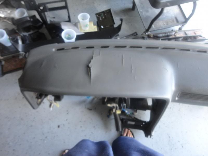

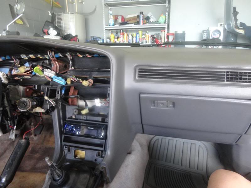

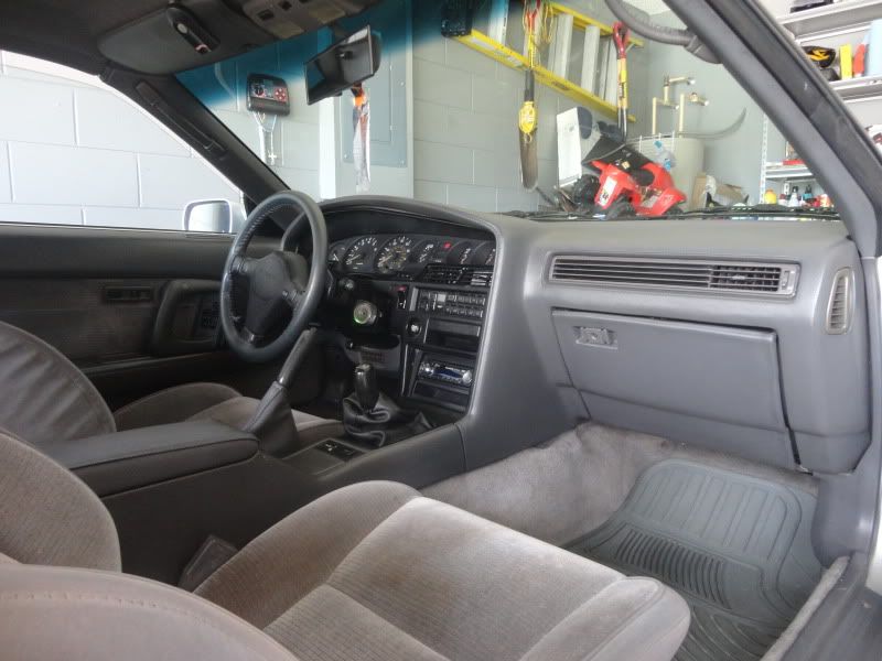

Not much of an update haven't really done nothing important.. i got to change my dash that was cracked and replace it with a better 1
What florida sun does to your dash
Got the other dash on

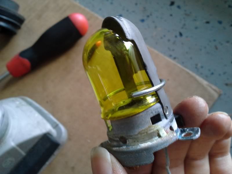

Also got to rewire the fog lights and also installed the capsules that Razo-e sells..
Got time today to get some pics taken with the KevinM visor and fogs
im in the process of saving up for a 1j so hopefully that will be this year. Tell me what you guys think of it so far. Also should i tint the windows?
