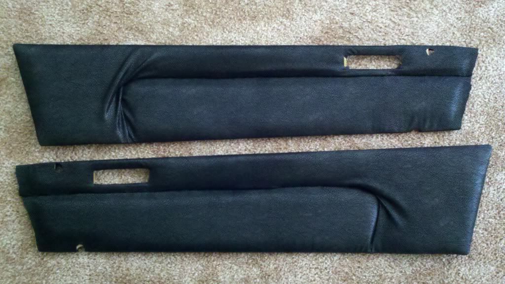

and I also recovered my door panel inserts. im not really happy with how it came out but oh well. thanks for looking guys
