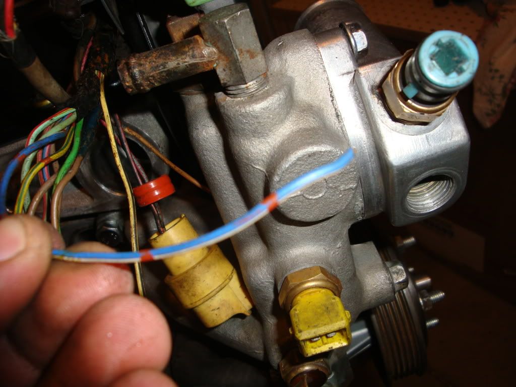

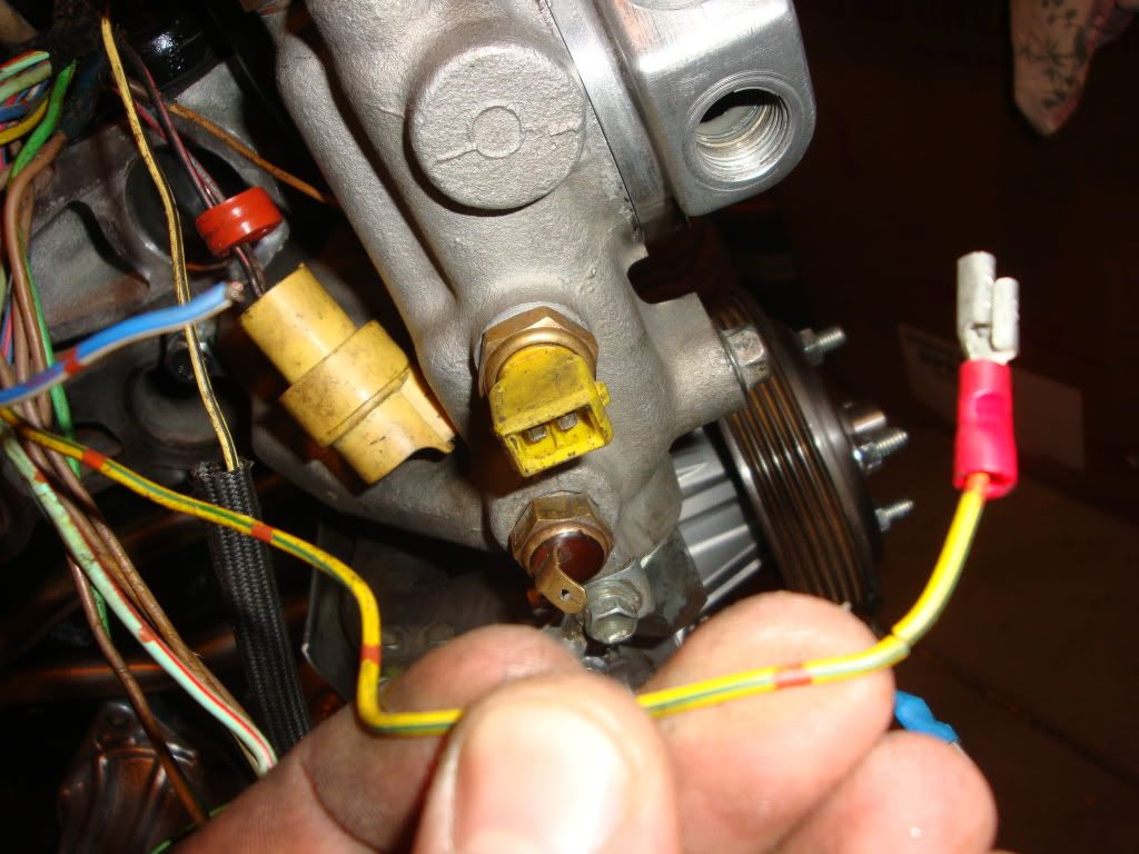

ok so i have some wiring issues and i really need some guidance on what wires go where.

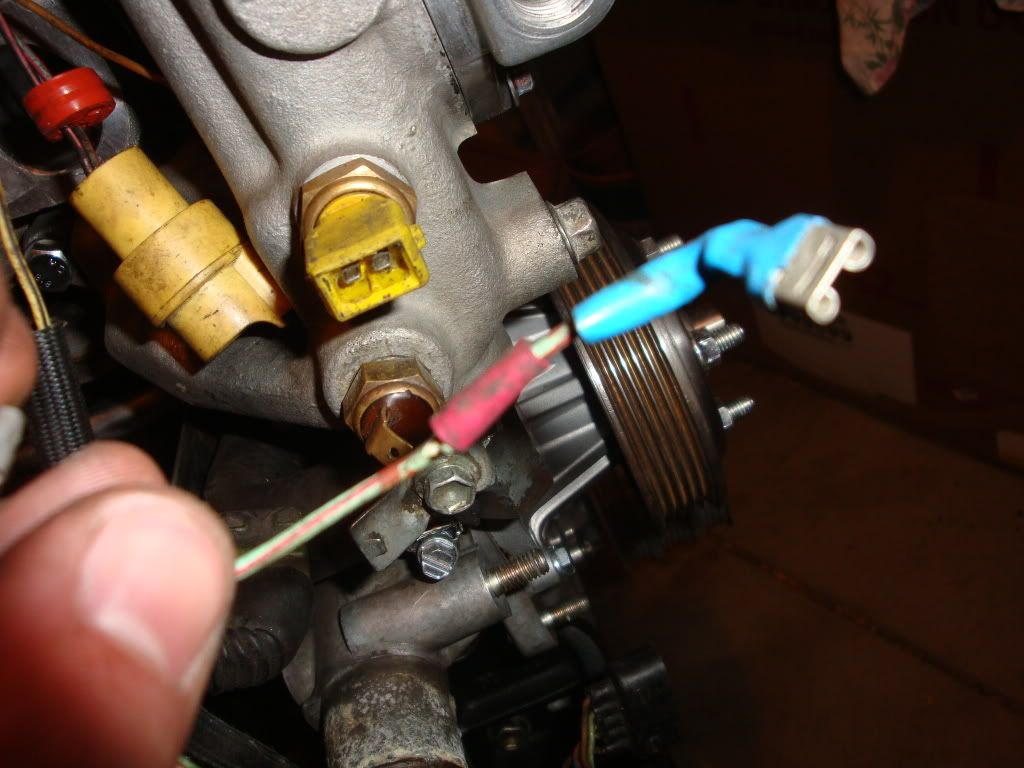

here is the first wire i dont know where it goes
here is another one with the same hookup but different color wire
this one that has no plug on it

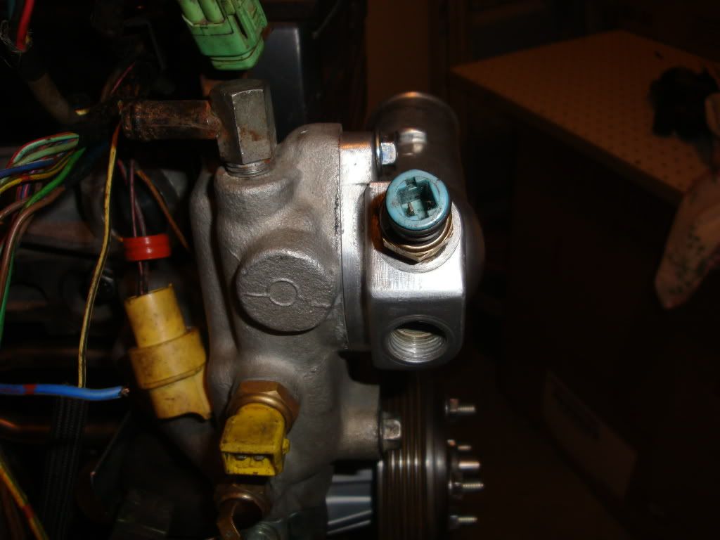

and in this picture what plugs into the blue plug on the water neck, and what screws in below that plug?
thanks guys i really need to get this project finished

Blue with White stripe, Auxiliary fan temp switch, (The one that has the blue plug on the T stat housing)
Green with red stripe, Coolant temp sensor for ECU
Yellow with red stripe, Coolant gauge sender only (if your gauge doesn't work swap the two wires. The one above, The two sensors look the same but only one works with the corresponding unit.
Yellow with black stripe, Oil pressure sending unit

cool that helps a lot Devin.. so i cant find where the green with red stripe (the one you said was for the ecu coolant) is that what is supposed to be screwed into the water neck beneath the auxiliary fan sensor?

Looks like your missing a sensor.. I think I was wrong a before. I need to relook up the wire colors for the stuff for yellow and grreeen with red stipe.. Im a little out ofit though.. Ill get backto you once im back to normal in the moring

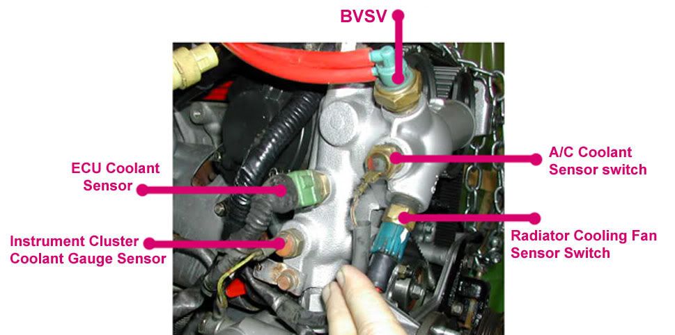

the one your missing is the a/c coolant probe. ill also look in daylight for wire color.
this help? borrowed from the WTB section
ya it helped a lil except my water neck only has two spots for sensors not 3 lol

also in that picture the BVSV to my knoledge is used for the cold start injector but my motor doesnt have a spot for it and what does it plug into? thanks a ton guys for all the :1zhelp: :)

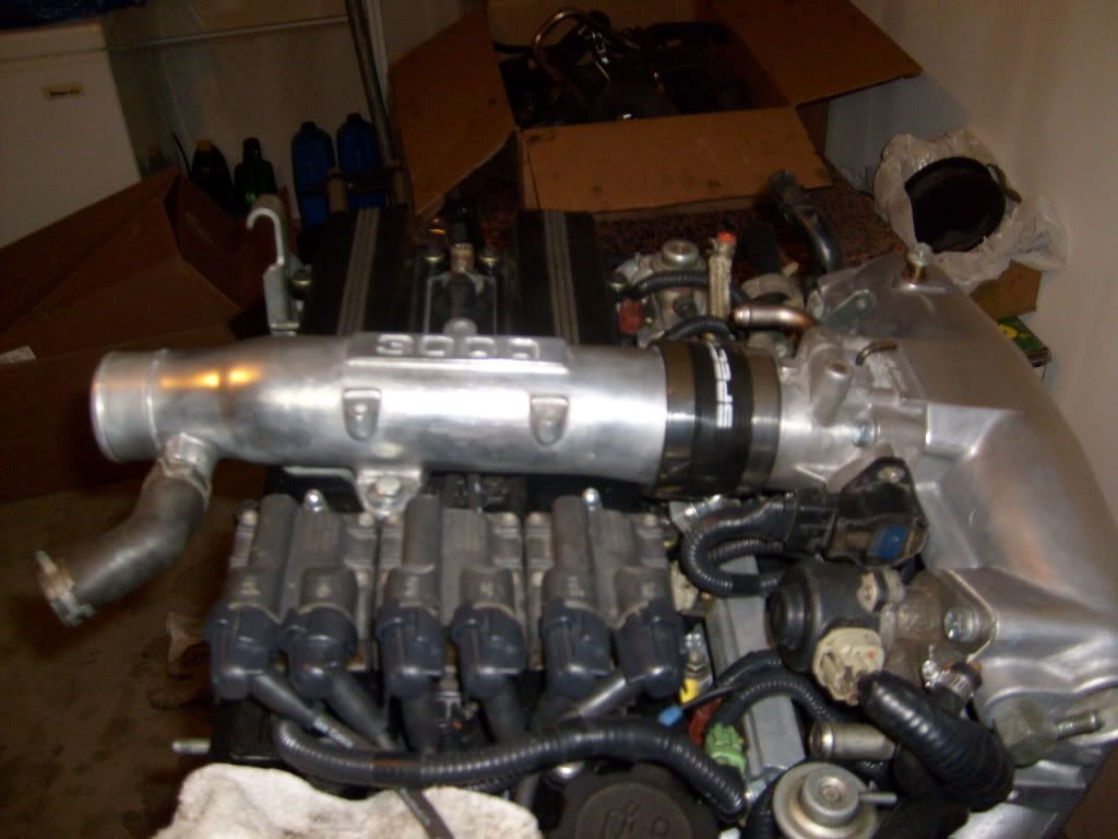

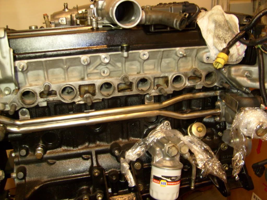

i got the 3000 pipe on and a bunch of other stuff so im finally getting there

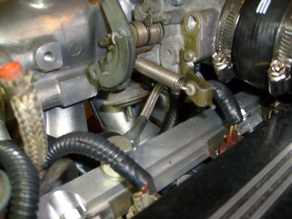

in this picture hides my braided stainless steal cold start injector line ;)
and here is my new 7/16 stud kit..

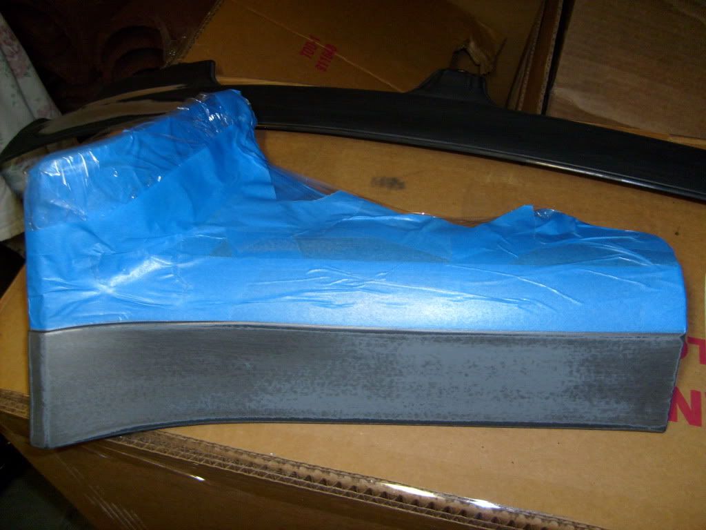

also i sanded, taped, and prepped out my mud flap, and window cowl so i can primer and paint them

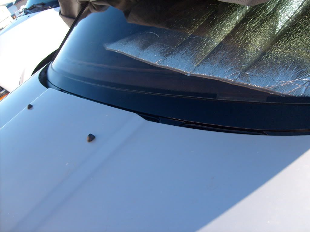

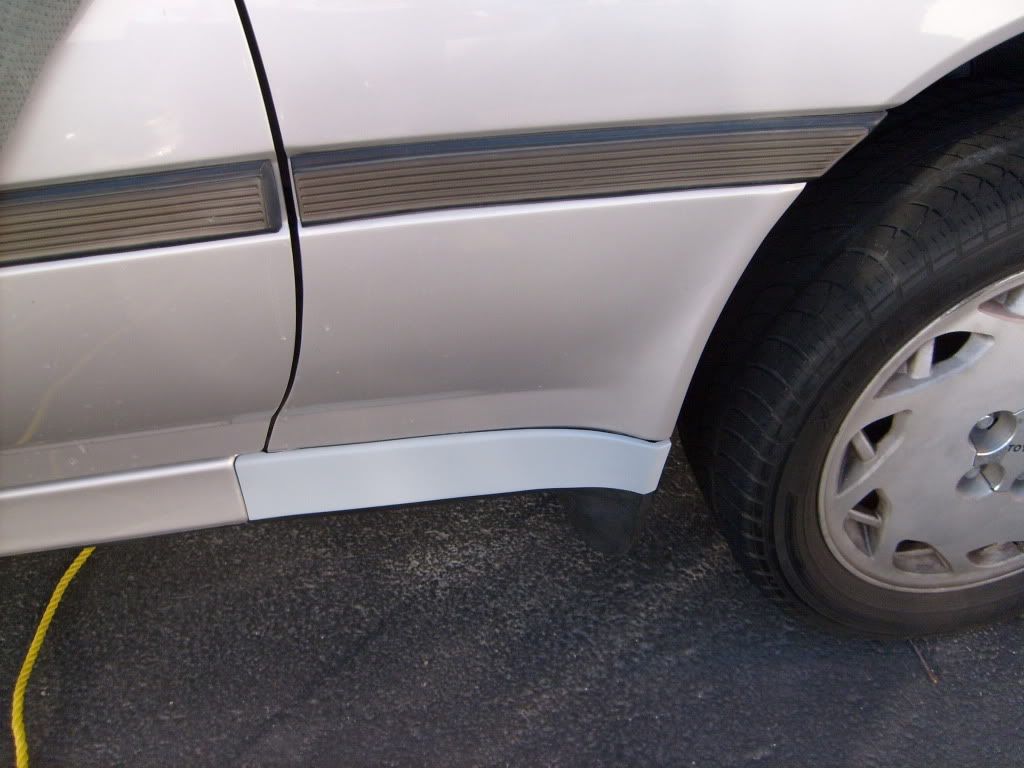

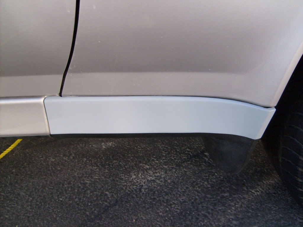

got the mud flap all primed up, wet sanded, and installed, along with the window cowl. i was about to take pictures and i cut my finger wide open, the razor blade went all the way to the bone.. ouch lol i ordered my clutch and new manifold so they should be here soon so i can get this motor in the car. also, i need a few parts please if you guys have them let me know asap.

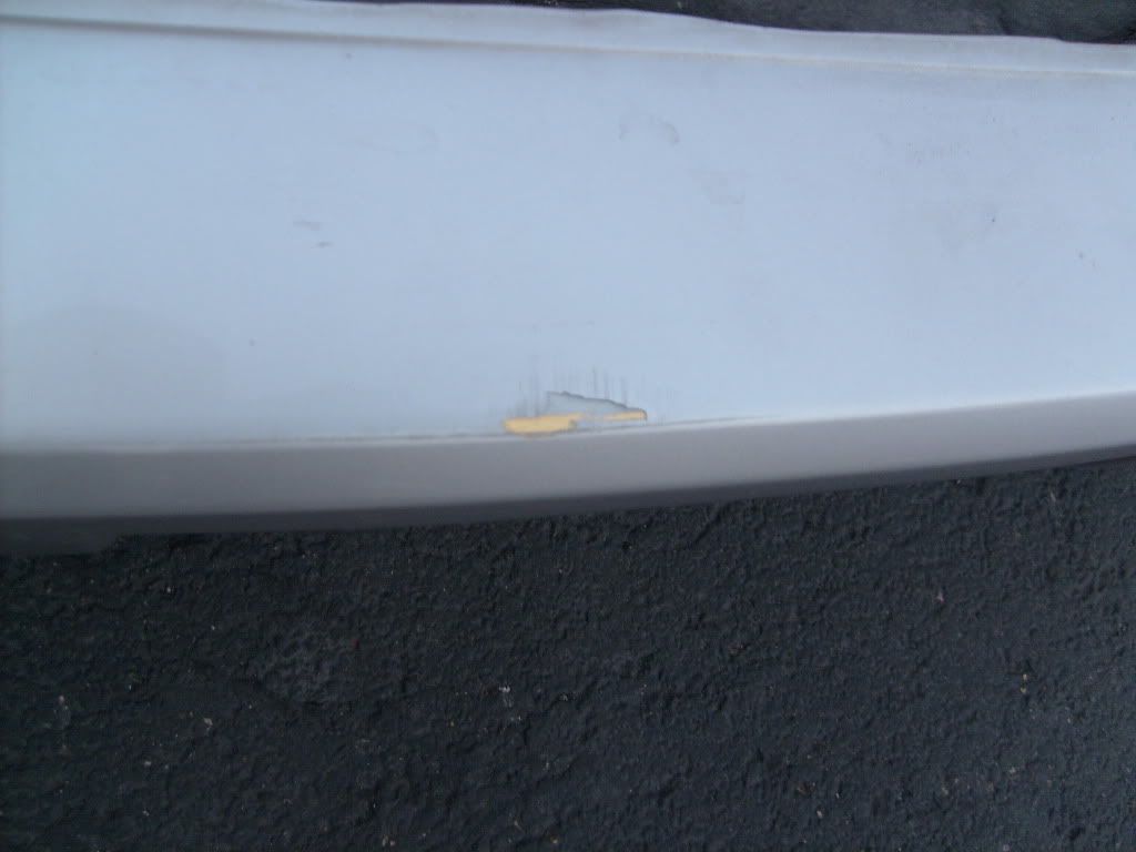

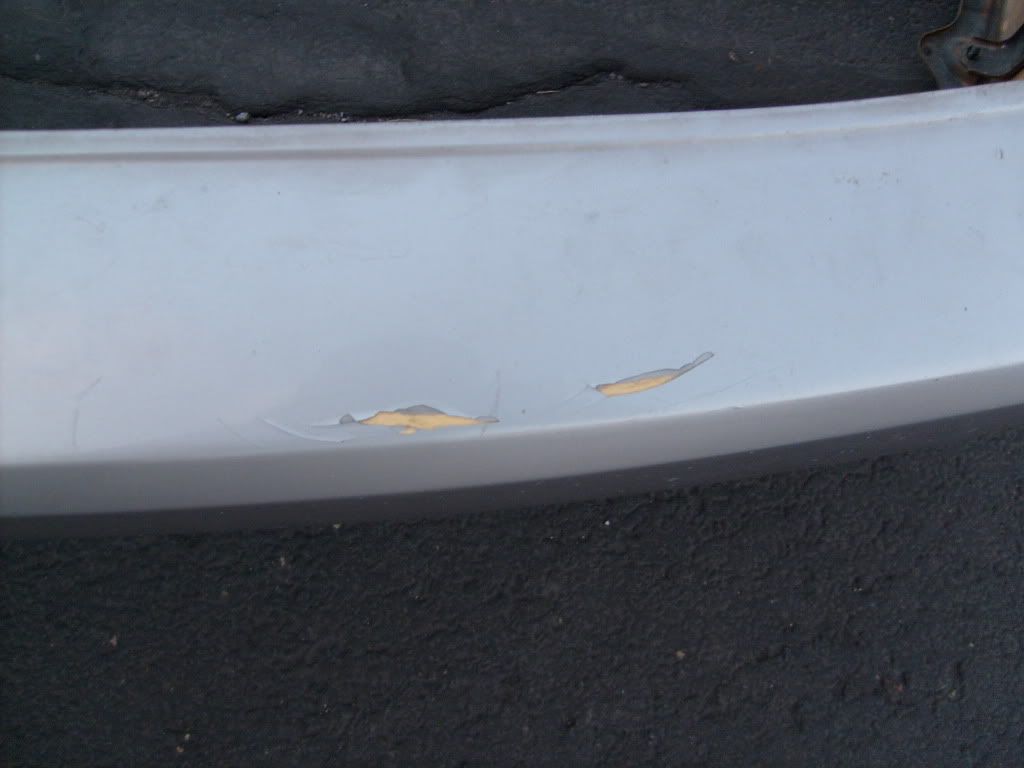

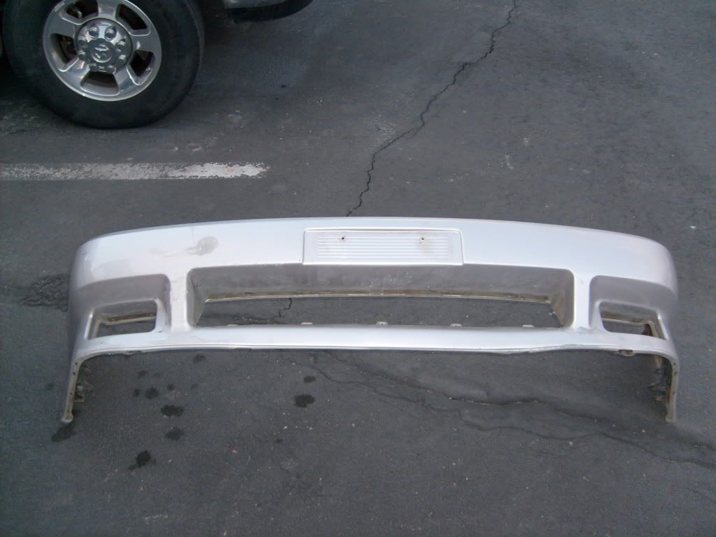

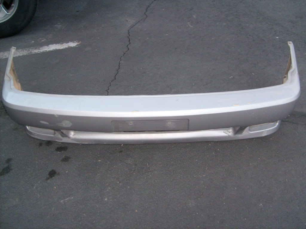

And if anyone is following or cares lol, i took off my bumper so i can sand and bondo and primer it just like the mud flap. tomorrow when i work on the car again ill take pictures of the mud flap and window cowl.

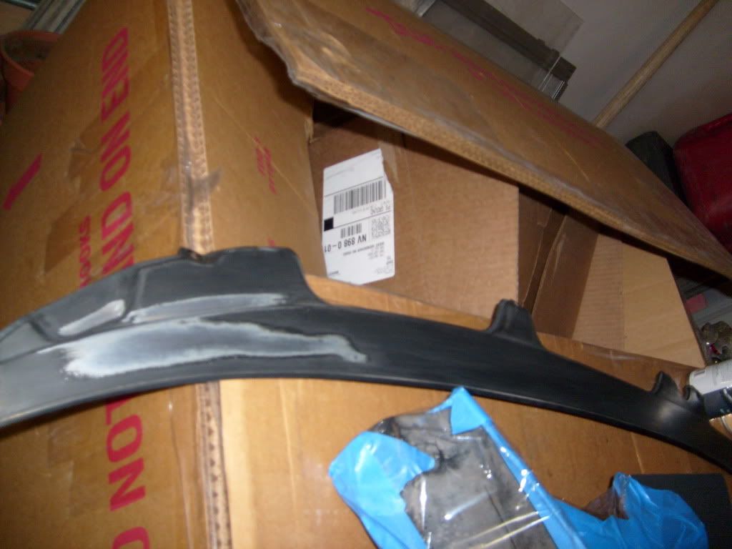

so here are some pictures of that, and i am also going to try to straighten out my lip... :)
wills_jdm
Jul 7, 2010
119
Nevada

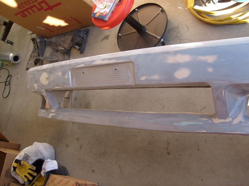

some progress. i began sanding down the bumper, i also took a dremal to it, and went and got a lil filler so i can fix the small imperfections on it, it is coming along good. also i decided to do what you said Devin and i am having my technology teacher help me modify the na tach to work with the turbo motor. and here is the pictures of the finished mud flap and window cowl,
and shown in this picture i took off the tabs that hold the plastic grill, i want the intercooler to really stand out :naughty:
