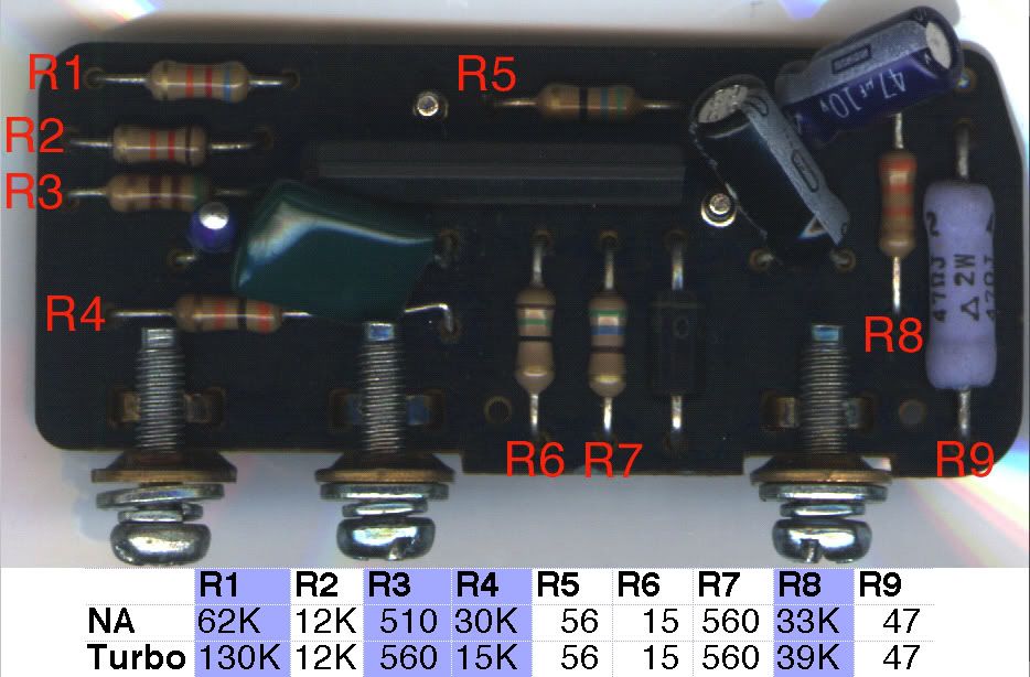

Here you go buddy ;) Only 4 resistors you need to change

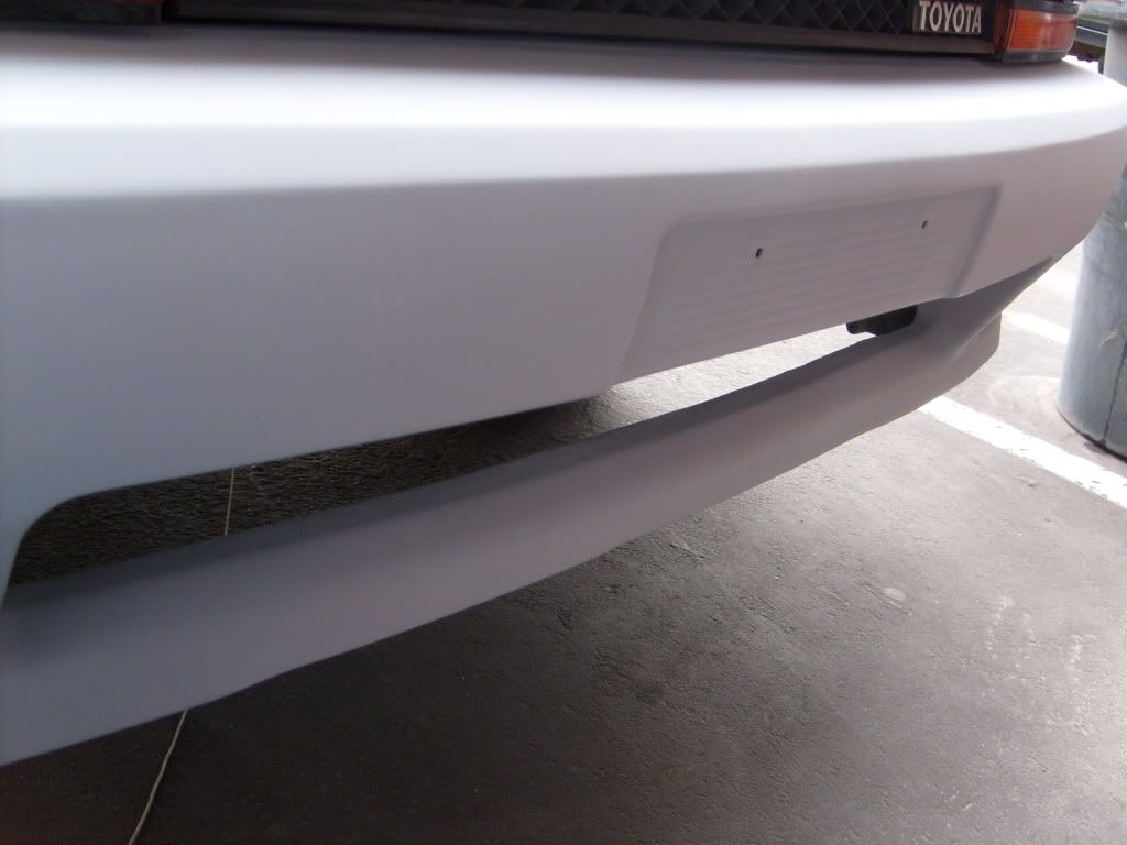

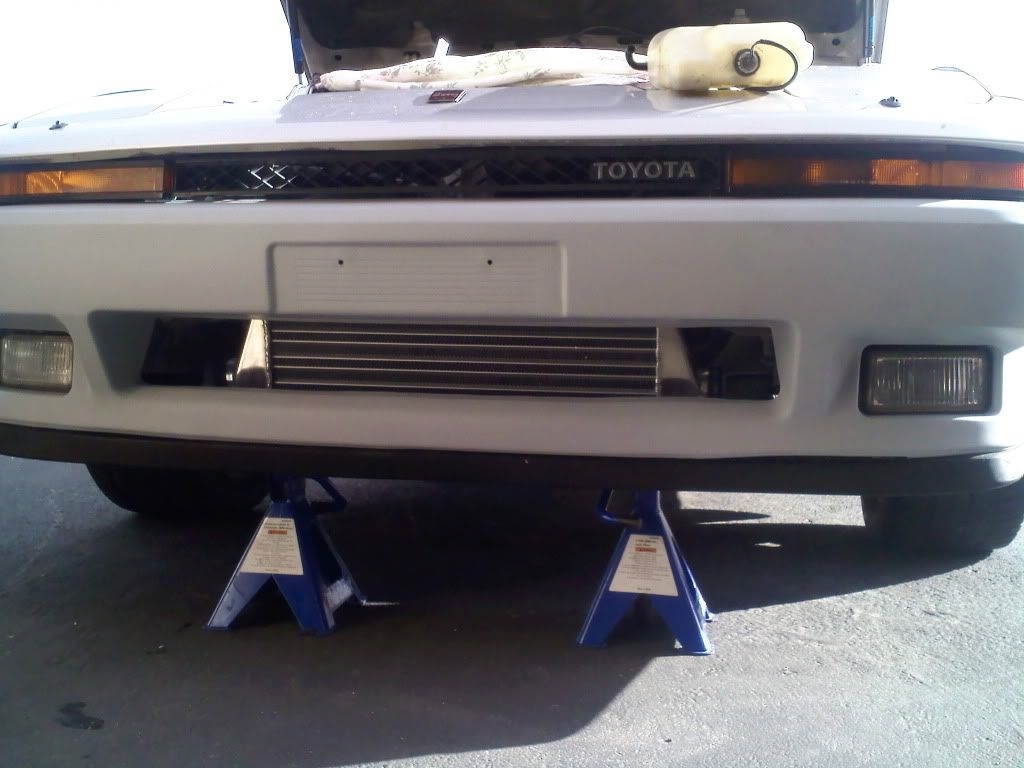

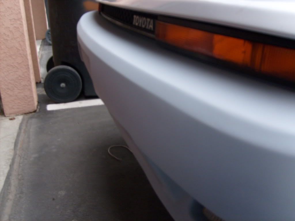

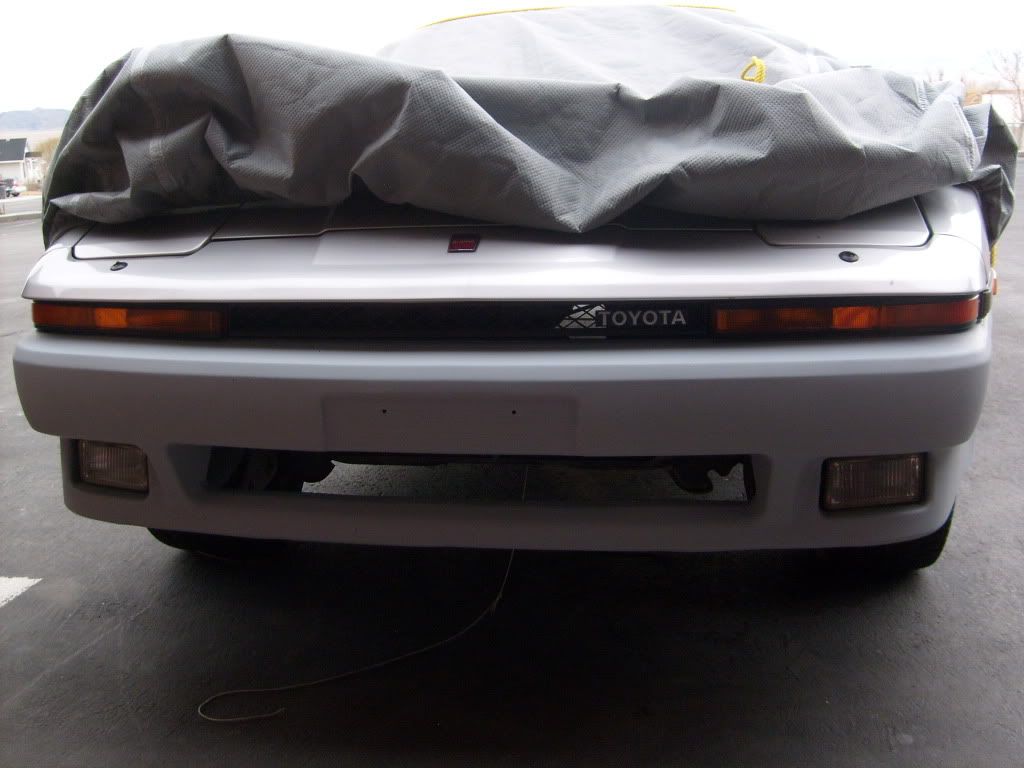

so i got the bumper finished up and primed, came out good. intercooler should be here this week so i can get it mocked up and mounted :)

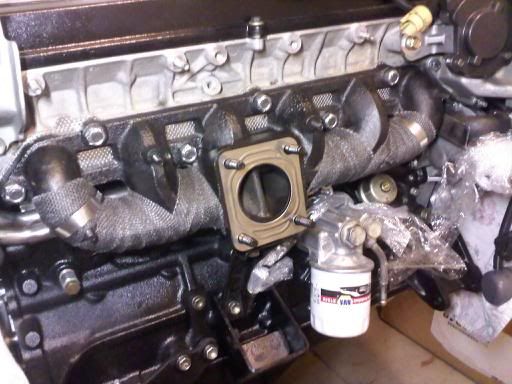

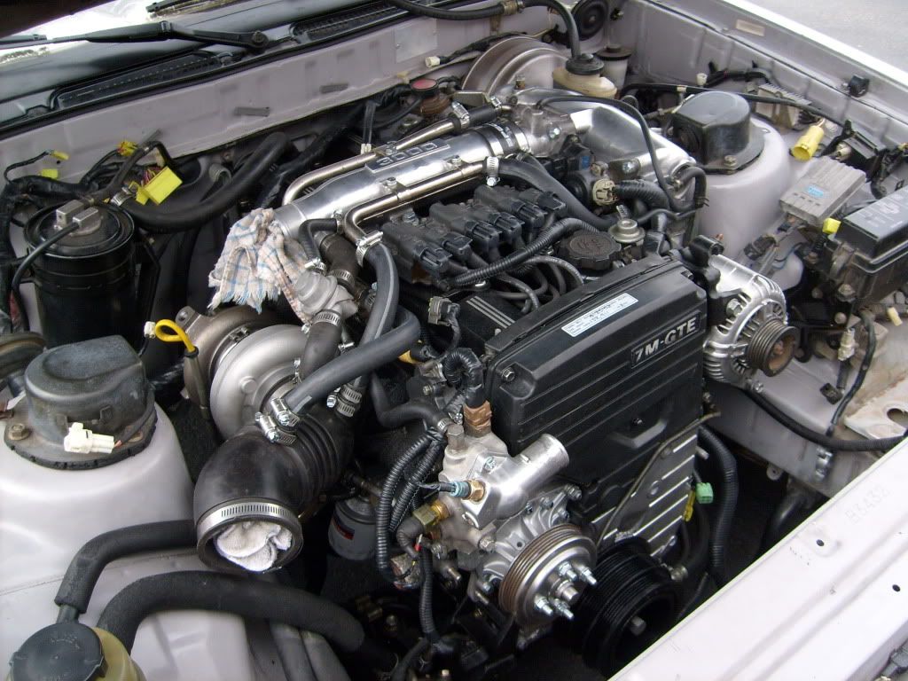

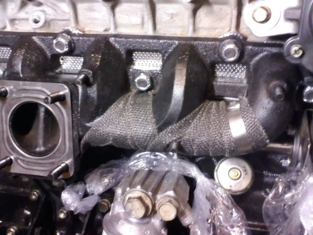

got the intercooler in the mail i might test it tomorrow if its not shitty weather, got my manifold all finished up and torqued down, and also got my clutch in the mail. so alot should get done soon i hope, heres some pics

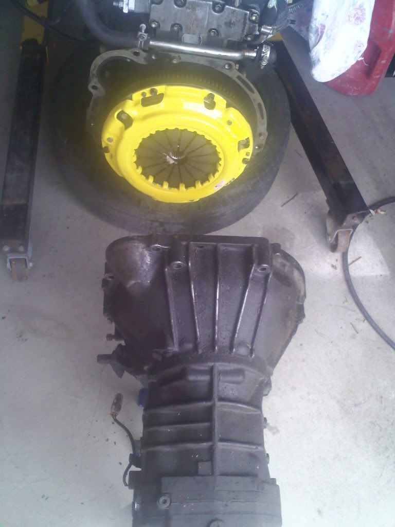

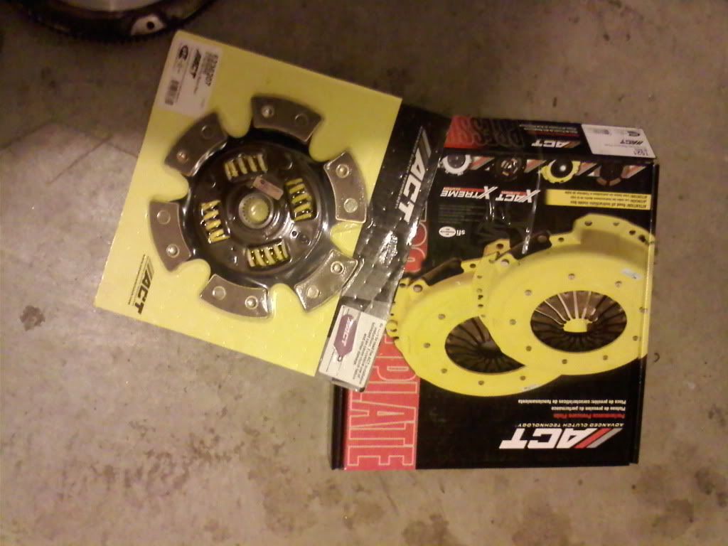

i got a ton done lately. The modified tach is now in the car, interior back together, and motor is completely done and buttoned up. Here is a crappy cell phone pic of the fresh act clutch and getting ready to mount up the tranny to the motor. im putting in the motor tomorrow weather permitting. wish me luck lol :)

I see a problem installing the transmission.. Leave the pressure plate and clutch on the transmission and then put them together, then through the inspection hole bolt the pressure plate to the flywheel :)

i just installed the new pilot bearing and then used the clutch alignment tool to get the pressure plate on there. worked like a charm in my opinion. whats the theory behind doing it the way you said Devin?

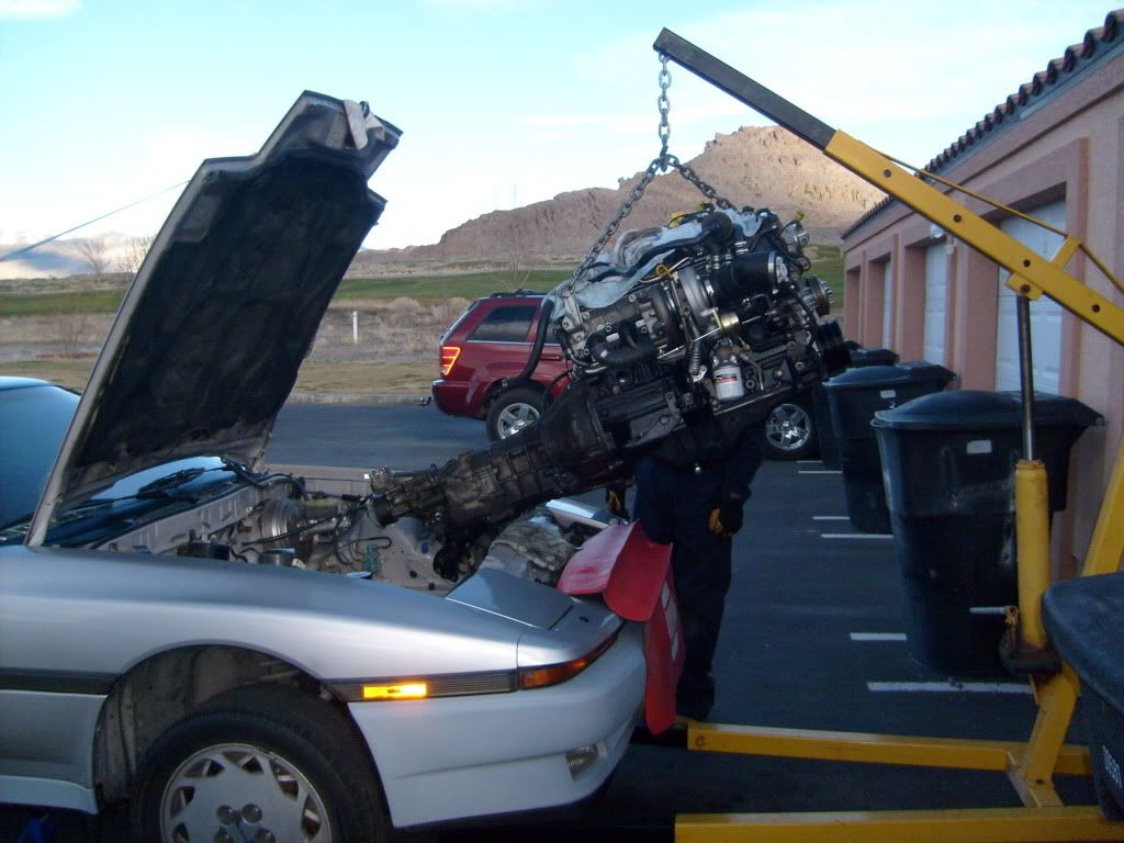

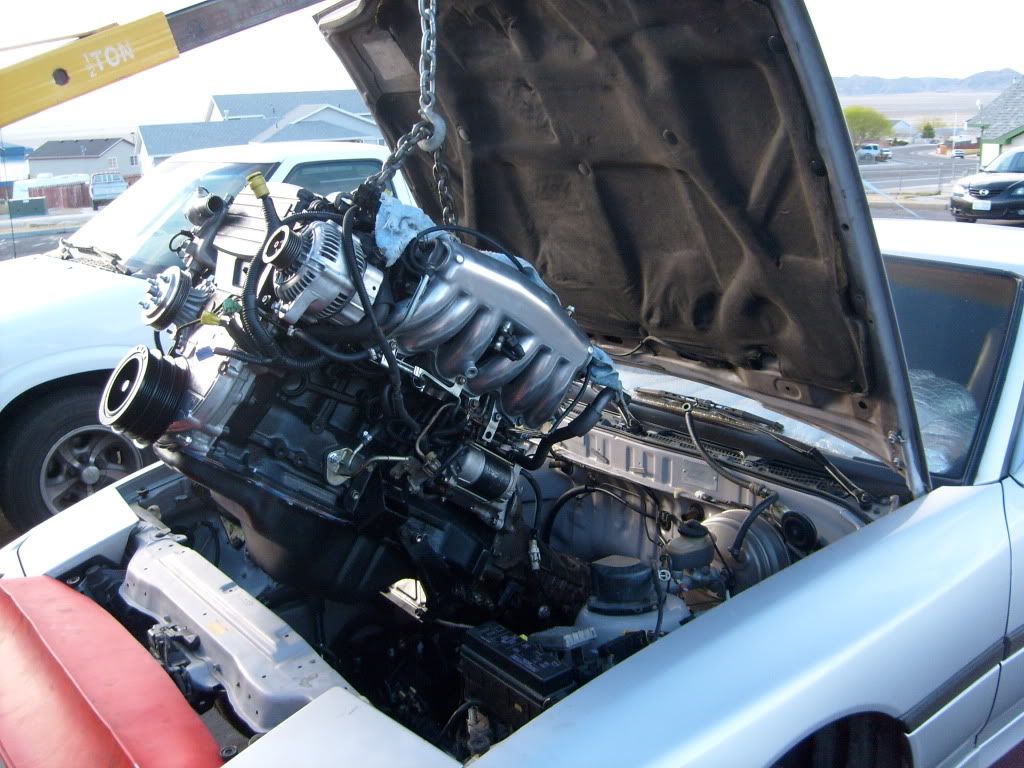

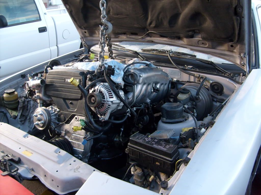

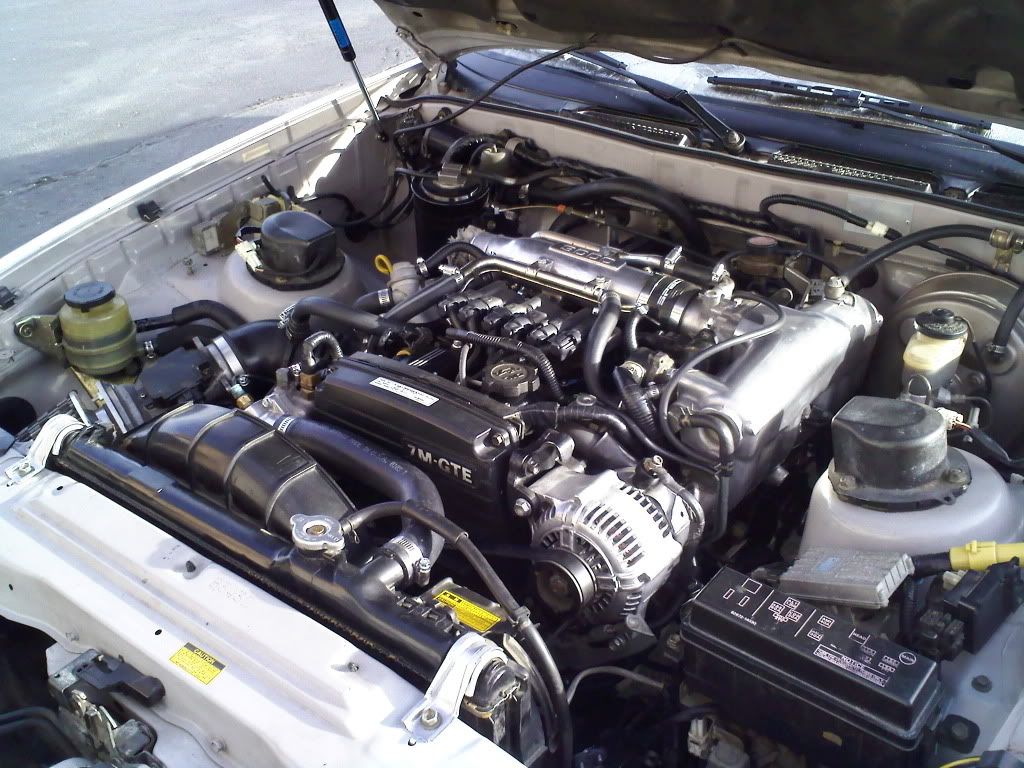

well as promised i got it in the bay today. then had to go to work so i didnt have time to hook anything up. just bolt her down. here is some pics of the install.. :naughty:
it plopped right into place first try, after i got the motor mounts lined up. it was a very clean install. worked like a charm :)

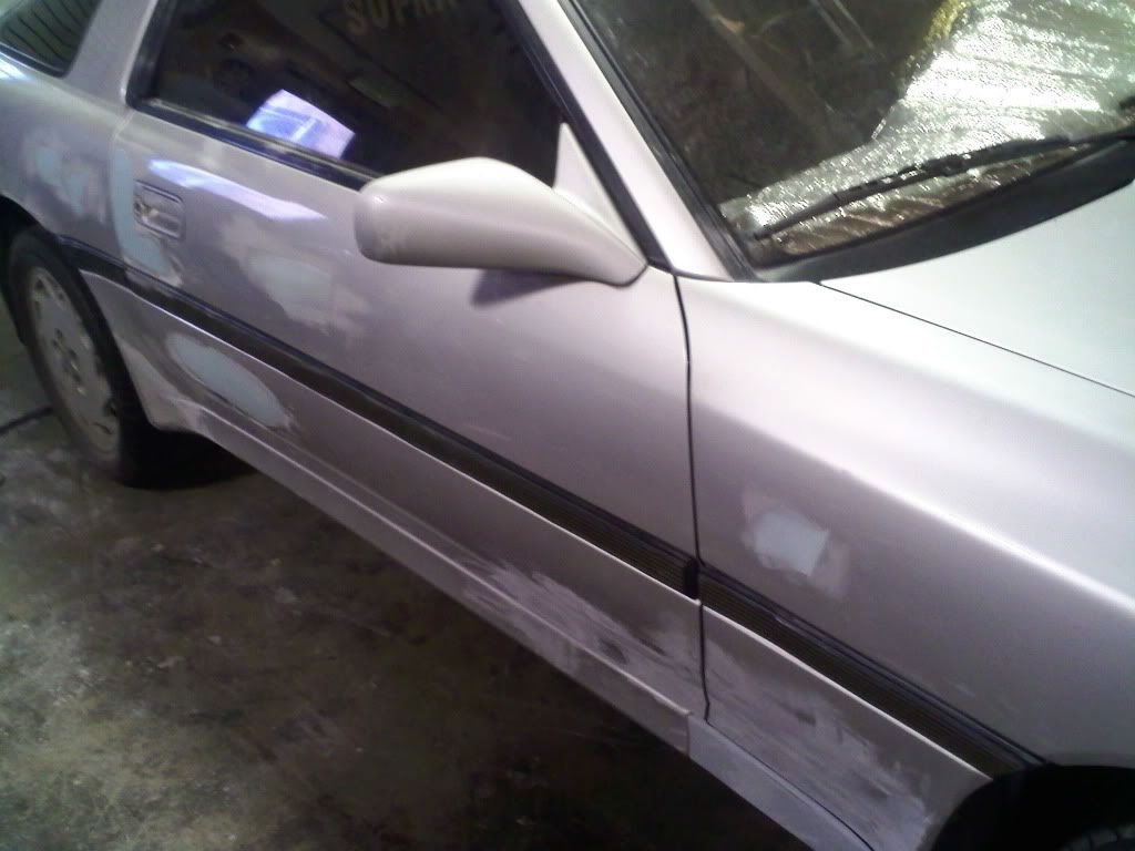

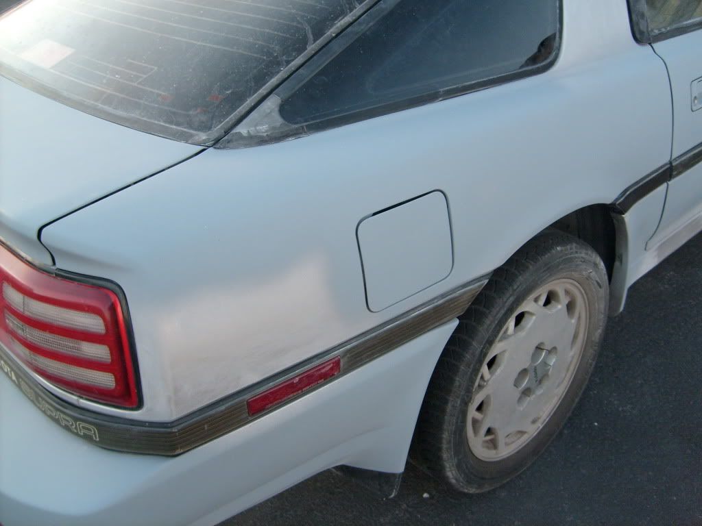

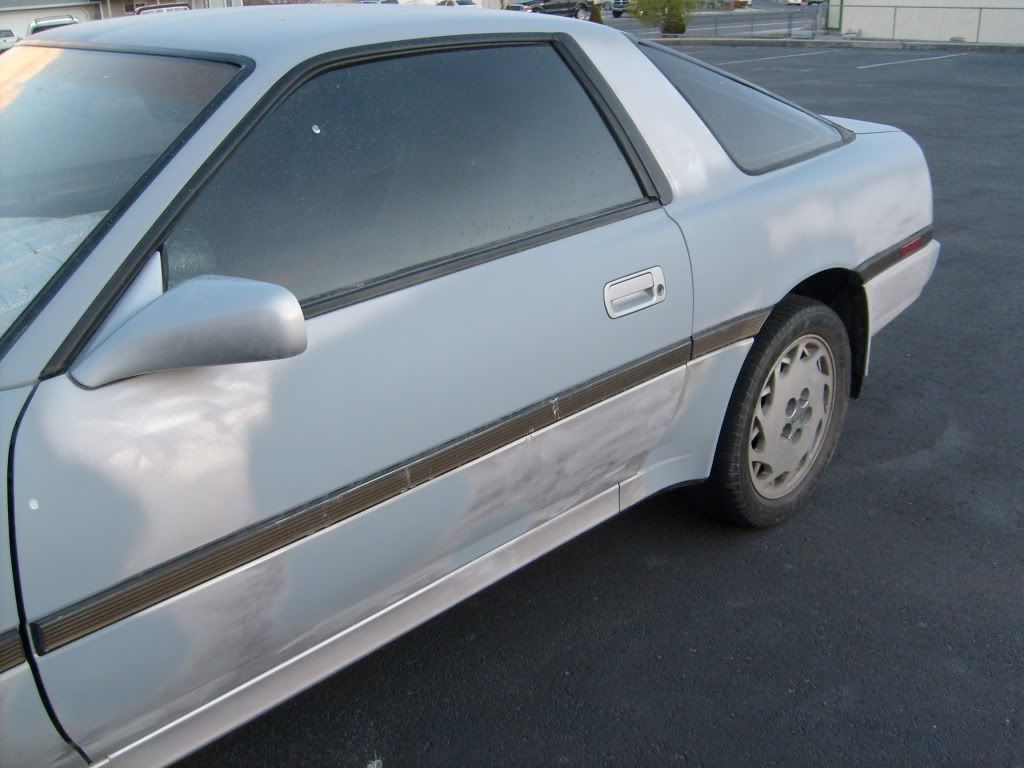

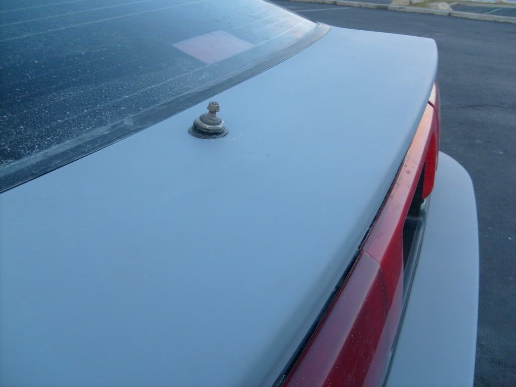

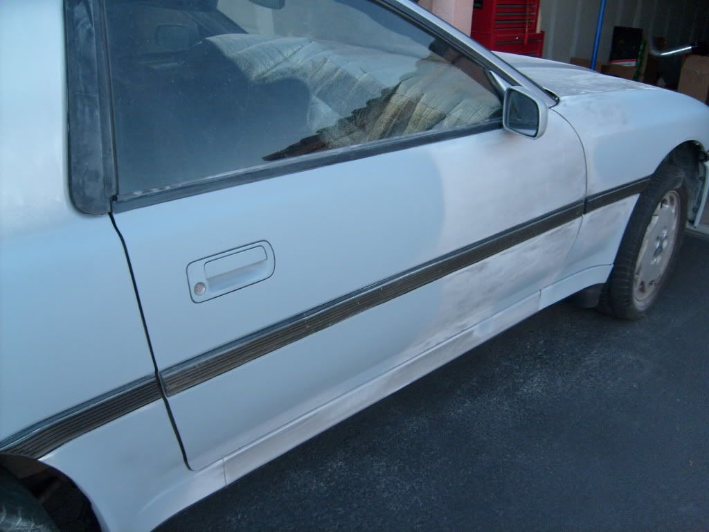

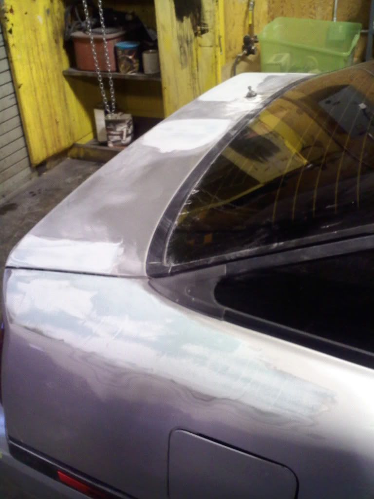

That is true Devin (i hope it is built right), i was planing on going out and doing some pretty hard runs, then changing the oil, then driving easy till around 1000 miles and then switch to synthetic. the guy that is doing my body work is doing it in our shop at school so i took some pictures while we worked on it today. and tomorrow i plan on fixing the throttle linkage, and mounting my oil cooler. that should only leave me with the inter cooler piping and gauges. here is some crappy cell phone pictures :), and no the bondo isn't that thick. i watched him put it on and it is very thin. we just haven't sanded it yet.

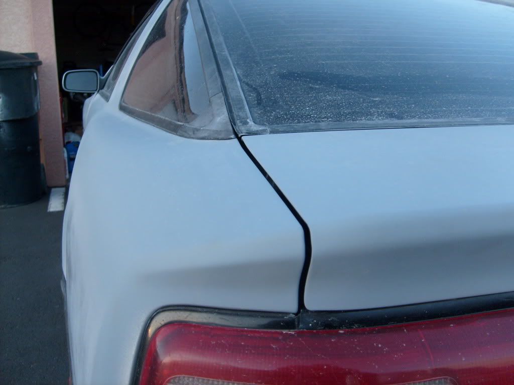

i got the car back on wednesday but i have been super busy so i didnt have time to post pictures. the body work is so perfect, and i know the guy that did it so he did it for uber cheap and let me watch the whole process. heres some pics, the car is really dirty right now sorry
no more nasty holes, rust, or dents.. YAY :)

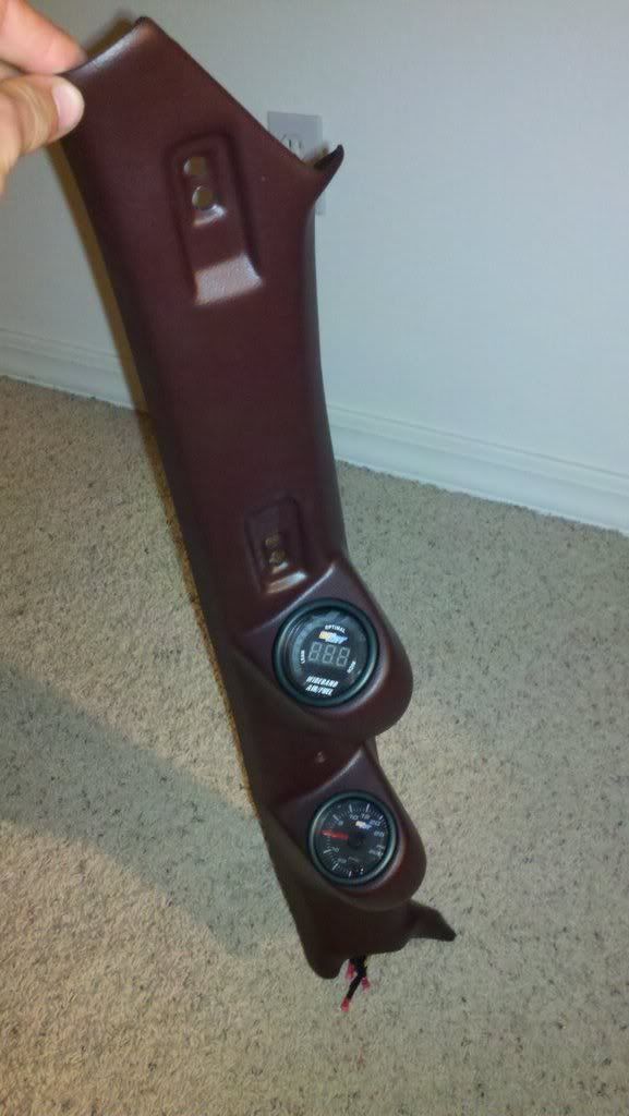

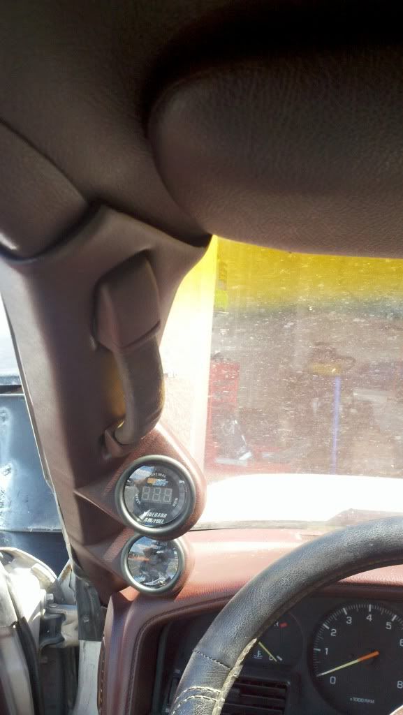

I got the upper intercooler piping hooked up but in waiting for a tube for the bottom. My gauge set up. Its ready to install now. And I've already ran all the wires

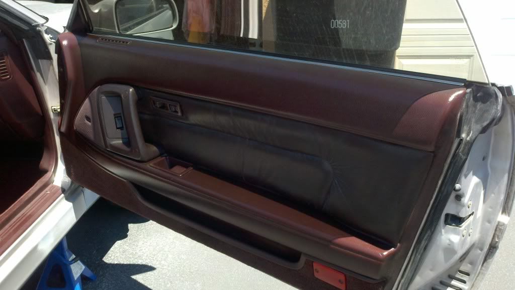

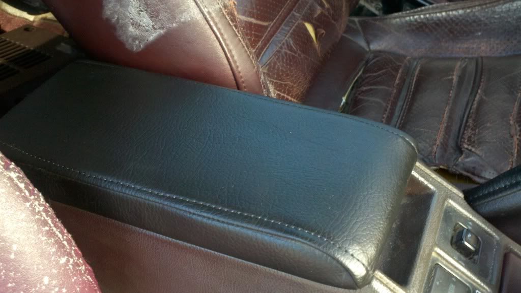

i recently purchased a ton of interior parts so i installed them today. i will post pictures of that once i get my gauge pod in. i also am very stumped and was curious if this has happened to anyone else ever, so i had the body work done, and now there are no holes in the trunk or fender. Well its been raining alot and i havent had time to work on the car so its been a while since i looked at it. well i looked at it today and the spot wear the spare tire goes, and the driver rear fender were full of water. i always thought this was happening due to the holes in the trunk and fender, but now they are gone. Any ideas on where the water is getting in at?
