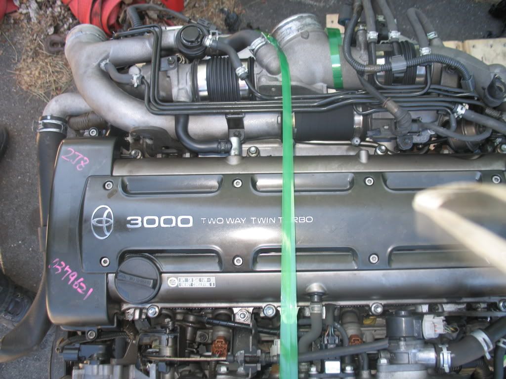

As for the 2JZ, I Am buying one hopefully today. Im getting it from JDM engine depot. I hope to have the engine within 2 weeks

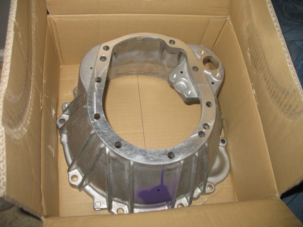

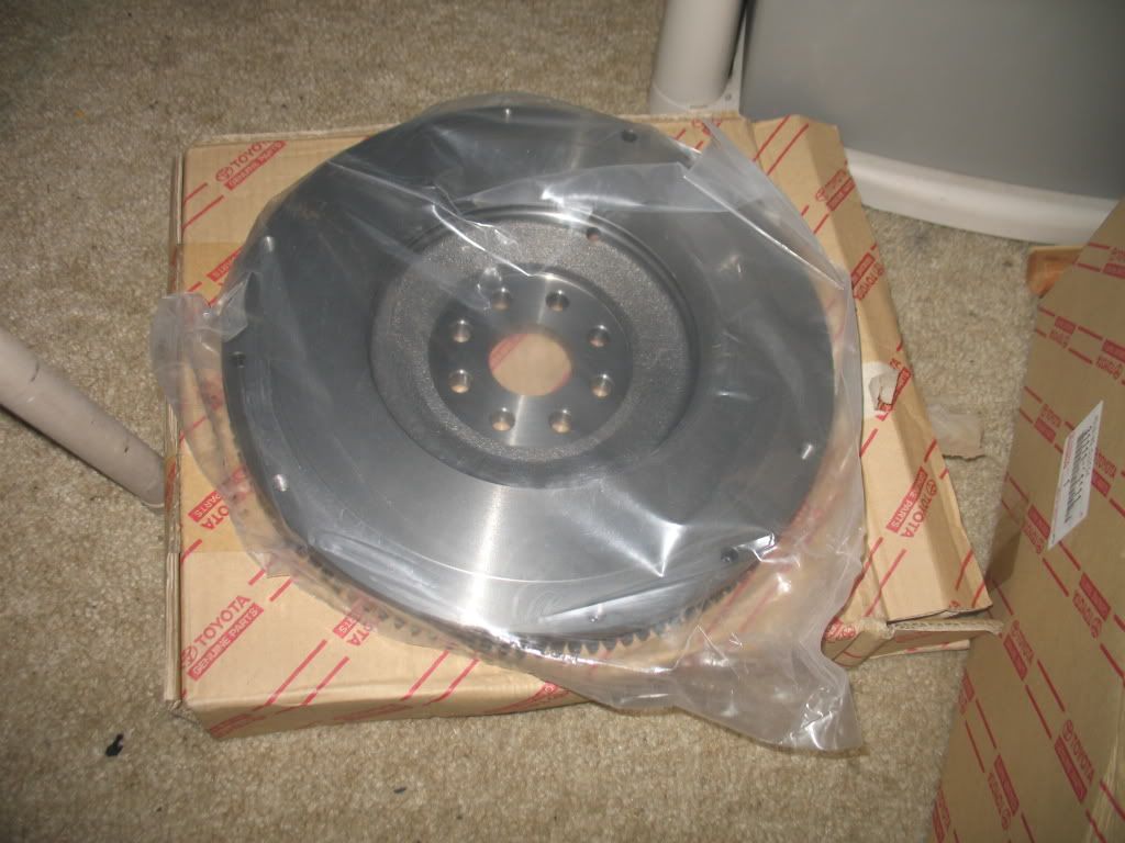

I just got the bell housing and the Flywheel

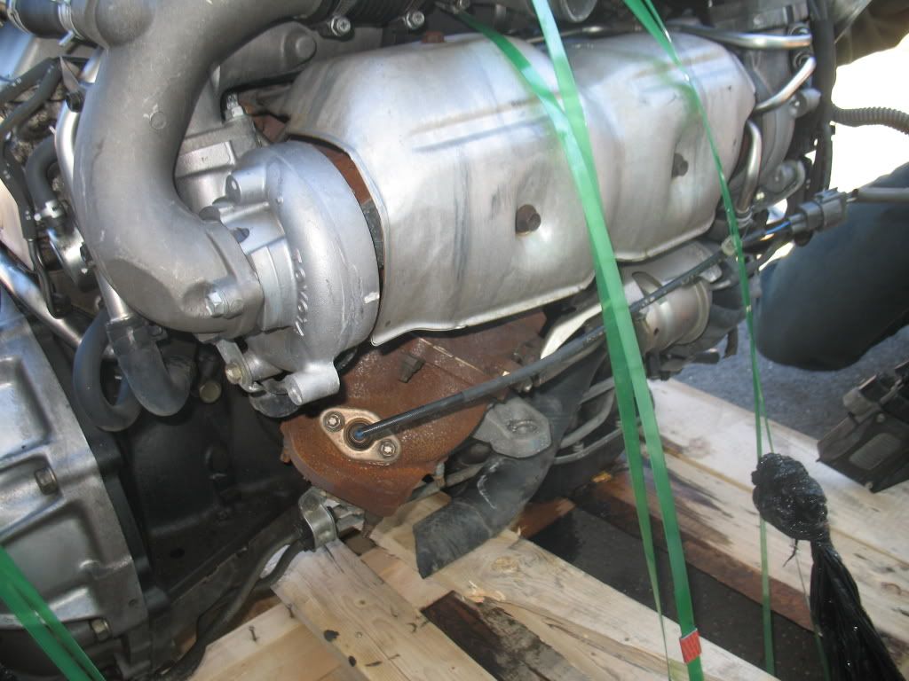

any way, Engine comes tomorrow. Ill be sure to have pictures. :biglaugh:

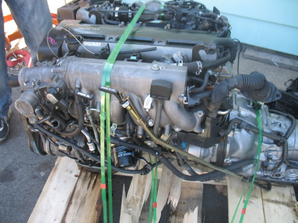

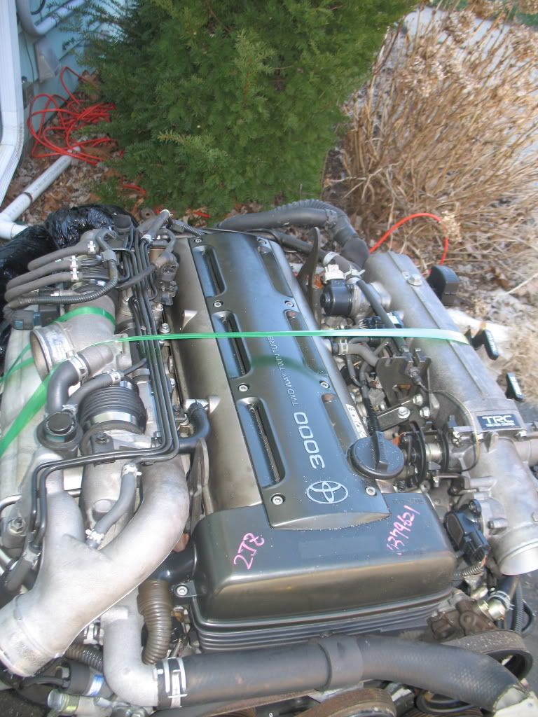

Well got her in :evil2:
I have a few questions.

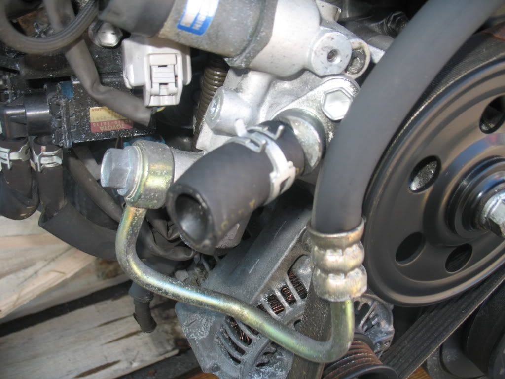

that was the hydrofan right? if so, I need the USDM water pump and fan then.

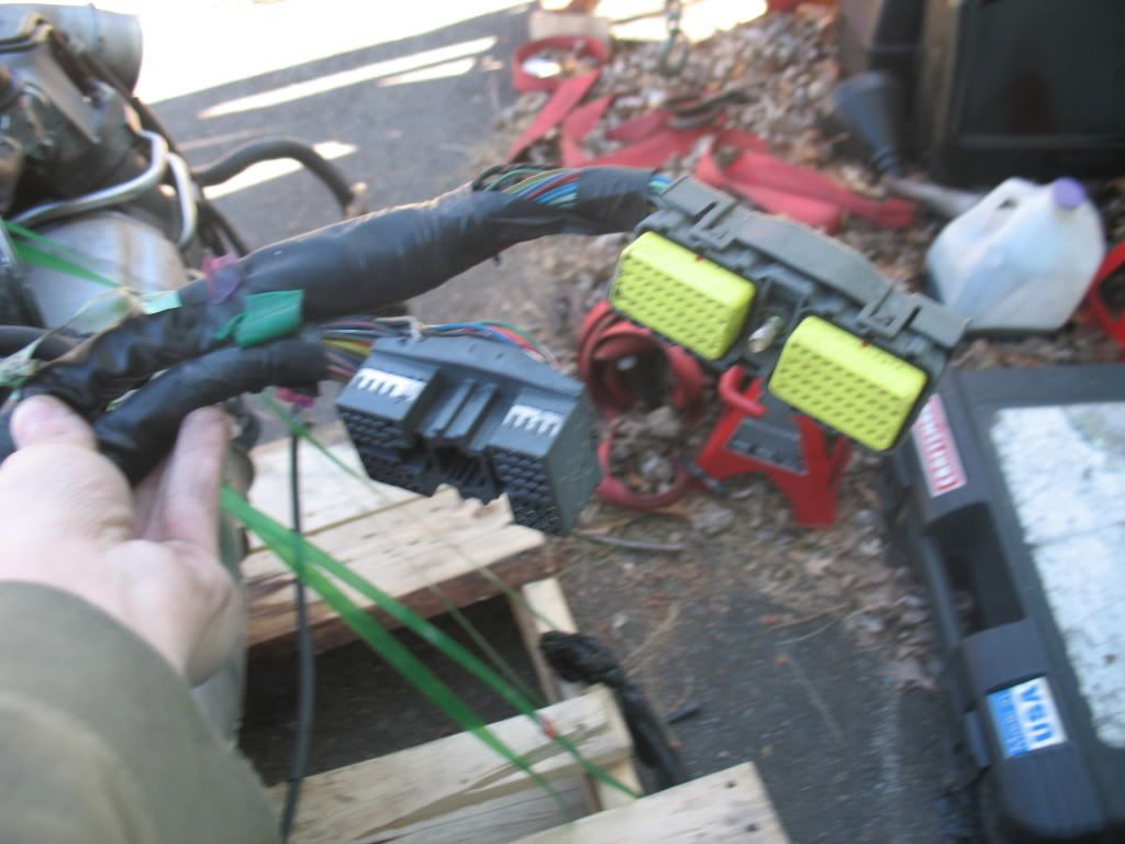

aristo harness right?
and JDM 2jz's dont run maf's, right?

If I go with a new Water pump and pully, will need the clutch fan from a mkiv supra too? or can the 7M fit? and what do I do about a fan shroud?

I'm just running an electric fan on mine but im pretty sure driftmotion sells a clutch that will fit that waterpump. If you end up wanting to going electric and if you need some help just pm me.

yeah that seems to be from an aristo. and its real clean too. Don't forget the rear sump oil pan for the Supra. Before doing any wire extension, open it up and stretch it out. It should fit through the stock wiring hole.

Subscribed! Looks really good. Your engine is so clean and it doesnt look like any connectors are missing or wires cut. It will save you some headaches. Mine had many crushed connectors and cut wires... :icon_evil

nice motor. let me know if you plan on selling the hydro pump. im in need of the pulley.
