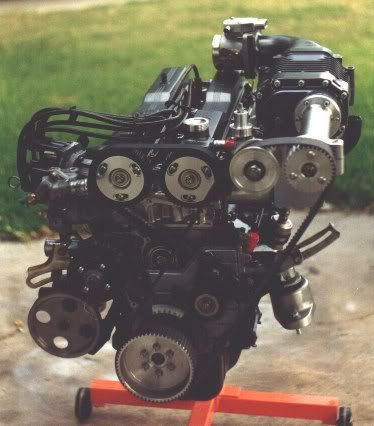

Yes. The mystery 7MGZE. I was gonna post that pic, but you beat me to it Eric. It's funny, it's the only picture out there.

I don't think there are, that guy probably just chose one based on size, and custom fabbed mounts, etc

Stretch said:
Behold...
eric
Behold, photoshop! Besides the obvious disparity between the engine and the blurred background, where is the intake manifold in the picture? And what is the hotwire mass airflow sensor on the intake doing there? When our car doesnt use one.
That pic originally had a white Cressida photoshopped into the background. I see it has been removed. The only thing that could be, is that blower was mocked up to see how it would fit or look. But that is a blower kit, and it doesn't go on the 7MGE.

I am not saying anybod here did anything. That pic has been around a long time.
But take a good look at the intake. Where is it? Best case scenario, somebody removed it and mocked up the blower to see how close it is. And not very close is the answer. Where does the throttle body go?

I thought that piece at the end of the pipe from the back of the charger was the tb. The grey tb sized part. You say it's the maf tho? Could it not be a tb with the tps on the top?
