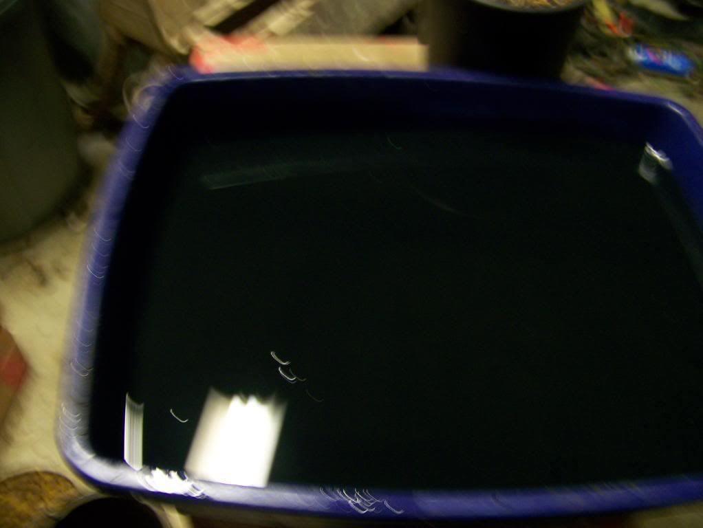

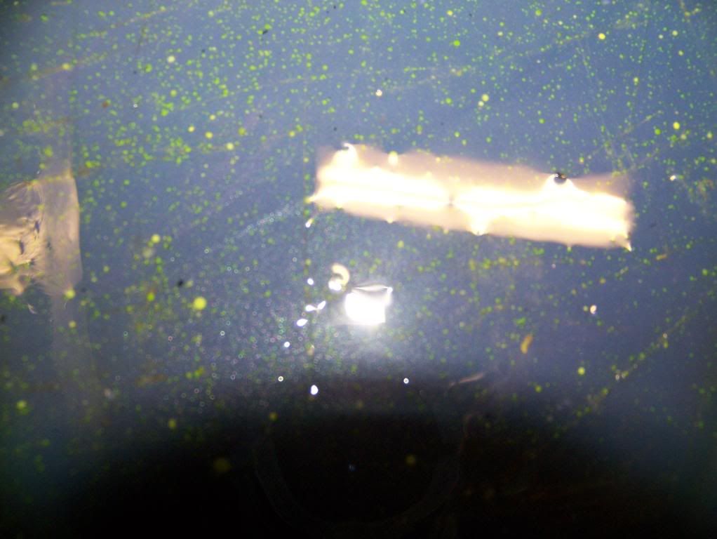

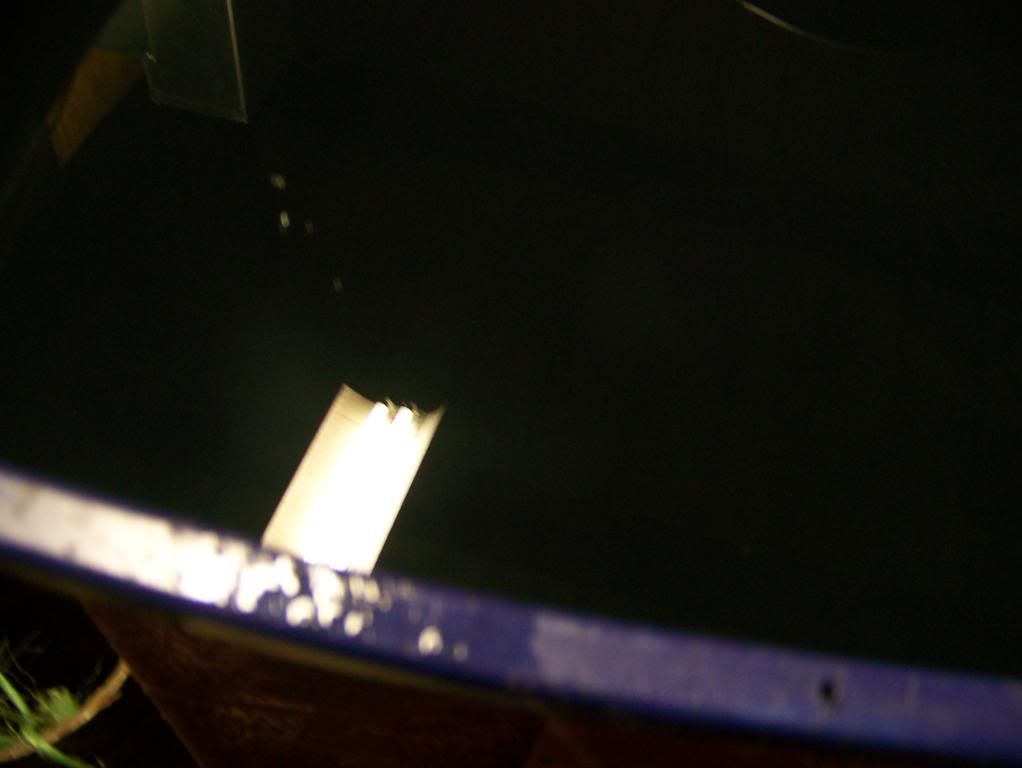

well....went to change the oil and inspect the filter...so i drained the old oil....looked a little wierd for 10 or 15 minutes of running time, but i did use some of that oil dye (not more than recommended) so i think that might be the culprit...at least i know its the culprit to the little bright green spots

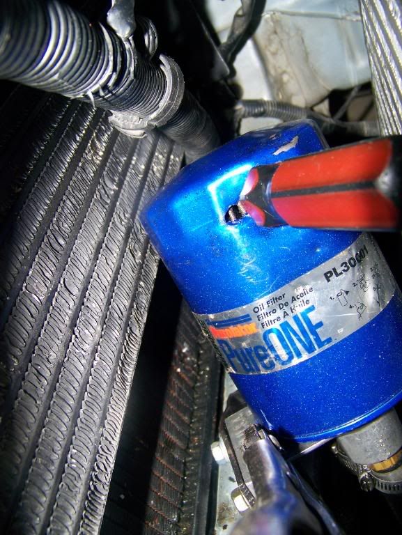

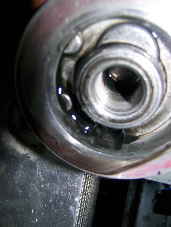

i went to remove the filter so i could cut it open and inspect it...and of course put on the new one! but.....low and behold my stupid ass put the filter on faaaaar too tight and i ended up with this....
yes...i do fail.....
but on another note i loosened up my crank pulley, it really didn't take much to get it off. I'm in hopes that was the culprit i tightened it down to 150ftlbs(as much as the tq wrench i have will go) then gave it another 1/8th or so of a turn to hold me over until i get a better torque wrench. I can't start it yet because i cant put on the new filter lol, so i'll be in pursuit of an oil filter wrench tomorrow and i hope that'll get the job done.

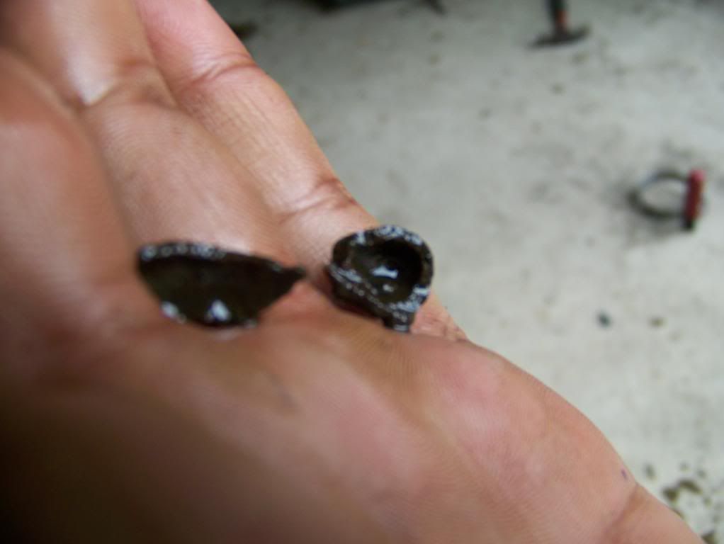

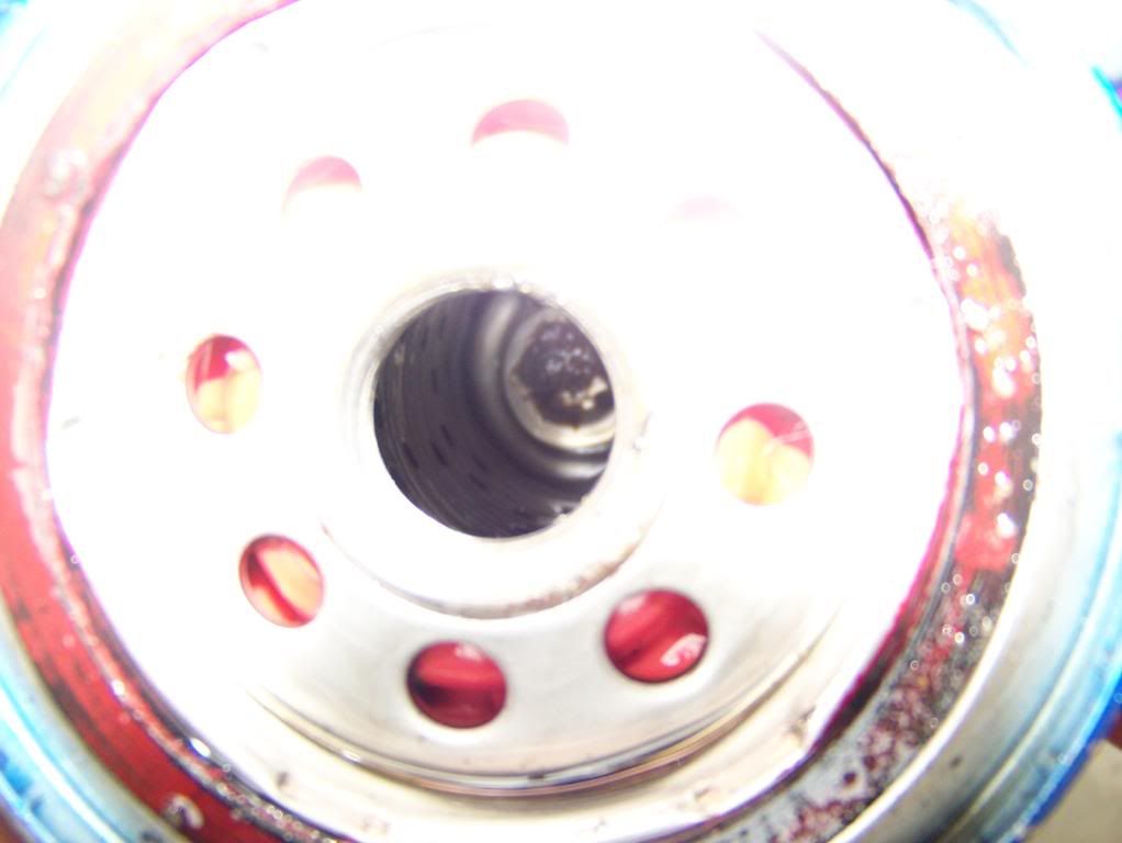

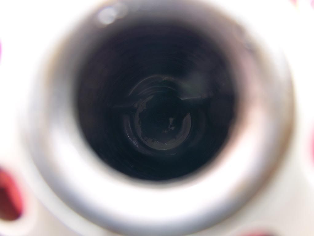

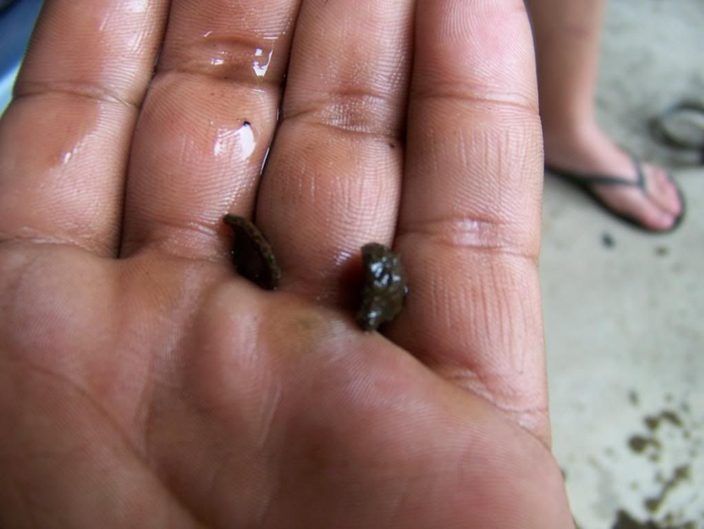

well.....fuck my life.....found out that this is nothing short of rod knock.....i know this because i got the filter off today....shook it....head some rattling around inside of it. I dump it out to find this....
fucking mud dobbers.....anytime i had an open port in the engine i was sure to stuff either plastic bags, or rags into the gap to make sure nothing got in....guess i was wrong....the shop i had the car in was infested with mud dobbers...i never found any of thier nests in the car, or in the engine bay...i found 3 or 4 on the under carriage of the car....and one in the oil pan from intitial assembly before i had oil in it. I took off the pan, and took a flashlight to where i could see and my hand to everywhere a flashlight would't reach and that was the only one.....so i thought......i'm not sure when i'll get to tear in to this because i don't have 100+$ for bearings....hopefully the crank and rods are fine....i did one last running video just to make sure after i tightened up the crank pulley last night and changed the oil. i'll post that vid here in a minute.....i'm so fed up right now.
