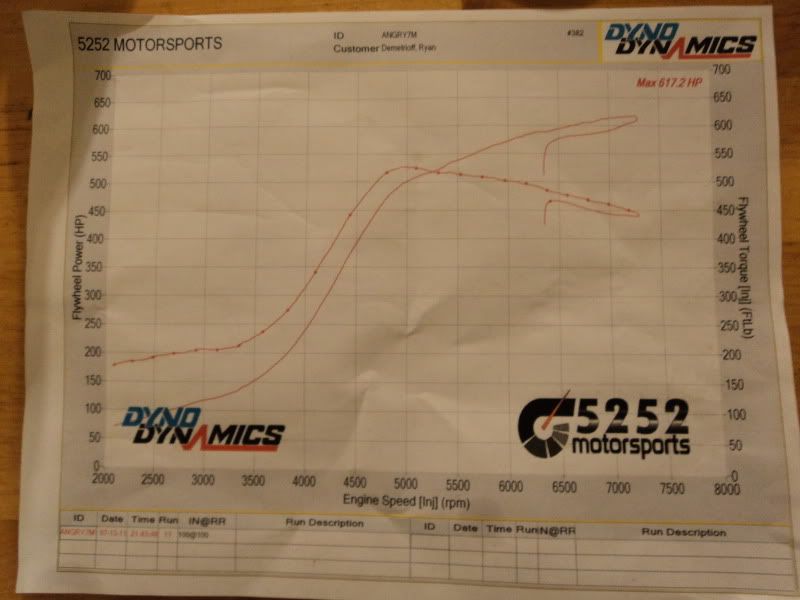

well I was going to post this befor but the motor changed abit it built 7m on basicly 5 pistons
mods one fucked piston and 3 other damaged piston's
motor mods
crank scaper
je piston thermo coated
eagle rods
deleted oil squrters
and 81 hot side
20 psi
my old map was 24 psi at 585
ant this was not a good tune eather even resalted in damaging my motor

mk3-4-me;1819695 said:
Why did you delete the oil squirters?
And when did you see full boost at with the .81?
because forged piston's oil jetting is some what not needed if you have a proper tune, now how long will the motor's ring's last is the big question that I can not answer
since all the pistons heat is transfer though the rings
technically since the dawn of time you pistons have bean cooled form fule/air and the over all temp of your motor
but in the late 80's the some companies started to add in oil jetting on turbo cars to help displace heat because cast pistons can not handle heat all to well nore dis pate the heat to the ring to the cylinder ways properly and over all relibilty 500.000 mile ect
further more oil jetting gives off alot of drag on the under side the piston witch reduse's horse power and rev speed
now is this for you you have decide? there pro's and cons of keeping them and deleting them read up on ask question and you find out if ya wana do it just do not do it with a cast piston or Hypereutectic pistons
for this time around I am going to be slotting my lower connecting rod's to provide more oil to my walls to prolong my ring life
