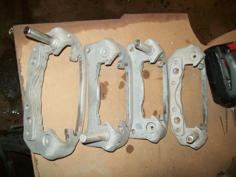

took the rear rotors into work yesterday and turned .040" off the ebrake drum radius.
they work perfectly now...
but, damn, every thing has been an up hill battle today...
go the car rolled out of the garage,

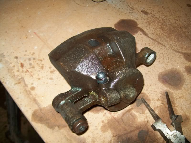

started sand blasting my caliper bits...
the check valve in my compressor nuked now when ever it shuts off the check valve opens and bleeds all the air out thru the head. so I have to let it build to almost 120psi than start blasting...
then the bleeder screw on the last caliper i was taking appart snapps off on me....
so i tried the easy out and that wasnt happening,
then the pb blaster, heat and easy out...
no go.
now ive been building up weld to get a nut on it, welding the nut and over heading it (glowing like yellow , hot) then doucing it with pb blaster, letting it cool, then turning it...
so far all thats acomplished has been braking 4 nuts off the broken bleeder stud...
looks like i have to admit defeat here and find a new left had side front caliper...
Im starting to feel a bit overwhelmed by this project... I mean, ive gotten so much done, and its decently close to running... but im starting to look at it as a chore... i have to really work up the ambition to go out there and get any thing done on it... that and aprils comming quick! Ill be real pissed if i spend the whole summer working on it without being able to enjoy it!!!
well, at least the caliper hangers are sand blasted... Ill force my self back out there after dinner to finish the sand blasting on the 3 calipers at least...

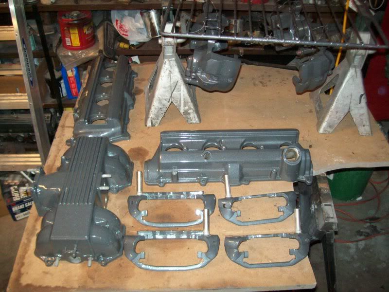

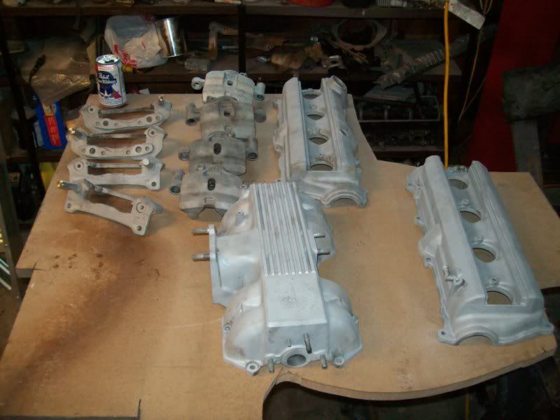

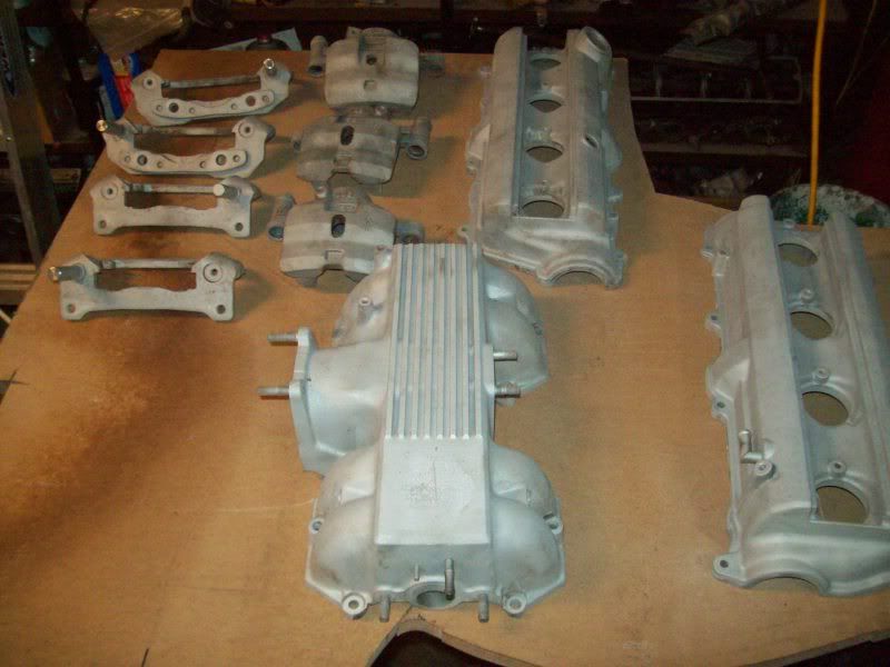

with exceptions of the caliper from hell, i got the rest of the stuff sand blasted today.
guy down the street didnt find a cliper at parts galore so i think i will just order one form rock auto and call it a day...

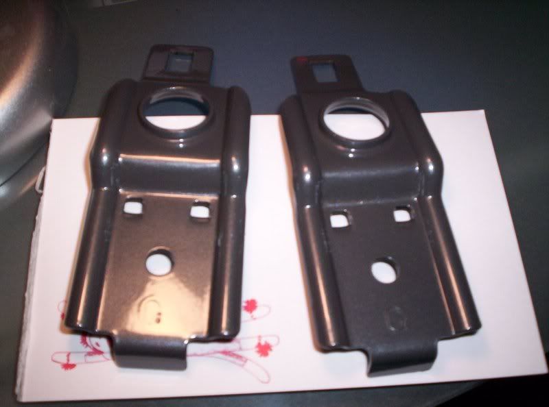

im thinking for powdercoat *since you all seem geeked on me turning out something classy* going with this dark grapite metallic with a thick clear topcoat *some radiator mounts i did for a guy a while back*

Got the caliper in the mail a few days ago... Finally today I got out of work on time and stripped down the caliper, sand blasted it, and powder coated everything. Turned out good, sad that I put the clear on just a little too thick and it cools a little too fast so there are a few cracks in the clear on the valve covers....
All and all, not a bad use of a night.
the ghoul
Sep 30, 2009
86
warren, MI

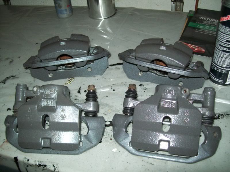

Been a little side tracked by a 91 mr2 I picked up for a daily driver, but despite the work that's been going on there I made some headway on the supra.
aside from one dust boot that i mangled (make sure the old one is removed fully before you attempt to press the new one it! :rofl: )
calipers are all rebuilt and ready to go in

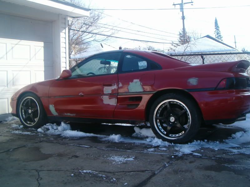

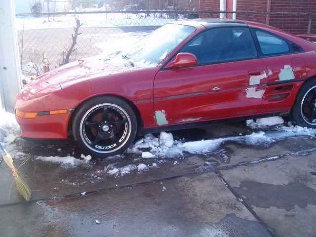

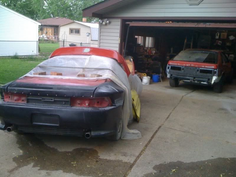

been about a month... figgured id let you all in on whats been keeping me busy
I got sick and tired of driving the minivan around so i went out and bought a piece of junk MR2 to get me around town till the supra was done enough...
well little did i know that it was actually a piece of junk!!
here was the car when i bought it;
Kid tried to start it in the middle of winter and couldnt get it to fire, and let it sit. When i went to pick it up, it started right up (after i talked him down to $700 from the $1400 he wanted; and he kept his rims, seats, steering wheel, and battery).
What i knew was wrong with it when i bought it;
- lower radiator core support was busted off
-200k on the car, 150k on the engine he put in it
- new bushings and suspension all the way around
- seats he gave me were ripped up and nasty
- needed body work like crazy
- part of the exhaust was missing
- timing belt was frayed
- idle would not settle down to 800rpm (stayed at 1200)
- passingers mirror was busted
- radio was missing
- shifter boot was missing
- wheels were comically bad
- drivers door panel was bad
- upper timing cover was missing
What i discovered while loading it on the trailer;
- none of the drivers door/window controles were working
- you had to push the clutch peddle to the floor to get it to dissengauge and after holding it there for a while it would slowly start to re-engauge
- all the bolts were snapped off in the engine hatch
- e brake didnt work
So far this car has had a snow ball effect in repairing it; one thing leads to another, leads to another ect....
The lower core support was broken off and twisted like it had been run into a curb;
- replace the core support
- radiator turned out to be bad
- radiator fans were missing (just gone, no trace of them)
- lower radiator isolator rubbers were bad
E brake cables were snapped;
- replace cables
- all the brackets/clips/pins were missing from the rear calipers
passingers side pop-up headlight was bad
- had to remove front bumper cover to access it
- had to cut the front pumper off destroying it ferther
- had to distroy front turn signals and trim bits
*this one is my fave*
trouble shoot the fast idle
- discover the coolant temp probe was bad
didnt fix issue

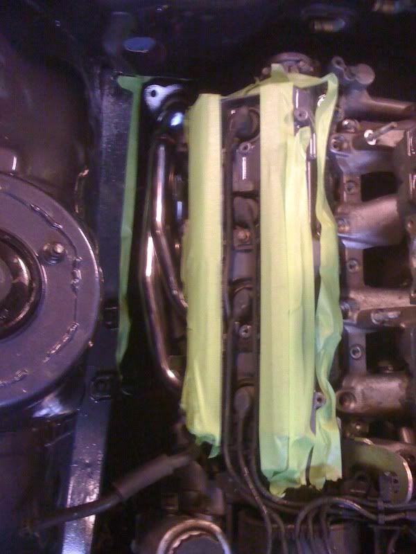

- decided the egr valve was bad, removed egr system.
- in the process of removing the egr system i had to undo a fitting next to the distributer wire connector, paranoid that i might damage the connector i attempted to remove it from distributor. As i wiggled the connector i realized that the whole distributor was rotating (the bolt was never fully tightened)
- looked for timing marks on lower timing belt cover and found out
#1 the lower belt cover was also missing
#2 the bolt holding the crank pulley on was backed out about 1"
#3 alternator belt was chewed up
- removed crank pulley bolt and discovered why it was backed out 1" (cross threaded)
- attempted to remove crank pulley (stuck on there so hard i snapped off 3 of the grooves on it and dislodged it from the rubber center isolator) I had to devise a pully puller to get it off.
- discovered the reasion the timing belt was chewed ( the aligment washer that goes between the timing belt cog and pully was bent and twisted)
- discovered why the alt belt was chewed up (alternator was locked up solid, casing was shattered)
- checked all the timing belt pullies, 1 was extreamly bad, another one had 1/8" of in and out play. The one with in and out play turned out to be the oil pump! :32:
- oil pump is intigrated into the front housing of engine, which attaches to the oil pan

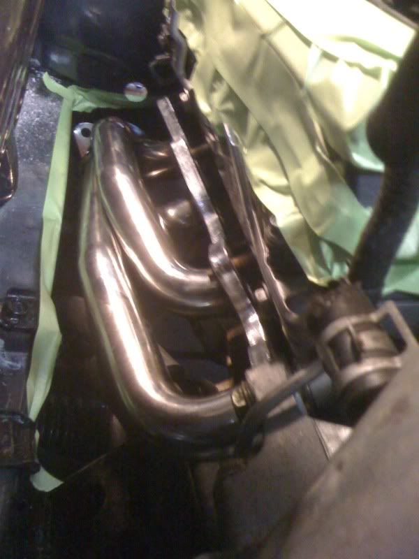

- had to remove the new headder i just got done installing, get a new oil pan gasket
- found out why i had to rebend the header i bought for the car (was hitting the oil pan); turns out the engine the kid used was from a celica and featured a crank shaft counter ballance to lessen engine noise and vibration. This required a deeper oil pan to accomidate, thus the fitment issue.
- counter ballance was promptly removed, and oil port plugged.
All the new bits are arriving little by little and hopefully after this weekend she will be moving under her own power again.

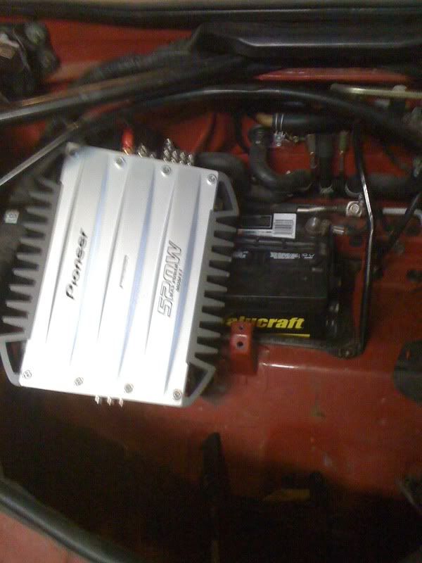

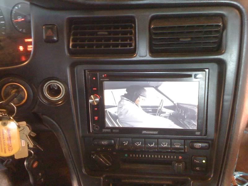

- Ive also been having fun with the sterio; installing my touch screen dvd player, 6.5" componets on all four corners, 4 channel amp, 1 channel amp powering a pair of 8" subs, and a making behind the seat boxes to house the rear speakers and subs

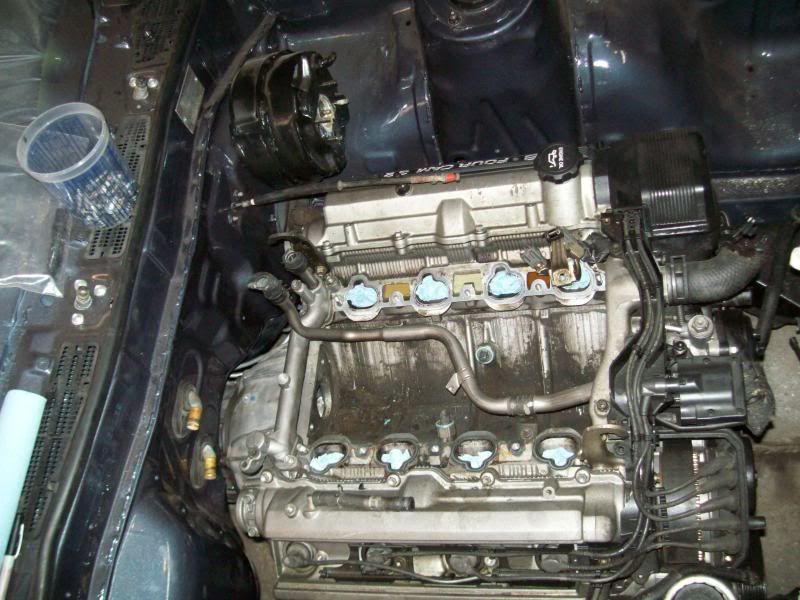

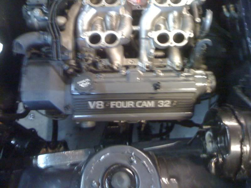

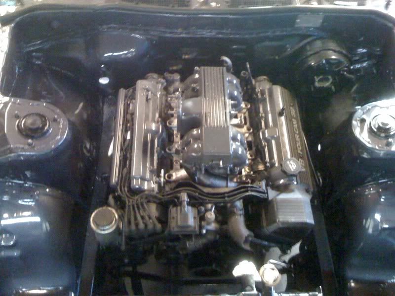

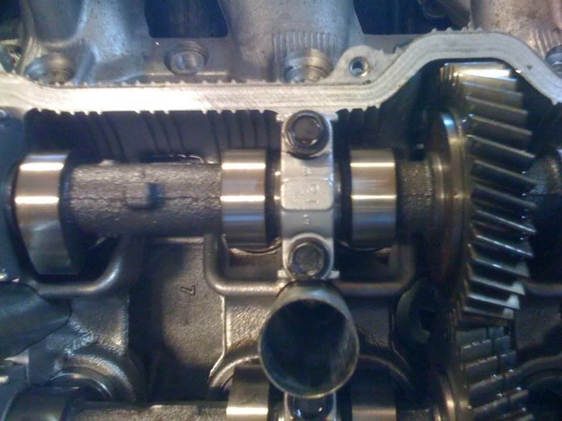

found some time to install the valve covers; I was worried they would clash with the body color too much but I think they are just right
btw; I loooooove real jdm engines!
I got the hole knocked into the firewall for the engine harness and did a quick test fit of the passingers side header.... Looks like the only modification I will have to make is opening up the hole pattern (again these are cheap eBay 3uz tundra headers)
