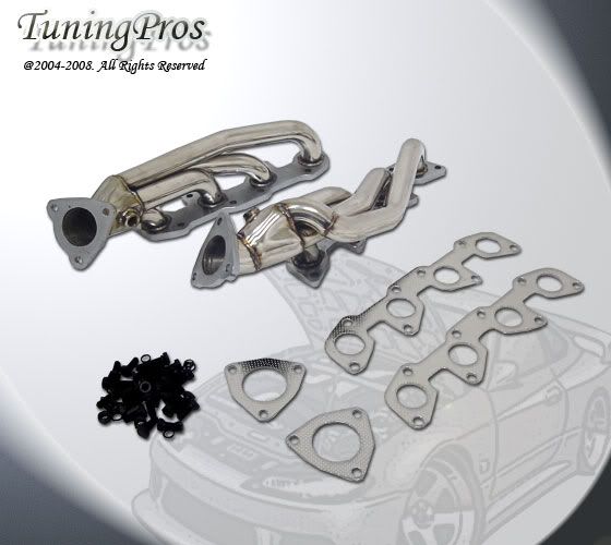

-xenocron.com 255lph fuel pump (model xfp-341)
-cheap-o ebay tundra headers (I know they are not going to fit, but they should be close enough for a good starting point)
- 1.5” dia “J” pipe sections (two of them)
so after the stitch welding is done and the underbody is por-15’ed I can throw all the hard lines back into it, hoist the tank into place (with new pump!!), install the rear cradle for good, and start fabricating the exhaust system…

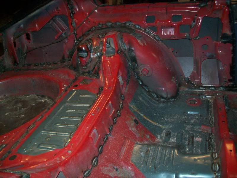

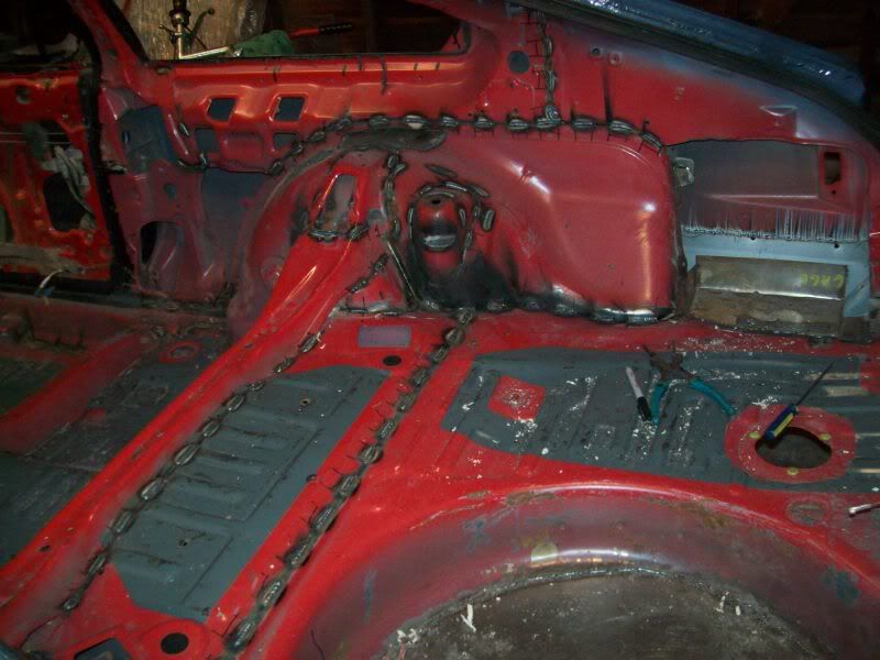

hu, didnt get as much done as i wanted to...
guy 2 doors down from me gave me $50 to finish pulling an enging for him (just had to dissconnect the o2 sensor, and take out 3 bolts supporting the passingers output shaft housing and she popped right out)
then as soon as i finished stitch welding the intirror i ran out of weld gas....
and the gas supply place is closed no thru the end of the weekend...
so it looks like ill have to wait to finish the stitch welding on the underbody.
but at least the intirror is done!!!!

I purchased a set of those headers as well! I had to drill out the top holes on the flange to get it to slide onto the exhaust studs though. Other than that, the only other thing I see as a bad point would be the cheezy flanges, but the welds are very well done.
wow, i was totally expecting to have to replace the flanges!!
I think with the mk2 im dealing with less room between the frame rails and i think my steering linkage is in a diffent place...
so i think mine will need lots of re-work...

Hey Kevin, looks like things are rolling! To my understanding, is that the tundra headers hit the steering shaft for the LS/SC/GS chassis. I'd imagine the fit is going to be much more difficult for you chassis.
I'm keeping up with your thread everything looks way promising!
yeah, im approaching these headers from the stand point that i will have to cut them apart and re-configure them. I basically bought these ones hoping the head flanges are some what correct, and for the exhaust flanges, collector section, o2 bungs, and piping. Any thing close to correct fitment would just be a bonus.
I figured if i couldn’t make these work its been proven that the sc400 headers fit with minimal modifications.... i just want something that looks a little bit more flashy, and hopefully flows better...
thanks for the encouragement and for lookin!!

ogre;1478058 said:
nice work... what kind of welder are you stich welding with?
nothing special, little linclon 115v model with 135 in the name (can never remember). Im running .023 solid wire with 75/25 gas i use that little welder for darn near every thing!

Please don't use a mig welder on your headers.
But the build looks great anyways. Keep up the good work
ill just dip into my trust fund and pick up a tig....
serriously, on this project, i gotta work with what i have.
I know the ebay listing clames its stainless, but im betting its a very low grade. that with the clean air mask i picked up from work (has a resperator tube built into it for a fresh air supply) I have no doubt i will be able to weld them safely.
They wont look the best, but im not going for show quality. Im going to clean them up best i can and eaither do some headder wrap or i have some good high temp header paint...
