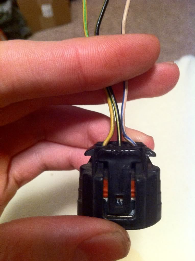

I'll do my best. School+Gym+Work= zero wrench time. I know this probably sounds stupid, and I've seen it many-a-times.... but I can't seem to find it. Pin-out numbering goes left to right, top to bottom for male pins, and right to left bottom to top for female pins, si?? And would this particular alternator plug be female??

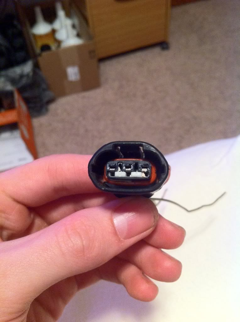

Andy I promise I do have a supra!! Here is proof, and I apologize for the delay.
Oval Alternator Plug [3-Pin, Toyota Chaser]
Pin #1: White/Blue
Pin #2: Black/Yellow
Pin #3: Yellow/Green
Again my info from Tweak'd Performance: Looking at the BACK of the alternator plug on the 86.5 body, Top pin goes to pin #3, bottom right to pin #1, bottom left to pin #2.
