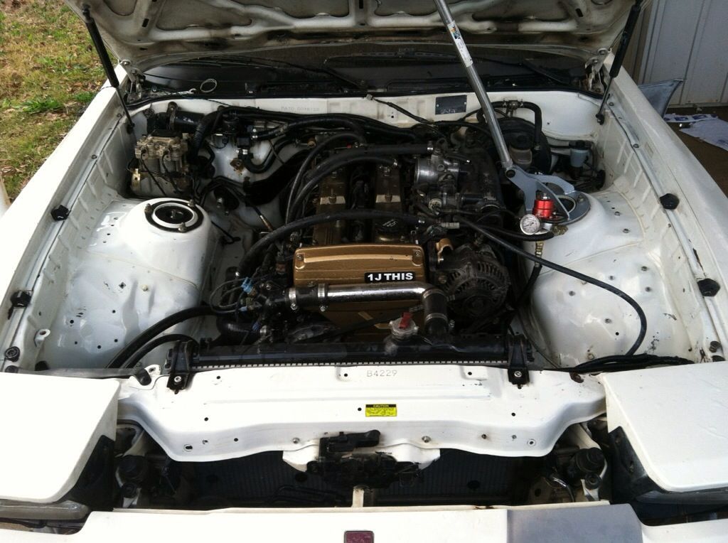

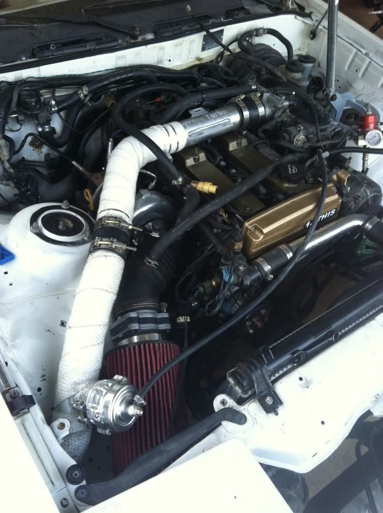

took me a while but it turned out nice, going to go a little farther while Im doing a JZ swap.
Before
After
Before
After

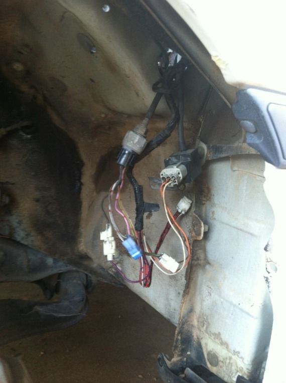

Did you have to extend any wires on anything and whereabouts did you tuck everything? Care to snap a pic?
jessemkiiis
Sep 28, 2009
490
Childersburg AL,
I extended a couple wires for my maft translator but that was it. everything went in the fender wells. I have some during pictures but didn't take any once it was done. I also made brackets for the big pieces and ziptied the rest.

You can mount any relays or resistors on the rear of the inner fender wells. If you have a/c the wires need to be extended around. Not too hard tho.
