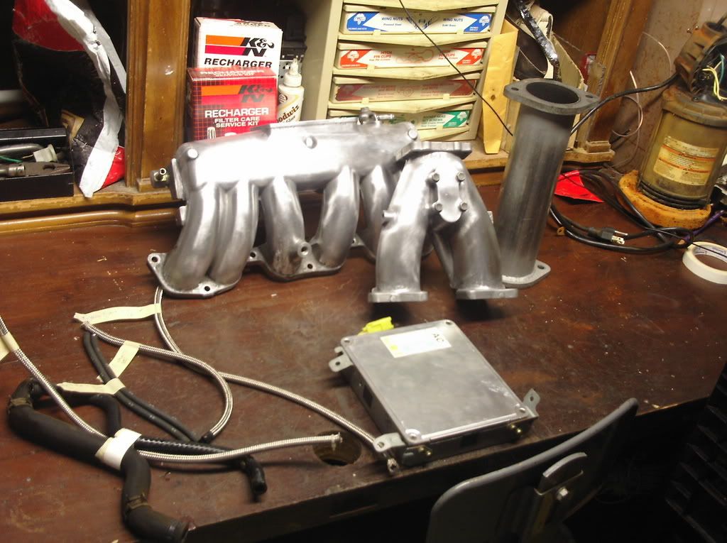

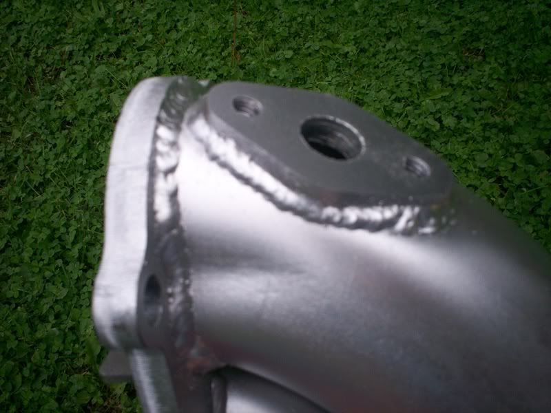

Hey guys, as many of you know Im going NA-T. Well, here we go! Real Quick list of the stuff thats going on!
CT-26 and manifold
BIC DDP
24x12x4 Intercooler and Hard pipes
Cometic Head gasket
ARP headstuds
K&N intake
3.5 inch exhaust
Associated gauges
Rebuilt head
Walbro 255lph fuel pump
SAFC
LM-1
Ive pretty much got everything so far, except the intercooler and all that ive got to do is put this bad girl back together!
Thats jsut a real quick list. You get the point. Also is all the GTE electronics, ECU wiring harness ECT--ECT--ECT

BIC DDP- This things AWESOME! (thanks mr. Shaeff)
LM-1 Wideband
SAFC
HKS racing BOV

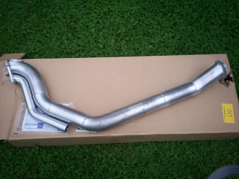

Exhaust( should like good with a nive 45 degree angle!)

to compare notes, how are you going to set up your oil lines? Originally I bought stock lines, but realized it would be easier to go with the rabidchimp.com oil line kit. What exhaust system will you be going with? I plan on going with a 3.5" too, 935 motorsports exhaust system is probably what ill purchase and swap the muffler out with a HKS TI
s383mmber1
Oct 31, 2005
3,614
34
Somers New York
For the oil line, probably custom, not 100 percent sure yet. Maybe Shaeff will chime in here as hes helping me out quite abit!
For exhaust, im going with a open BIC DDP for now, and when emissions come, ill hook up my stock NA system. Then take it off soon after. I dont mind the noise, and dont feel like dropping 400+ bucks for an exhaust. That money's going towards my maft pro and other stuff.
Eventually i will go to BIC for his exhaust.

You can get a muffler shop to do a Full 3" custom job doesnt cost too much other then that love how your car is so mint and glad to see your joining the dark side.

lol, thats exactly what ill be doing until I can drop the change on a cat back. My dp is a megan racing one though with the stock elbow. I wanted a BIC, but i got this one for like 80 bucks. My car has been down for so long, hell ive owned it for a little more than a year now and its been down for all of it except like 2 months. Im so close to getting everything back together and getting it on the road again.

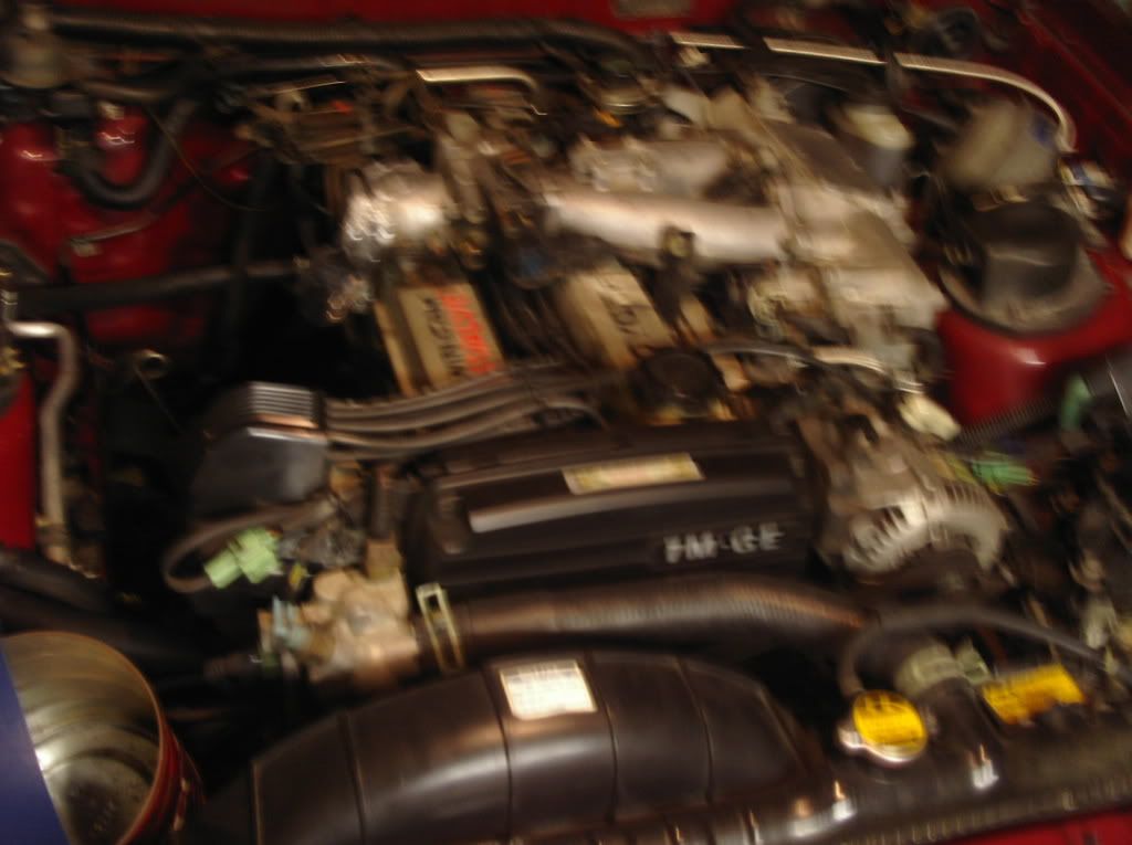

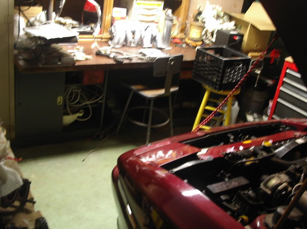

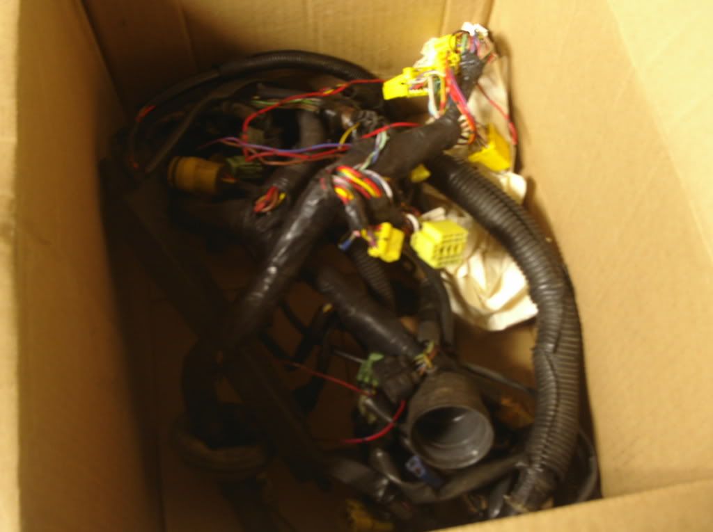

Update-
Got alittle bit done today after school. Mostly hooking up my sweeeet sound system:naughty: :bump::bump::bump:
But i did remove a few hoses, cleaned ect.
And a few new parts ect. HKS original racing BOV (not-ssqv) should be here real soon!
Not looking forward to this disaster. ;)
Labeling EVERYTHING. Not fun, but should clear up in the long run a little!
