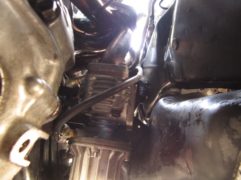

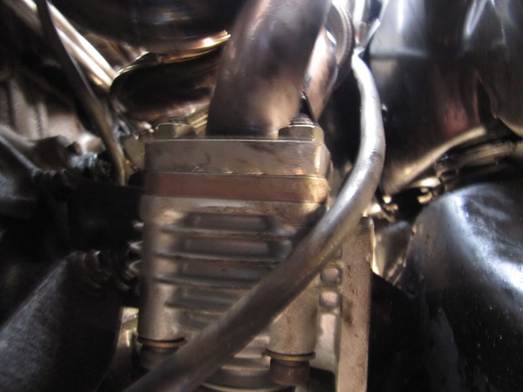

ooohhh, well ima go bolt my DP back on after i take some pics of thw WG, and i'll take off the MBC then post up my findings.

MDCmotorsports;1366781 said:
Id like to see how you have the lines setup to the waste gate, and how you have the wastegate bolted to the flange on the manifold.
i'll get some pics of the lines up tonite.
lemme know if you see anything out of place.
thanks
taking the MBC didnt do anything but lower boost to 7psi, and it still didnt hit it till over 4k rpm, actually seemed to spool slower.
