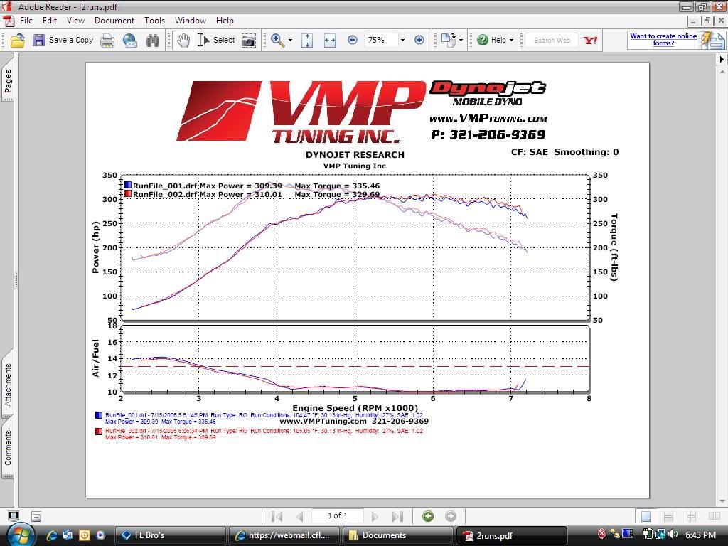

For an argument, I dyno'd with stock cams and made over 300whp for 2krpms with the exhaust cam retarded 2.5 degrees with a crapload more torque.

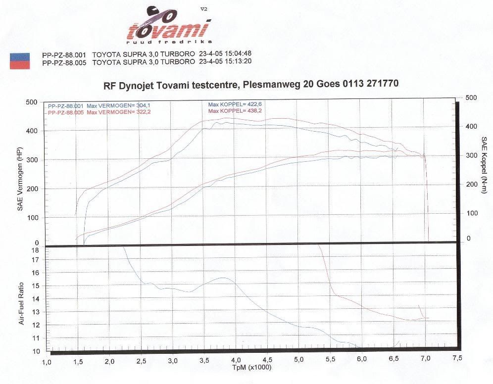

Don't want to put down anyone, but I'm not really impressed by the 2jz cams numbers.
Here's a dyno I did 2 years ago on stock twins, stock cams, no cam gears.
Upgrades are: 550's, SAFC, A-VCR, 2.5" exhaust, Skyline IC
To translate: 'vermogen' = power in hp, 'koppel' = torque in Nm, the 438Nm equals 323ft-lbs.
So: 300+hp between 5000 - 6700rpm and 300hp up to 7000rpm...
(don't pay attention to the A/F's, they are from a probe in the exhaust which works crappy, we used the on-board AEM-uego and that was all good numbers)
Come on people, you can do better on 2jz cams!

So, what are you saying in your dyno :dunno: ? Was that a before and after with the 2jz cams? Or just your dyno numbers?

I'm saying these were 2 runs without 2jz cams, just the stock 1jz cams with some safc tuning in between.
So the numbers I've seen here on 2jz cams with stock twins are lower than this.
