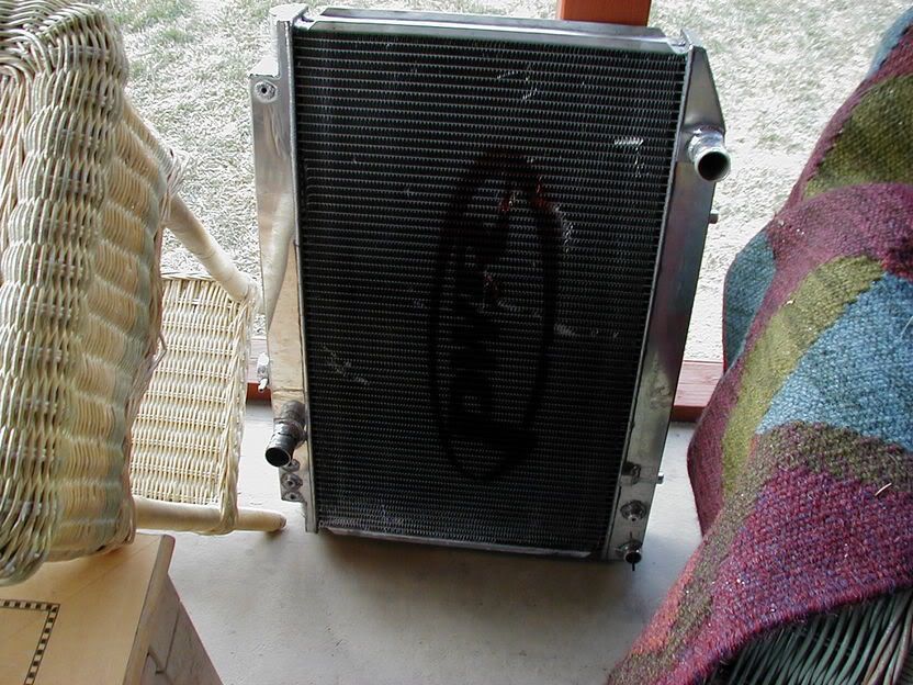

Dave (Grimjack) had to cut a hole in the top of his shroud, because the PWR is so thick it moves the shroud within 1/8" from the stock fan blades, and they can easily jam the fan and break the shroud.
62
0 fit issues here with ALL of the stock gear and a PWR Brad.

Myself and another guy nearby have Fluidynes. We both run Toyota red. Both weep coolant at the ends of the upper and lower tanks. I sent mine back to Fluidyne but they claimed it passed their pressure test. I shipped it with all of the original packaging including the cardboard on both sides of the core. They dented one of the top mounts, stuffed it in a box with peanuts and shipped it back.
Edit: I should add that the Fluidyne radiator fits perfectly including the stock fan shroud and aux fans. I have absolutely no complaints on fit, finish, or performance, just the leaks.

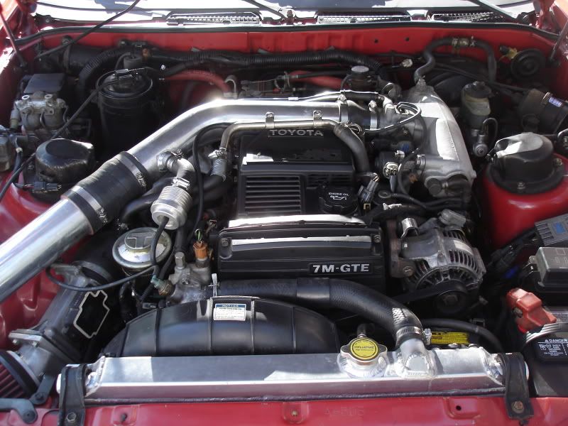

ma71supraturbo;1414459 said:
Koyo R: $360, 2-row, 2.1" core, 20 fpi (requires modification to fit factory fan shroud)
That is an untrue statement and needs to be corrected!
If you keep the hydrofan or fan shroud of the JZA70 then no modification is needed because it is designed for the JZA70.
I know because everything lines up and fits perfect in my car.
You should also note that if you go with anything thicker then a koyo good luck getting the mechanical fan or an e fan in there!
Half true, since it doesn't fit perfectly with the 7m shroud, which is what your car probably came with. But I've made that notation a little more accurate now.
