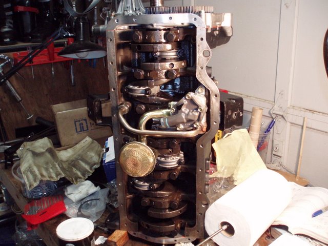

No need to check on the oil pump fitment- I will tell you right now- the mk4 (2JZ-GTE or GE) oil pump assembly will not work on a 7M, ever. The 7M has a remotely located oil pump that is driven by seperate shaft so it can be in the middle of the block. The JZ series has the oil pump as a part of the front cover and the oil system is plumbed for it to work that way. They will not swap over.
7M pump:
7M front cover:
2JZ pump:
I'm not trying to be a jerk, I'm trying to give you the correct information. There is too much misinformation floating around that it's hard to know what is good and bad info. :)
