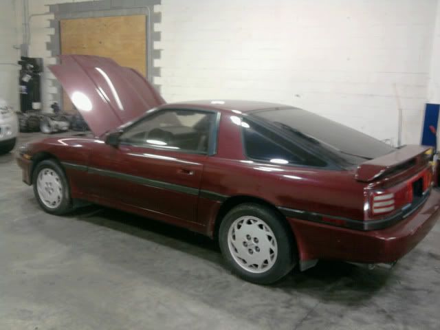

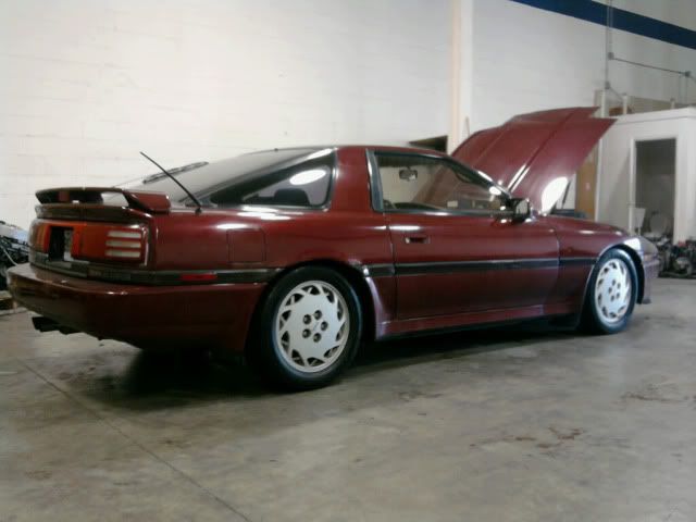

OK maybe someone can help me out on this. I just got some adr-7 17x7 wheels, the tires on them are shit and way small (205/40) mounted one to see how the rims look, and it looks like they are tucked into the wheel well like an inch or more? Is that just how it looks with the small tire? I found some 245/55/17 which i just found out came off a truck. what would be a good size to install on these front and rear? I do not know the backspacing but tried measuring from hub to lip and think it was 5.5 inch, the 16s i took off are like 7 inch? Should i get some wheel spacers or what?
Also found a set of 235/50/17 any ideas

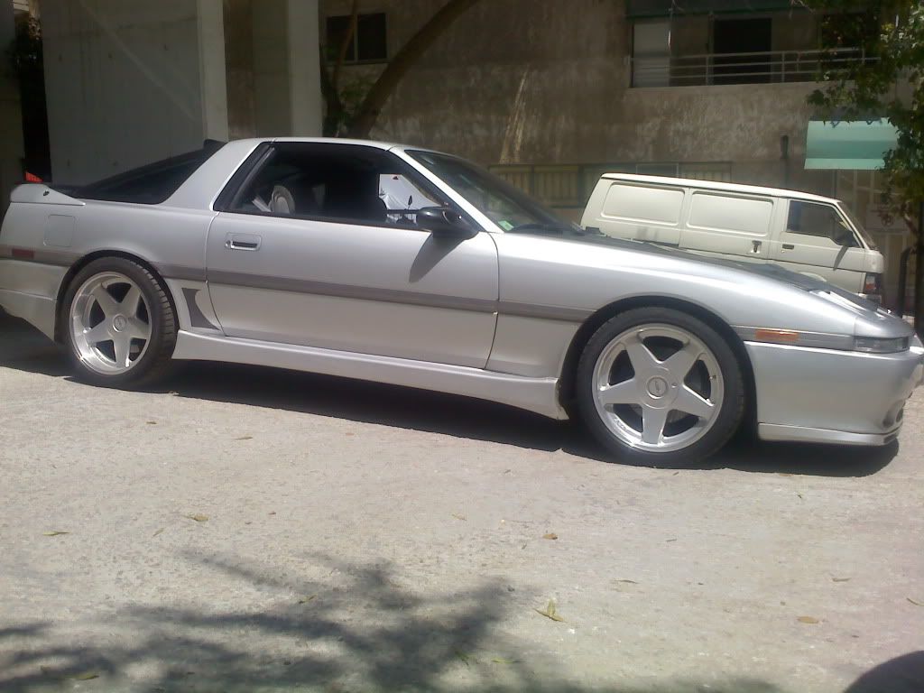

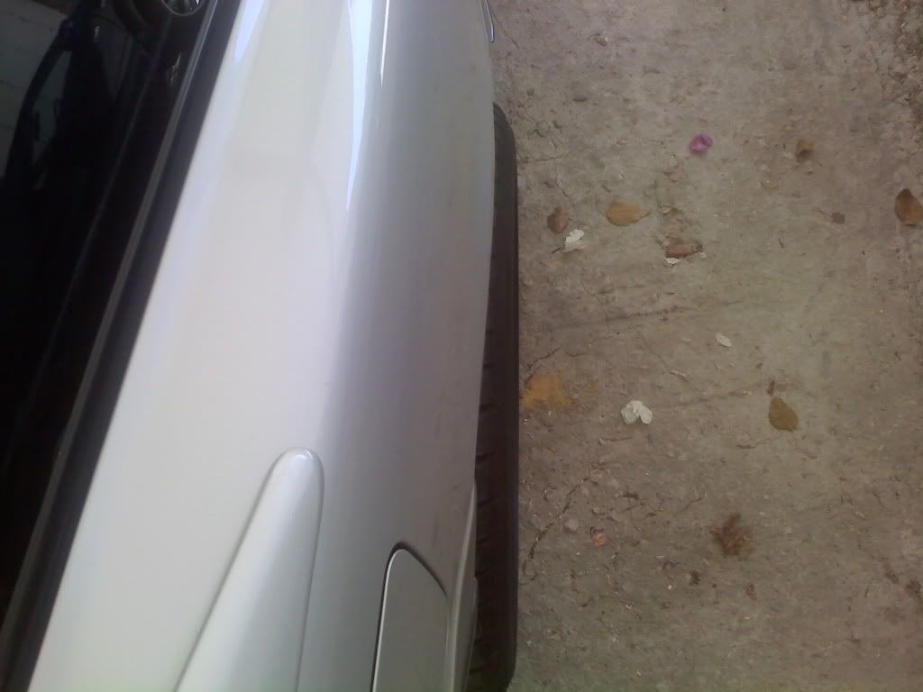

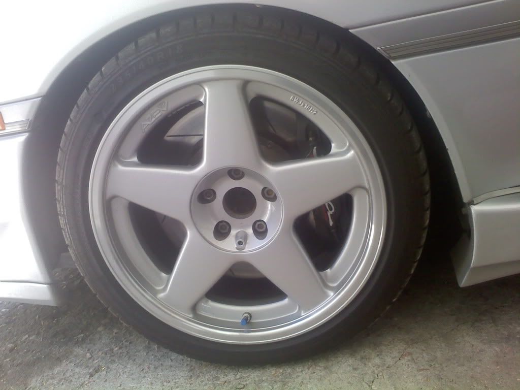

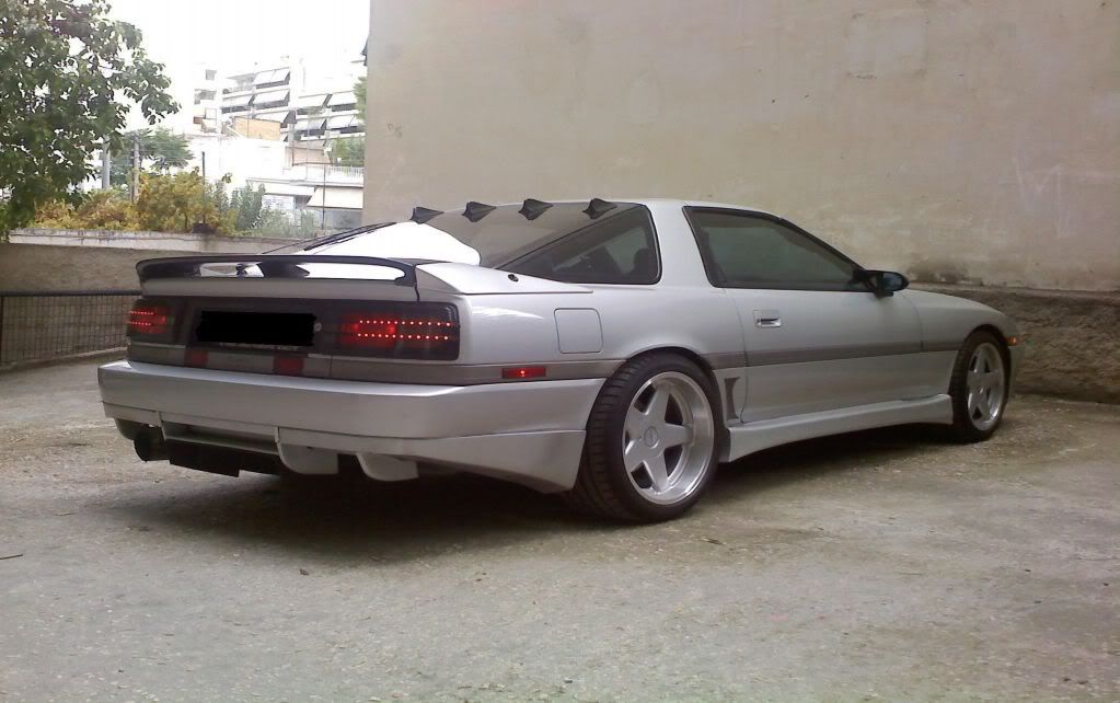

Hi guys... Got these new rims and tires 10 months ago and wanted to share with you some tips and infos!
Rims are Azev type A (from Germany) monoblock made from realy strong alloy material. Always loved the
Work Equips and since they don't make them anymore went with these A type Azev wheels that have a
kind of a similar design.My car is on Tokico (TEMS) shocks and Eibach springs. Anyway here they are :
Front are 8.5' x 18' (+25 offset) with 235-40/18' Dunlop SP9000 asimetric tire. (0 camber)
The offset choise on the fronts is between +18 to +35 given from 'Azev'.
They fit very well.They also clear my BBK (14" / 6 pot) very well ! They don't rub at all. I think I could fit a bigger tire like 245-40/18' without any issues.

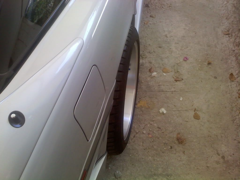

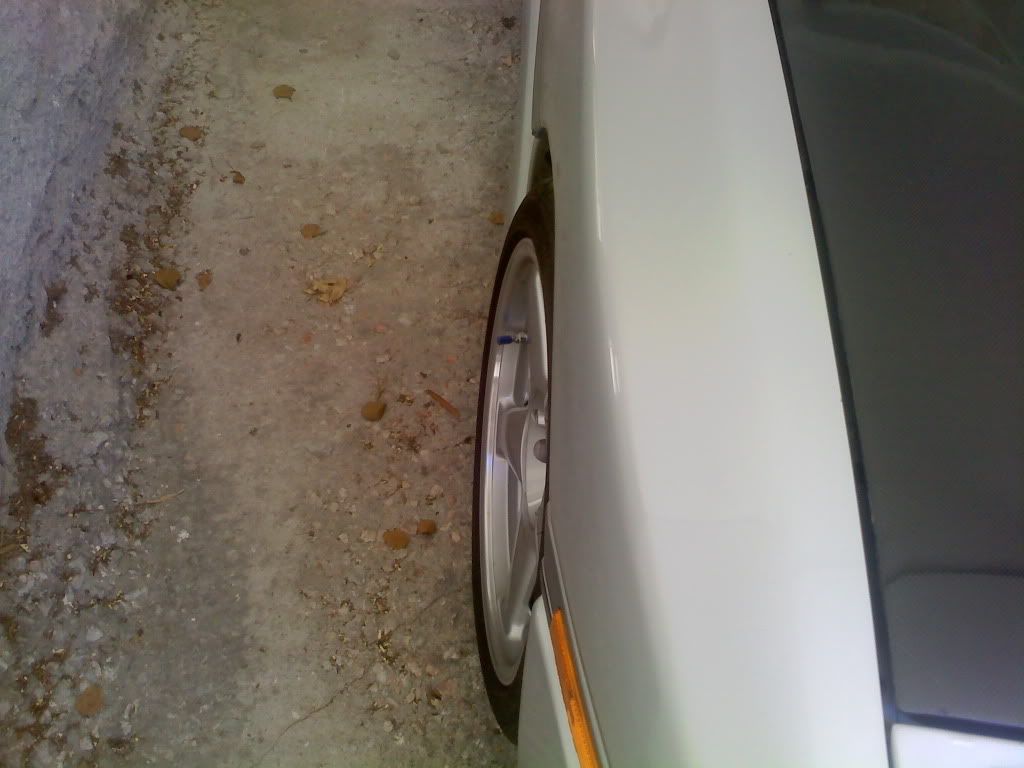

Photos of the front:

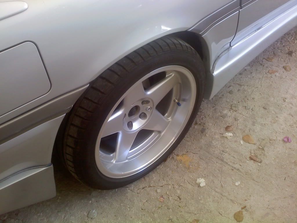

Rear are 10' x 18' (+20 offset) with 275-35/18' Dunlop SP9000 asimetric tire. (0 camber)
The offset choise on the rears is between +10 to +24 given from 'Azev'.
When I first drove with the new 18's wheels/tire combo I had a rubbing issue. And a very bad issue if I had 1-2 person in the car.
I rolled the rear fenders and did a very slight pull. Now is much better and almost OK!
Photos of the rear:
Like I said,now is much better but I still rub sometimes when I get into a bumpy road or turn on a big curvy road with bad asphalt and have more than a passanger.
Future plan after summer is to machine the offset to +24 (from +20),wish I could take it more,like to +30 and solve the problem 100%.
I will also get some swaybars to help the stability of the car. Then I think I will have no more rubbing issues... Last choise will be a 265-40/18' rear tire.
I want to have zero rubbing issues even with +3 passengers and a full gas tank cruising on every kind of roads or highways!
