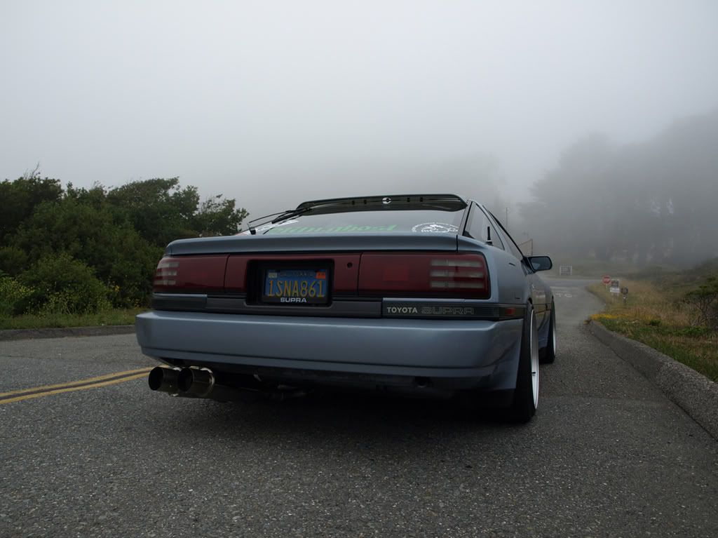

one have a pic of how a 19x10 +13 would fit on the rear?
It will be close to when i had 18x10.5+15 but be about 1/4" in more. let me pull up a pic
Do you know what the offset and width of the wheels in front are? Also what size tire is that in the rear?
Of course I know. :biglaugh:
18x9.5 +15 in front. I had 245/40/18 tires all around. But because I was running RE01R's in front it seemed much larger then the Falken ZE 512 in the rear.
