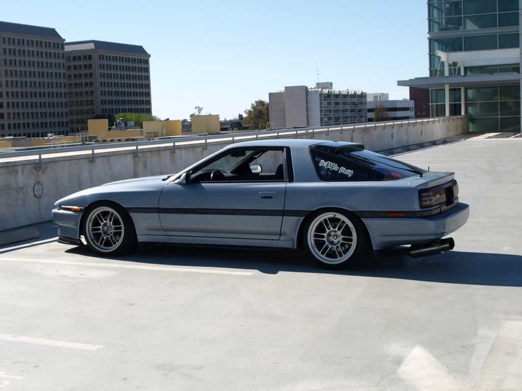

A-to-the-J;799718 said:
IMHO, Jose has one of the best wheel fitment to date. the new wheels he has are awesome and the pictures posted just don't do it justice.
EDIT: i stole a couple of joe's silv pics.
pure fucking sex omfg:aigo:
