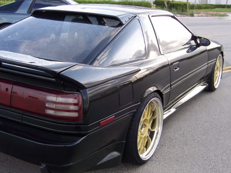

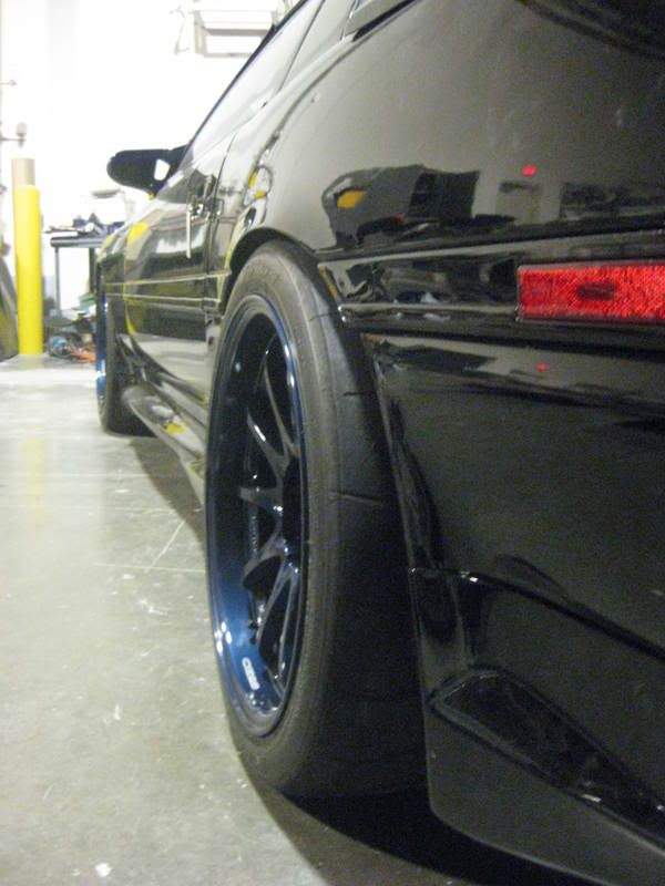

Wilcox;1918057 said:
Lip size is part of the width witch is needed to know if they will sit flush.
Lip size does not determine flushness. Width and offset will help determine flushness.
This wheel, 18x10.5+22, has 1.5" of lip, but it's flush.
This wheel, 18x10.5+18, has 4" of lip, but only sticks out only 4mm more than the wheel above.
so the lip is factored into over all width and is not a spec to be worried about, yes? i noticed in the two pictures above the wheel with the bigger lip has less offset and sits the same as the wheel with more offset and less lip. so if the two ( width and offset ) are praportional it will work.
