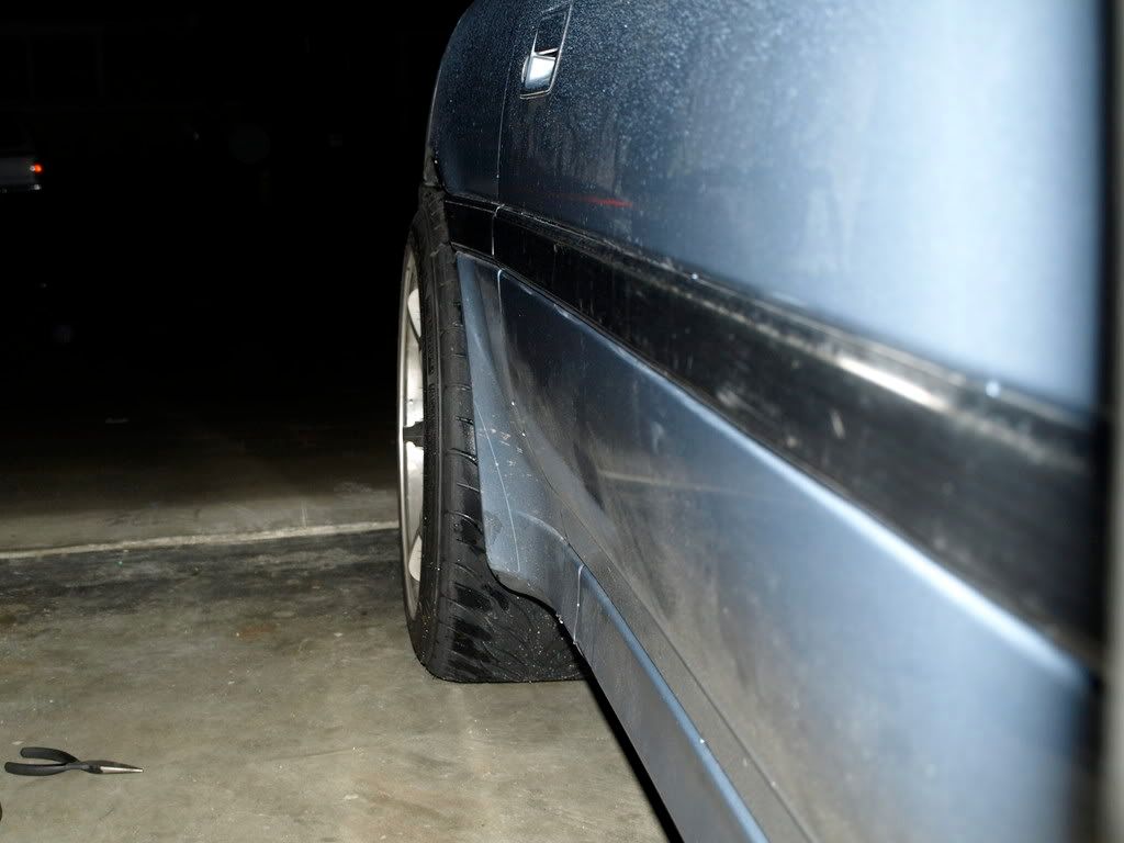

Thank You BorHor, i appreciate the quick response. Do you run the same size up front by any chance?BorHor;1778502 said:Here is a pic of 17x10 +25 with a 255/40/17. I had no rubbing issues.
ocerrahyan;1778556 said:Thank You BorHor, i appreciate the quick response. Do you run the same size up front by any chance?
thanks again brother

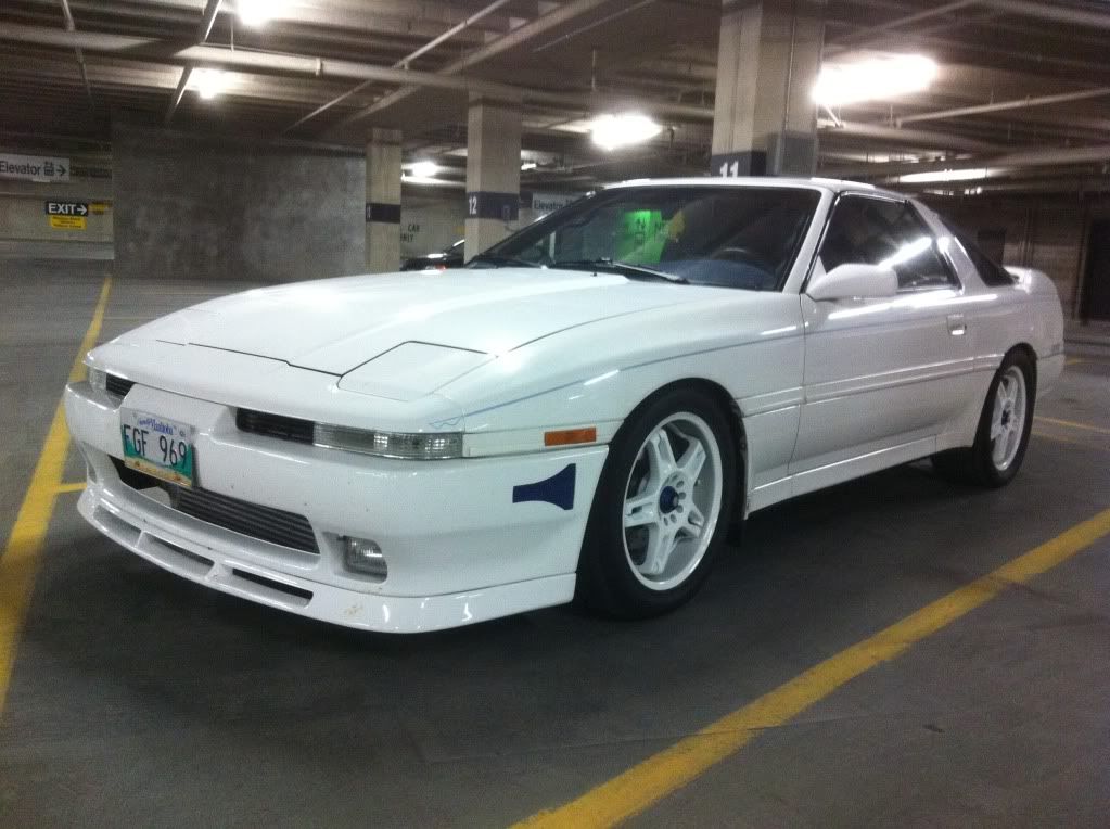

xzeror;1778666 said:Hey bor, how would mkiv tts with a 20mm spacer in the rear and 25mm in the front with (245/45/17 and 275/40/17) fit? or would u recommend diff size spacers?
IBoughtASupra;1778672 said:Not to be an idiot, but why do you want to run a 10 inch rim in front? That's going to make your steering feel very heavy.
BorHor;1782486 said:^ Dan
With the tires you want I would go with the 17x9 +35 and 17x10 +38. I would consider that the nice clean fitment. It should clear with out fender work. And also because you will not be slammed I believe it will look the best over all. Having lower offset wheels + high car = FAIL.
