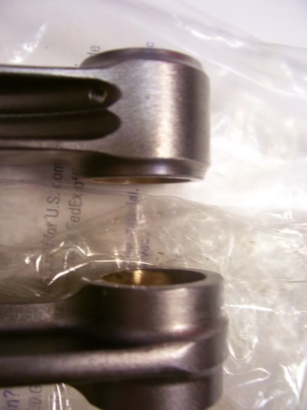

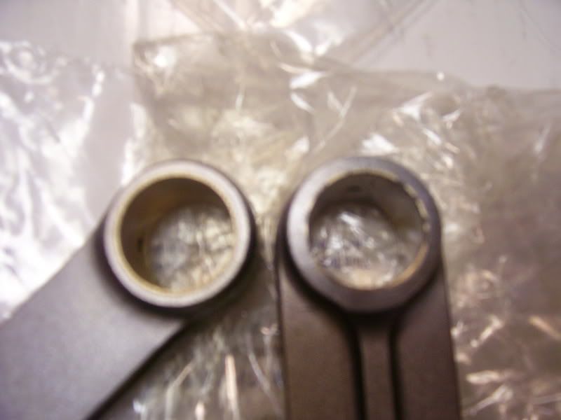

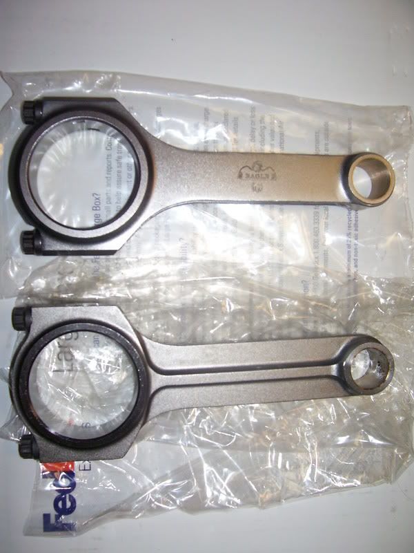

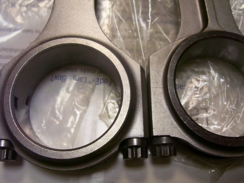

Even though eagles are made the same way as pauters, they are just not as heavy and stout as the pauter rod. Kinda like a dime and a quarter.
Pauter on the right in every photo

wow....... thanks for the pics...... however, the eagles sure look beefy to me! clearly not as stout as the pauters, but they have some serious mass to them non the less!
