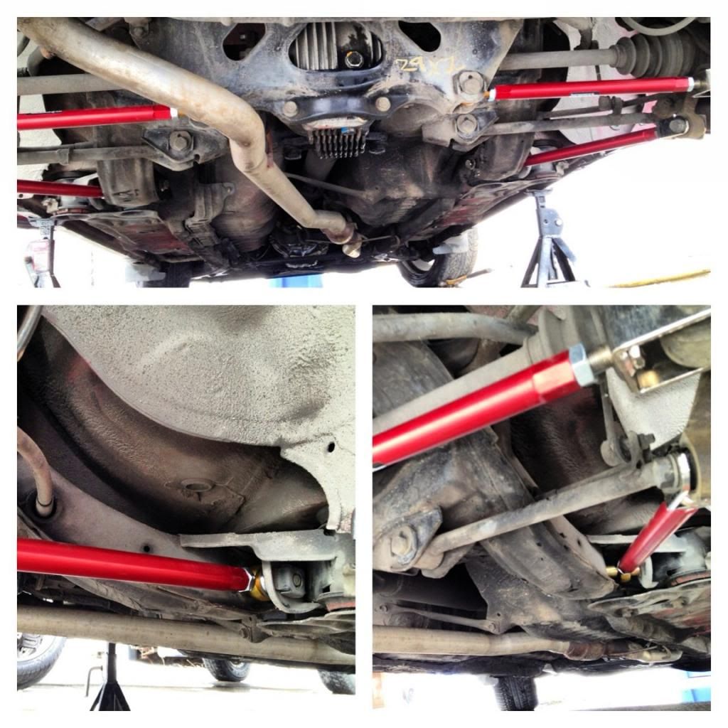

Put in the battle version rear traction and camber arms

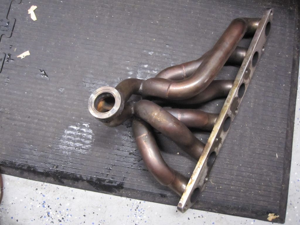

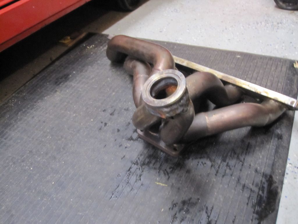

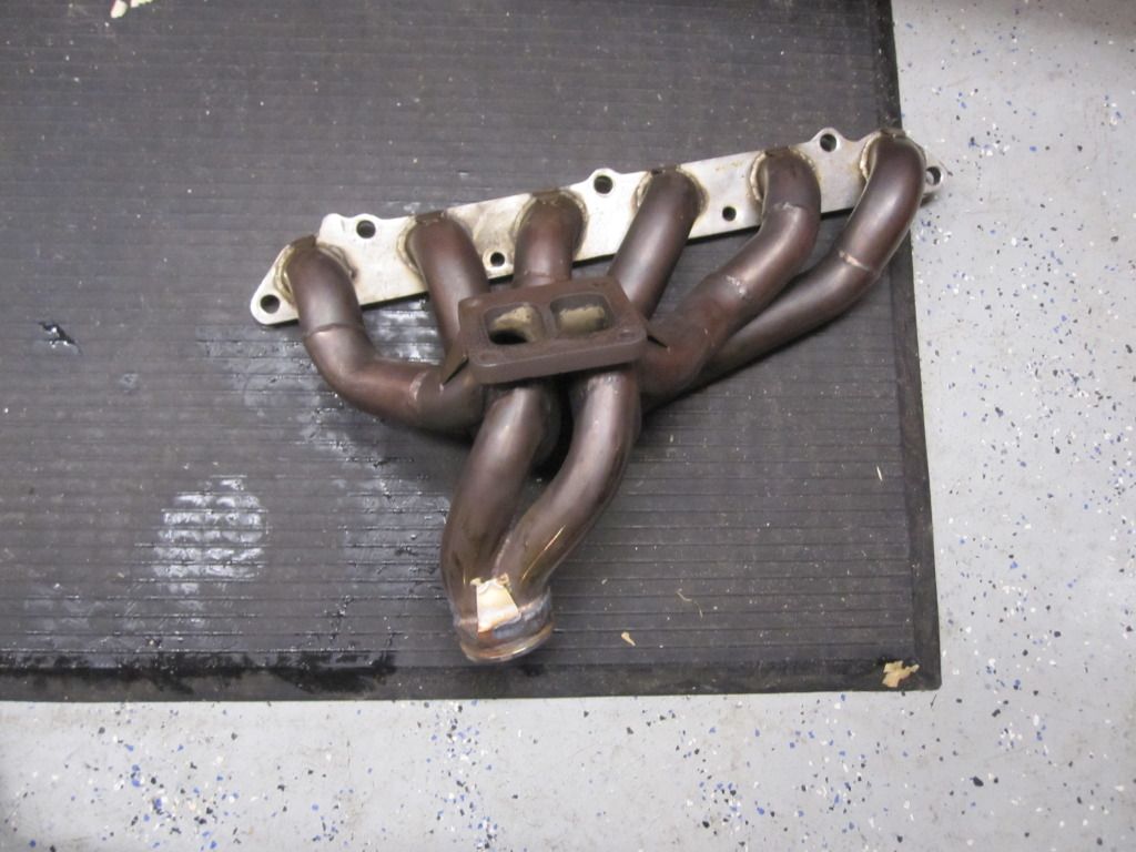

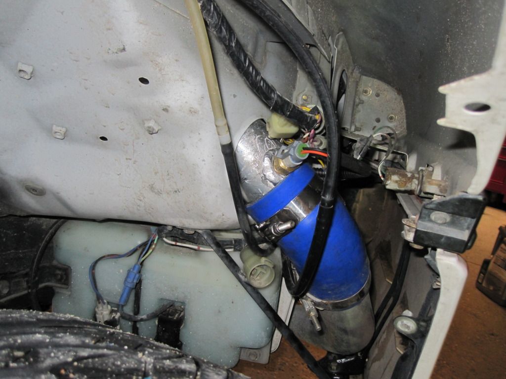

Today, I picked up my turbo manifold and intercooler pipe from my buddy that welded them. I had him cut the old HKS flange off the turbo manifold, and tig on a Tial 44mm flange, I also had him weld my IAT sensor bung into my intercooler pipe.

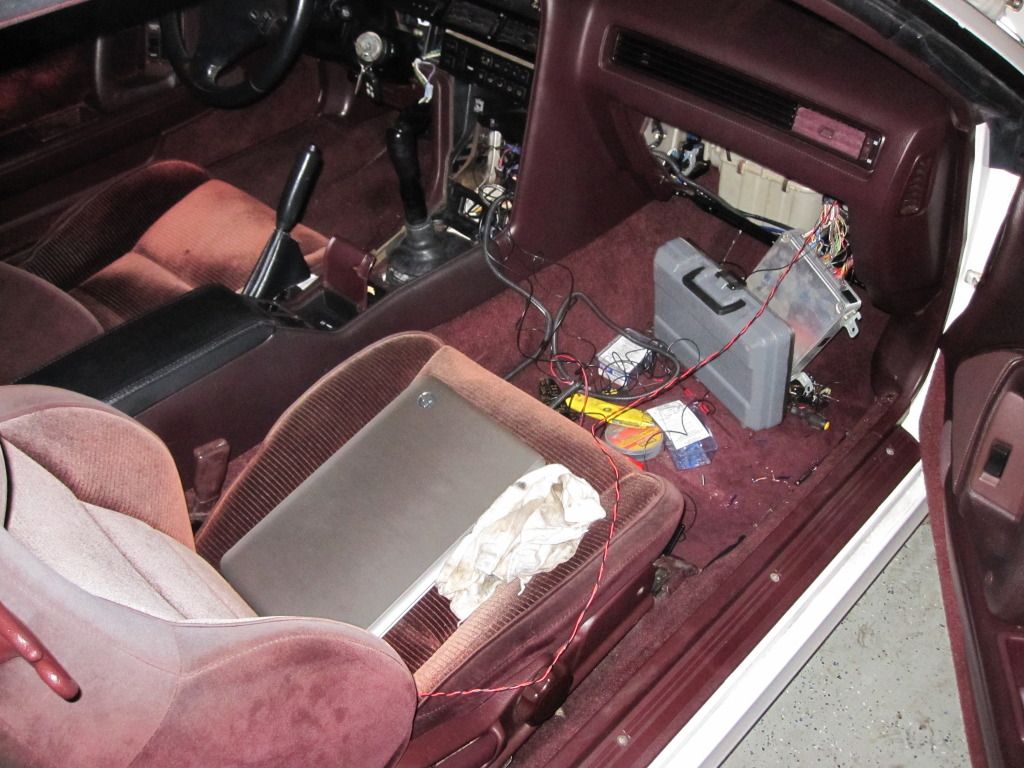

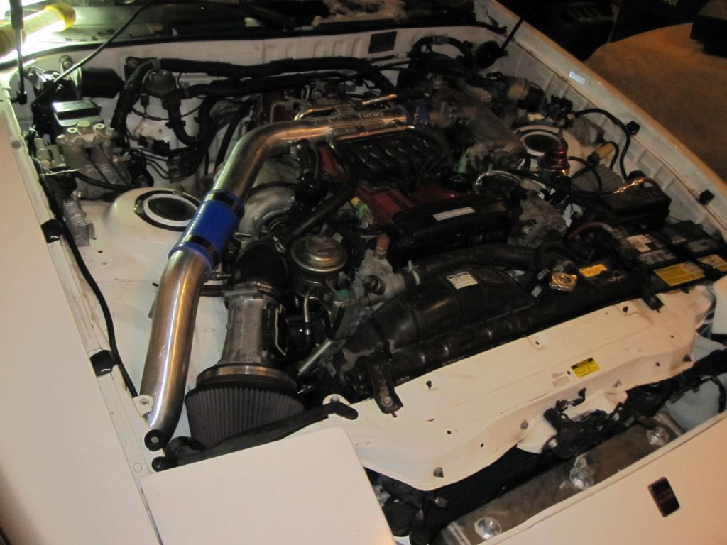

I also finished up wiring in my MAP sensor, IAT sensor, and Wideband all to the ecu plugs for my AEM. I then uploaded a basemap that is changed over to MAP sensor instead of MAF, and she started up first try. I am pleased. Now I have a lot of tuning ahead of me. I cant wait until shes drivable, so I no longer have fuel cut, and a fun car again.

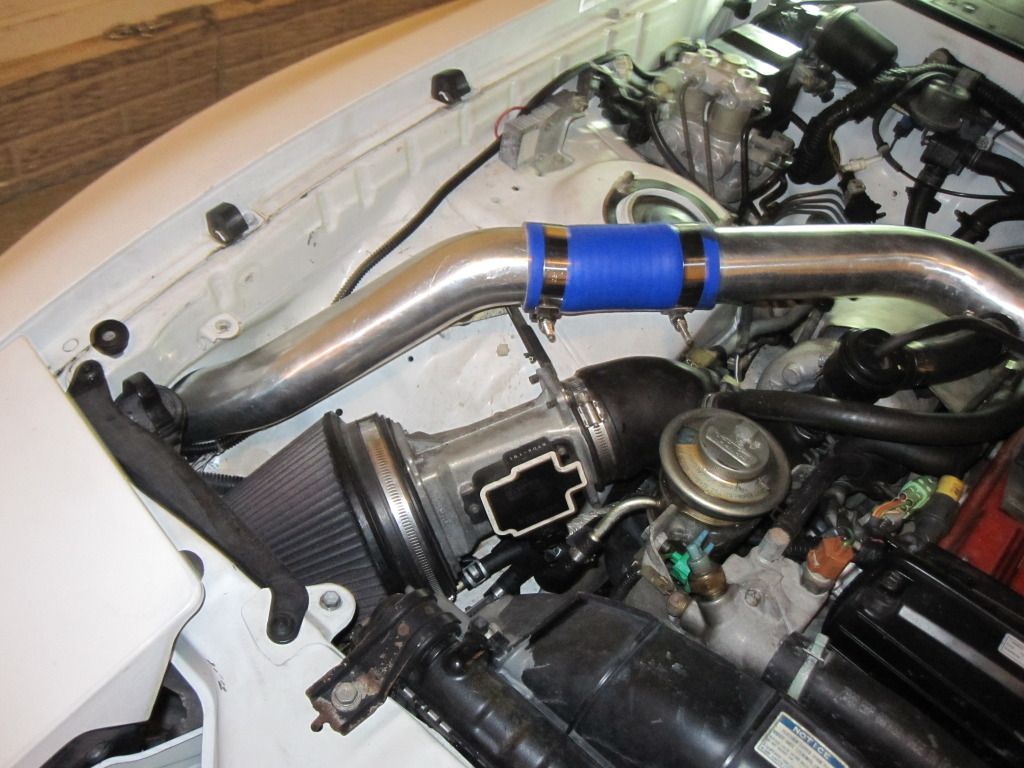

Location of IAT sensor in IC pipe. I am hoping it does not heat soak here.
Where the wire will be temporarily ran through the engine bay.
Engine bay shot.
Turbo manifold. Not the prettiest welds, but the will hold and look like they will seal well.
