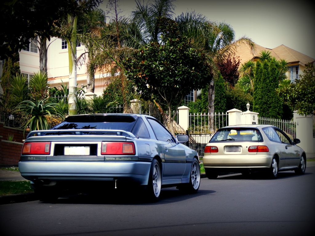

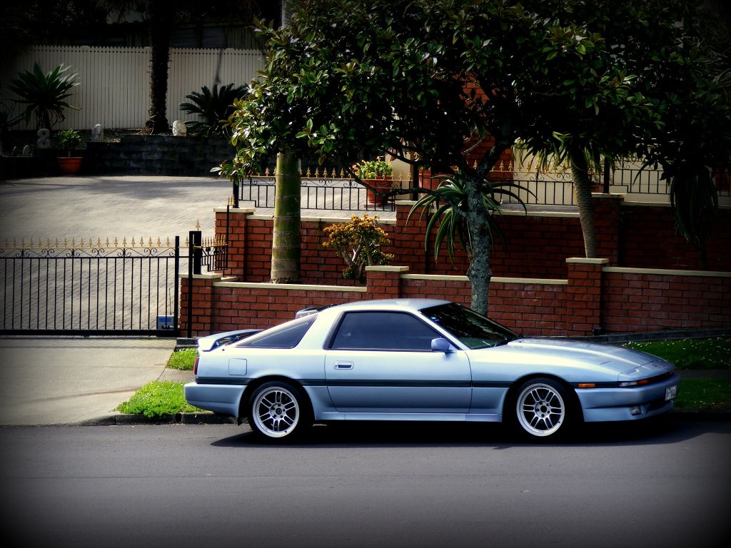

Cleaned her and got some shots with a mate of mine few goodies on the way for my supra...

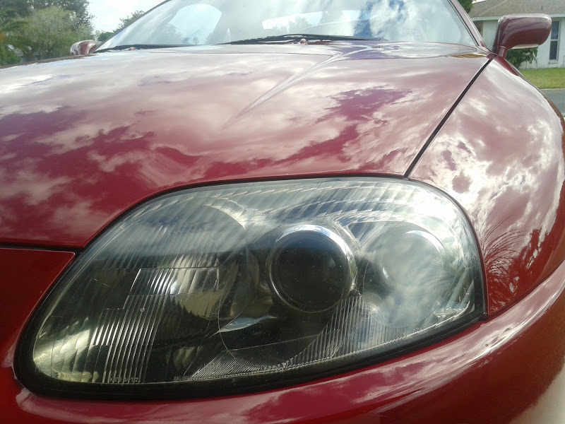

Thanks man. It helps to start with a car that has a clearcoat and that isnt completely shot--you can see my Miata daily poking out in one of the pics that is pretty much pink its so faded.
In either case, it takes plenty of time and patience!

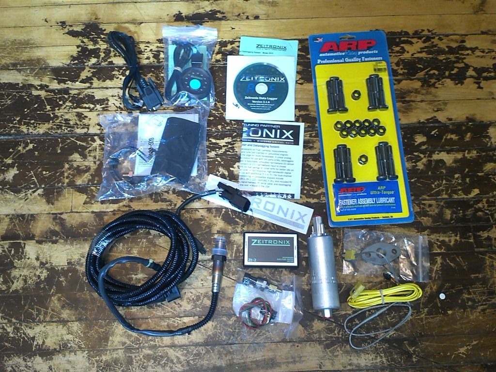

Goodies arrived from Driftmotion.
ARP Rod bolts, which I ordered, but since I've now installed my rods and pistons... Not sure what I'm going to do with them.
Walbro 255lph pump, in-line. I plan to install this further up the fuel line, since it's not the in-tank model, it will serve to ensure adequate fuel pressure.
Zeitronix Zt-2 datalogging system, with wideband O2 sensor.
Zeitronix Zr-2 multi display
Zeitronix 3.5 bar boost sensor (Will also double as input to the Apexi AVC-R)
Zeitronix EGT probe
Stock O2 sensor to Wideband adapter flange, so that I don't have to modify my existing elbow for the wideband.
My exhaust manifold already has a 1/4" NPT tap for the EGT, so no worries there. I just remove the plug that's in there and install the EGT probe. It's on the #6 runner, which should serve as a reasonable indication for EGT. I can tee in the 3.5 bar boost sensor for now. I'll tap in a sensor port on my new intake manifold though. I'll probably install the fuel pump while the engine is out. I should be able to put flared fittings on the hardline at the firewall.
I already have the ECU out to fit the Apexi stuff that I'm installing, so I'll start wiring in the Zeitronix unit now, I suppose.
