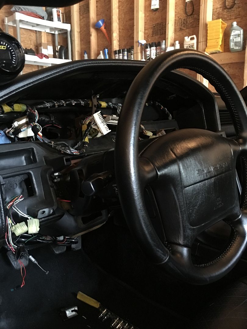

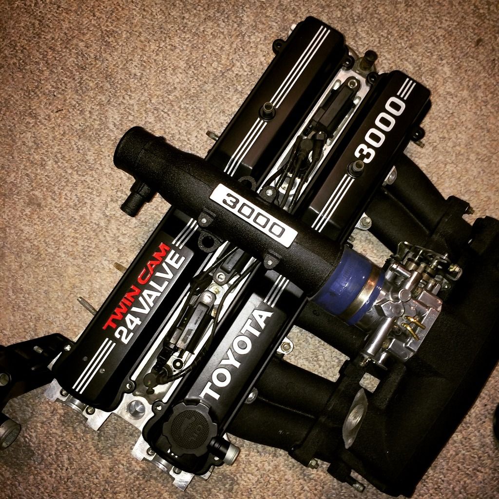

I've been working on this lately.
Next up is the wiring harness.

Awesomeness! I may have to do that to mine. What kind of paint did you use? (in regards to the black valve covers, but the grey ones are cool too!).

I used high temp engine enamel. Masked off the lettering, sprayed on a few coats. Then used acytone on a paper towel wrapped around a piece of flat plastic to lightly skim off any excess paint from the top.
Be VERY careful with the acytone, it will eat the finish on the powder coating (luckily mine are satin black so it is hardly noticeable) and the fumes alone will wrinkle the paint in the lettering. Go very slow, quickly wipe once and wait a minute (or you'll end up redoing 5 times like I did). Maybe try gun wash or wax and grease remover as they aren't as strong.

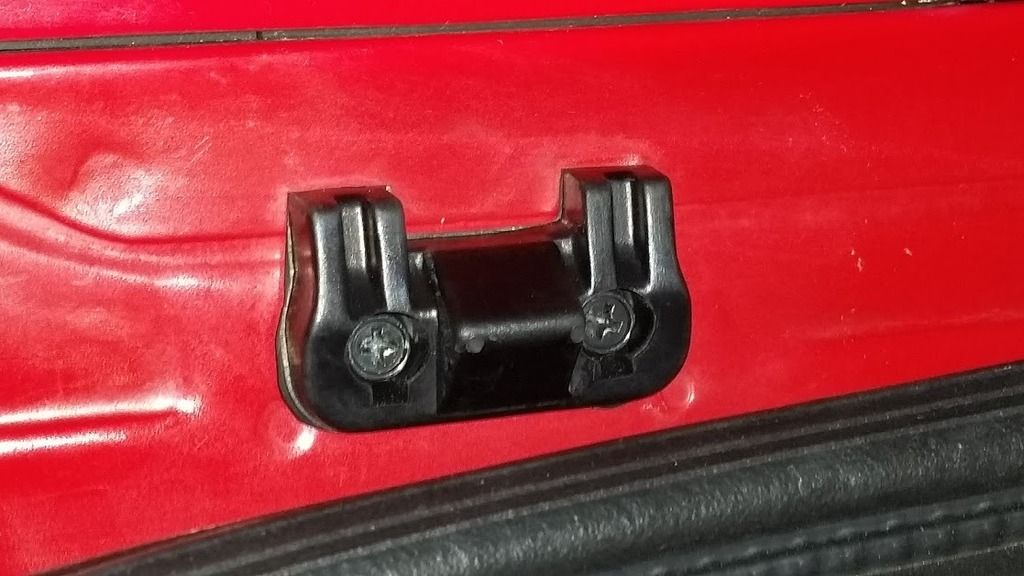

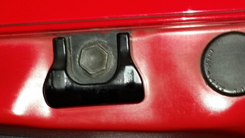

Nothing too strenuous. I ordered and changed the worn out rubber stops on the hatchback. I finally had enough of that occasional rattle from somewhere "back there" over the last several years. Ordered from toyotaonlineparts.com--including four new screws it was $39 shipped. I read a lot about the difficulty many owners had getting the old stops off due to the factory loctite on the screws. I did what many recommended and cut away the old stops to get the screws out in the open. I tested and found the loctite holding firm so I carefully squirted a little PB Blaster on them and waited. Used a good #2 Phillips and a lot of pressure. Once each started to give, I used my drill with the clutch set about 30% and more pressure to ratchet the screws out. I only slightly deformed one screw head with this process--the first one, before I thought to use the drill. The new stops went on with no problems.
I brought the hatch down to make sure the upper stops seated properly and I noticed that each of them hit the lowers at a slight angle. I never noticed that before but I adjusted them so they were parallel with the hatch and they seated perfectly.
Hopefully they'll last another 27 years!

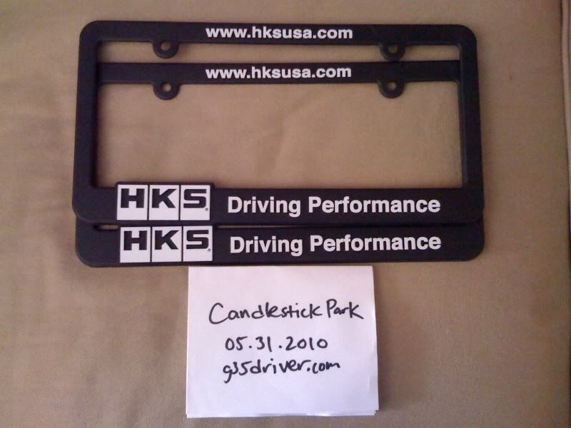

I REALLY wanted one of the these:
The problem is that HKS doesn't make these anymore and I haven't seen people selling the ones that they have recently. So I thought up of other automotive related companies that I liked. What I had issue with is that my car didn't have any of the parts that these companies made and I thought it wouldn't be right to have their names on the car if that was the case (I have at least an HKS turbo timer, which I've read is pretty useless for a street car anyway?)

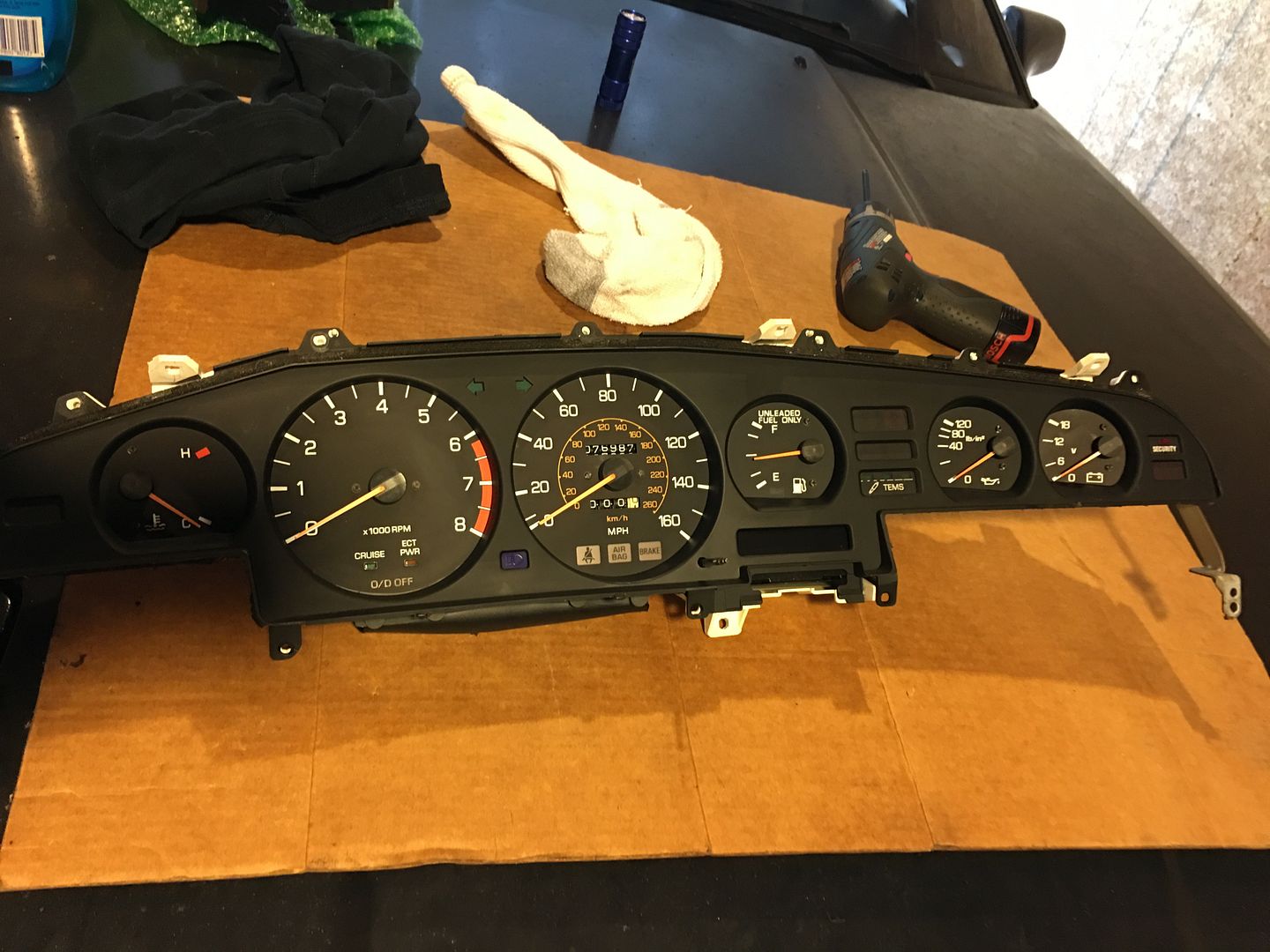

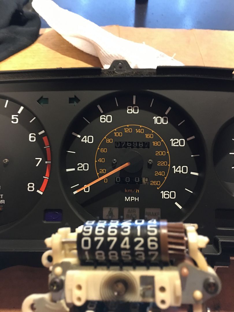

Finally got around to replacing my speedometer with a unit that had a working trip meter and replace the voltmeter's needle with a non-faded one.
All done. Not bad. Damn near the original miles too.

Hey, my trip meter started to not function properly at the end of the summer. Wouldn't roll over 99 miles and then 29, then 1/2 and now it's stopped. My ODO still works fine but i'd like to get my trip meter working again.

Afraid to say there is no repair that I could find short of replacing the unit with a working one. Odometer and all.
