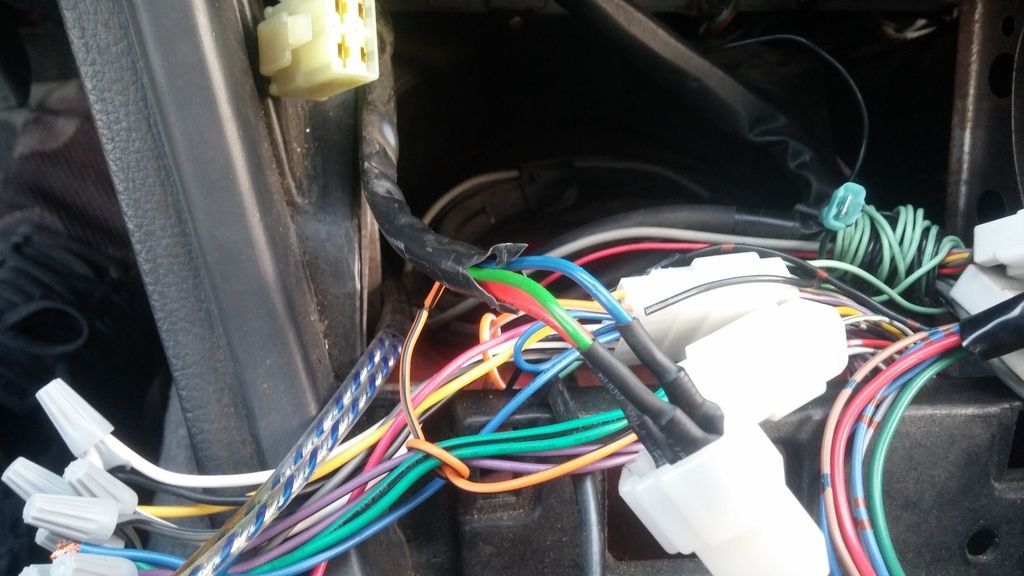

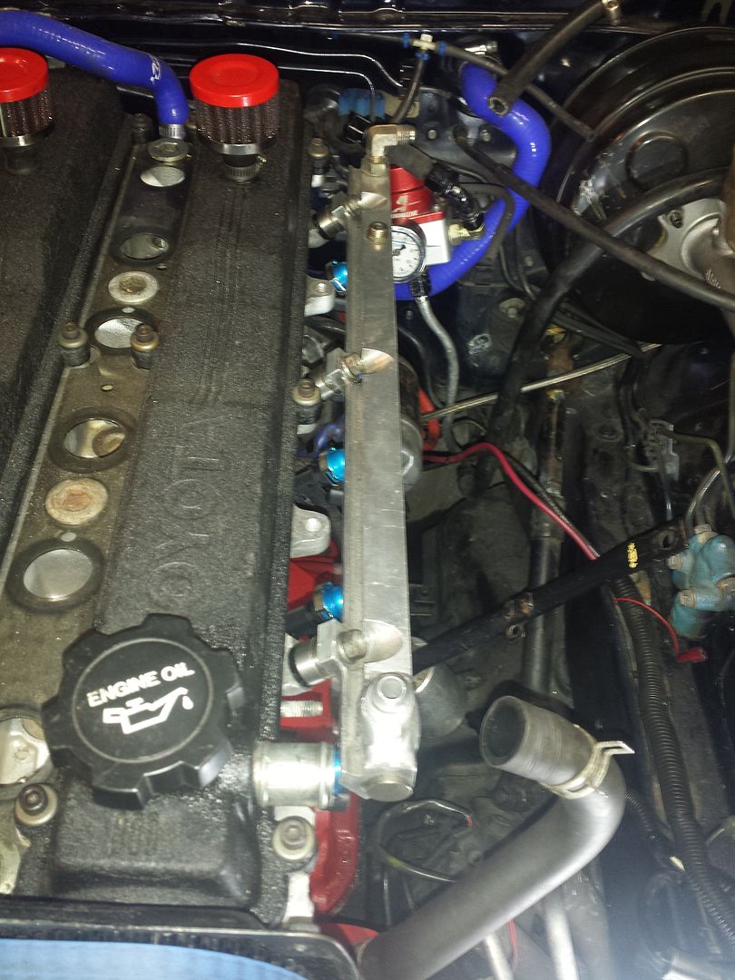

3p141592654;2063666 said:
Where did you run the boost wire through the firewall. I used a grommet that was over by the master cylinder if I remember correctly.
through the wiring harness grommet on the passenger side with a rewired knock wire. I'll re tape it when i have the lengths i need figured out.

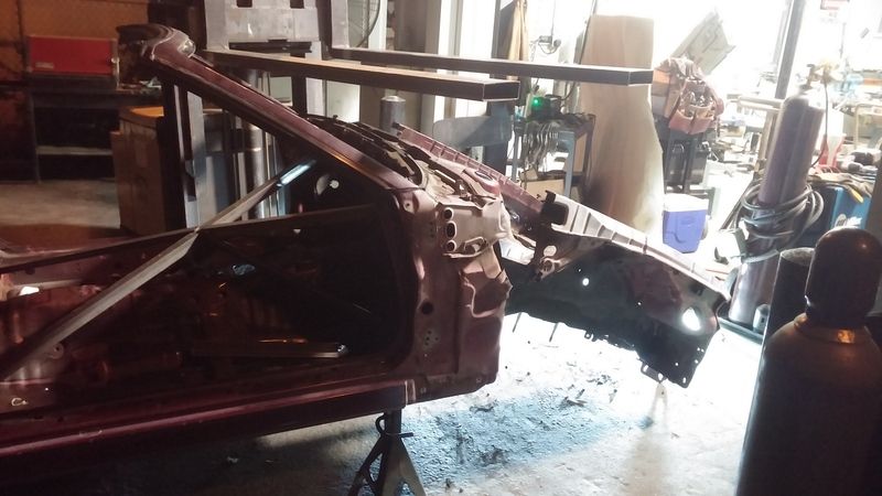

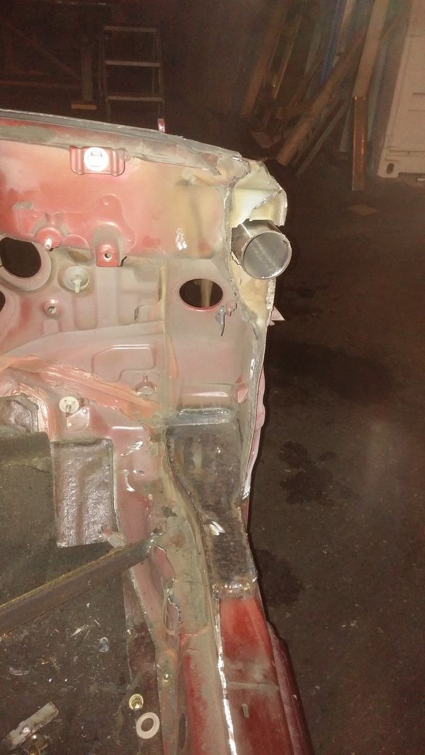

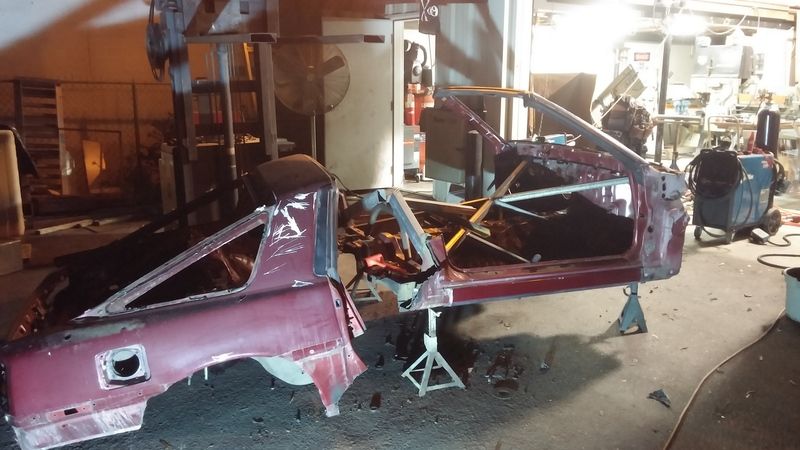

Decided to fix some frame damage on the front.
Started inspecting the rear and it was tweaked also...

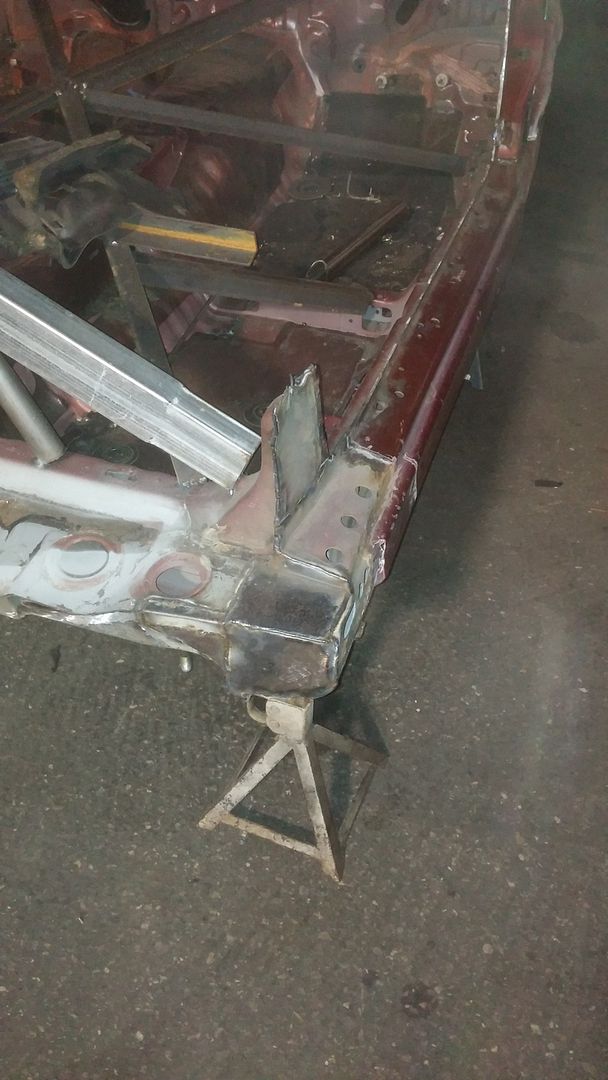

Got some more work done, started prepping for new frame work...
Now just waiting for some clear time to put it up on the frame table.
Looking forward to trying those auto tranny mods once this is a car again.

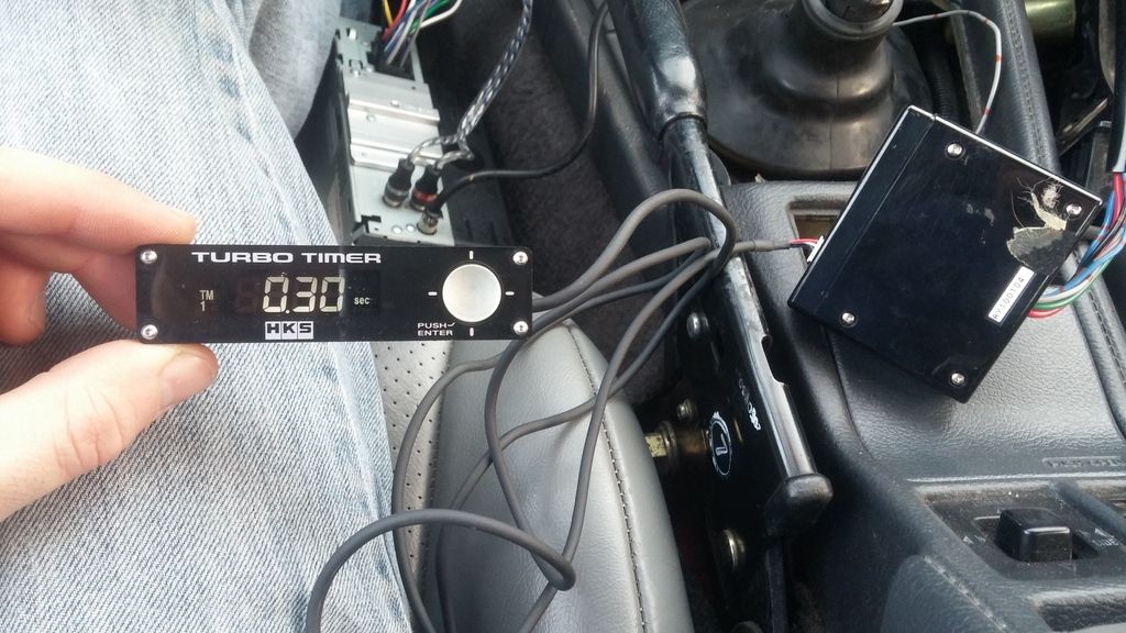

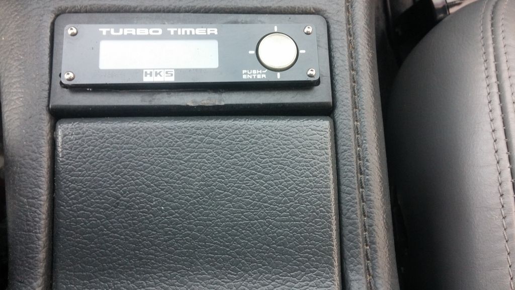

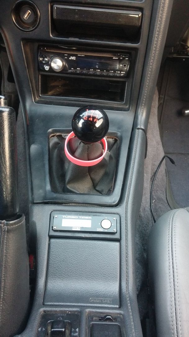

a friend of mine gave me an hks turbo timer. i think its an authentic one, either way it still works counting down just like any other turbo timer.
heres some pics from the install and mount
sheedy126
Boost Addict
Apr 30, 2012
716
kennewick
Even if it's driven hard and close to my house? I'm unsure of where you're coming from. No offense I just see a very good use for it
Sent from my LG-LS980 using Tapatalk
Grandavi
Sep 25, 2008
2,664
Calgary, Alberta, Canada
He's right, although I also have one on my Supra. Proper driving habits dictate you don't run full boost and then slam on the brakes and shut down the engine... If you do that... You have other issues. You don't need a turbo timer on a mk3.
I put one on thinking it would help and had it explained that typically, they just waste fuel. We don't generally drift to our house, and shut down the car... It's usually a nice drive through residential.
I do still use mine. Though... Lol
sheedy126
Boost Addict
Apr 30, 2012
716
kennewick
Oh definitely, I 100% agree. Not that I'd ever do what you said, it's a good peace of mind to have one. I take mine to the drag strip occasionally too and instead of letting the oil cool down in the pits I'll just let the turbo timer turn for a minute or two
It's not needed under normal everyday driving conditions, but when I really need one it's nice to have
